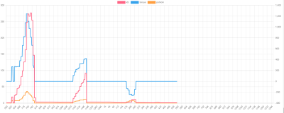

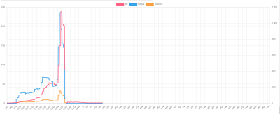

Thanks Jamie, Andy please keep to a conservatie throttle max for now, we want to see if the IDC levels off as quick now. Should theoretically not be the case so the torque will carry on for longer.

Too late bloody awesome
After these 2 runs I floored it and span the wheels half way up the road, my neighbours are so pissed most of the juddering has gone I feel a lot of what's left may be the backlash in my diff I'm not sure it will last much longer with that torque

Re: [WIP] BMW Z3
Now thats more then double the current draw, and no flat point insight on the current draw. Better get the car ready for some higher speed acceleration tests.
