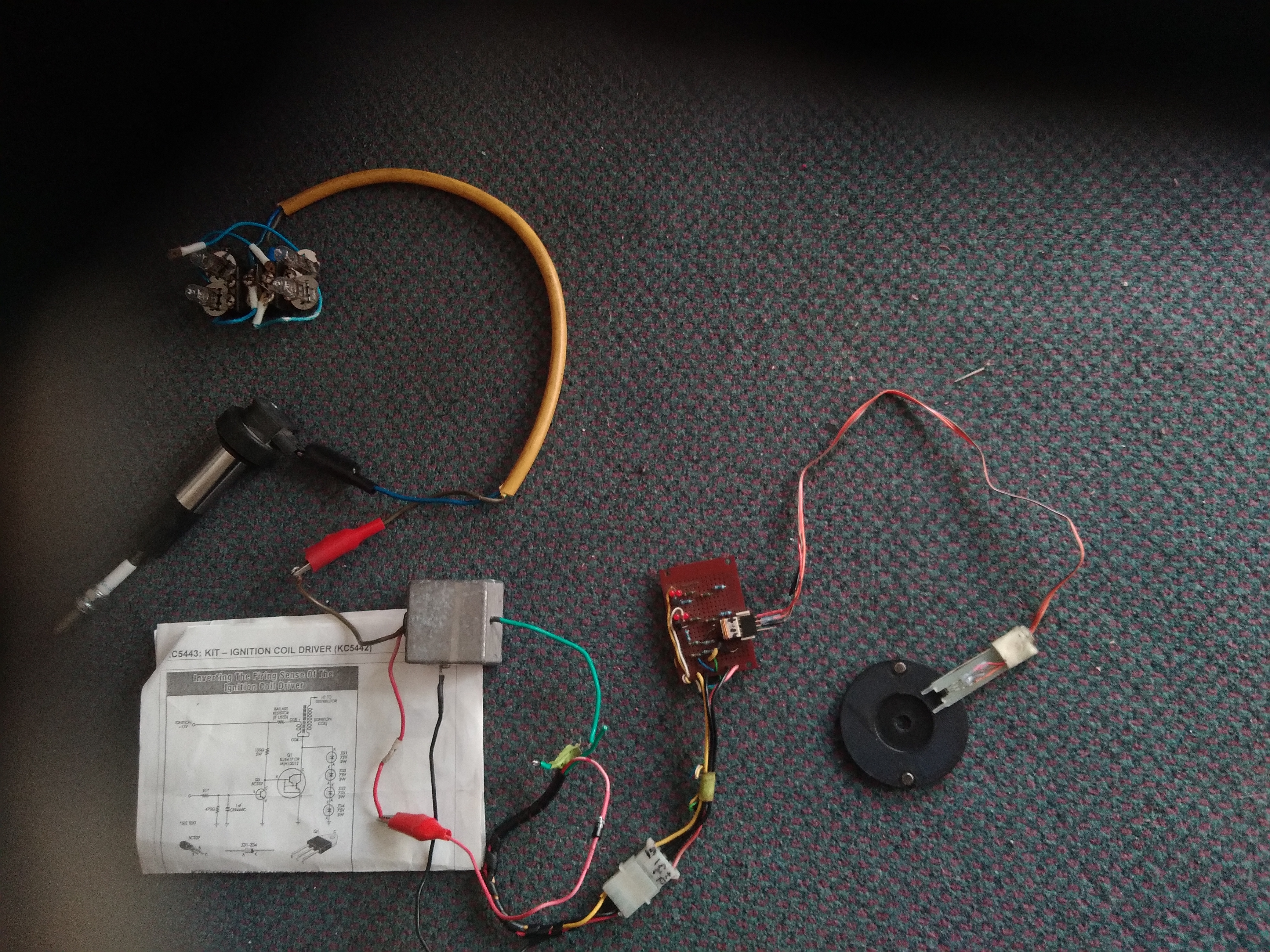

A Bmw sensor for what is possibly tacho and timing to go on the speeduino track has now arrived, for after a more basic approach.
The magnet wheel, Hall sensor, Pre conditioning amp, Coil Driver kit, Ballast bulb, up to the Coil and plug.
Lots of bits to eliminate a set of Mr Ketterings Points.

The spark set up, now delivers a slender, but firm mini bolt

I'm kind of surprised it's an odd fire twin, but they do make good torque for their size.
Speeduino works with odd fire setups but it likely has some specific triggering requirements to do it.
1 magnet on the trigger wheel with 2 Hall sensors spaced 90° or whatever the offset is could work to rig it for now. 1 for each coil. It will be tricky to time / adjust though.

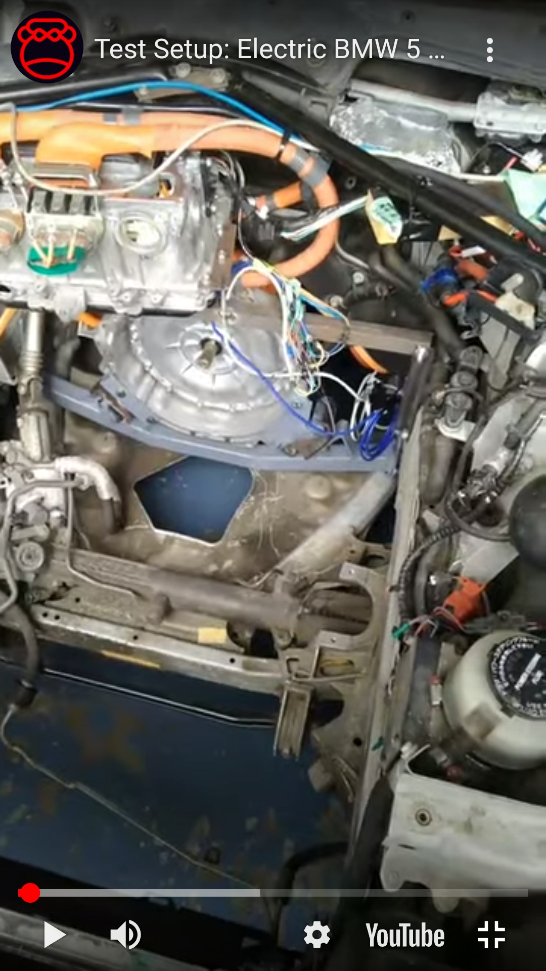

Water circulating system gor the Kymoco, twin cylinder now running as a single for test purposes., has been fashioned for short running.. No radiator or heat exchange yet, but coolant in pimp and block.
A stumbling block has appeared...Once a clamp meter indicated 14A into the 250V battery occurs, the charge drops to zero. Reducing the throttle, then initiates the charge, but again will cut out at 14A.
The Nissan leaf inverter which is being used with the Valeo motor generator from the REX unit, is controlled by a Thunderstruck V1.0 vcu.
Increasing values of
max Battery V for regen,
Idleregen,
and brakeregen settings has not made any difference.
Also have activated the Brake switch control input, and no improvement yet achieved.
The reason for the limit is not yet understood.

There are no errors or messages showing in the thunderstruck vcu?
Its likely that there is some limit at 14A or 3500watts that is triggering it to cut regen. Could be a missing / incorrect input like temp, voltage, amperage, etc. What can you see in the thunderstruck vcu that looks out of the ordinary?

Thanks jrbe, the Thunderstruck V1.0 vcu is one of the very first releases, looking to re find the manual . Had used it before with Leaf inverter to drive a ED Smart car, which had done it's graveyard mode shutdown. Have not used the brake function, or more than mild regen, so had not seen this limit till Rexing.
Will see how to find/read errors, for clues.

Have located the relevant manuals , and so far have not found , what may be missing.
Have also now tried the V3.1 vcu, with the same result, so pointing towards something the inverter, possibly an input not satisfied.

Activation of brake switch, Changes to regen config settings of brake, idleregen, and turning all off, seem to have no effect, still 3.5kw or 14A on clamp meter, and it unloads.
Finally some variation can be gained by retarding the resolve setting some degrees, and 7kw or 30amp on bus clamp meter observed. However there is then low starting torque to crank the engine at the present Nm settings, unless advanced to around the original selected resolver position.
Looking at trace info, you see of anything can be gleaned.. Wondering if this charging is somehow dictated by the inverter , perhaps some default setting... WIP
