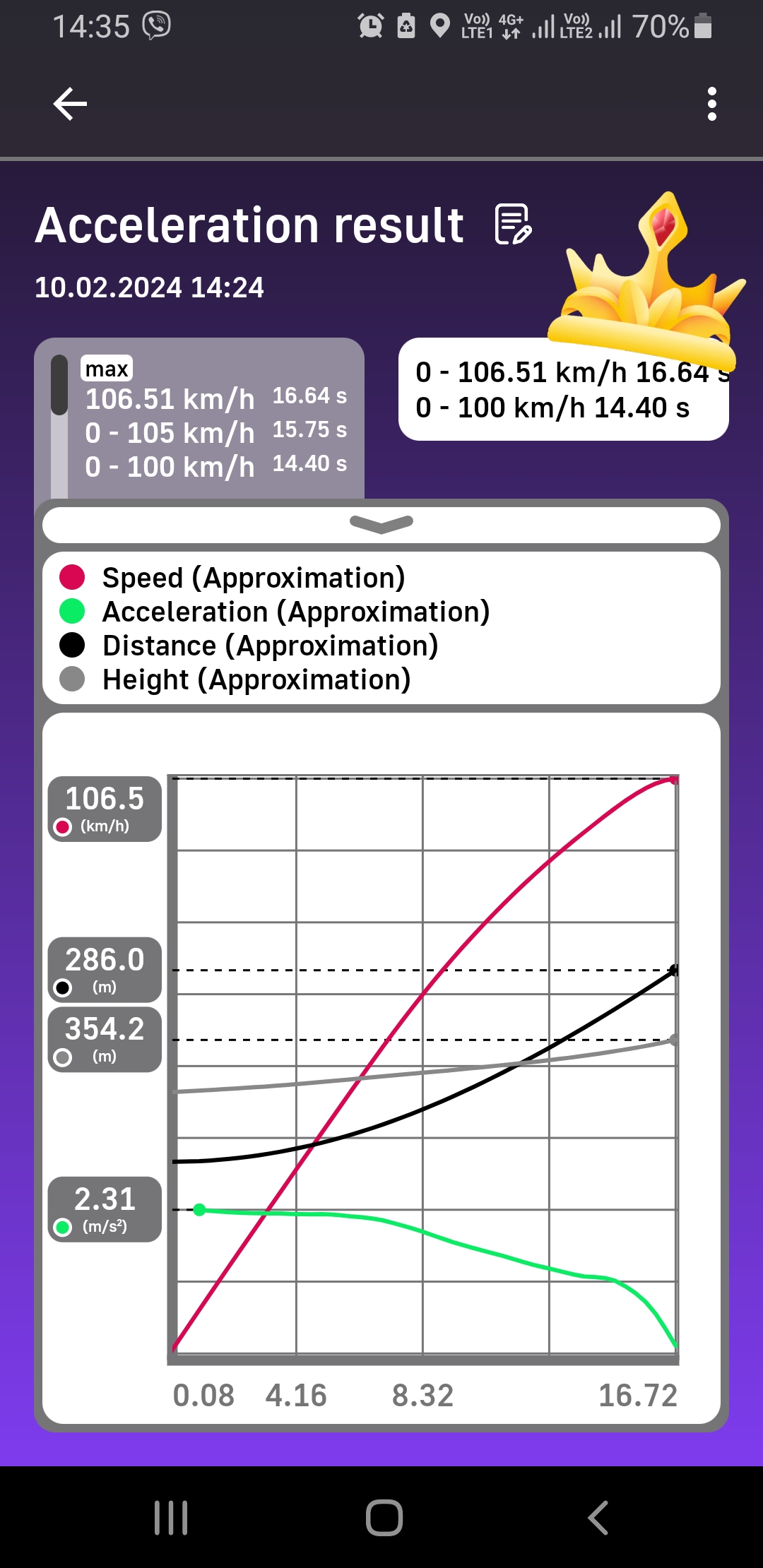

I measured acceleration at 15s from 0 to 100km/h....
I made some effort to play with map3 and changed some values at the first section up to 2500rpm from 7 to 15! This notably increased responsiveness from takeoff. At second try i got 14.4s to 100km/h. I am sure i could do even better....

Did you also change or comment out the over torque check in the code?
I ask as a value of 15 in the map would be 150% of 200nm so 300nm
Would be interesting to see how much the inverter thinks it's putting out.

No i kept it in as i thought final sanity check might help .
I just prepared a new map for test

Mazda V6 engine used to have 230Nm of max torque at 5300RPM...
EDIT: Whoa! Torque at start was huge with value 25! I could easily shave tires... But very soon torqueRequest = 0; reduction kicked in.
So for another attempt i reduced values to 20 and changed torque reduction to torqueRequest = 2000; So as to stop adding to torque but keep the torque already requested.

There is a dark side though, When in map1 there is a rubbery feeling of throttle effect. Also suddenly throttle would go from 100% to 0 and create a sudden jolt. I abhore map1 and its incremented torque. Seems unnatural.
EDIT3: To remedy this i remodeled map1 and still i get unnatural acceleration/decelleration with increments. But now when in overtorque torqueRequest goes to final value at least it wont jolt the car anymore...

Ok so I think we can say your application does not need any ramping to control wheelspin.
I would suggested removing it and simplifying the code, your fork is quite far from mine now so It's hard to debug any issues you are having
I would be interested to see if you can actually command (and get) more than 200nm from the inverter

Yes thank yxou for your help. I suspect i can already get up to 230Nm. I assume this empyrically as i corrected my code in part of max torque limiter where i set 2300 as the limit. And result was 240A current when accelerating where before it was only 210A.aot93 wrote: ↑Tue Feb 13, 2024 2:17 pm Ok so I think we can say your application does not need any ramping to control wheelspin.
I will confirm this further by openning up the limit to 280Nm and see if there is any change in amp draw.
EDIT: I tried to remove incrementing from map1 and it worked the same asa for map3. In addition i inhibited all regen when in map1. This should be used when in rainy or icy conditions due to possible wheel lock.

Now finally everything works as it should with VCU. I got good acceleration, good regen response, Nice reverse drive and everything connected to Outlander components is operating aas it should.
Acceleration at 13s now. I managed 11s with large torque swings, but it was not comfortable. I setup all around comfortable ride.
