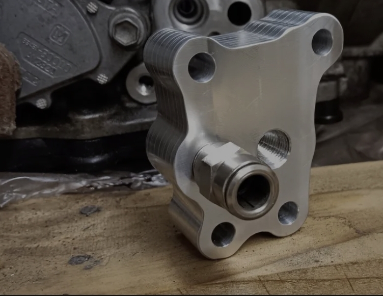

What about something like an accusump to store oil pressure while driving? They make them with a solenoid to store the combustion engines oil pressure while the vehicle is off. Key on typically turns on the solenoid to send pressurized oil into the engine. You could potentially use something like this to store oil pressure while not moving but a few points:
1 you'd have to build up oil pressure with the wheels up then turn off the accusump solenoid.
2 if you managed to run out of pressure while out you're screwed.
3 still looking like an auxiliary pump is required for slow moving traffic. I'm not sure what speed the transmissions internal pump takes over. An external pump that turns on < 0 throttle but < wheel speed. Then could watch pressure in the accumulator and kick on when necessary or run variably to maintain some acceptable pressure.
You could use an adapter like this,
https://www.ebay.com/itm/175936880476
Along with one of the many universal oil pumps available that could work as a backup pump plumbed into an adapter.
I'd be willing to draw an adapter up in Solidworks if someone got me good dimensions of everything.
