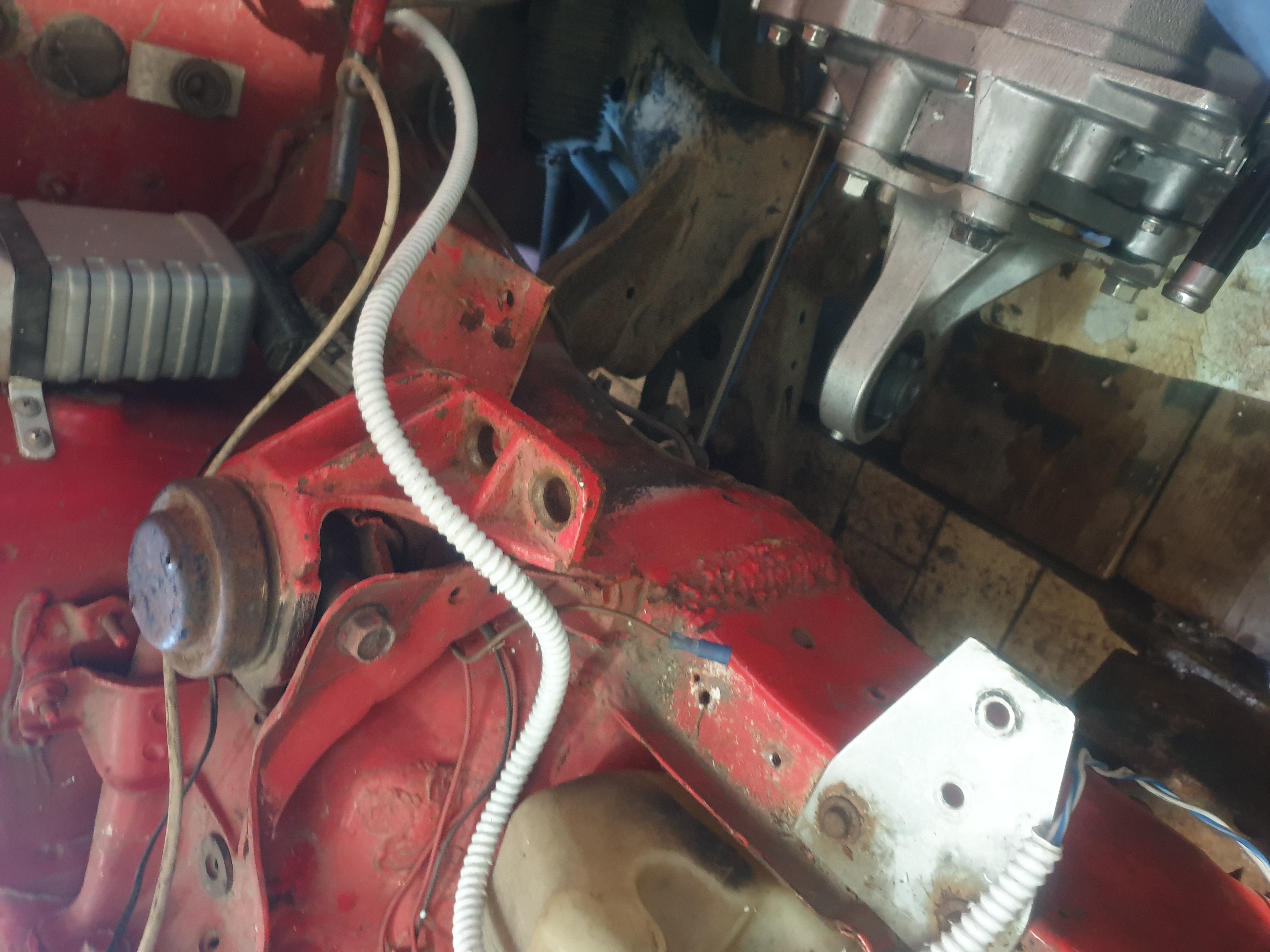

Some more photos of motor positioning. I need to get good level position with driveshaft well clear of the frame when car is on lift!!

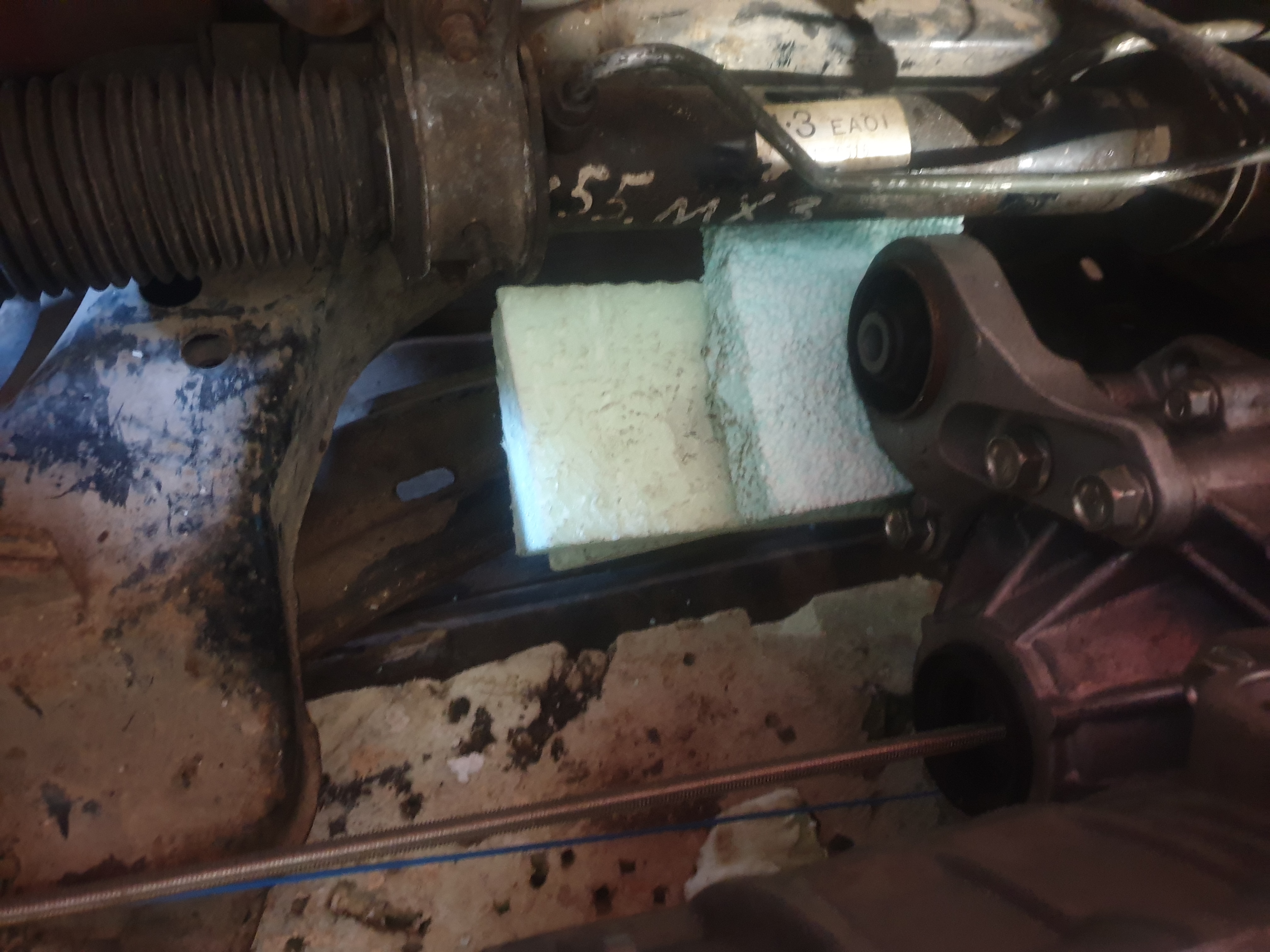

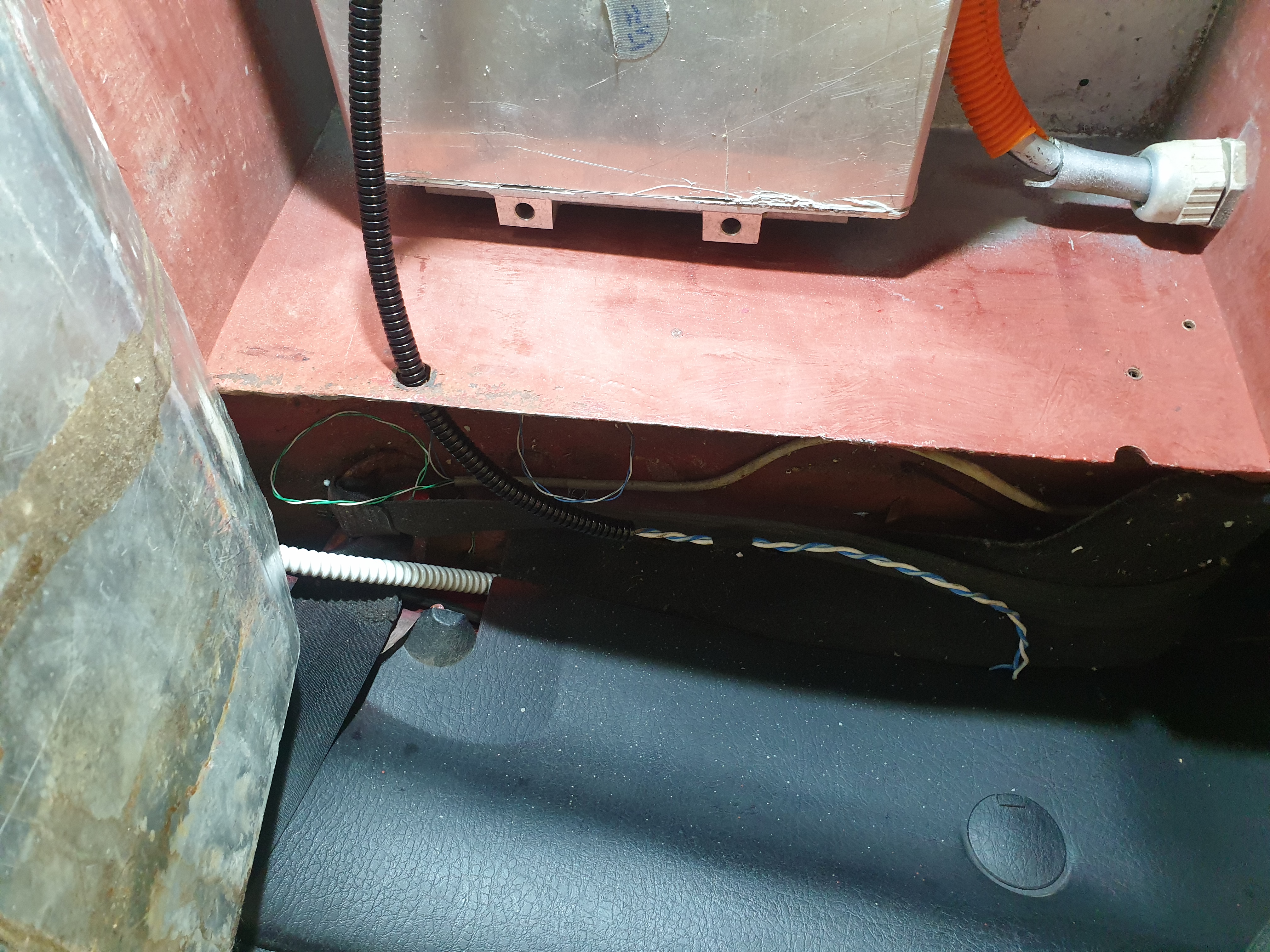

I managed to install Outlander motor. It is a bit offset, to forward axis, like 5deg probably because of my strange bands mounting contraption.
If i dont like it i will correct it by rewelding those forks. Next i started to mount inverter and charger. Well the charger mount was already made. I just repositioned it.
For the inverter i made 5mm alu brackets that mount firmly to the chassis. At least 3 mounts to define position in space. I also put Outlander heater on the side so i can connect and setup hoses. Next i need to fit the front battery box to those transverse beams and make mounts for cell modules inside the rear box.

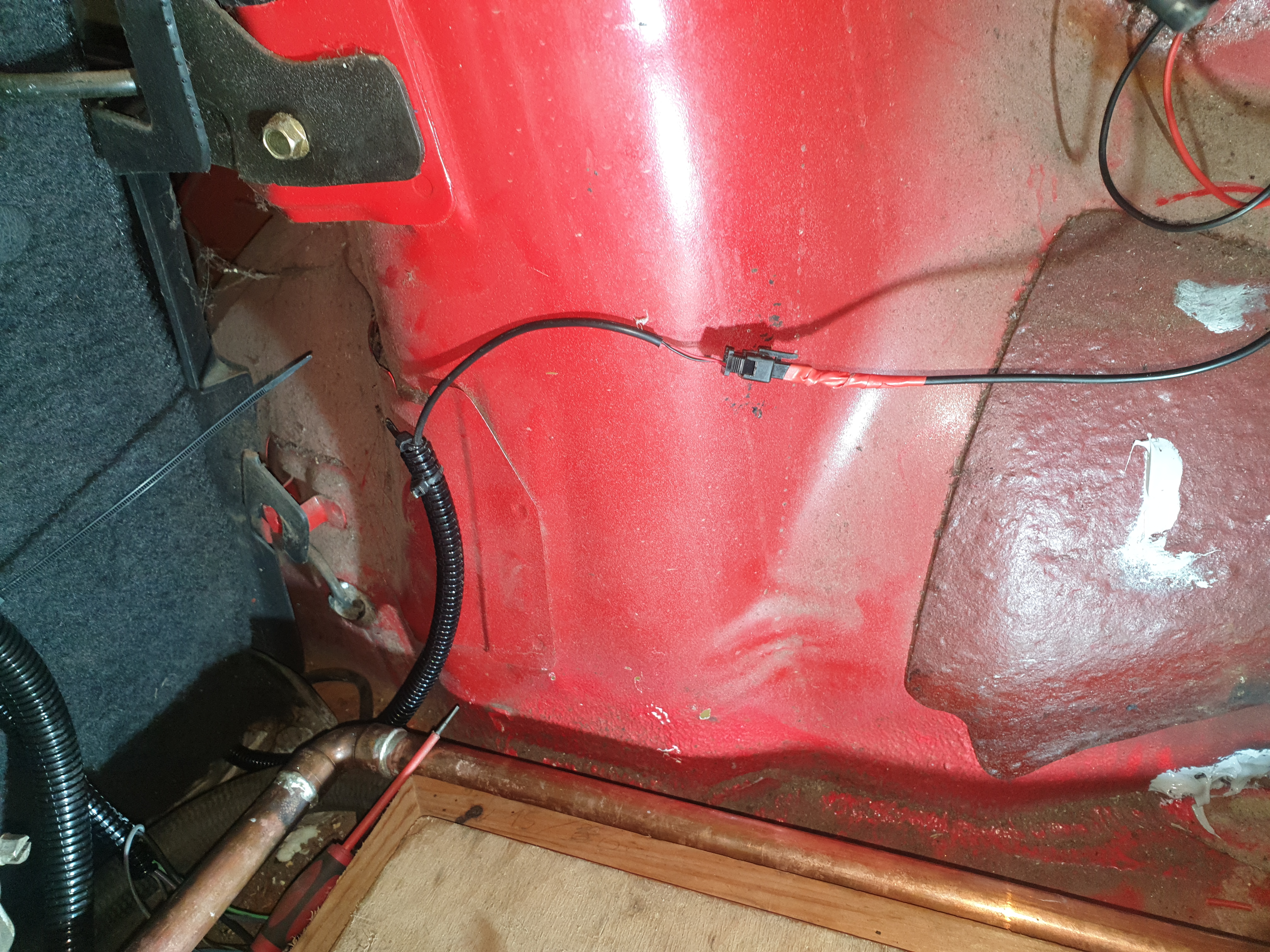

The other thing is the wiring of systems in front. I made a single CAN line for VCU – CHARGER – INVERTER – HEATER – and leave the last connector for CAN bus termination or to add one Volvo Eltek charger in the end. Of course there will be 12V lines and relays for Enable or charging signaling etc..
The idea is nice and compact wiring up front, something that is now called Full Mux where you only have power supply and digital signals to drive your devices. https://mazdamx3ev.wordpress.com/2023/1 ... omponents/
Next i need to test my CAN lines for messages from VCU and devices.

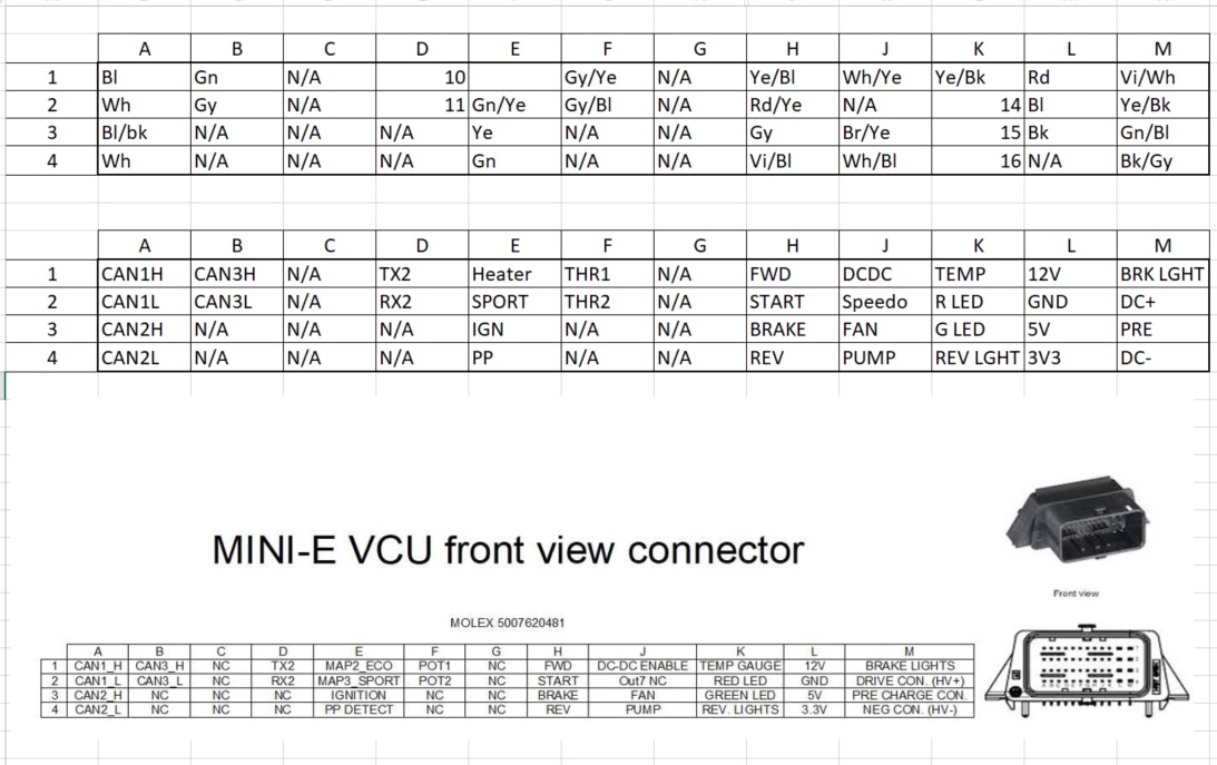

arber333, have you documented your wiring diagrams anywhere? I am currently trying to figure out how to wire up my outlander rear drive unit on the bench and would love to plagiarise it
- Posts: 3276
- Has thanked: 80 times
- Been thanked: 239 times
Re: Mazda MX-3 electric
Sure... lets see... i am still writing detail posting about my contact box... any day now .Scrappyjoe wrote: ↑Mon Feb 05, 2024 11:13 am arber333, have you documented your wiring diagrams anywhere? I am currently trying to figure out how to wire up my outlander rear drive unit on the bench and would love to plagiarise it
See here my connector schematic if it will help in the meantime. I made a quick schematic of my connections to reflect on...
In the meantime i had to chamge some connections because of the startup logic. I had to start inverter and charger logic BEFORE precharge is complete, but DCDC pin 4 (12V signal) i turn on only after everything is ON. I am missing sense pin 7 (permanent 12V) and charger pin 8 (ignition).
I wired heater start pin so it comes on only when ignition is on, as i also need to power the internal fan. I will capture those in my summary.

I decide to connect additional 12S module, 8 in total together.
This last module will live under the rear seats. I cut an underside plate from 5mm Alu which will help fix the module in place and dissipate the heat.
To fix it in place i used 100mm M10 bolts that i fit from the underside and carefully torqued not to damage the module.
BMS module is connected directly in 12S connection and i connect CAN wires to the main strain.
