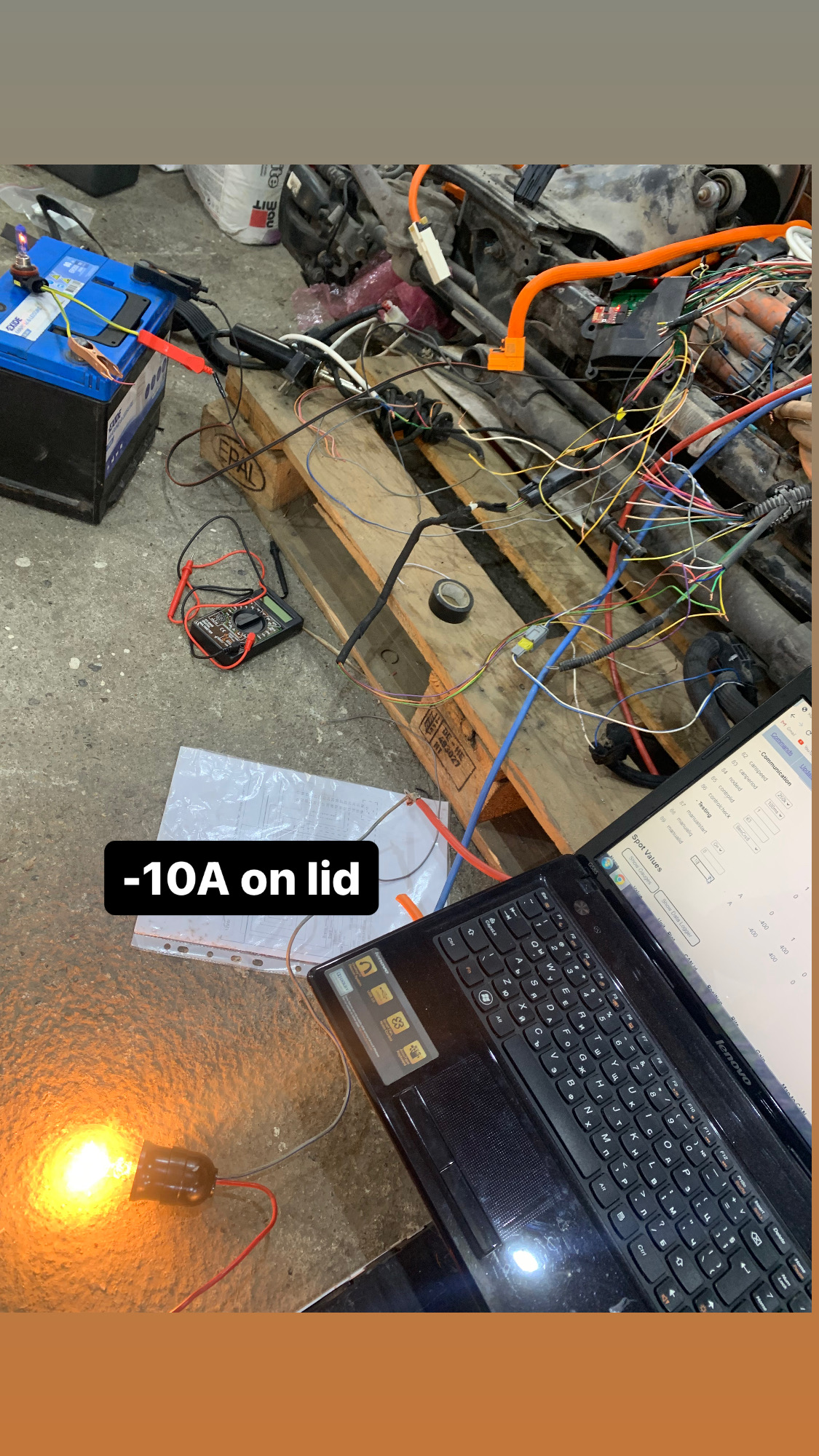

The motor is on a bench PMSM Bosch SMG 180/120 with resolver with Toyota Prius Gen 2 and Openinverter PCB of course!!
3 times watch the Video tutorial for FOC

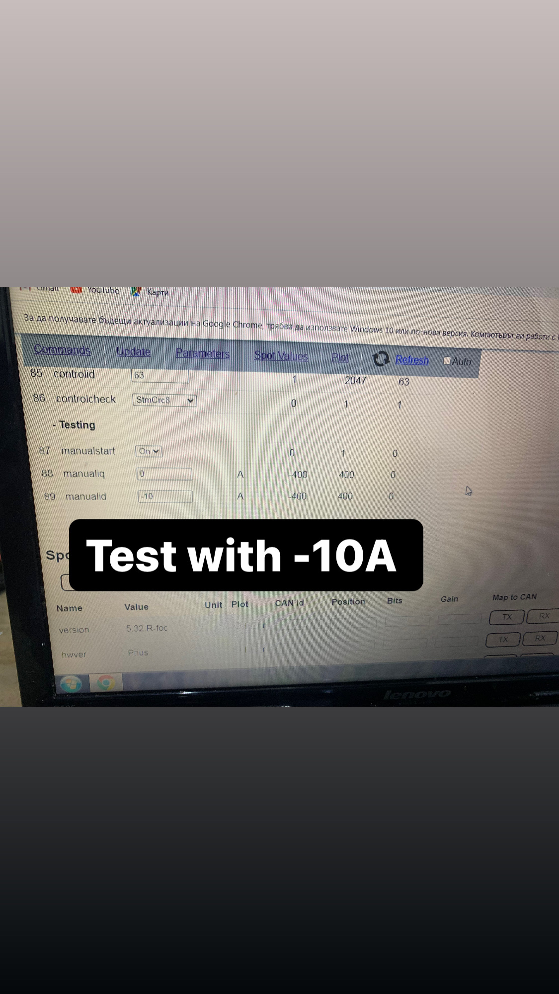

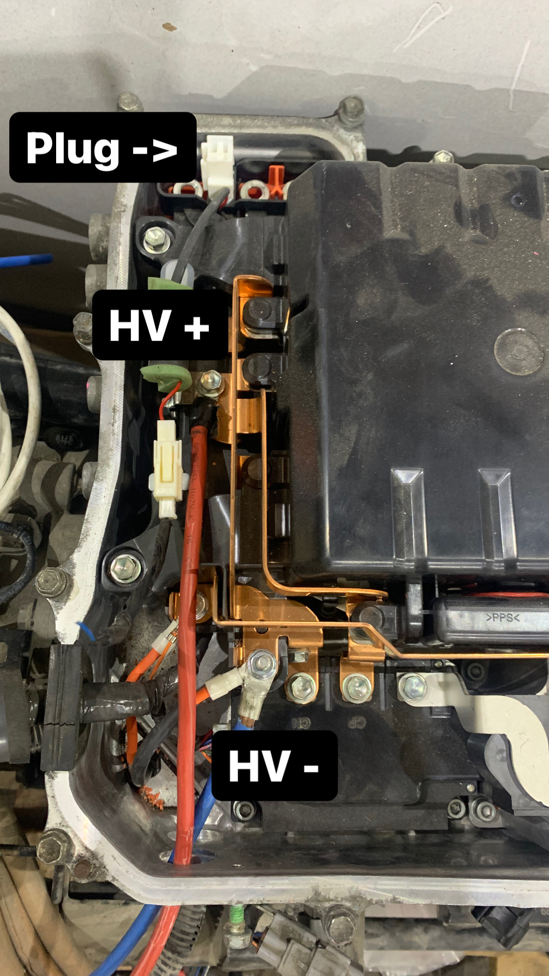

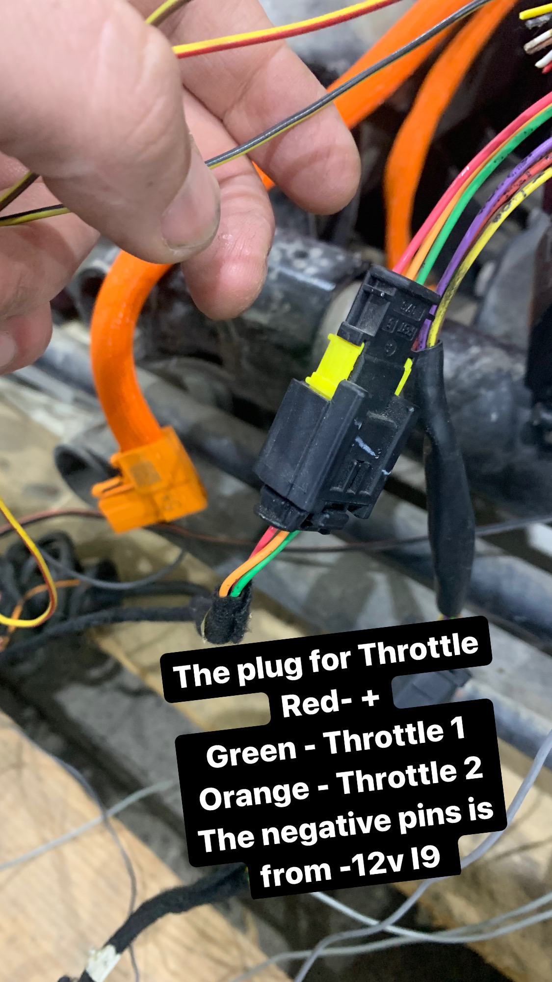

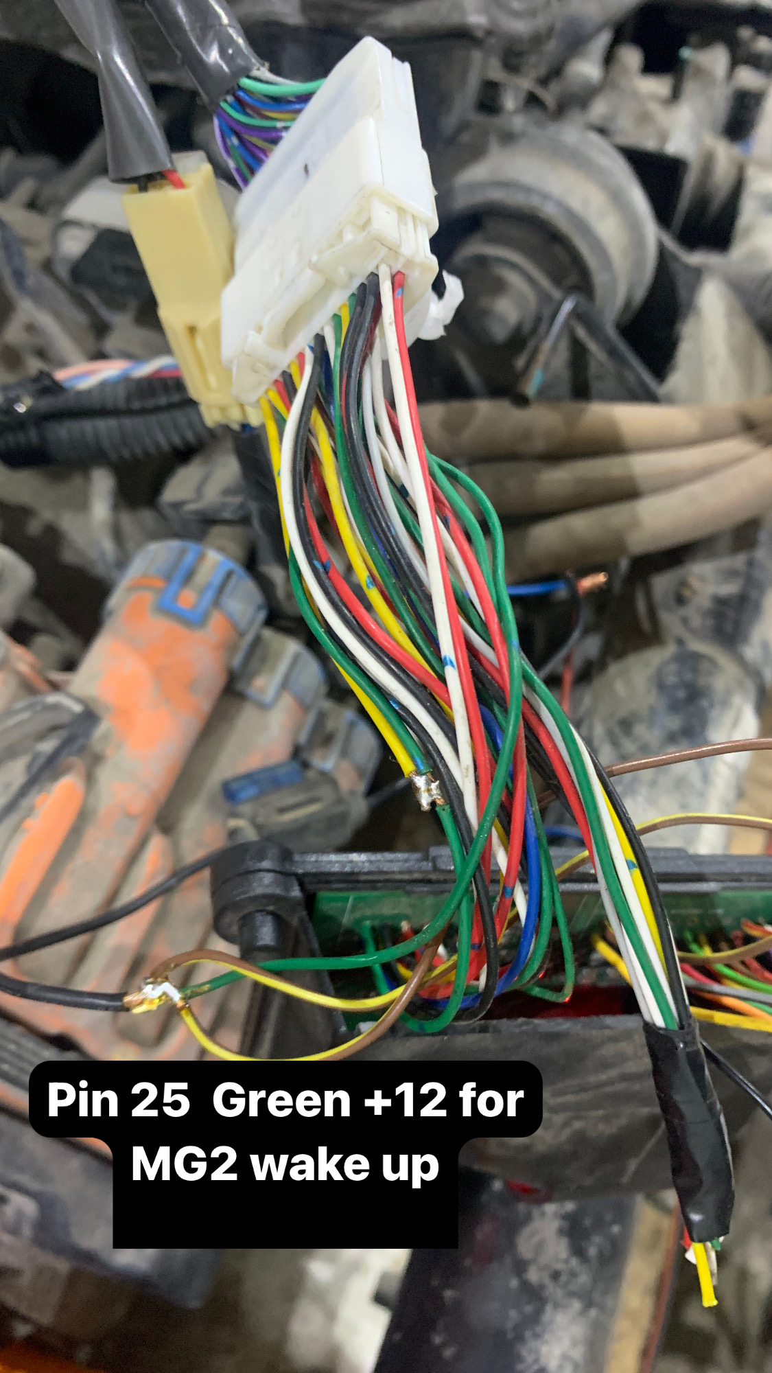

I do everything as a Johannes and D. Maguire said in video, but when try to Test the motor NOTHING, i make a couple of photos how i connect the Motor+Inverter+Controller!

Re: Peugeot Bosch SMG 180/120 with Gen 2 inverter
Nicely documented.
what isn't shown if opmode changes to run. If you did nothing about the PRECHARGE error then it won't. Lower udcsw to 100 and read here https://openinverter.org/wiki/Errors

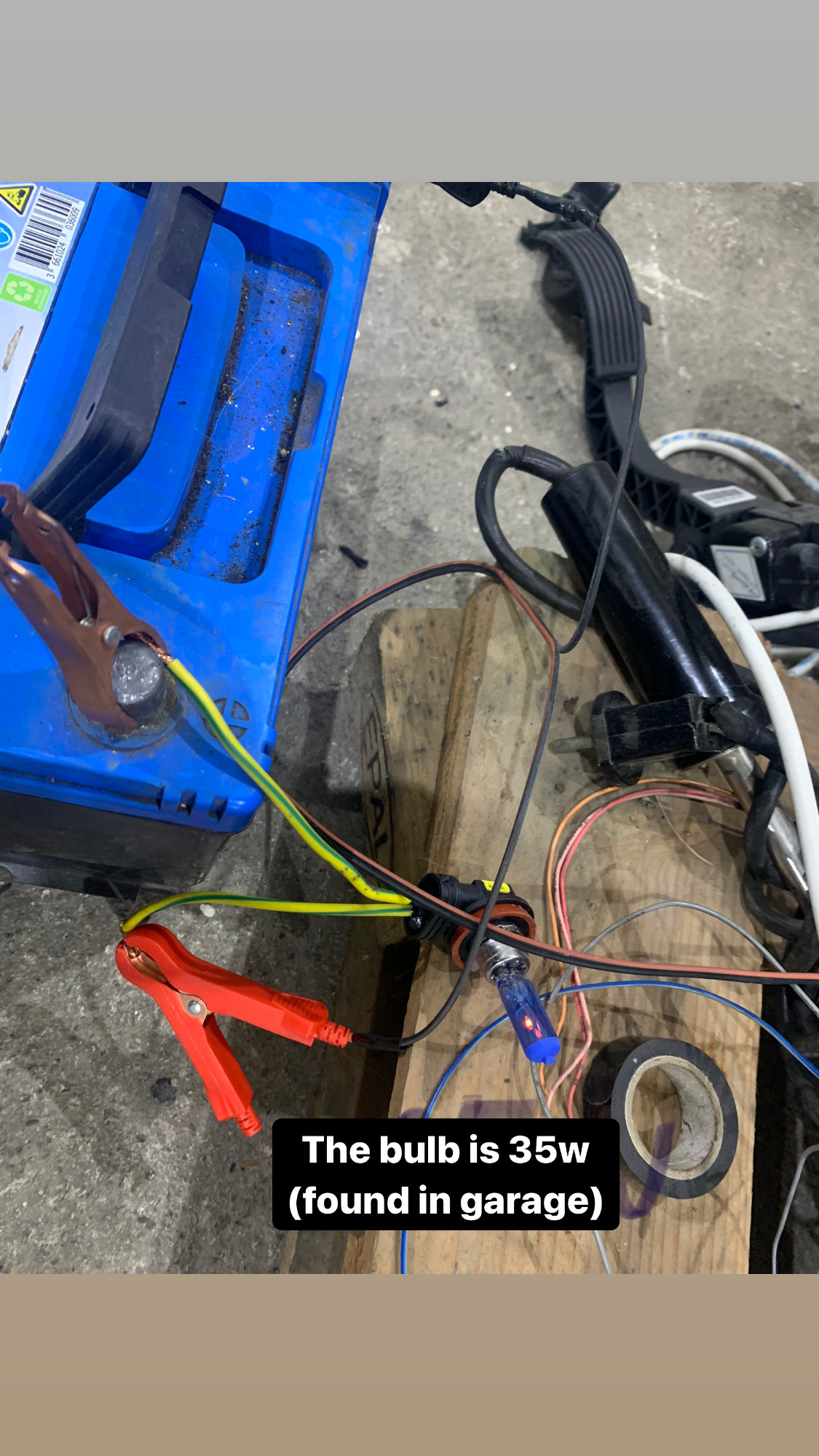

After lower the udcsw to 100v show RUN and the 220v bulb rise up with -10A BUT PRECHARGING stay

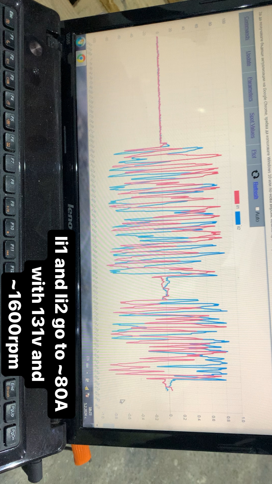

WE DO IT!! change the “respolepairs=6” and “pinswap=7” the motor spin very well.(will upload a video in youtube)
First test:
Voltage 131v
The motor go to ~1600rmp with il1 and il2 to ~80A
131v X 80A = 10 kw ~13hp
Second test:
Votage 198v
The motor go to ~2200 rmp with il1 and il2 to ~24A
198v X 24A = 4.75kw ~ 6.2hp Why why why
when select the direction with +12v on a PCB the Forward spin in reverse and reverse spin forward they are swapped.
Also when remove the direction switch on “reverse” position the motor continue to spin with high rpm and can’t stop only way is to remove the power supply.
The parameters that i need for this rear axle is 200v 100A and 2500 rpm, what i need to calibrate first, now the motor is not load…

To calculate power input use battery current not phase current. From your rpm/Volt figures I would speculate that your syncofs is not quite correct, retarded timing I suspect.

Yes that and you are in dirmode=DefaultForward. Put it to Switch or SwitchReversed then you can switch to neutral by removing forward and reverse.

Ok friends may be now is OK, Test many “syncofs” but finally found may be the correct one. “syncofs=30250” on manualid=10,20,50,100 even 120A does not spin the motor, just a bit vibration, than manualid=0.1 with manualiq= -3 and 3 the motor spin smooth in both side with a bit different RPM, -3A= ~360rpm and 3A=~340rpm. The test with trottle spin in both side on a “switch” mode with +12 power supply, but when release the trottle the motor continue to spin with high RPM in both position. The MAX RPM on ~198v is 1600-1800… I post the 5 min. video with many details.
- Posts: 32
- Joined: Tue Dec 13, 2022 8:13 pm
- Has thanked: 12 times
This morning i do “syncofs=30250+32768=~63030” the motor spin in both side with +-3A, in both side ~2000 rpm, may be the new “syncofs=63030” is the correct one.

Basically the correct one is where the stators "south" lines up with the rotors "north". The other one that also doesn't yield movement lines up the "northes" and "southes". With that field weakening becomes field strengthening. And because it doesn't have the desired effect once the FW point is passed FW current will "latch" on keeping the motor spinning at low torque because of minor misalignment.
With the new you don't have runaway I guess?

With the new i don't have runaway, when release the trottle the motor stop spining in both side, is that mean the “syncofs=63030” is the correct one, also the rotate dir. on my wheels now is correct, Is it ok to use the motor with this “syncofs”
