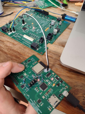

So, to carry this on. I've not got one of Damiens WIP Remote-ESP32-CANLOGGER7500 boards.
I've put https://github.com/Pete9008/esp32-web-interface on there, after burning the efuse
Tested working:
SDCARD
RTC
Unfortunately, it doesn't have the RX TX pins from the ESP32 broken out for easy use, but does have 2 can interfaces and some serial interfaces (RS-485/RS-422) which my OI boards don't have. So next need to bodge these on there.
espefuse.py --port /dev/tty.usbserial-14200 set_flash_voltage 3.3V
SDCARD
RTC

- Posts: 1596
- Has thanked: 75 times
- Been thanked: 306 times
Re: ESP32 Based Web Interface & Data Logger
Done this for now
Going to put your auto tune branch on this board now and test if it gets logging. Still not figured out the current sensors so can't run it on a spinning motor yet.
Looks like he has done that though. When he's back online I'll see if he'll put on github to so I can make some tweaks and send off to JLCPCB for one with fixes on.Going to put your auto tune branch on this board now and test if it gets logging. Still not figured out the current sensors so can't run it on a spinning motor yet.
I've reversed the CT pins before plugging in, so that shouldn't be the problem.
On your branch I've getting invalid JSON back from the json command.
Oops, just remembered on my F405 version I added two lines just before the SD start up, not sure they got pushed to the F103 version (which I'm still running on the prototype hardware so not needed):
These allowed it to run without a pullup on SDIO.D0 which otherwise caused a problem with the bootloader. Might be worth adding them to see if it helps with the SD issues?
//initialise SD card in SDIO mode
gpio_set_direction(GPIO_NUM_2,GPIO_MODE_INPUT); //hardware pull up causes bootload problems so use pullup
gpio_set_pull_mode(GPIO_NUM_2,GPIO_PULLUP_ONLY); //possibly not needed and probably over ridden by driver
//if (SD_MMC.begin("/sdcard", true, false, 40000, 5U)) {
if (SD_MMC.begin()) {
- Posts: 1596
That seems to have done the trick, its mounting every time

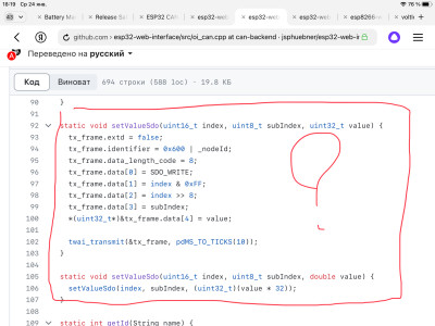

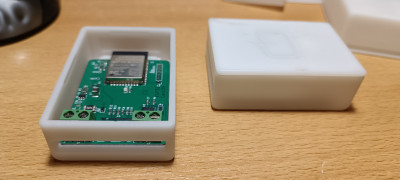

- Posts: 5824
- Has thanked: 162 times
- Been thanked: 1045 times
Got mail.
This is the modified ESP32 CanLite from which I removed the 12V high side drivers and replaced them with an SD-card slot. Also rerouted the pins to be compatible with Petes and Damiens design. As you see it also comes with a nice printed enclosure.
It only communicates via CAN so won't be able to do any real time logging but therefor will be able to talk to all openinverter devices on your bus, provided you took care of your node ids. Node ID is selectable in the web GUI. I have finally merged chrskly's better looking web interface. Only downside it's a bit wide for phones.
https://github.com/jsphuebner/esp32-web-interface
Will put it in the shop soon.
When composing a sketch, it returns an error. Maybe I don't understand something. Please enlighten me)))
- Posts: 5824
It must be something with the compiler version, it doesn't seem to understand the overloading.
Can you try to compile with platformio? Arduino I haven't tried.
In the description on the git hub, you posted instructions for arduino) I'll try it on the Platformio…

On other news I tested the device on my very busy Touran CAN bus and that wasn't very good. As soon as it starts transmitting the CAN bus is disturbed, i.e. ABS light comes on and other indicators. Even a permanent airbag fault developed. Maybe it doesn't properly back off when loosing arbitration?
- Posts: 1596
I get the same can message corruption on my ESP32 based BMS, the messages have CRC though so I can junk rubbish messages but yea, lost confidence in ESP32 for can projects.
