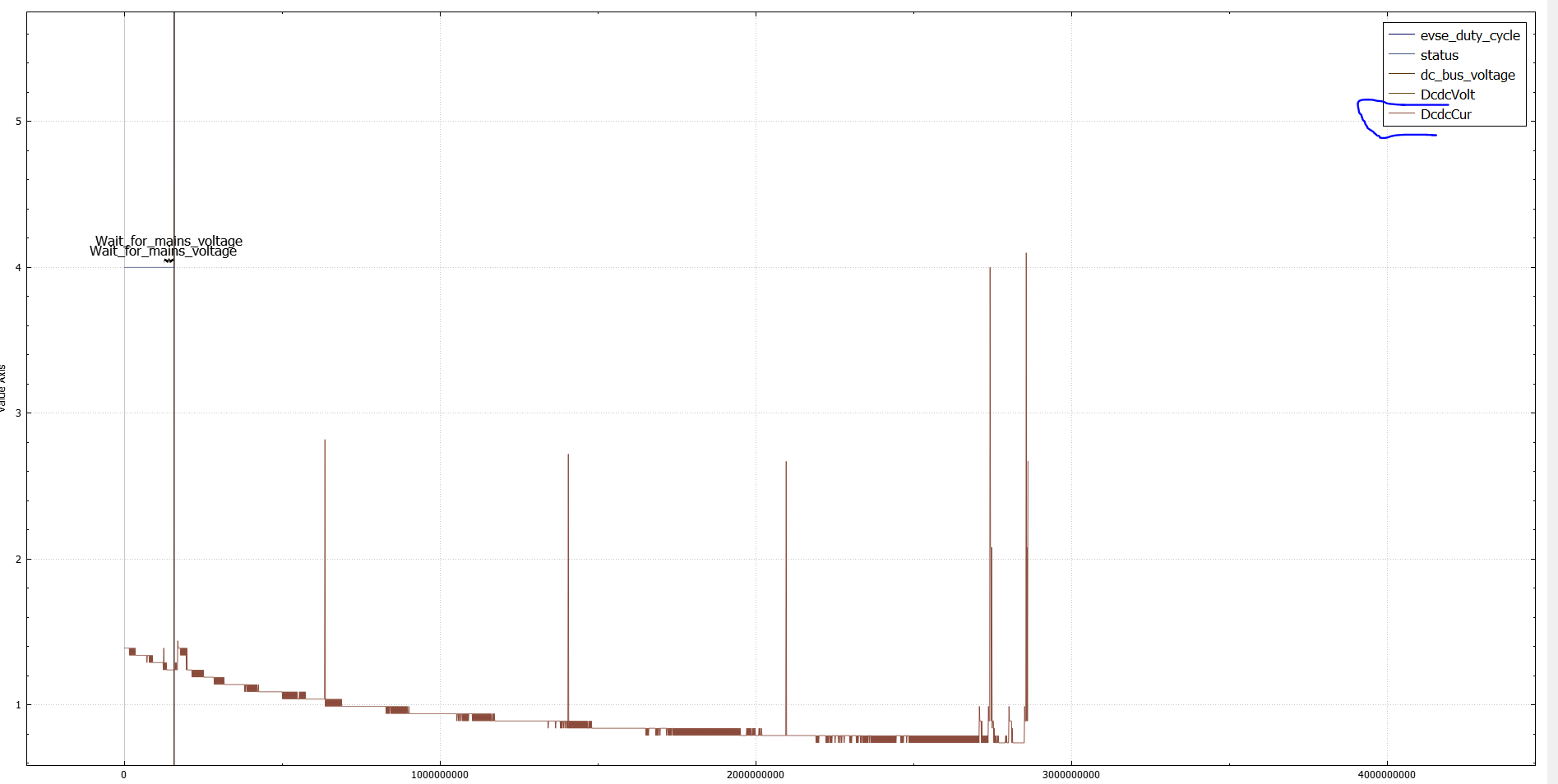

The plot thickens!
First I want to thank you guys for your help and support with this but I think the charger is OK and not the problem.
Today I started a charge and a CAN Dump with SavvyCan, around 20 minutes later I climbed into the car and tried something which caused the car to cut out a couple of days ago while driving. I turned on the headlights.
Immediately I heard what sounded like the clunk of a contactor and the charge stopped, the coolant pump briefly changed tone but then went back to normal, I didn't see the change in low voltage but if a contactor was turned off briefly then this makes sense .
I tried turning the headlights off and on again to see what would happen but nothing so this is intermittent.
I have attached the CAN Dump anyway but I think I'm looking for a stray voltage, a poor ground or a bad connection.

Contactors are opening
You can see the voltage suddenly jumps to the max, the charger errors out.VW Beetle 2003

Your DCDC seems to be fine, you clearly have some very dodgy wiring/12V power faults.

Yes, agree 100% with you guys, thanks for showing what is happening.

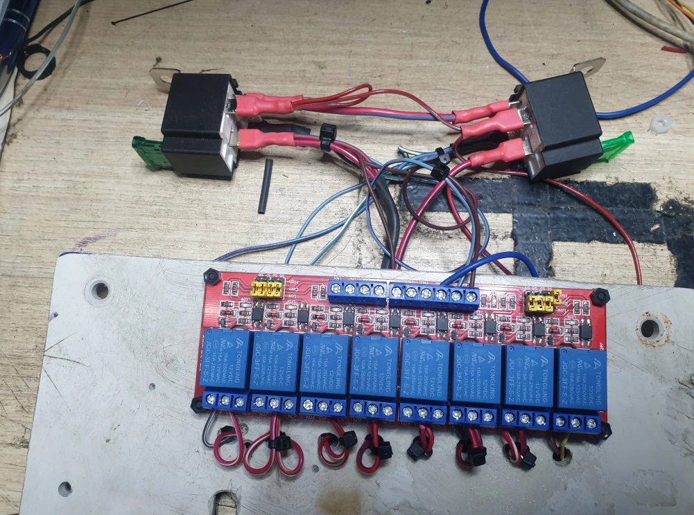

Funny you should mention PodPoint as I tried to charge there and it didn't work, when I get the cutting out issue sorted I'll look again at this thanks.Bigpie wrote: ↑Tue Jan 16, 2024 2:01 pm Your 0x285 message looks funky as too, but it seems to work. Wiki suggests the 3rd byte should be 0xB6 to pull the EVSE into the correct state. Yours is 0xAA. Not sure if this is a full log, but some public EVSEs wont work if you skips state B and jump straight to C. The Pod Points at Tesco for example
Talking about cutting out I discovered something big today.
I wanted to see which contactor was dropping when I turned on the lights, and today it happened every time whether I was charging or not.
I only needed to wait for a few minutes after turning the car on if I turned on the lights it happened.
So I put a meter across the neg contactor and a second across the pos then turned on the lights and discovered it is the pos contactor dropping. The thing is it's not coming back on as I thought. This confused me for a bit as the dc to dc was still operating and I still had 14V which was why I presumed it was bouncing off and on.
Turns out the precharge relay is still active and was keeping HV to the dc/dc through the precharge resistor and a very light cable.
I think that's another thing to change.

I was about to say
"It looks like the issue is a faulty contactor."
I put a meter across the 12V supply for the positive contactor and when I turn on the headlights the contactor opens and stays open even though the 12V to it doesn't change."
However it wasn't quite as simple as this.
I used a different multimeter to watch the voltage and noticed it flicker a tiny bit so decided to try changing the supply source for the contactor from the ignition switch to direct to the battery and this helped to the point where I thought I had it sorted. I was about to put the lids back on when I did one last flash of the headlights and it failed again.
So after this I tried flashing the lights with the contactor already stuck open and noticed a faint sound of a relay clicking so I new something else was going on.
I got my daughter to mess with the lights while I watched what was happening and It turned out that the timer module I am using to drive the positive contactor (from the switched neg supplied by the VCU) didn't like the fact I had several other devices using it's positive wire and when I flashed the lights the relay was sometimes flicking off. The thing is it was so briefly it caused the contactor to open and lock open.
So after more time running individual wires to the various devices involved I tested it again and couldn't get it to fail. I'll try again tomorrow but hopefully the issue is resolved but even better it may have resolved my cutting out problem while driving.
Once again a huge thank you for the help in tracking down this issue. I don't know for sure if it is resolved yet but at least I think I know where the problem is.

You could try running contactor from negative side. Supply 12V from ignition directly from ignition and use timer relay to bring GND to contactor. Maybe GND is more stable...

I'd consider binning off the timer relays, just use the VCU directly to do the pre-charge sequence. Timed pre-charge isn't the best method, if precharge fails, blown resistor for example, then boom, it'll just switch on the main contactor regardless

That's a great suggestion, however I'm using the neg output from the VCU to power the timer relay. I tried connecting the VCU directly to the contactor and it didn't work. I think the VCU didn't like seeing the 12V pos from the other side of the relay coils. How do you guys use the neg outputs from a VCU to drive contactors?
The timer relay is there for two reasons. The reason above (ie how to drive a contactor from a VCU) plus it's a kind of fail safe.
A few months ago I had the timer relay turned down to 0 seconds but I believe the VCU had hung with the post precharge outputs active (the VCU would hang sometimes if I had the laptop connected to it while it was in the car) so when I turned on the ignition it activated the pos contactor immediately and blew a 300A fuse. I spent a while going through what had happened and double checked the connections and this was the only answer I could come up with. My VCU is the one Damien made specifically for the Gen1 Leaf inverter. There are not many here are using it so I don't know if others have found wee quirks with it.
The other thing I considered was putting a capacitor across the power connectors of the timer module but I don't know how big it would need to be to make a difference. Is this worth considering?

First i would advise you to make a latching relay circuit. The fact you are using timed relay to power your contactor can be tricky.
I allways want to have ability to latch contactor so that no mattery what VCU does HV wont be an issue.
You can do this by using two automotive SP relays (or single multipole) and wire them to receive power from ignition side with trigger pulse from timed relay. That way you will have control to unlatch the pair simply by removing ignition. This would be a stop gap measure to use the car interim until fuse block come...

I have also connected it through a latching relay as suggested by Arber333.
And the car has not cut out while driving either so I guess the two issues were caused by the same fault.
The latching relay is being triggered by the timer module but is held closed by 12V directly from the ignition switch so even if the timer module glitches it will not cause the positive contactor to drop out.
