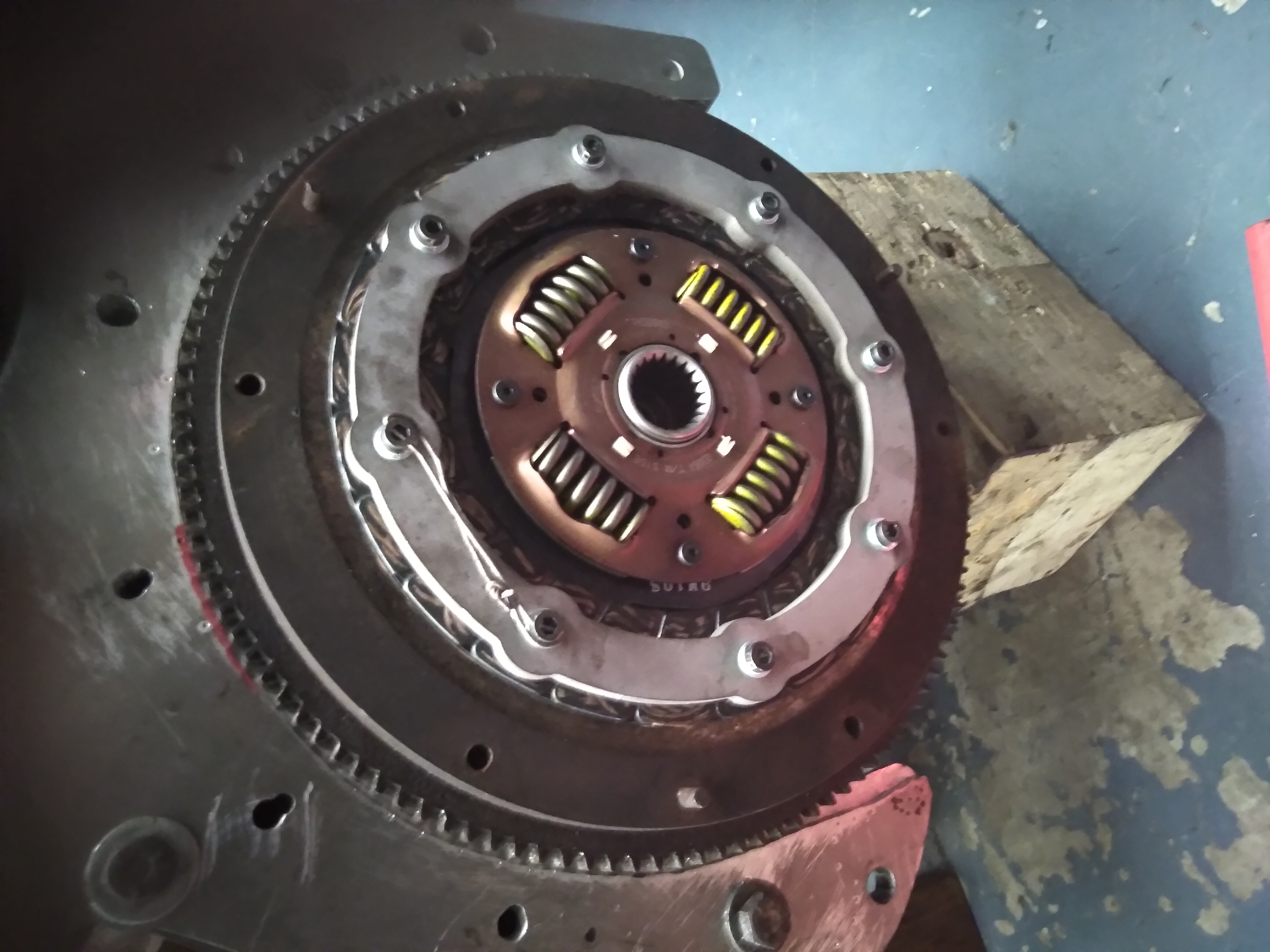

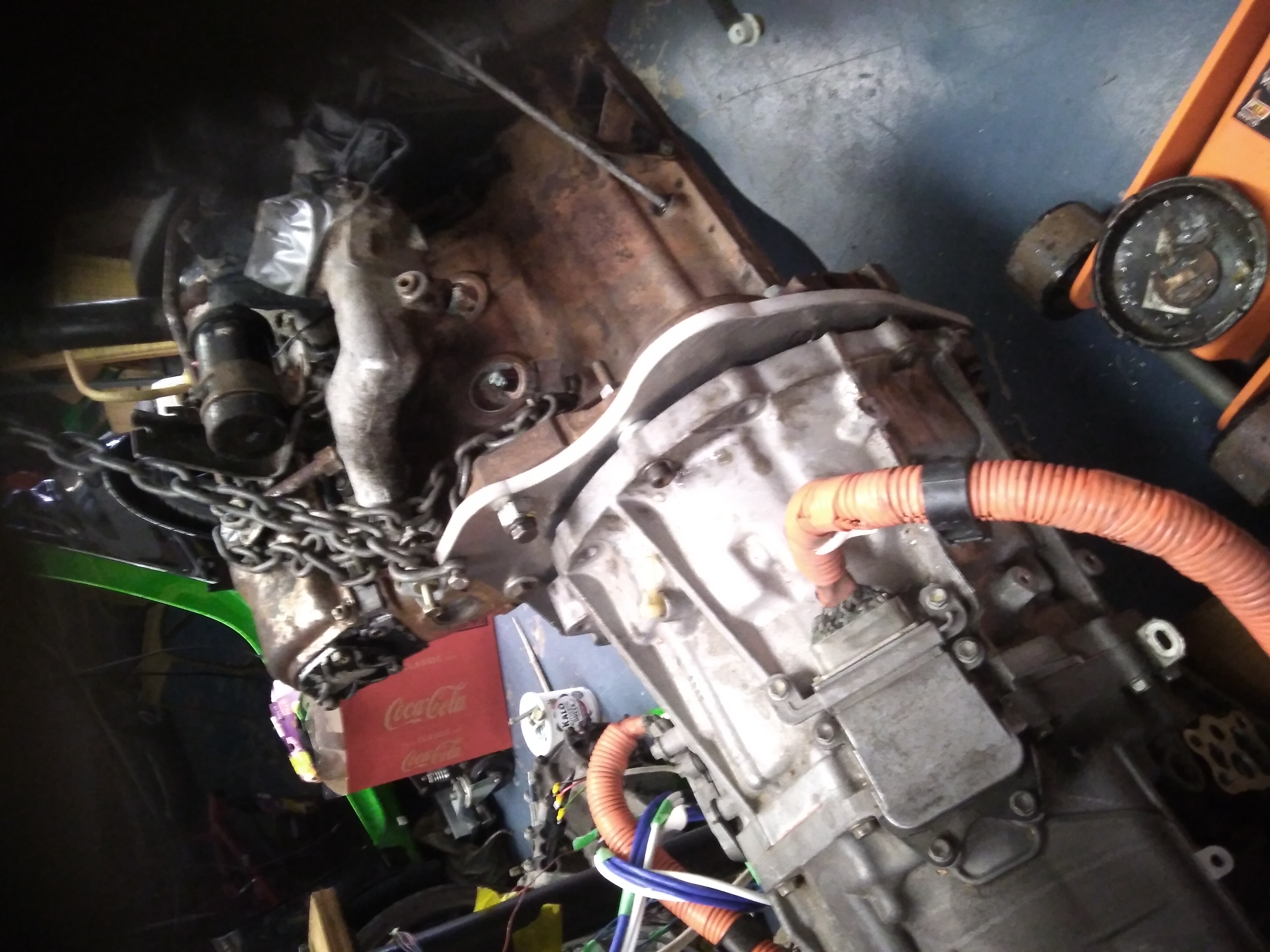

With regard to experimenting with this, have had bench set ups with a separate torque control input for MG1, and another for MG2..
Then progressed to applying an input ICE to the splined shaft. The ICE speed is selected and set with a potentiometer to say 1500rpm,
This is independent of MG2 being at stand still or turning to drive the vehicle.
The rotating ICE is then supplied fuel, at this stage LPG injected in the inlet to stoichiometric ratio, and throttled to over speed the MG1 set speed. This then tries to lift MG1s speed, and has the effect of it becoming a generator, and power returning to the Hv bus, to be used by MG2, or returned to the Battery..
Basically a range extender...
Some limited test runs in a Bedford Campervan have been successful in maintaining battery Soc for short distance driving..

Yes, tested on the bench/floor, with MG2 locked with parking pawl, initially with manual control of torque request, and engine throttle/Lpg fuel adjusted to give 6 to 8 kw charge to battery.
Next was installed in the van, and test run on a circuit, to have MG2 as traction, and MG1 providing a charge of 6kw, as MG2 was going through accelln, flat running or deceleration. A few promising runs done , the aim is to get a feel of how well this can maintain, when out on the road.. Have operated a Toyota Coaster series hybrid Electric bus, modified to Phev in this way and was satisfactory, so aim is to emulate similar behavior.
Owing to a ph storage fail, have only a few rescued snips and pics. Am seeing if can recover from some which had shared, and will put these up, along with new pictures.
