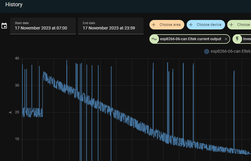

Re: Communicate and control Eltek Flatpack 2 HE
I have the unit set to limit its voltage to 48V for my batteriesTomHC wrote: ↑Mon Aug 28, 2023 8:53 am BTW, anyone interested in Home Assistant /ESPhome control of Flatpack2, here's the code - https://github.com/taHC81/Eltek-Flatpack2-ESPhome
It successsful tails off the charge power as it reaches its target voltage, but then gives it full throttle every few minutes
Ive edited your code only to amend the serial number and it logs in frequently and changes set voltage, but i still seem to have full throttle applied regularily
I note from your github page:
Any thoughts how i can prevent it disconnecting?note that PSU is reverting to the default voltage with no current limit while the communication is lost
