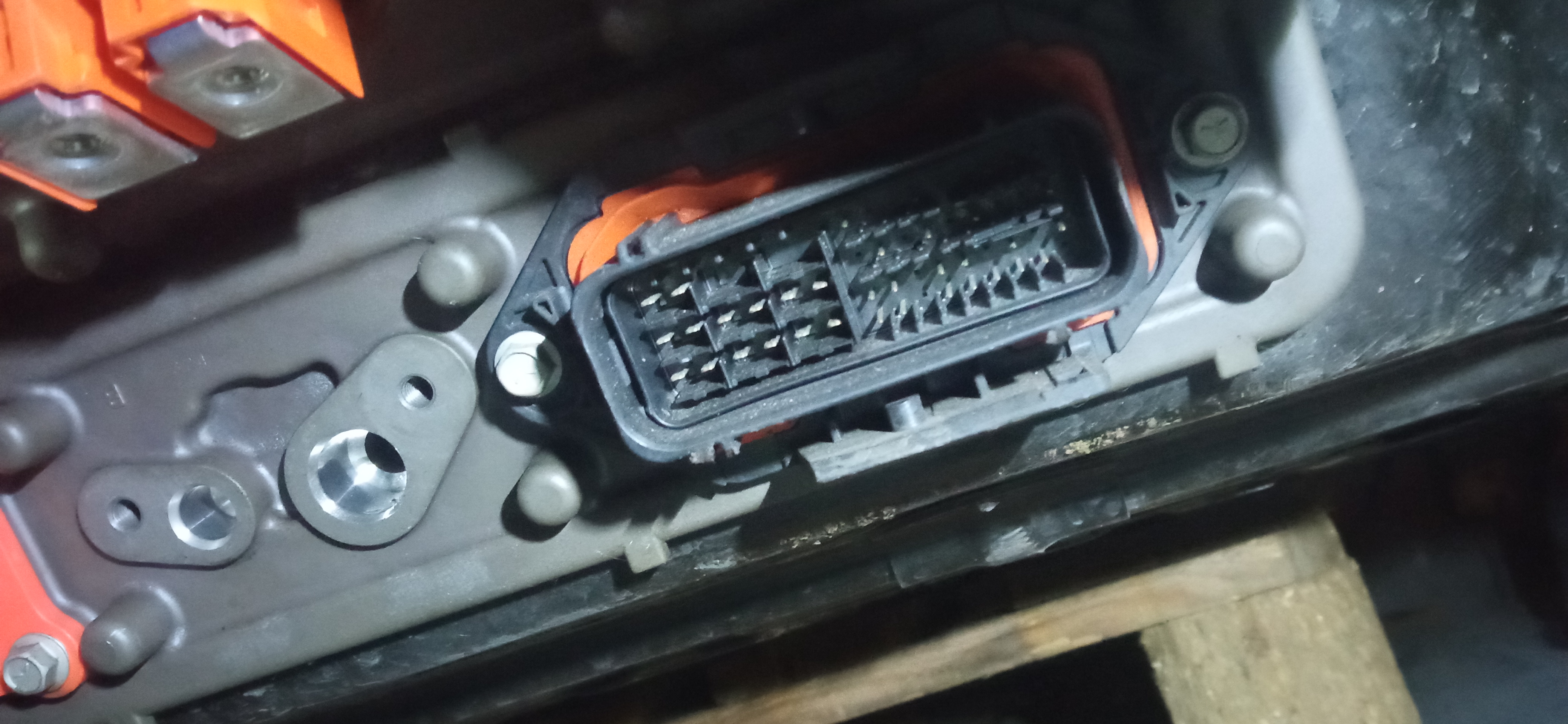

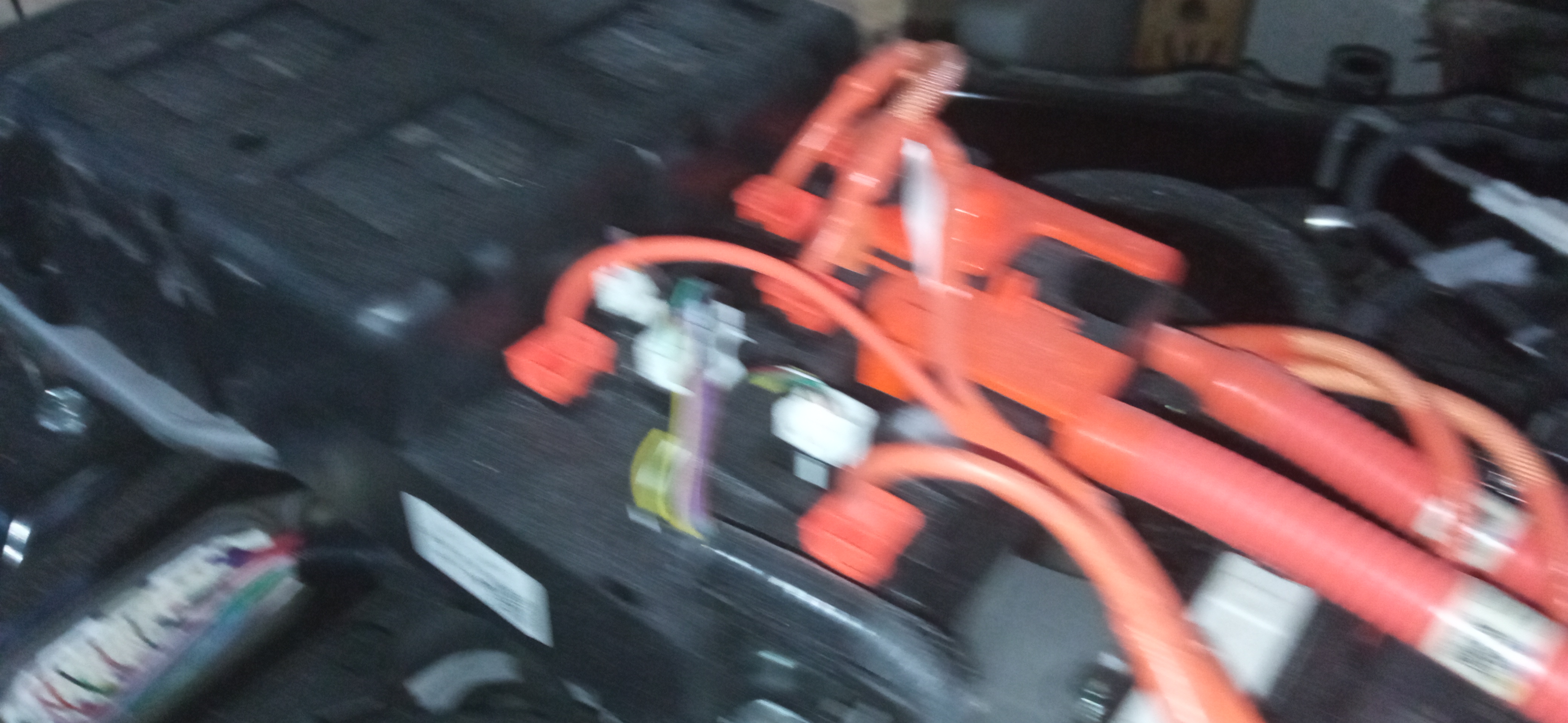

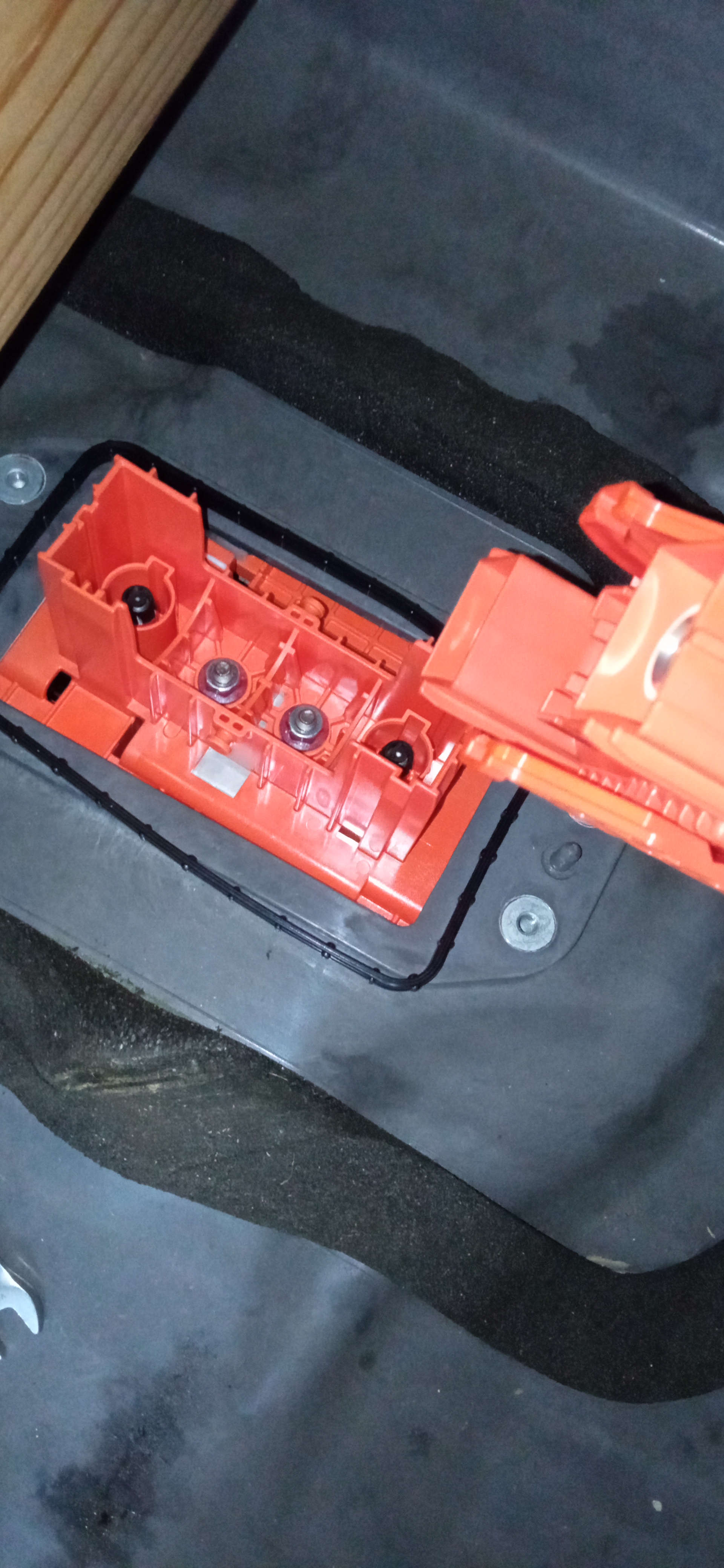

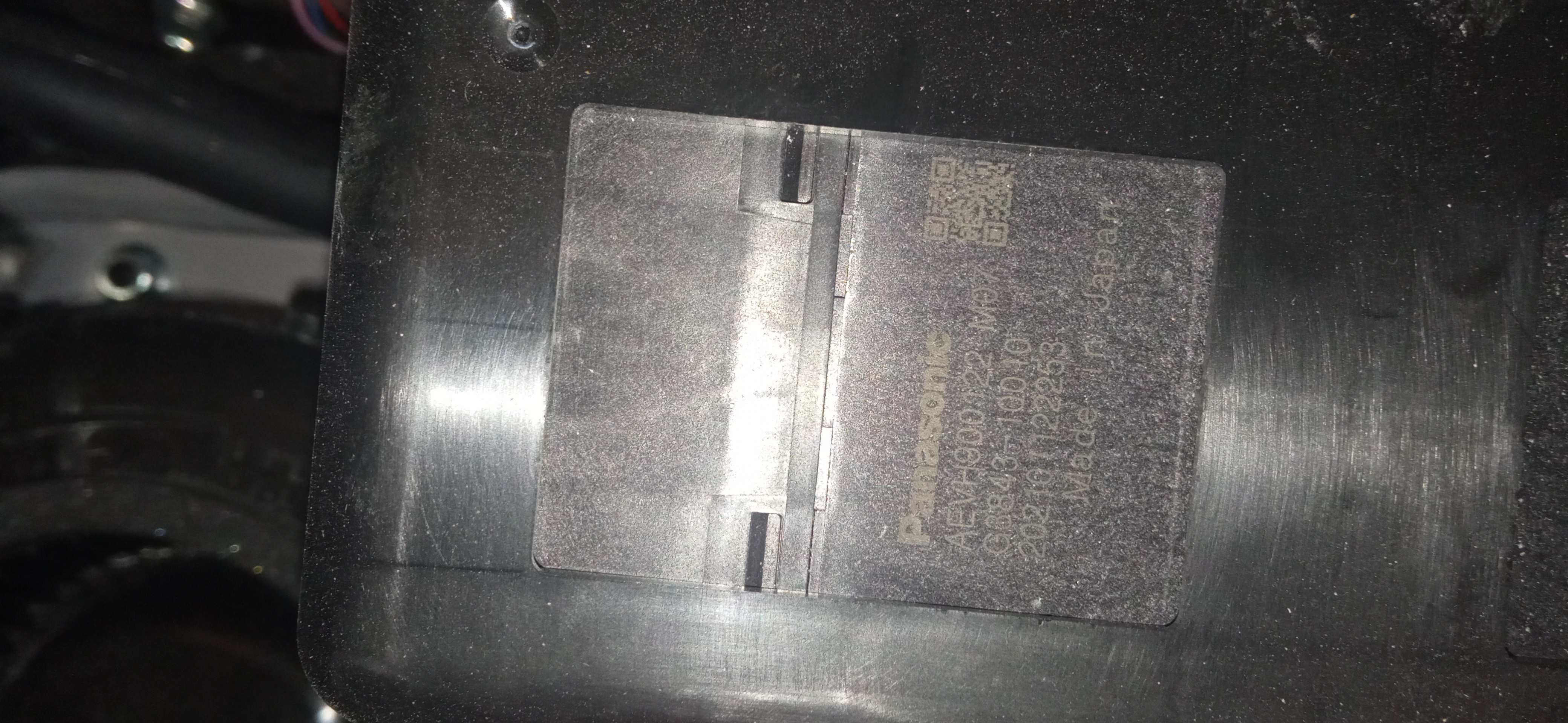

Pre the locating of an I3 REX , which is to be picked up tomorrow, a Honda 5Kw generator is working okay driving 15A into an Evse charging lead..
This allows charging through the charge port, and suitable when not moving.
Previously on another Hv vehicle, had rectified the 240v, and added a number of 24v meanwell supplies on top, and was charging direct to the battery, at around 10A, which could be run whilst on the run.
Am hoping the I3 REX is capable of more, once method to control it is established. If it is resolver indexed, will use a prius gen3 inverter for starting, and request neg torque to enable charging...

So yesterday I picked up a 54kwh pack from a Lexus UX300E for £900! (thanks BigPie for the heads up!)
It's much mess capacity then I was hoping for but it's a start and I'll add either a similar pack in parallel OR a pack with the same cells in series in the future.
The top was fibreglass and given I can't lift 500kg myself, I had to dismantle it from within my campervan. Once all the bolts around the edge were removed I used and angle grinder to take the top case off as I couldn't manoeuvre the pack to get the lid off in one piece myself.
Here are some pics....

It's got 8 modules of 27 cells (9s3p) and 3 modules of 24 (8s3p)
Its air cooled and has all the cooling infrastructure inside it.
It also has 8 contactors inside, I've not worked out what they all do yet. It's a centralised BMS.
