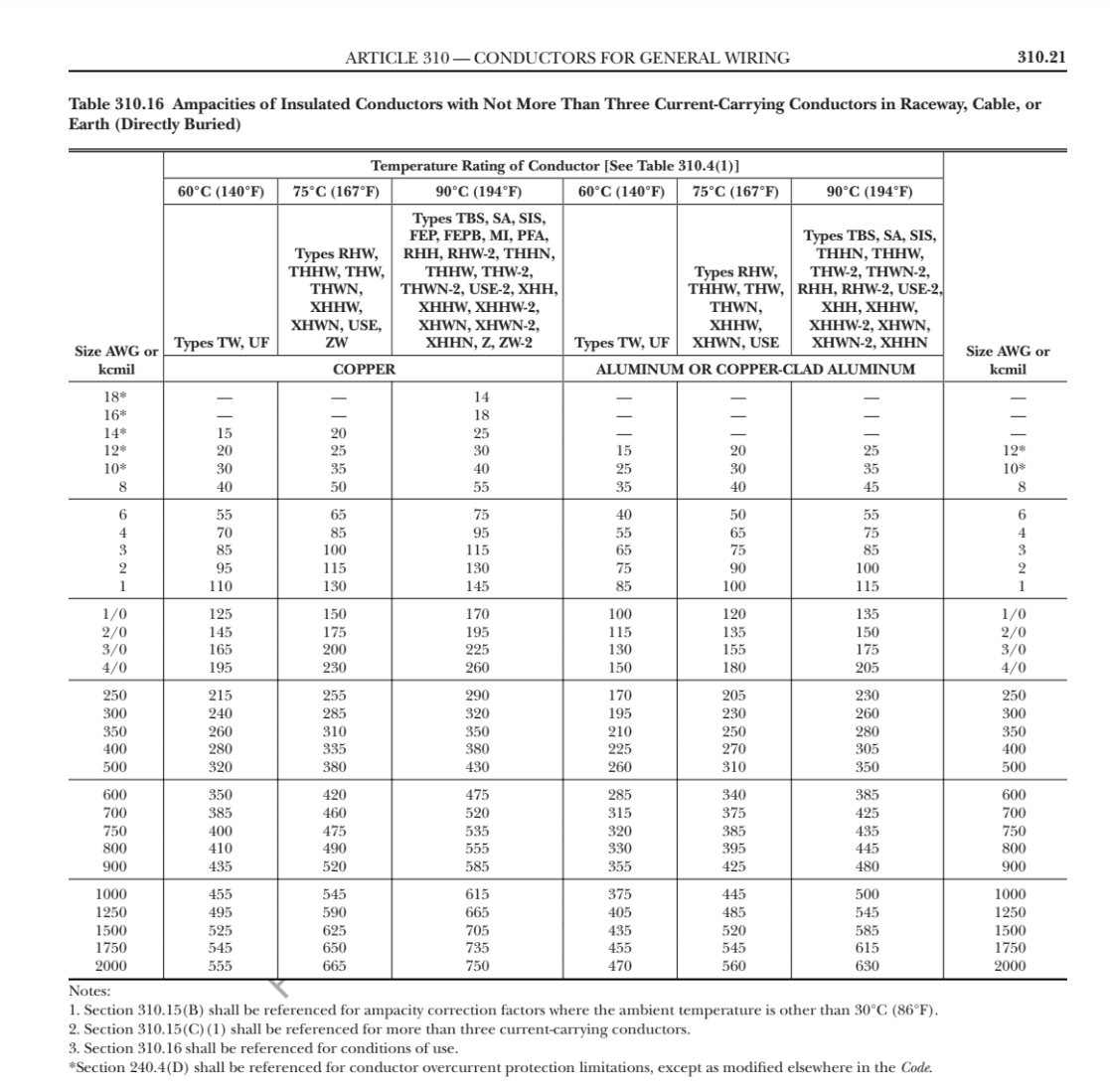

Guys,
I ran into the situation that the Model S 100D I got as a donor, have 3 different gauges 1/0 for the R-SDU, 2/0 for the HVJB in the front and 3/0 for the charger. Since most level 2 chargers only output 50 amps and I'm not planning to use superchargers, I was wondering if I can downgrade to awg # 8 that will hold good up to 55 amps. What you guys think?
Gen 3 Charger Cables gauge too BIG?
