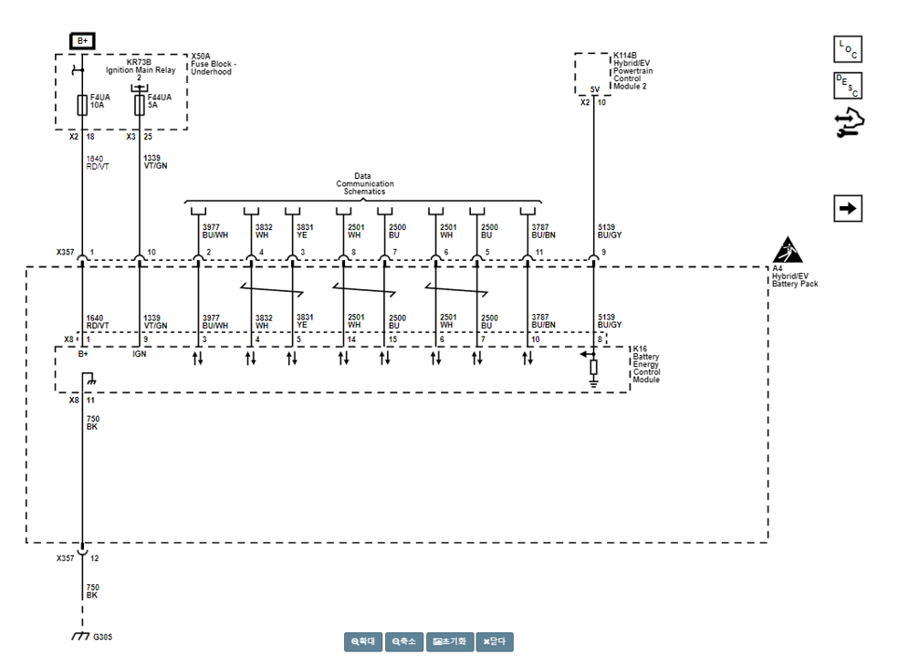

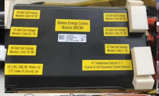

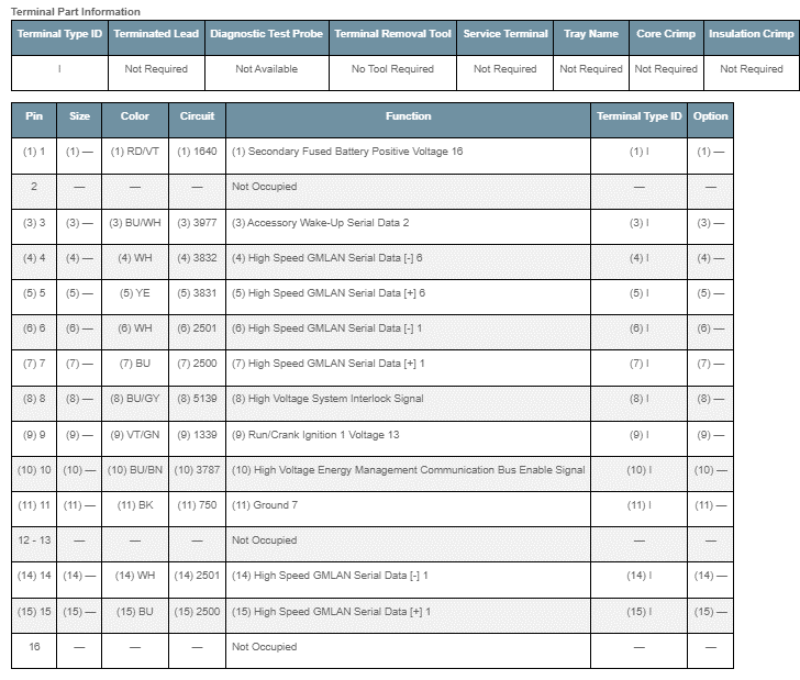

I would like to connect to CAN Communications and obtain information on 96 cells. Is it possible to obtain information by simply connecting CAN_H and CAN_L to K16-X8 connectors 4/5 or 14/15?
I wonder if I need to put in a different power source. If I need to put it in, what pin number and how many volts should I put in?
