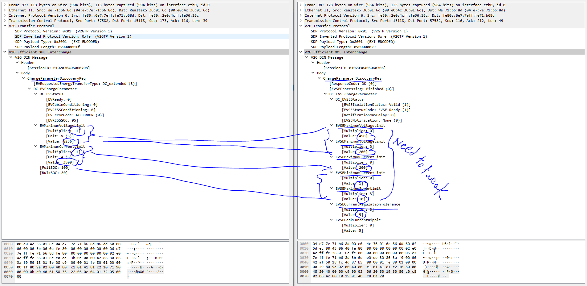

Edit: Had a look to the EV6 trace. What I see so far:
- It announces a max voltage of 825.6 volts. Ok, it is a 800V car. And 350A max current. Impressive.
- After the charge parameter exchange, it says directly PowerDeliveryRequest with "ReadyToChargeState": "0", this means it says: I do not want to be charged by this charger. That's why it does not even try the cable check and precharge phase. Afterwards it stops the session.
The question is, why it is not happy with the exchanged charge parameters. Maybe the announced power limit of 10kW looks too bad. Or something else, difficult to guess.
Edit 2: Could you check, whether you have the latest version of OpenV2Gx, including https://github.com/uhi22/OpenV2Gx/commi ... 0ea65211a9? I do not see valid units in your ChargeParameterDiscoveryRes, but this should have been fixed in August this year, and discussed here: https://github.com/SmartEVSE/SmartEVSE- ... 1666218352

Thank you for your detailed explanation and spending time to go over the messages. I think you're correct on the kia side, I noticed some of those fields in the req/resp and the resp had values which may need to be tweaked to something higher. Also I'll update my v2g code. How do I update the code to send out a higher response than 450 volts in the response. I couldn't find it in any configuration so I'm thinking it's somewhere in the code. Appreciate you taking the time to go over and respond. Any idea where I could find values that should be changed to reflect this vehicle or should I just increase the numbers accordingly for voltage, current, power and see if the car responds with the cable che check req/resp etc.
Thx again. May need to do dive into your code and understand better.

The values of the ChargeParameterResponse are not configurable at the moment. They are hardcoded here: https://github.com/uhi22/OpenV2Gx/blob/ ... ce.c#L1304
So you could try to change some of these values, re-compile the OpenV2Gx, and test whether this makes a difference.

uhi22 wrote: Fri Sep 22, 2023 12:39 pm The values of the ChargeParameterResponse are not configurable at the moment. They are hardcoded here: https://github.com/uhi22/OpenV2Gx/blob/ ... ce.c#L1304
That makes sense - I did a param by param comparison for the EV6 and will try and tweak these values to match up or advertise a bit higher than what the vehicle has advertised on its side... if you have any recommendations of values based on your experience or expertise it would be greatly appreciated. Also what does the multiplier of 0 and -1 mean? In the req I see most of these as -1 while the response had either 0 or 3 (for power)? I will also update my v3g code seems I am having a version prior to the Aug updates..

The multiplier means "Exponent to the base of ten". E.g. if value is 8000 and multiplier is -1, this means physically 800.

Hyundai/Kia HV vehicles run at 450V when dealing with “low voltage” chargers (typically 500v max). If charge parameter discovery response EVSE max voltage is below 450v, you’ll very likely fail out. Newer model S and X are ~450v as well, so your likely faulting out for the same reason for both vehicles.
I suggest hard coding a 500v evse max voltage for now.
