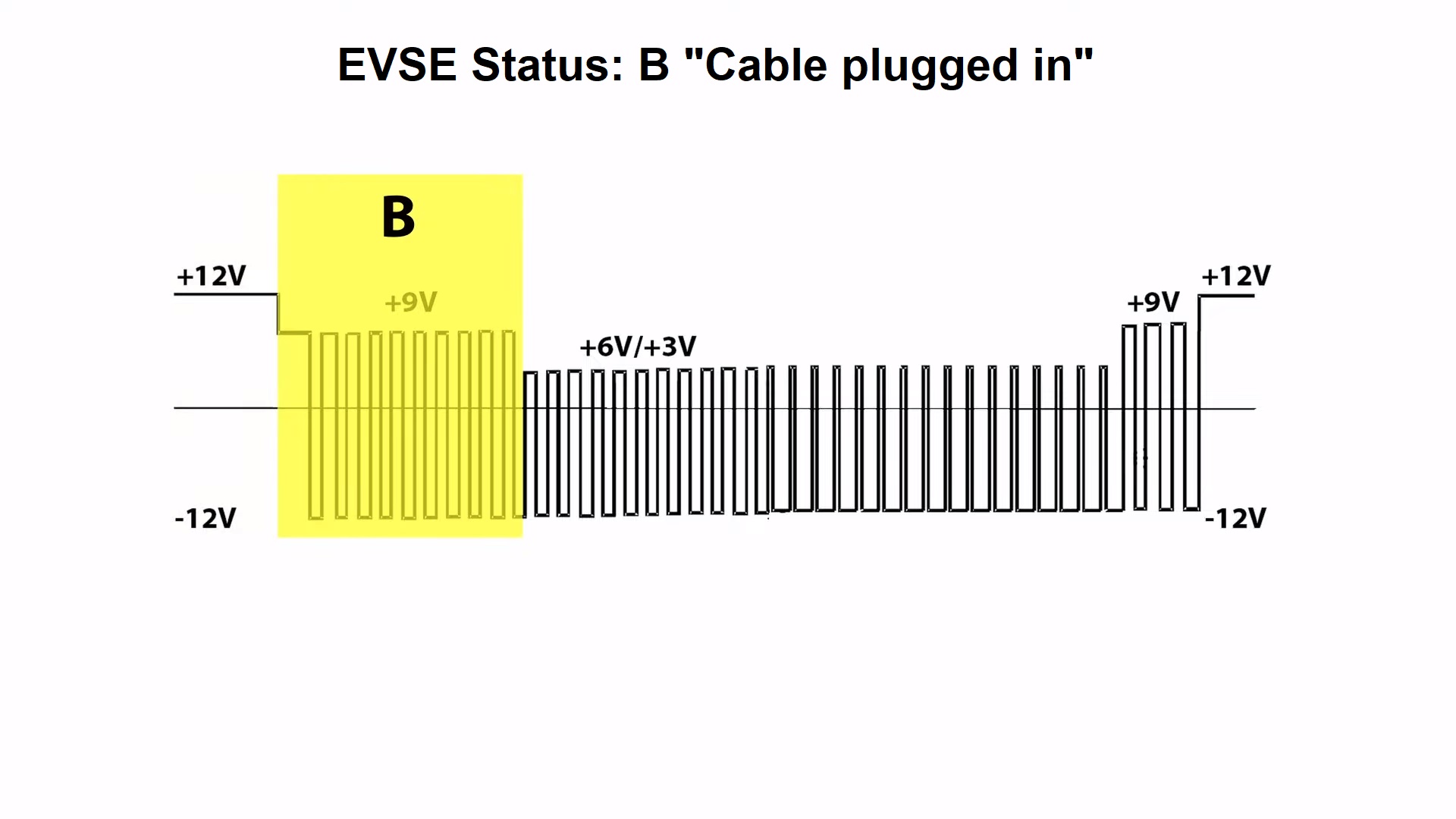

How does AC (smart) charging actually work? PWM explained!

Re: How does AC (smart) charging actually work? PWM explained!
https://en.wikipedia.org/wiki/SAE_J1772 This has all the bits you are covering listed per topic.
