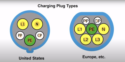

Video Takeaways With Direct Links Back To The Video
Two Different Types of Charging Plugs

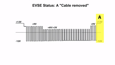

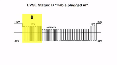

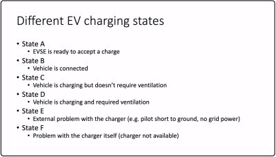

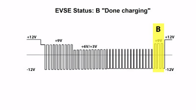

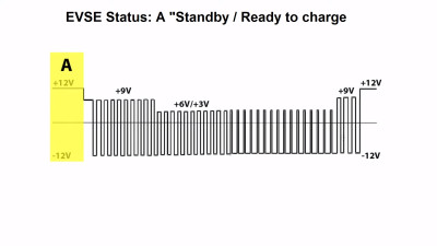

The EVSE Can Show One Of Six Different States / or Statuseses
EVSE Status: A, B, C, D, E, F

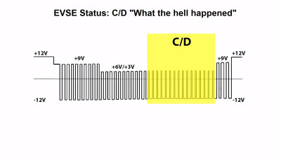

Status C/D
C = Charging
D = in the old days of lead acid batteries meant Charging with Ventilation

How can we detect that an ac or dc charger is plugged?
Gregski wrote: Wed Oct 04, 2023 2:32 pm very detailed explanation if you want to test your inner Geek
Posts: 1326
Location: Bristol
Has thanked: 106 times
Been thanked: 226 times
Re: How does AC (smart) charging actually work? PWM explained!
DC chargers go into 5% duty cycle, thus requesting digital communications instead of PWM.
uhi22
Posts: 639
Location: Ingolstadt/Germany
Has thanked: 93 times
Been thanked: 425 times
Post by uhi22 »
Yes, and AC chargers have two possibilities: Either use a higher PWM ratio, which defines the allowed current, or apply 5% and announce in the high level communication (IP, TCP, V2GTP, EXI) during the negotiation of the charge parameters that they support AC.
