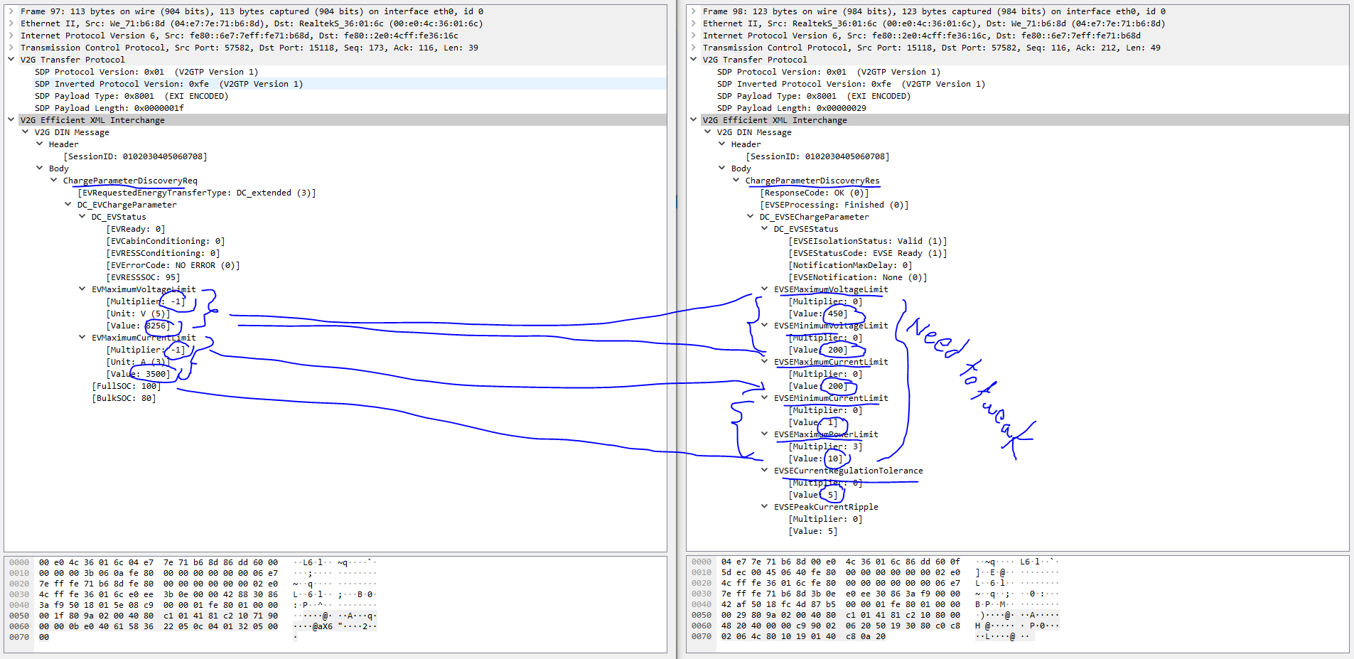

The values of the ChargeParameterResponse are not configurable at the moment. They are hardcoded here: https://github.com/uhi22/OpenV2Gx/blob/ ... ce.c#L1304
So you could try to change some of these values, re-compile the OpenV2Gx, and test whether this makes a difference.
That makes sense - I did a param by param comparison for the EV6 and will try and tweak these values to match up or advertise a bit higher than what the vehicle has advertised on its side... if you have any recommendations of values based on your experience or expertise it would be greatly appreciated. Also what does the multiplier of 0 and -1 mean? In the req I see most of these as -1 while the response had either 0 or 3 (for power)? I will also update my v3g code seems I am having a version prior to the Aug updates..uhi22 wrote: ↑Fri Sep 22, 2023 12:39 pm The values of the ChargeParameterResponse are not configurable at the moment. They are hardcoded here: https://github.com/uhi22/OpenV2Gx/blob/ ... ce.c#L1304

The multiplier means "Exponent to the base of ten". E.g. if value is 8000 and multiplier is -1, this means physically 800.

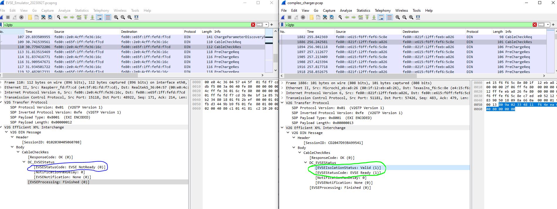

Hi all - I tried the above suggestions - updated my params etc but no luck yet So for now I am focusing on one car Chevy Bolt (where I am still stuck at the CableCheckResp and the PEV stops sending anything and then times out).

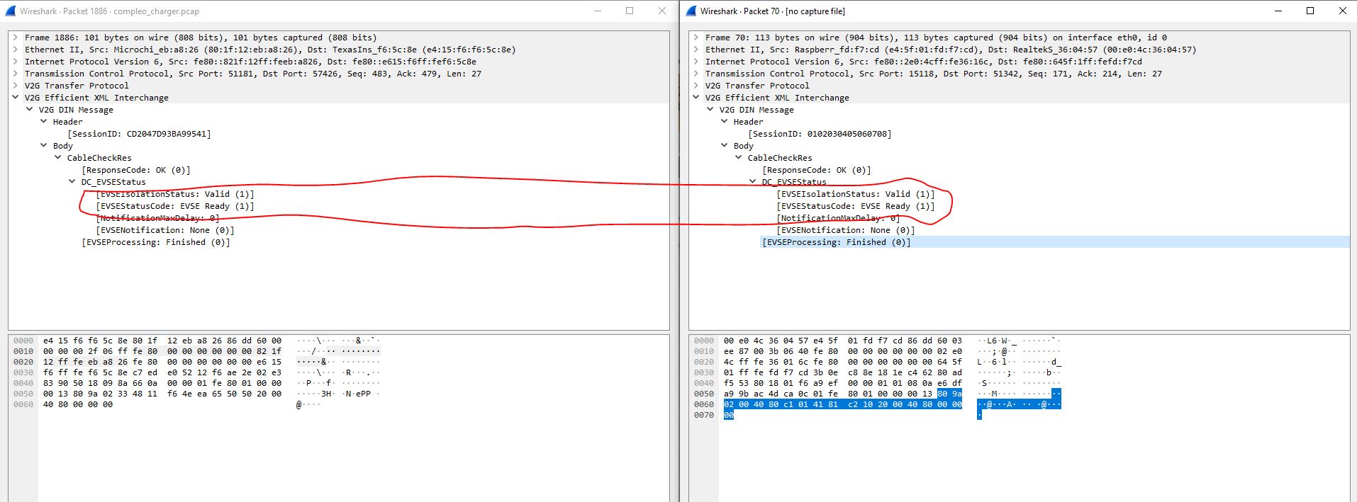

As I was going over the req/resp messages between I see in the CableCheckResp the EVSE sends from a real charger trace uploaded on the forum - and some params looked different so I am changing them in the OpenV2Gx codebase @uhi22 has (thx I've now migrated to the latest codebase and see some of the errors in units etc updated - not that it helped in my case )
Here's the diff in traces for the response: based on the param diff I thought of updating the code as follows (added the right elements in the structs to keep the code happy and build) But still I don't see any difference when I run it and the response field is still showing the same values as EVSEStatusCode: EVSE NotReady
Do I need to change anything on pyPlc side to have the message encode something differently? or just changing on OpenV2Gx side in encoding the response allow me to change it - because somehow something else seems to be overriding the values...
Any help/insight is appreciated. I want to try and match the response to an actual charger and see if it tricks the car to move to the next step which is preCharge and hopefully close contactors etc..

No, nothing to change on pyPLC side, the encode function creates the stream and nothing overwrites it. The code looks ok for me. Did you compile it before use? And did you compile it in the path where pyPLC searches it? (Sorry, stupid questions, but no better idea at the moment )

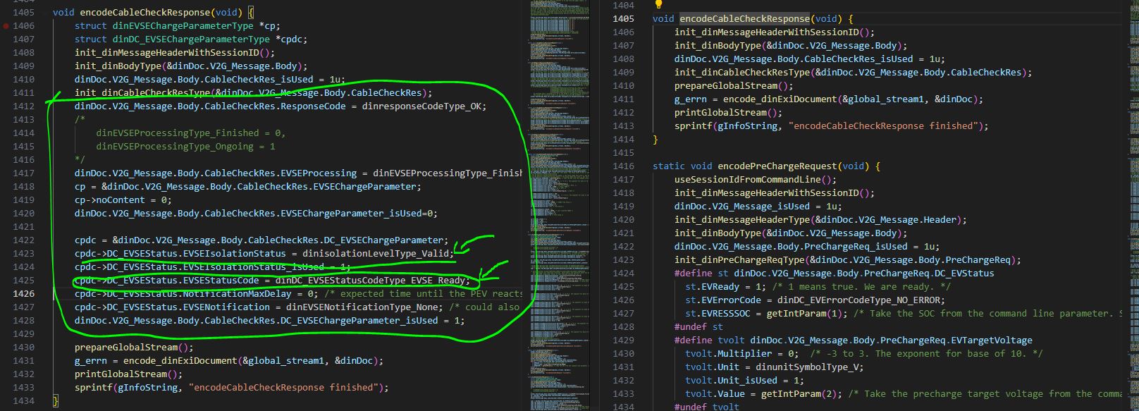

I found the issue - I was trying to add info elements under the wrong struct. Looking at the trace more closely figured out it was under another structure. I've done the changes and do see the IE and correct values matching a real charger CableCheckResp message. Will attempt to connect with my Bolt next week and if it works will send out the appropriate changes. Thx again for your help. Will also try to see if I can match up other responses to be more in-line with real charger fields and attribute values.uhi22 wrote: ↑Thu Sep 28, 2023 5:43 am No, nothing to change on pyPLC side, the encode function creates the stream and nothing overwrites it. The code looks ok for me. Did you compile it before use? And did you compile it in the path where pyPLC searches it? (Sorry, stupid questions, but no better idea at the moment )
I updated the code in Openv2gx related to the encoding of CableCheckRes to match the real charger and the the Chevy Bolt was able to transition to the PreChargeReq/PreChargeRes state. I see the pyPLC calculating the EV Present Voltage based on the target sent in the Req and the logic seems to be working correctly plus the messages compare almost identically to ones see in real charger traces. But after a minute or so the PEV side times out and sends a SessionStopReq to the EVSE side. Please see attached trace for more details. I am not sure if the car is checking the voltage and/or current on the DC terminals prior to moving the PowerDeliverReq/PowerDeliveryRes state. Any thoughts or insights welcome.

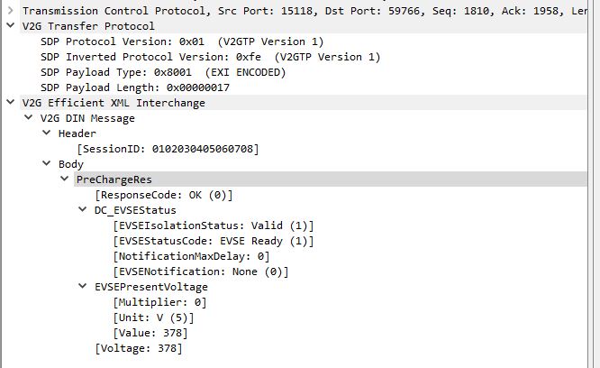

I was able to finally get a charge (fake) session going with the Chevy Bolt using the pyPLC EVSESim (did some changes to messages and attributes to match up real charger traces. Also the EV expects to see voltage and current at the terminals once the preCharge is complete. So I put a small DC voltage/current gen and was able to trick the car to close contactors. Once it went thru it kept the contactors closed for 50 sec before sending the sessionStop (as it didn't sense the expected voltage/current as promised )
Please find the trace attached showing this successful run.. any suggestions/feedback is appreciated or ideas how to keep the contactors closed for longer.
