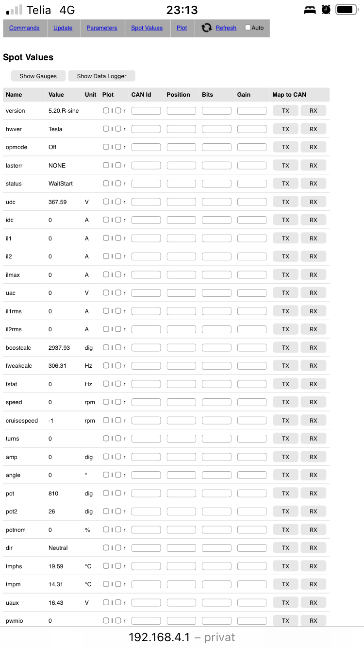

Last week only 50 met after starting driving home from work, car on charge during the day (375v ish 15 deg celcius) during acceleration it suddenly loses power, It felt like it got into ICE ’limp home’ mode annother 100met before there is practically zero power. Come to a standstill and test cycle off on and try forward or rewerse a couple of times but car have almost zero power and jitters/ jumps. Turning car off for a minute and cycle on again and then car feels ok again. Trying to drive home again car works approx 1km before same thing happens again. This time stopped in a bad place on road I got little worried and just keeep throttle 100% after cycle on off dont give any power at all the car suddenly gives 100% power in 1-2 sek bursts and this gives me oppertunity to reach a parking at side of road.
Checking parameters, I can test that inverter changes from neutral to forward and throttle values on 0% and 100%. At that time I give up and got help towed back home 10km.. Well back home I can start car and drive it back into my garage.

I think it must be the temp derating. Check your cooling works ok and raise tmphsmax to 110°C.

I will change and raise value, but car and coolant was low temp since charging only was active until lunchtime so it only indicated 20 ish degrees celcius (I have installed an watercoolant guage) The highiest indicated temp have been 42 deg celsius after a longer drive for approx 30km the day before…

Johannes was spot on!
Waterpump not flowing enough or have given up and tempsensor far away from inverter fooled me. Indicated 24 deg celcius on guage is much more deg in inverter. Long but gentle driving and first full pull day after then charger heating water and inspired drive from start lead not to limp home but overcurrent and inverter shut down. Testdrive tonight lead to annother overcurrent when I did a 50% throttle pull so inverter have got beaten up for sure But first a better coolantpump is needed. Look at inverter temp…omg

Very good. Nissan Leaf pump perhaps?
Also just noticed tmphs can't reach 110°C so more like 95°C should be the maximum
