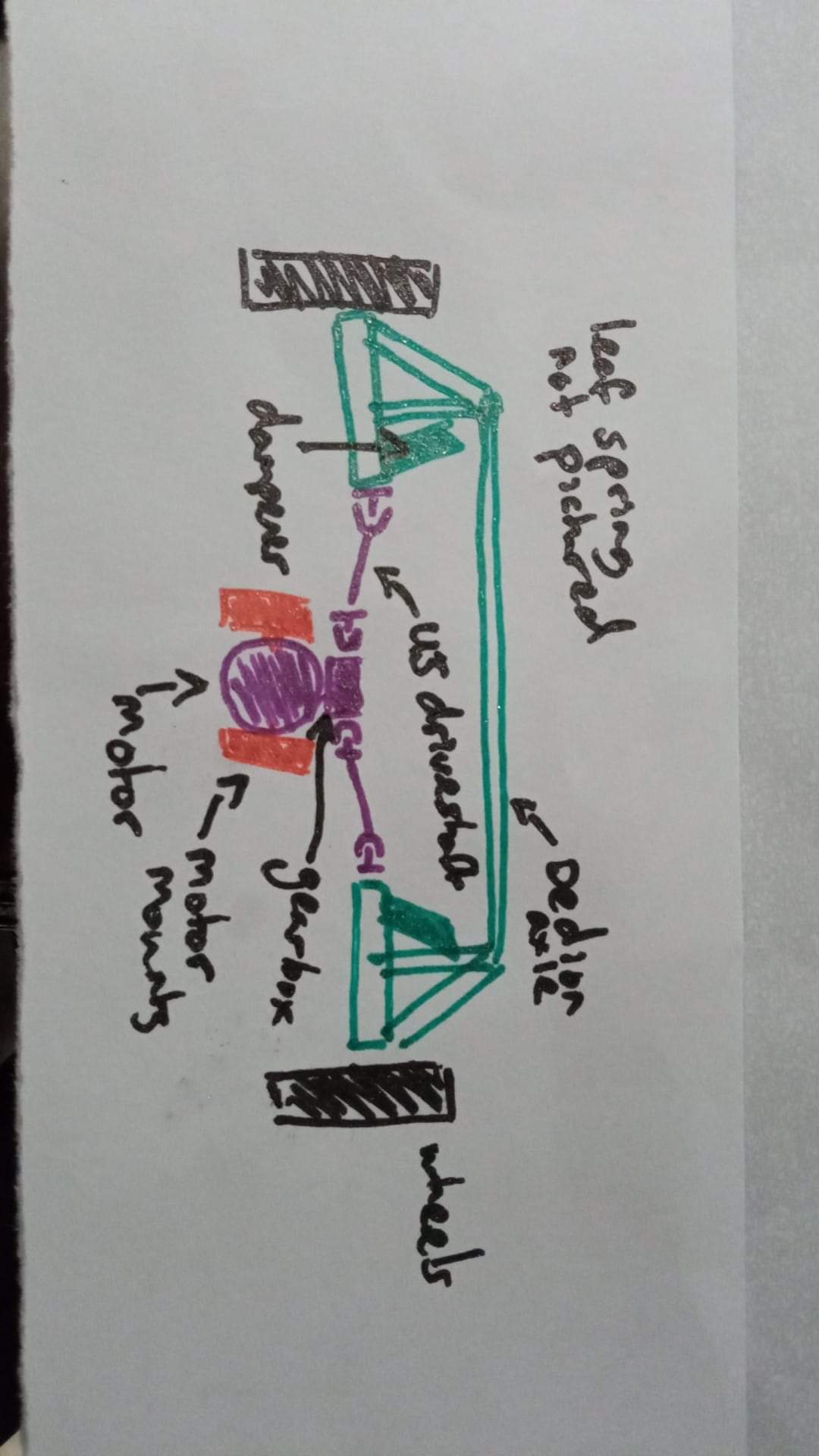

TLDR; has anyone modified their rear axle to be a de Dion axle in the UK and what legal implications did it have?
In planning my conversion I'm considering modifying my rear axle in order to use a transaxle setup (likely a leaf).
My vehicle is a large van and given size and lack of aerodynamics I really think going for the most efficient approach would be the best approach.
My plan is to buy an identical solid rear axle to what I already have, weld on a U-shape for the de Dion, cut the diff out from the axle and then add disc brakes in place of the original drums (potentially adding air assist bags to the leaf spring setup also).
The motor would then mount at the back in place of the diff, using modified drive shafts and CV joint to connect to the wheels, with half the drive shaft housed in the axle on bearings.

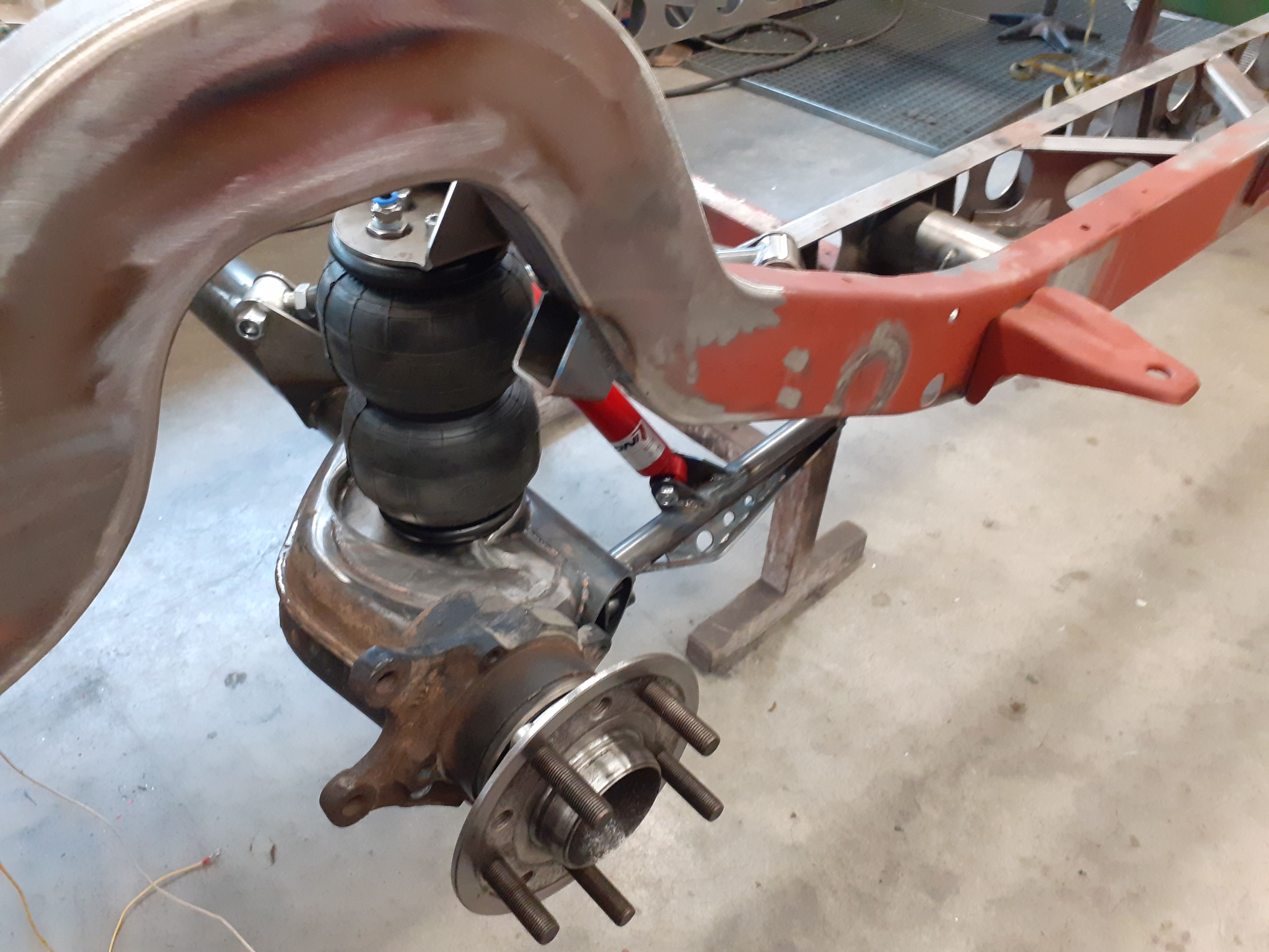

I don't know anything about UK regulations, but I can imagine that you have better chances if you fit parts from another car. One possibility would be the axis of an Opel Diplomat!
I personally made a De Dion axle out of Mercedes trailing arms for my car. I also use the Mercedes brakes and drive shafts.

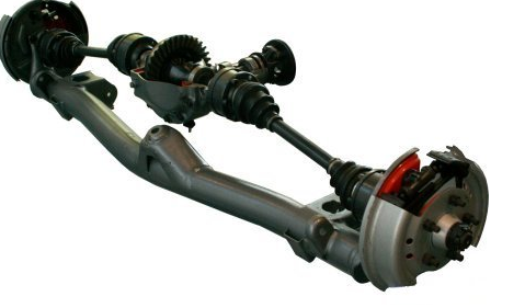

Mercedes is easy to find.
https://www.ebay.de/itm/285397074812?ep ... R6COzZy7Yg
I think cutting up a rigid axle is a bad idea. The semi-axles have bearings on the outside and are supported on the differential. Converting the wheel bearings so that it works and making a connection to the drive shaft is a huge effort.

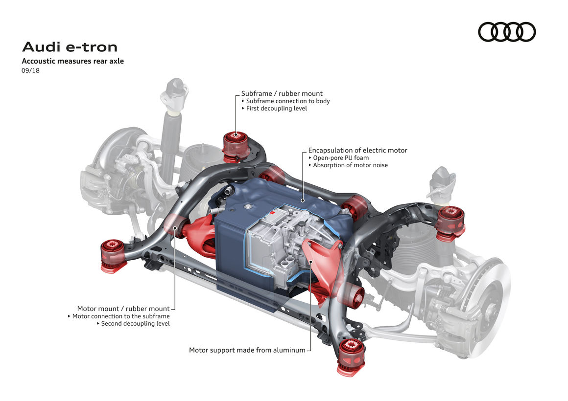

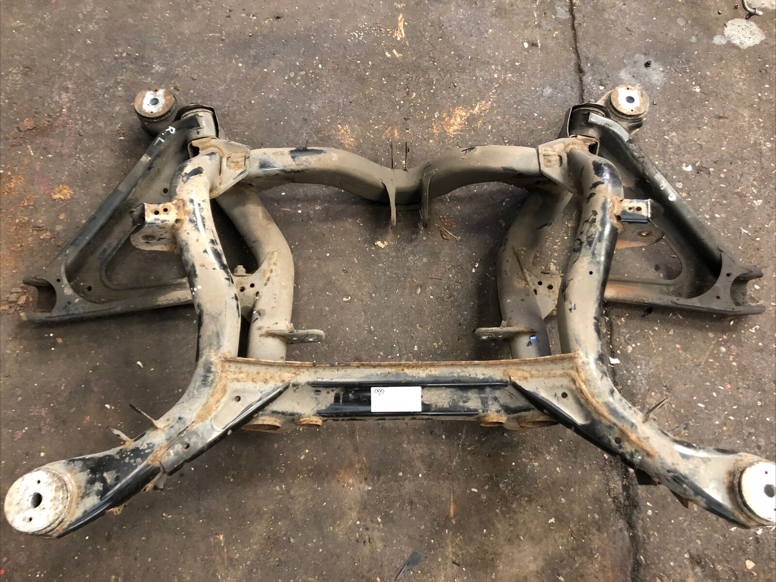

After looking for vehicles with matching PCDs and rear disc brakes with an axle that may be able to be swapped I've come across the VW Touareg (maybe the Audi Q8 also). An E-tron also seems to fit which might help with motor mounting....
Anyway, these are all rear subframes, would they be a suitable option for modification/swapping do you think?
I suspect not for a swap but modification potentially... Tracking width is also within 20mm which is nice.... I just need to work out how to add the leaf spring/dampener mounts.
They are also very cheap which is good. Touareg Etron rear axle (expensive)

Re: Modified de Dion axle in the UK

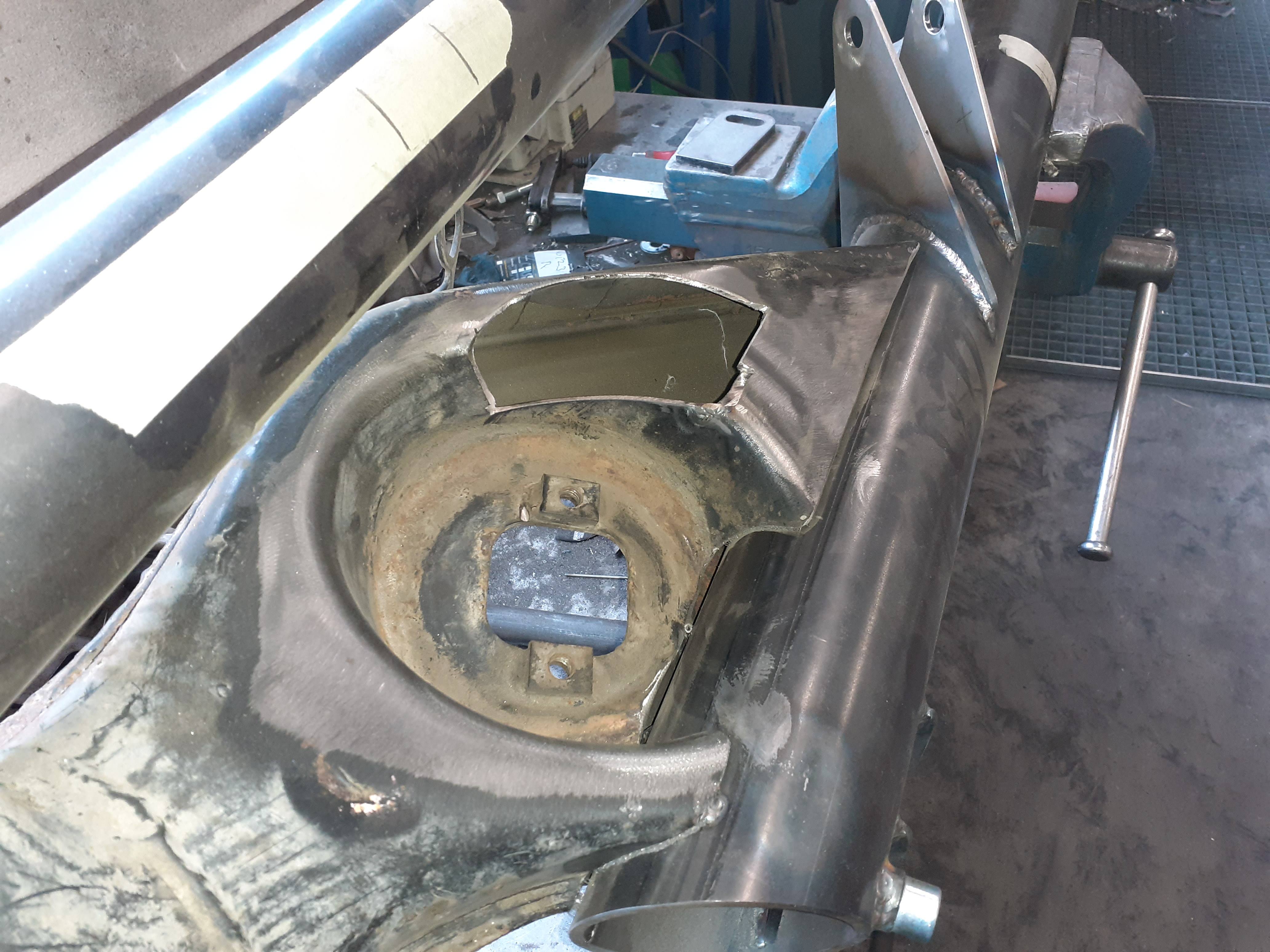

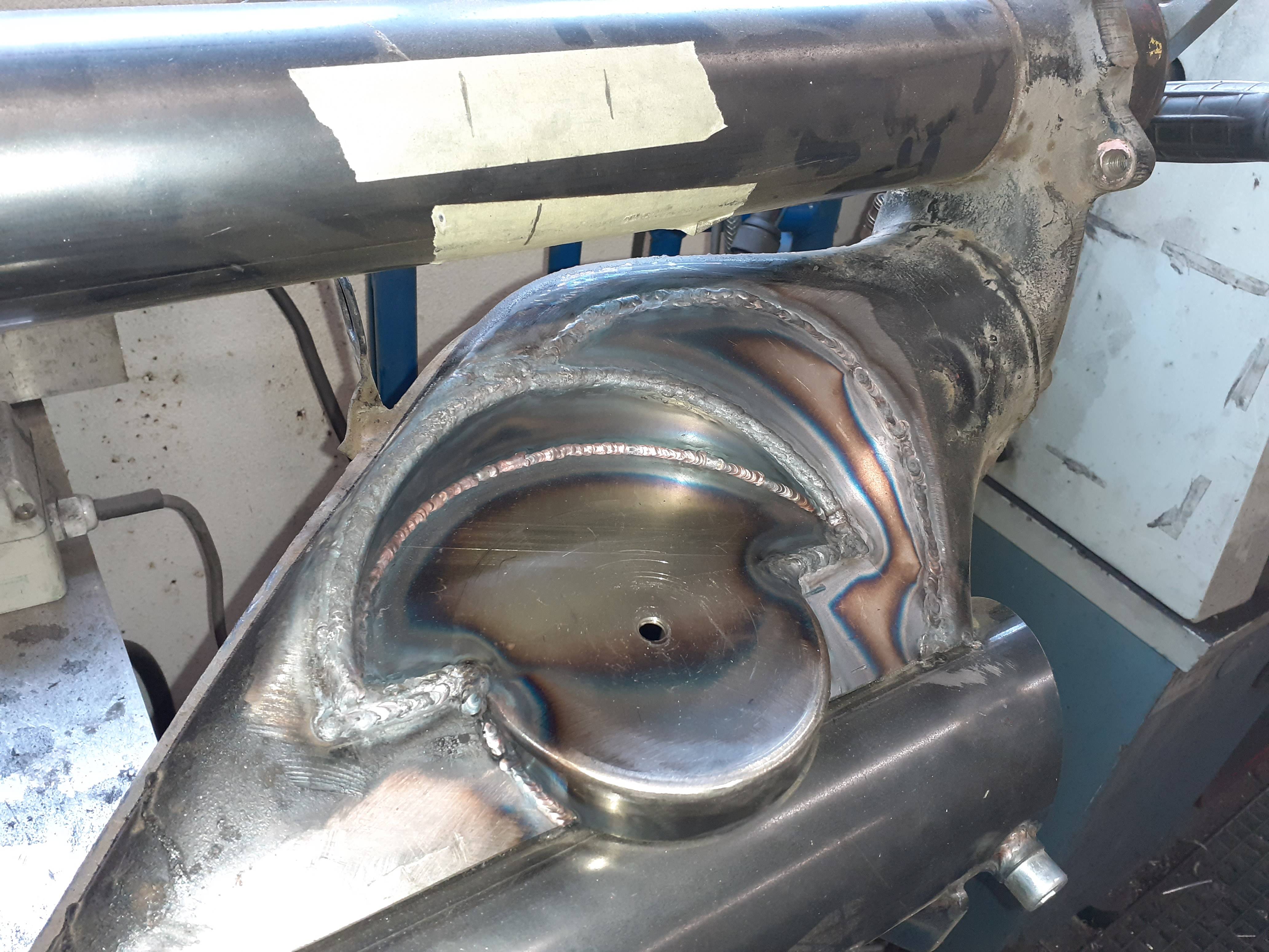

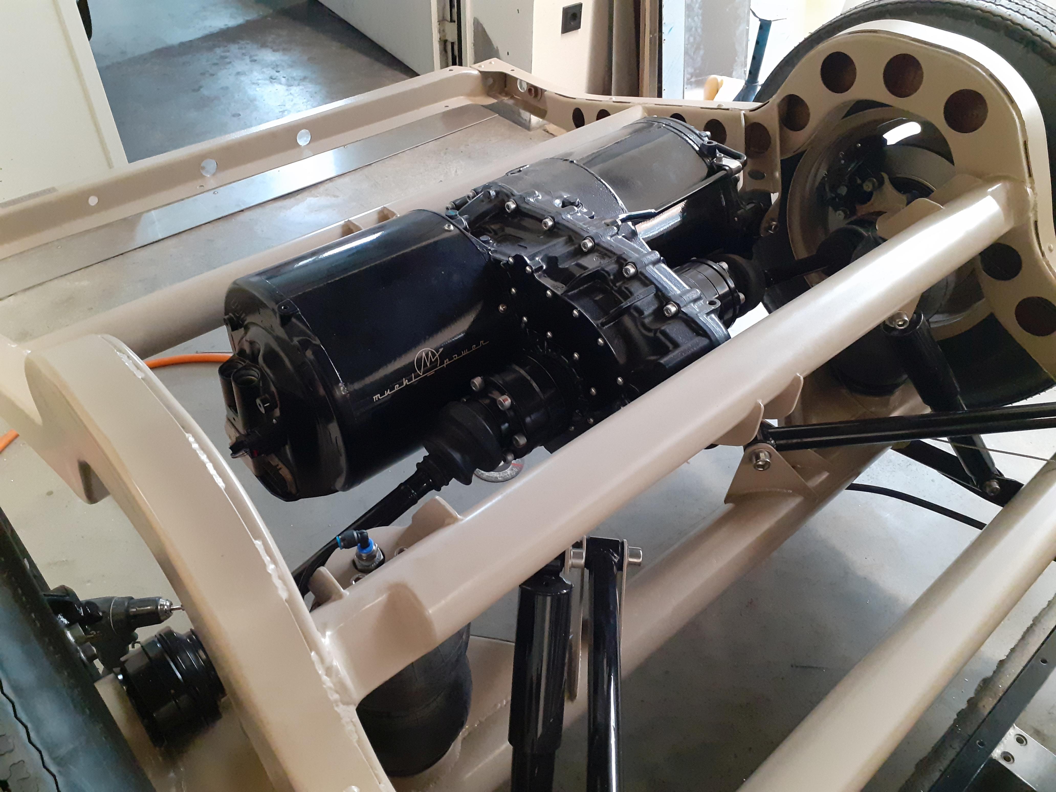

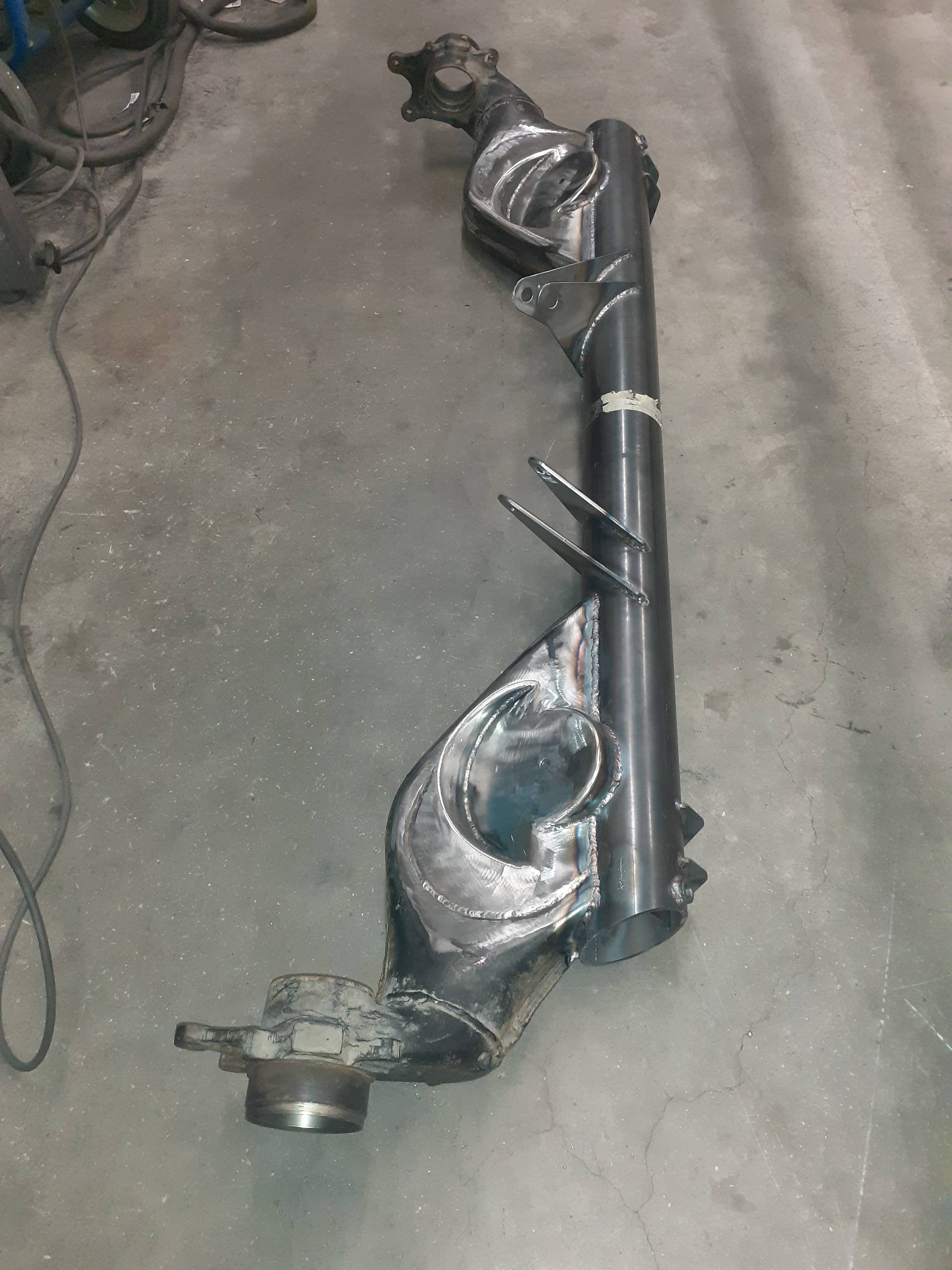

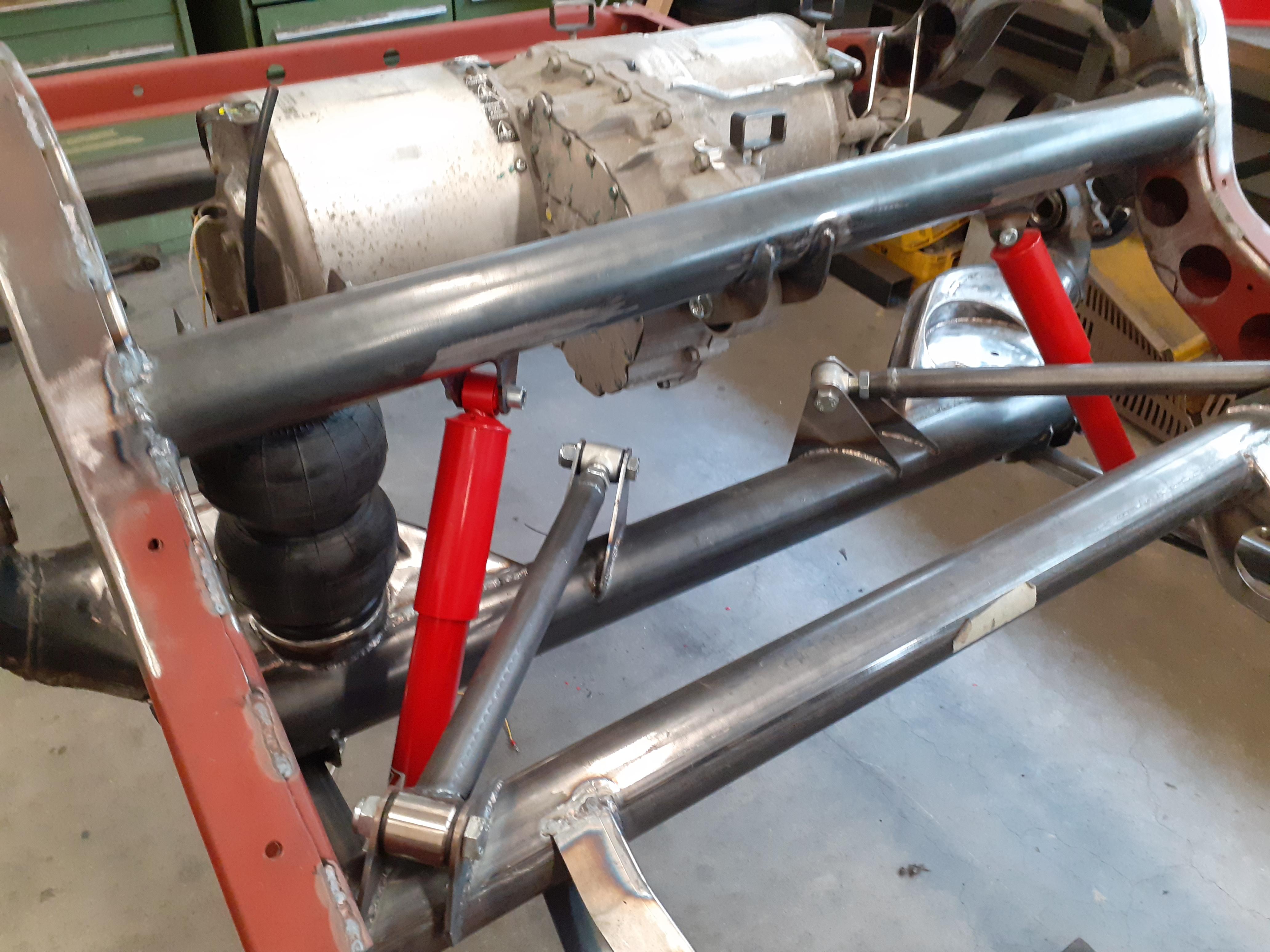

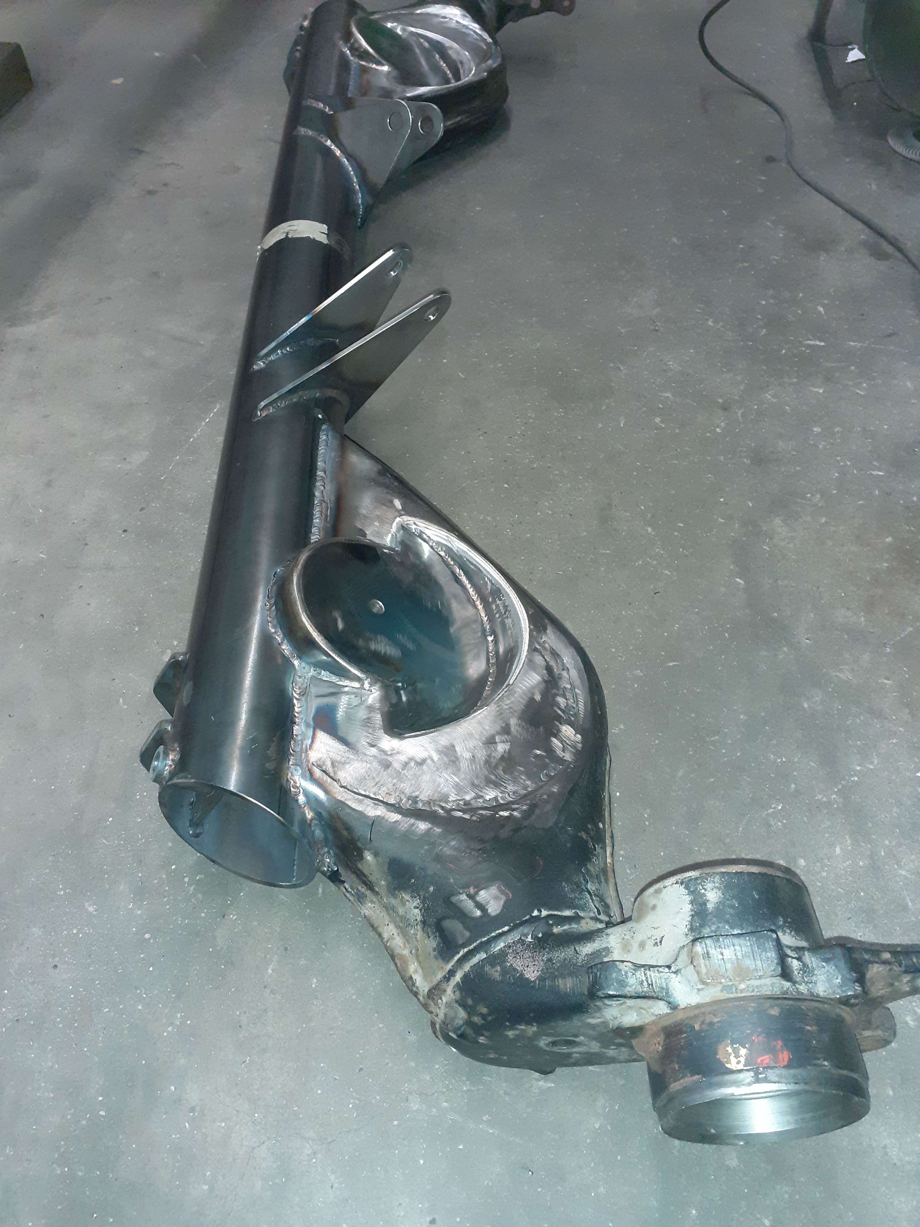

I first fixed the two individual parts with a pipe and a threaded rod. This ensures that the wheels are straight afterwards and that the track width is correct. I also changed the attachment for the air spring, it would look different with a leaf spring. The welded tube has a diameter of 89mm and a wall thickness of 4mm.
