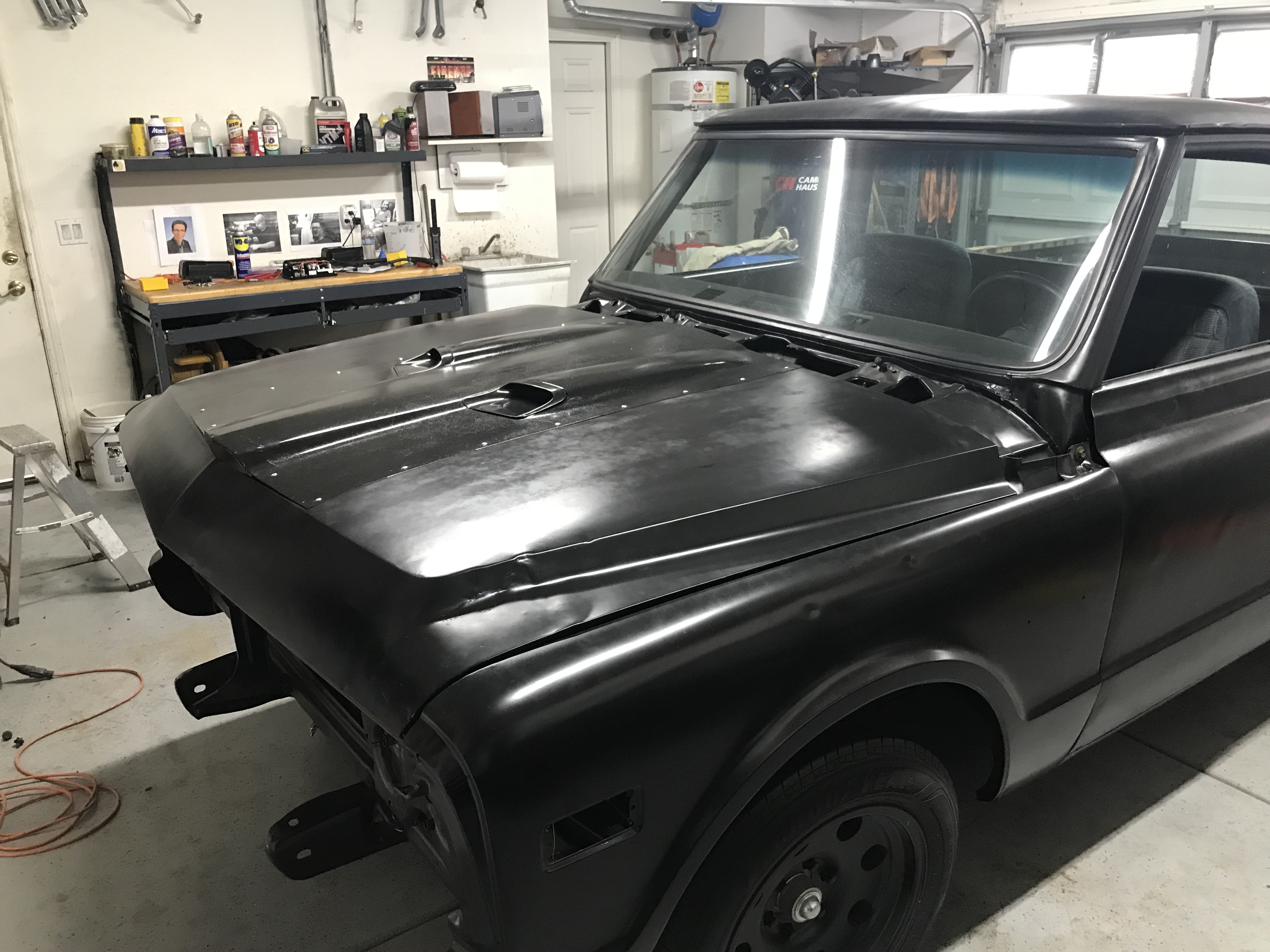

two bit coin to the first person to tell me what hood these nostrils came from

just a high tech truck with a low tech hood (bonnet) brace

That's what you claim in your text, in fact it's Pontiac GTO 1968-1970

I thought no one reads that stuff !!! lolmuehlpower wrote: ↑Mon Jul 24, 2023 4:14 pm That's what you claim in your text, in fact it's Pontiac GTO 1968-1970
