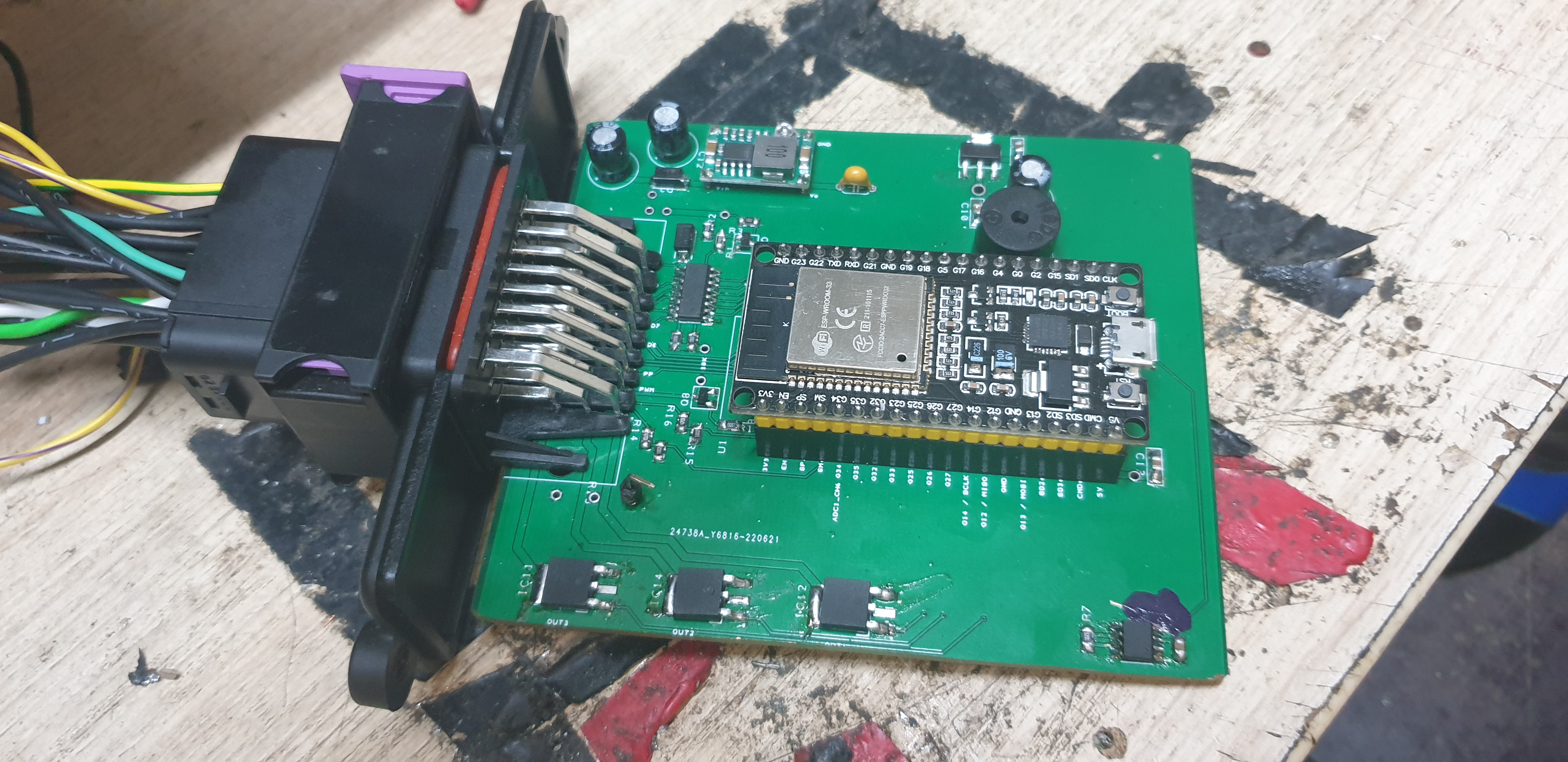

I have prepared a board with ESP32 chip for testing and VCU development.
Primary goal would be to develop low cost version of BMS/chademo controler but using this as simple VCU is not excluded.
Main caveat is this only has a single CAN.
Good point would be integration of buzzer for error signalling etc...
While i develop the code i intend to add another CAN to SPI pins... this should make it a great board especially so since it has BT/WiFi functionality already integrated.
If someone already developed something for ESP32 that works i intend to shamelesly ripoff their hard work and use it in true engineering spirit...
You may do the same to me.

I did some programming of the ESP32 dev boards and during that came up with the list of usable pins...arber333 wrote: ↑Wed Aug 24, 2022 8:41 pm Yes the idea is to replace the module with the clear ESP32 chip in the end. I need to know which pins i can trust and what would actually be better BLE or Wifi. I am really impressed by my BMS ability to connect via bluetooth showing all the cells and data...
Mostly using board with 38 pins and those have voltage regulator like LM1117 so it should work on up to 16V without extra voltage regulator components. However, when connected directly to 12V from car (on pin 5V) voltage regulator gets really hot and results with the board reset... On first startup it works for about 40 secs, and after every restart working time is shortened. I guess 14-15V is too close to top limit and it results with overheat.
Ended up adding additional voltage regulator as I see on your picture.
If you plan to use WiFi intensively then avoid using ADC2 pins as those are used for WiFi comms.
I detected total 14 pins free to use by firmware. Of those, 4 are input only.
Free to use IO pins:
5, 16, 17, 18, 19, 21, 22, 23
ADC1 pins that can be safely used:
32, 33 - as IO
34, 35, 36, 39 - as input only
It is critical to avoid pins 6 to 11 as those are used for SPI flash, and also ADC2 pins (if WiFi is used) 0, 2, 4, 12, 13, 14, 15, 25, 26, 27
For sensing use ADC1 pins 32, 33, 34, 35, 36 and 39. ADC1 also uses pins 37 and 28 for channels 1 and 2 but I think those are not populated on dev boards.

True, first i tested that board and found out that 14V is stretching the LDO. This is why i decided to use 2 stage power.
1A 5V regulator first then 1A 3V3 LDO regulator.
What i figured is i need one GND layer and a second power layer. But 5V in the power layer is a bit too much for inputs. So i decided to split that. On the top and right edge i have 5V, but 3V3 is everything else.
I made a first mistake when i fixed CAN transciever to 5V layer. tx is pulled up to Vcc and that will show 5V to ESP directly. I will make a change to 3V3 in next iteration. For now i just cut that layer above CAN and fed 3V3 to it from the side.
Thanks for the pins count. I already figured out some of that limits, but its good to know more.

2 things that are worth noting from my adventures with the esp32 on spaceballs ... is that you'll struggle to build a on chip board design at a reasonable cost with jlc as the extended parts fees and the cost themselves for the esp32 and the usb-uart chip even using the ch340 you'll struggle against a known good AliExpress supplier (for the Dev boards). If I got myself an PCB re-flow oven for the extended parts I reckon I could bring costs but that's allot of extra complication. Plus hand soldering the esp isn't recommended as you struggle to get solder to the heat pad under the chip themselves.
Plus there is the added 3rd dimension when using a dev board, this allows the can transceiver chip and an MCP can chip with their associated chips to be put underneath the Dev board. You run out of space really quick once you have connectors and test points
For my next revision I'm going to use these... https://www.digikey.co.uk/en/products/d ... E/12091811
As for the price point I can't get near it as it's genuine cp2102 usb uart chip, extra ram and rom plus you can choose internal or external antenna!
edit: yes i have swollen the esp32 pill completely!! such an insane chip for the price point.

I'm curious how gpio27 is on the banned wi-fi list? as this is what has been used for the colin kidder/jack rickard/evtv esp32-candue im surprised that this was missed if that were the case.mario wrote: ↑Thu Aug 25, 2022 9:10 am
32, 33 - as IO
any info on this would be appreciated.

The ADC2 pins can be used as GPIO or for digital peripheral functions without restriction. The limitation is that you can't use them as ADC inputs if Wi-Fi is also used (as Wi-Fi uses ADC2 internally).rstevens81 wrote: ↑Thu Aug 25, 2022 5:52 pm I'm curious how gpio27 is on the banned wi-fi list? as this is what has been used for the colin kidder/jack rickard/evtv esp32-candue im surprised that this was missed if that were the case.
There are however some strapping pins on this list which it's safer not to assign. if you do use them then it's important to take care of the state coming out of reset, or the chip may misbehave. GPIOs 0, 12 (aka MTDI), 15 (aka MTDO) are the ones to pay most attention to. The ESP32 datasheet Strapping Pins section has this information. There are also some handy diagrams around, for example https://docs.espressif.com/projects/esp ... pin-layout

So i should avoid pin 4? I am already trying to use it as my CANrx pin with pin 5 . Do you think i should use different pins for CAN then? I want to use Wifi or BLE.
- aot93
- Posts: 212
- Location: UK, West Sussex
- Has thanked: 8 times
- Been thanked: 49 times
Re: ESP32 VCU development
I tried 4 and 5 for can Comms without success.
Pins 16,17 have worked just fine though.
I’m running CAN on pins 4 and 5 for the ESP32 driving my Bluetooth head unit I built. I’m pretty sure it’s a wroom-32 model.

I would use the default which are GPIO_NUM_17, GPIO_NUM_16 from esp32_can_builtin.cpp if you can as they are known working pins. The easiest way I found to work out known good pins was to look at the evtv due manual (http://media3.evtv.me/ESP32CANDue.pdf) if you do want to spi can you have to edit the library to uncomment the mcp2515.
My rationale for copying the pin out was to (a) it's a known good configuration and (b) I can use the board with saavycan
