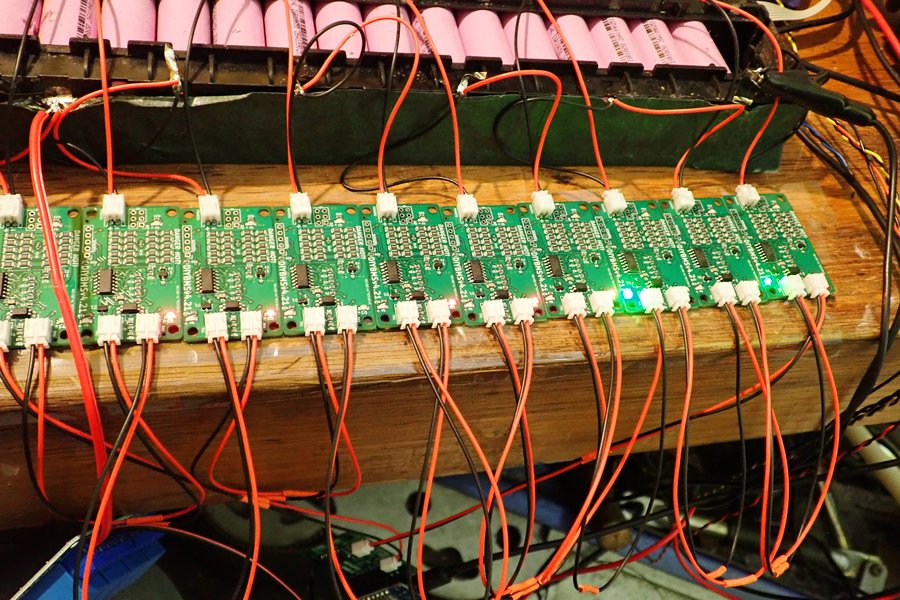

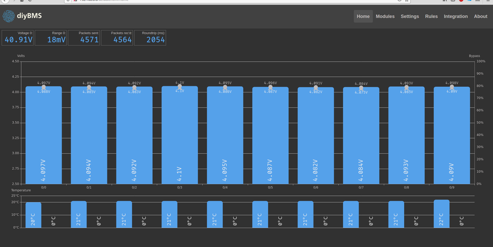

I'm using a DalyBMS for my current quad battery which is 20s1p 48Ah pouch cells, rated for 250amp continuous. It was about £150 though.
I used a cheaper generic chinesium BMS in the previous incarnation when my battery setup was 13s2p using the same cells.
Both seemed to work fine.

This system is a string of individual modules with an optical link between them all and a WiFi config page. It has a few relay outputs to terminate charge and flag battery errors like low cell voltag etc.LRBen wrote: ↑Sat Jan 02, 2021 6:30 pm I'm using a DalyBMS for my current quad battery which is 20s1p 48Ah pouch cells, rated for 250amp continuous. It was about £150 though.

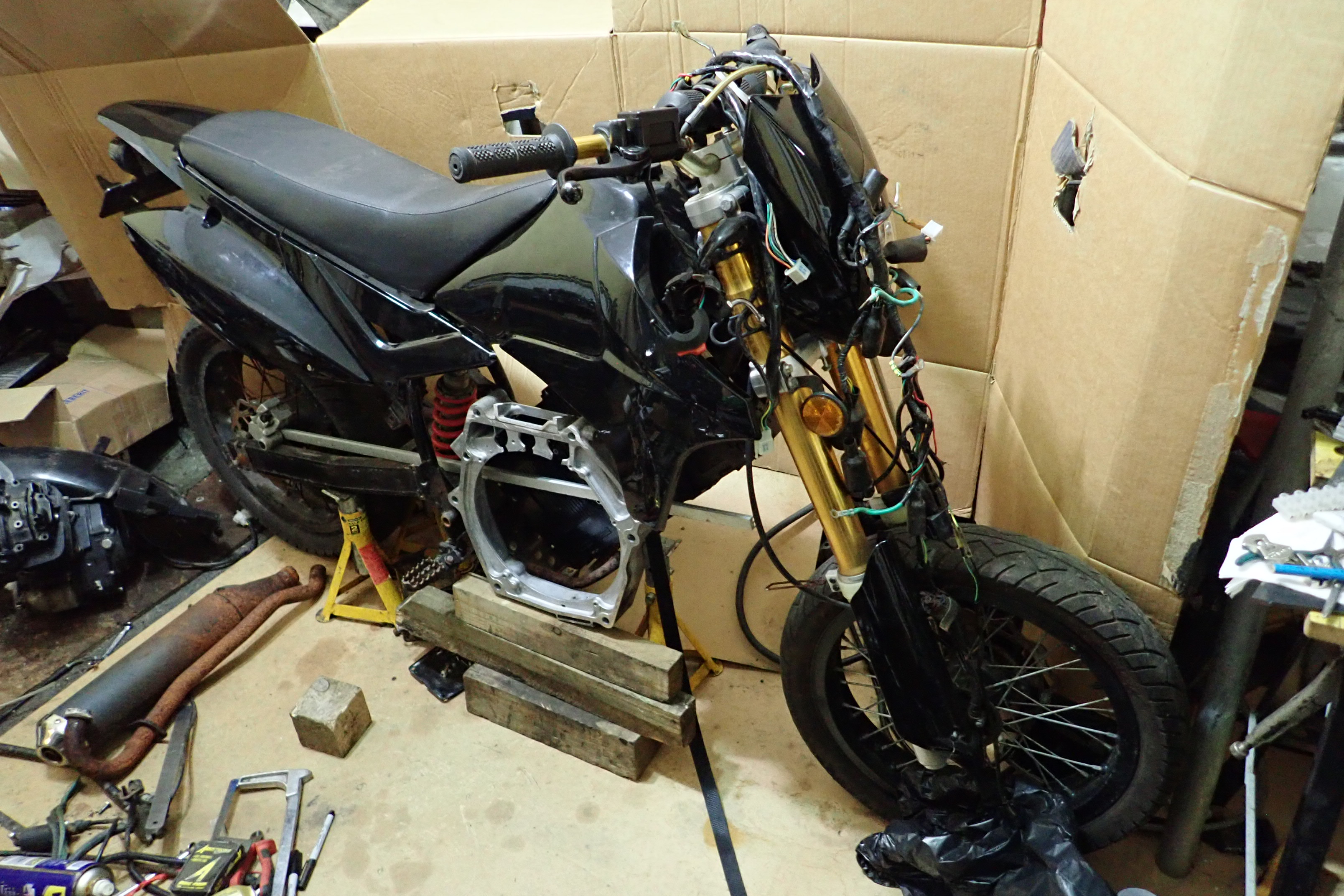

Re: Chinese 125cc + Honda IMA motor

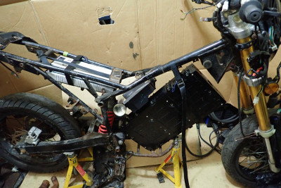

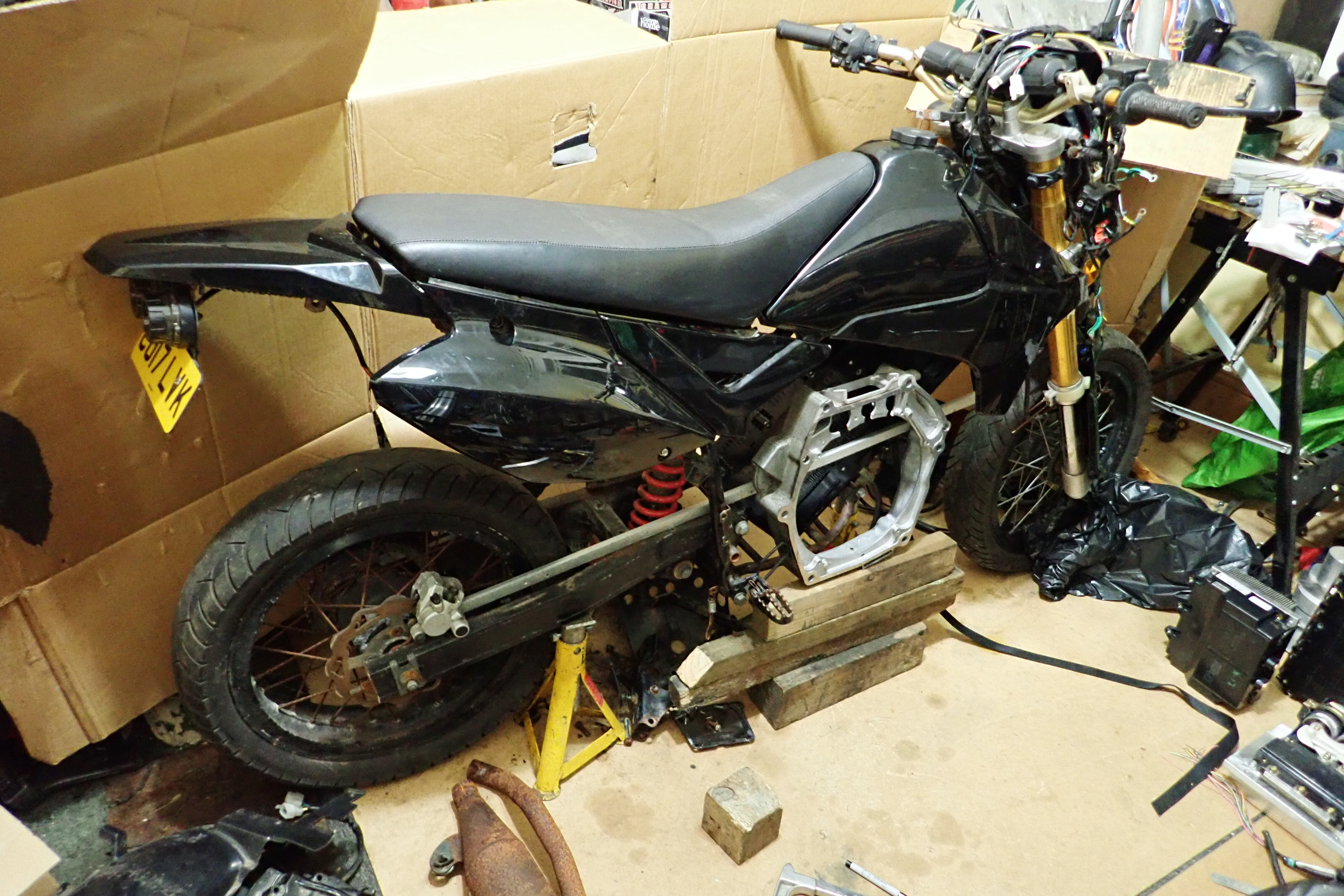

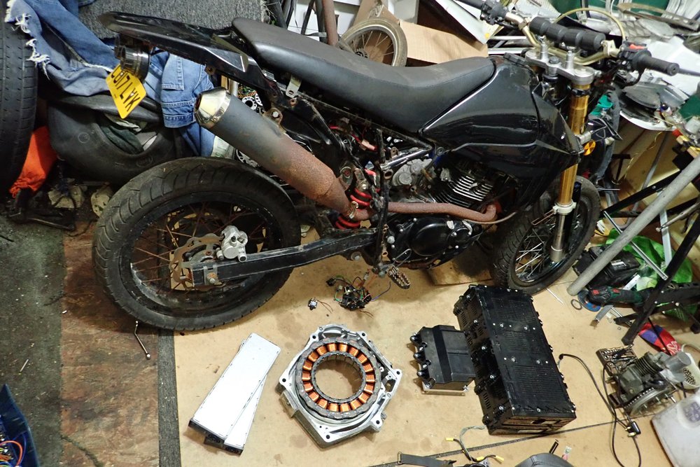

Not much progress this month other than removing the engine and related gubbins and mocking up the location of battery, IMA Controller and twin Eltek chargers.
To get the battery to fit the frame I had to remove the frame down tube that supported the engine which acted as a stressed member to the lower rear frame. A new subframe will be built to regain strength and experience with altering other motorbikes tells me this change will get a MOT when I need it despite technically needing a new registration if you're going to be a pedant with the rules.
Very luckily the original ground clearance and bash plate are maintainable which is useful as I am slightly short in the leg and will eventually want to lower the ride height by a couple of inches. The IMA motor is flat and of large diameter so the plan is to offset the batteries and have it along side them.
I've replaced the bike panelling and fuel tank to confirm it will all go back with the batteries and motor in place which is something I'm very pleased about.

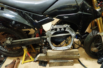

Here the motor casing is mocked up in place on the wrong side because I currently don't have room to get to both sides of the frame easily and at this stage of the project the frame can be considered symmetrical (No motorbike frame I've worked on is ever symmetrical ) .
When putting the panelling back on I realised that if I'm going to carry a Type 2 charge cable I'll be able to put some sort of tubular container under the rear right hand side panelling in place of the exhaust to stow it in.
The motor will not interfere with the foot position much so hopefully the peg location will not need changing.
The batteries, IMA controller and chargers will need waterproof enclosures as I intend this to be an every day bike to use around town and local trips in all weathers. The plan is to make aluminium cases for each major electrical part and the casing will also form part of the mounting bracketery.

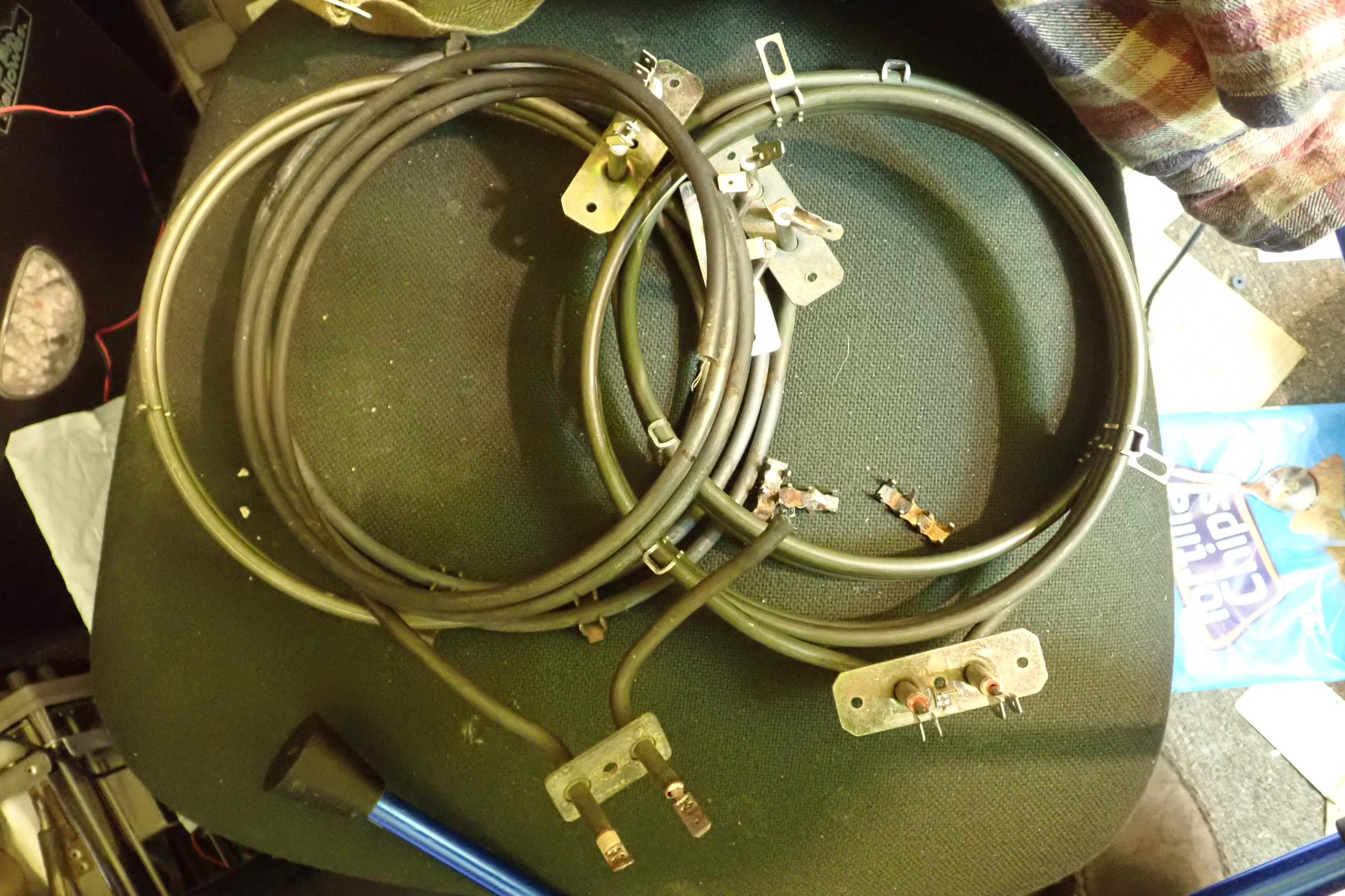

The next stage of the project is to load test the batteries to assess if they are worth continuing using in the project as firstly they are second hand and secondly to see if they will have any significant warming under charging / discharging to require active cooling, and hence a much more elaborate enclosure.

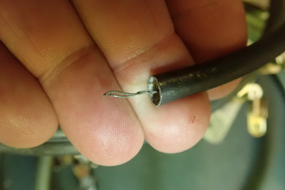

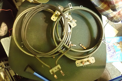

To do this load testing at a potential maximum of 100V, 15 - 20kw I've got some cooker elements I will cut into thirds to work at 100V.
This will also give me a chance to test the BMS system I have as I'm not convinced I should keep it or switch to the 4 channel daisy chained system being developed over on the BMS threads.
Collection of New and Used cooker elements.
One cut open and the element pulled out a bit. I should be able to crimp a wire to this.
I'll be able to bend the element to a new shape by hand. It won't be elegant but should be practical.

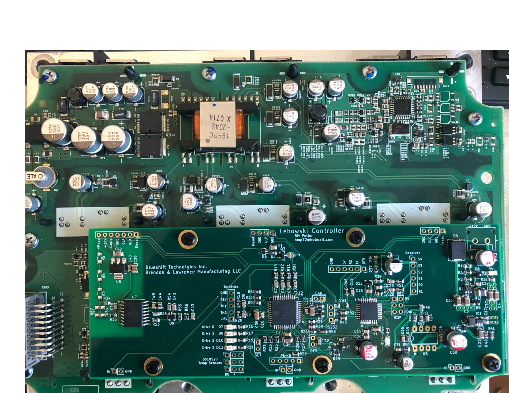

Check out the ES forums where some guys have been working on a drop-in board for the IMA controller. I personally funded most (edit: some!) of the development on it and a guy who goes by kiwi is doing the work. He should be able to sell you a board.

Here is a photo of the board ready to be patched into a gen2 Honda IMA inverter:
https://www.youtube.com/watch?v=7by7oVfw86s
A fair amount of work hooking it into the existing 20 pin IMA socket but worth the effort. Currently the resolver firmware only supports 1:1 lobe to motor pole pair resolvers like the HSG and the Nissan Leaf. I'm not sure what the pole count of the IMA motor is or the resolver for that matter.

Judging by the description of the video there is a Lebowski controller

The gerbers will be released once Cole carries out some testing of the IMA/HSG combo on some electric minibike series that is supposed to be happening in Texas. I am really not sure of the timeline for that to happen but hopefully sooner rather than later.

Hi guys kiwifiat and cole.
Still have my lebowski boards (managed to bugger up the 6pack ixys prototype power stage by a wrong config) i need to decouple the power stage and reset the errant setting where i inverter the hi/lo side fets stupidly.
Anyway mouse, i see you are using stuart pittaways v4 bms. I have built one too but i only have it running 4s ie 12v i really want more slave boards, did you order any overs i could buy off you?
