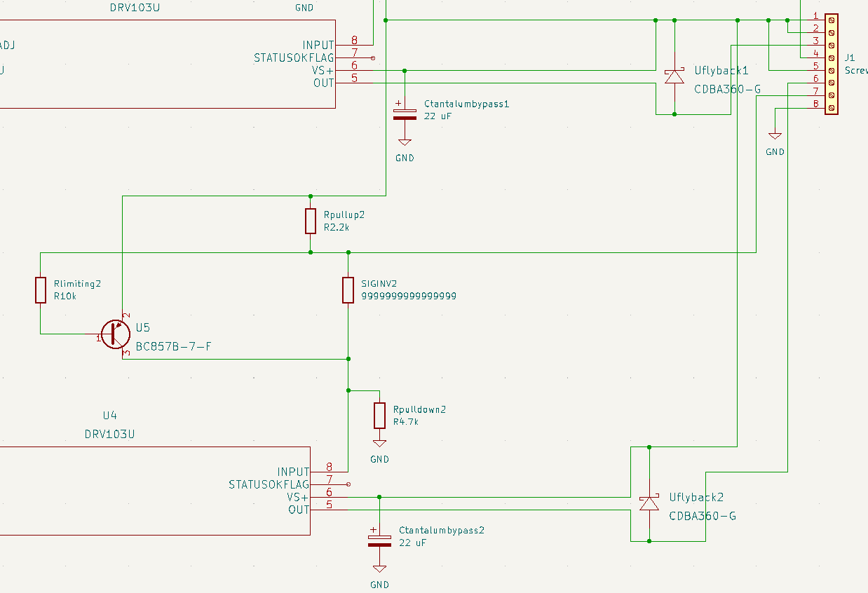

Fairly sure both channels are different and not convinced either is quite right - my version had 4 resistors, you've added one to give the non-inverted input but still only have 4 TBH I always try to layout the schematic so that it flows, minimises crossed wires and tries to have positive at the top and gnd/neg at the bottom - I find it just makes it much easier to follow it and to spot errors.
On my kicad, which I think is a standard install, if you go to 'Add a symbol (A)' and then type BC857 in the search box it comes up with 4 items, the first one is in a SOT-23 package so looks like the one you want. The BC857 is a fairly generic part though, it just ties down the basic part type and footprint. Once it's in the schematic you can go into it and edit the value to exactly match the Digikey part so that the BOM comes out correctly (not exactly best practise but creating a new library part for every physical part becomes a nightmare and is a little unnecessary for this).
Just checked and there isn't a drv103 in the kicad library but the one you've created looks OK. Did you create the footprint or did you use one of the ones in the footprint library?
Edit - Think this is what you have for the lower channel: And this is what you need: Thinking about it it might also be worth adding a 10-100nF capacitor across Rpulldown2. Not too sure what the ESD protection on the DRV input pin is like and if the board is used without the transistor a cap will help it survive transients better.

Re: DIY Economiser for OEM Contactors
Ah damnit, you're right. My son isn't sleeping right now and thus I'm not either. Seems I'm affected more than I thought. I'm sorry to have wasted your time like that. I'll revisit it in a couple days and get it fixed up with that extra limiting resistor and capacitor. I'm pretty sure I understand how it's supposed to work now, at least.
And to answer your other questions, I did try putting 5v straight to the input pin and it did close and economize the contactor. Hopefully that means at least that driver isn't blown, because the stupid things are kind of expensive when you start going through them in pairs, haha. I also kind of hate the tantalum caps because they physically blow up when you solder them in backwards. Very difficult to tell polarity after you solder and desolder them once. But, that's what the datasheet calls for..
I'm not sure where that original box symbol came from but I believe it came up when I first added the transistor, so I just ran with it. Then I tried to swap it out for one that looks like the proper symbol and used "Transistor_BJT:BC857". The DRV103 footprint was downloaded from somewhere else, but I had to add the via in the middle. At the time I believed the one I was getting had a pad on the bottom for heat dissipation, but that turned out not to be the case. I just left the via in case anyone did have one with that feature.
No problem, know what it's like to lose sleep and how much it affects things, not nice. Also no problem with my time, I'm recovering from a health issue at the moment - well enough to get bored but still without the energy to do anything physically or mentally strenuous so PCB type stuff is ideal. Happy to provide as little or as much help as is useful.
Regarding the power dissipation I tend to be a little conservative on power ratings, I know the max operating temp for these is 125C but I don't like letting anything get above 70-80C to maximise life (and prefer to keep it down to 60C to minimise the chance of burning myself while testing!). Using an 80C limit, 40C ambient and the device without the power pad (thermal resistance of 150C/W) means that the continuous current would be limited to around 0.75A. A 100C limit would get you around 0.9A. If that isn't enough then it might be worth considering moving to the power pad device, and adding a small plane area, to get nearer to 1A continuous at 80C (although they appear to be out of stock at the moment).
Revised files attached, please feel free to keep or ignore any or all of the changes. I think everything discussed is included but please check it all thoroughly.
Quite enjoy doing boards like that! Edit - Just realised that the entire current was flowing though a single via on the gnd pin of the drv - not ideal. Just added a second track and via and updated the zip.
No problem, glad to help and enjoyed doing it. Just hope it works!
Also realised that I mislabelled four of the resistors. Rin on each channel was supposed to be the non-inverting input while Rinv was supposed to be the inverting - I seem to have managed to get them the wrong way round. Shouldn't affect operation at all, just a little irritating, but might be worth fixing before getting anything made? (just change the names over in the schematic, update PCB from schematic (but make sure that re-link footprints based on reference designators is NOT checked) and then run the PCB design rules check to make sure it's all still OK)
