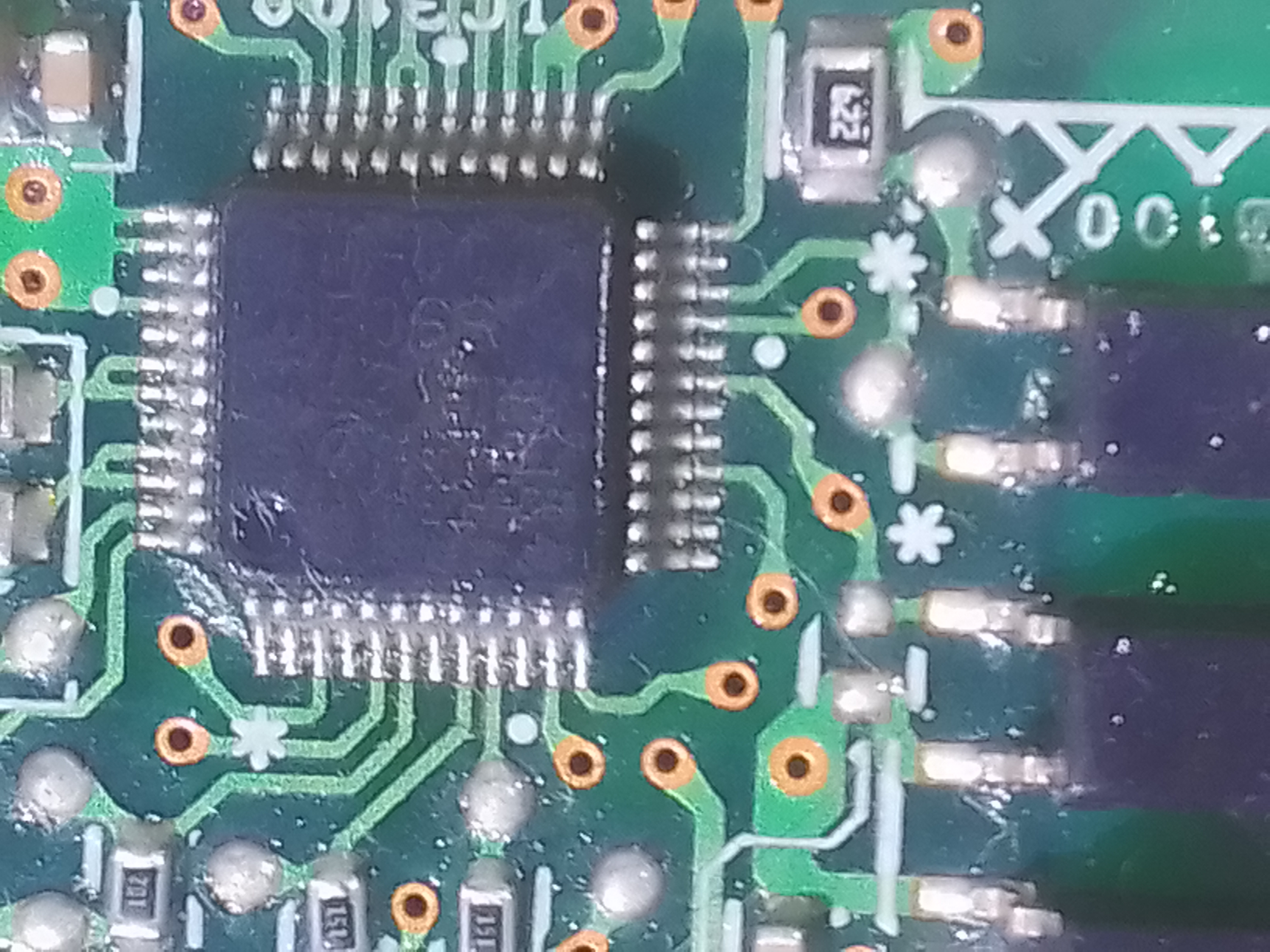

I have taken the top board out to expose the driver board. Each IGBT has the following pins going to the IGBT on the pcb: E S G A K *.
Took the inverter outside into the sun to try and see through the yucky crazed varnish stuff hiding the numbers.
Got:
TM-001
DE066
148
C
with some sort of QR code next to 148 and C.
If you know of a solvent to carefully remove this varnish stuff I could get it then try again.
Kind regards Pete9008.

Thanks Johnspark, that's perfect!
I'm guessing the E S G A K must be Emitter, Substrate (collector), Gate, Anode and Cathode which indicates that there is a temperature sensing diode on each IGBT
The DE066 looks like a Denso part, unfortunately I can't find any data for it so guessing it it Toyota specific
Your last picture has given me an idea though. D1306 looks like it might be part of the standard desat detection circuit. If it is then it should be possible to inject a signal after it from a sig gen to simulate a desat event on the bench and then see what the driver board does. I'll give it a try.
Probably be next week though as my wife has just tested positive for Covid I'm still negative but feeling pretty rough so think it's just a matter of time before I test positive too - so my normal,fairly slow, rate of progress on the car conversion is likely to drop to zero for a while!

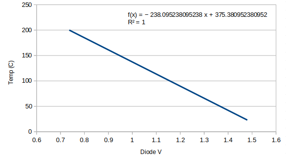

Had another look at this and the IGBT control board does disable all PWM for the duration of the MG fault. It does this by disabling the supply to the logic board PWM pull ups which was what was confusing me (when scoping the connector pins it looked like the logic board PWM has stopped when it actually hadn't). So this confirms the above, derating isn't going to work, it's either trip or try to ride though the 130ms shutdown (probably the former!).
While doing this I also had another look at the temperatures:
The temperature currently reported as the heatsink temperature is actually the die temperature of the centre phase low side IGBT (the one referred to on the PCB as device 1). I've proved this by adding a resistor across the A and K connections for the IGBT temperature sensing diode and monitoring the web interface while forcing the diode voltage. This has also allowed me to better characterise the sensor and I think we may be reading it wrongly (assuming that I've got my board set up right - I'm using the Semikron setting for snshs??).
The voltage measured at room temperature is 1.5V. This is about right for a pair of temperature sensing diode in series. Based on a measurement of the voltage at room temperature and an assumed characteristic of 2.1mV (or 4.2 for the diode pair) per degree C (assuming it's actually a diode connected transistor which gives better stability) gives a diode pair voltage to temperature characteristic of: Worth noting is that the Prius built in over temperature trip occurs at a diode pair voltage of 0.83V (and resets at 0.87V). This corresponds to a trip when the die temperature hits about 175C. This is a little high but does match the higher end specified for IGBT modules so I'm inclined to believe it.
Next I measured how the diode voltage relates to the voltage on the STM pin giving this:
Which is nice and linear which is good. Also of interest is that the voltage to the STM bottoms out at 0.334V on the pin or 1.077V on the diode (you can just see the plot starting to straighten out in the graph - I didn't include the extra points so as not to mess up the trend line). This equates to about 120C and would suggest that the inverter designers intended the IGBTs to normally be kept below 120C even though the safety trip is 175C - so a pretty big safety margin.

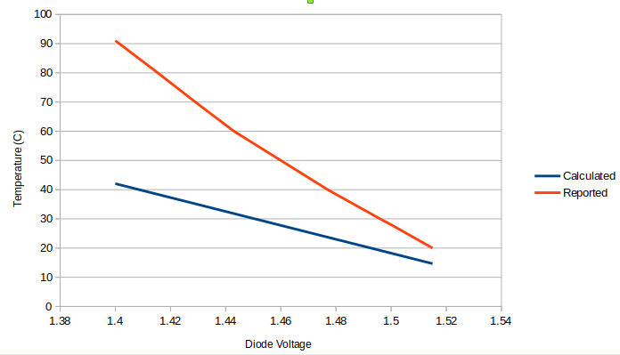

Finally I compared how the temperature calculated from the diode voltage compared to the temperature reported by the web interface for tmphs and got this: Now that is quite a significant error and may explain why some people have commented that it was difficult to use the heatsink temp as it moved around so much! Alternatively I've got something wrong somewhere - let me know if you can see any flaws in the reasoning!
Going to have a look at the alternative sensor characteristics built into OI to see if there is one that matches better, if not I'll create one.
