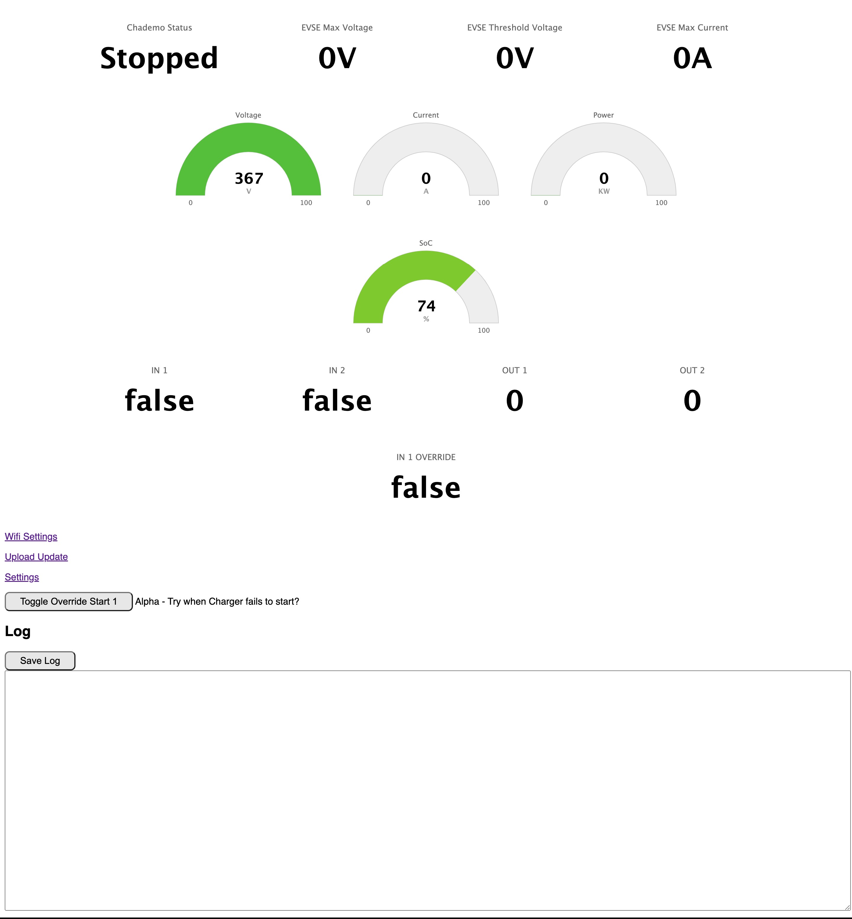

Bigpie wrote: Tue May 23, 2023 7:10 pm Web interface for setting params and logging output
Can you post a screenshot of your wifi charging interface? Just a teaser... :)
Posts: 1597
Has thanked: 75 times
Been thanked: 306 times
Re: ESP32 Based Chademo
Will this do? Wasn't charging, just sat on the drive.

Bigpie wrote: Wed May 24, 2023 8:21 am ESP32-BMS.jpegScreenshot 2023-05-24 at 9.18.38 am.png Will this do? Wasn't charging, just sat on the drive.
Really good thank you. Its just what i was hoping for :). I will adapt the code and test it in my Chademo setup.
