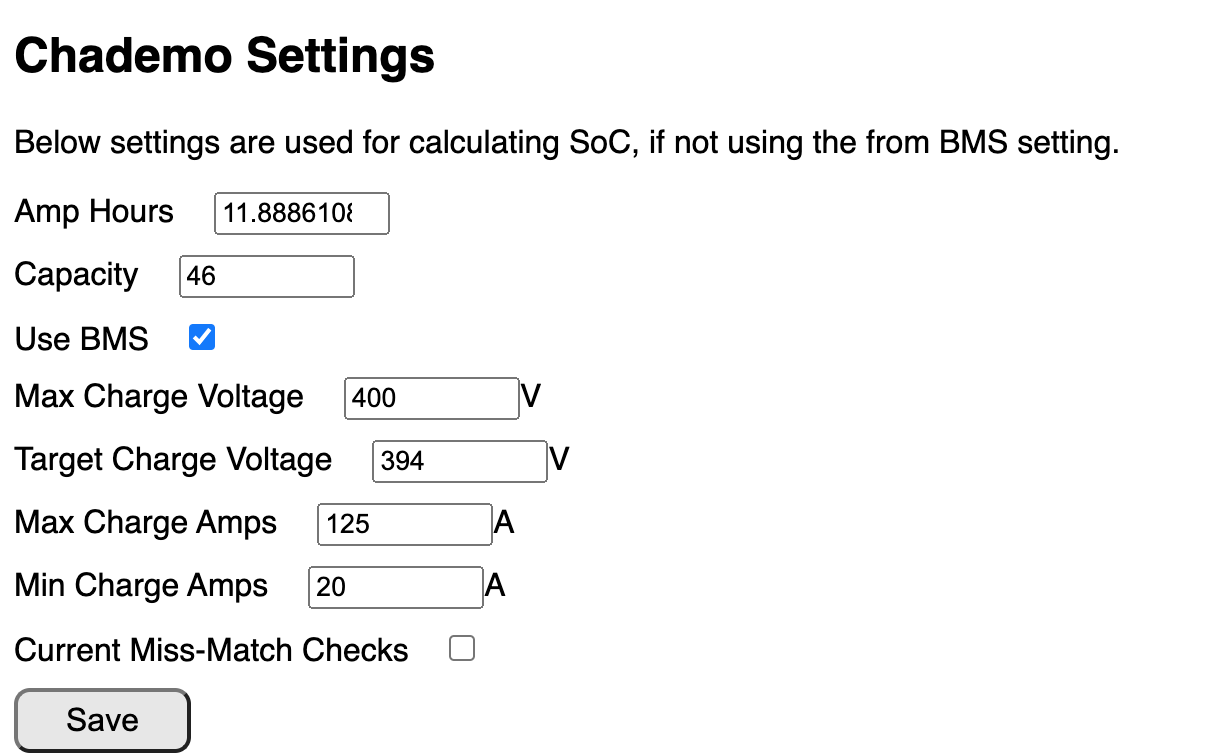

Hi again i think i will try to add your code to my ESP32 version. Can you tell me if you actively use Wifi interface to setup parameters for chademo? Or what do you use Data folder for?
tnx
- Posts: 1596
- Has thanked: 75 times
- Been thanked: 306 times
Re: ESP32 Based Chademo
Web interface for setting params and logging output

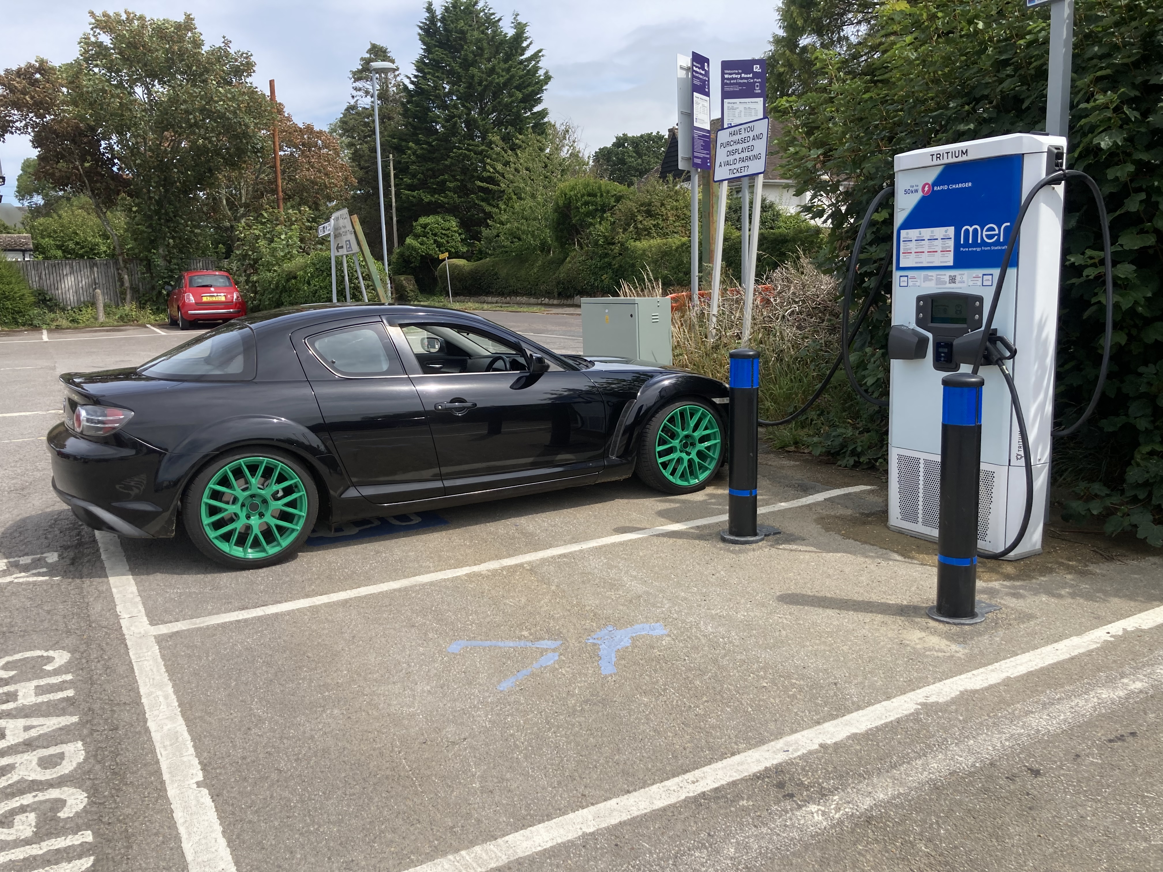

Trinium Mer charger today, started charge fine charged to 71% (bms Soc) and then kicked me off whilst still charging at 50a, possibly an issue with my settings I have changed them since going 96s but maybe target of 384 and maximum of 393 is too low? 384 is 4v per cell and was kicked off with cells above 3.9… the charger showed an impossible Soc of 156% to start and then actually fell to 142% when does the charger get it’s Soc from?
