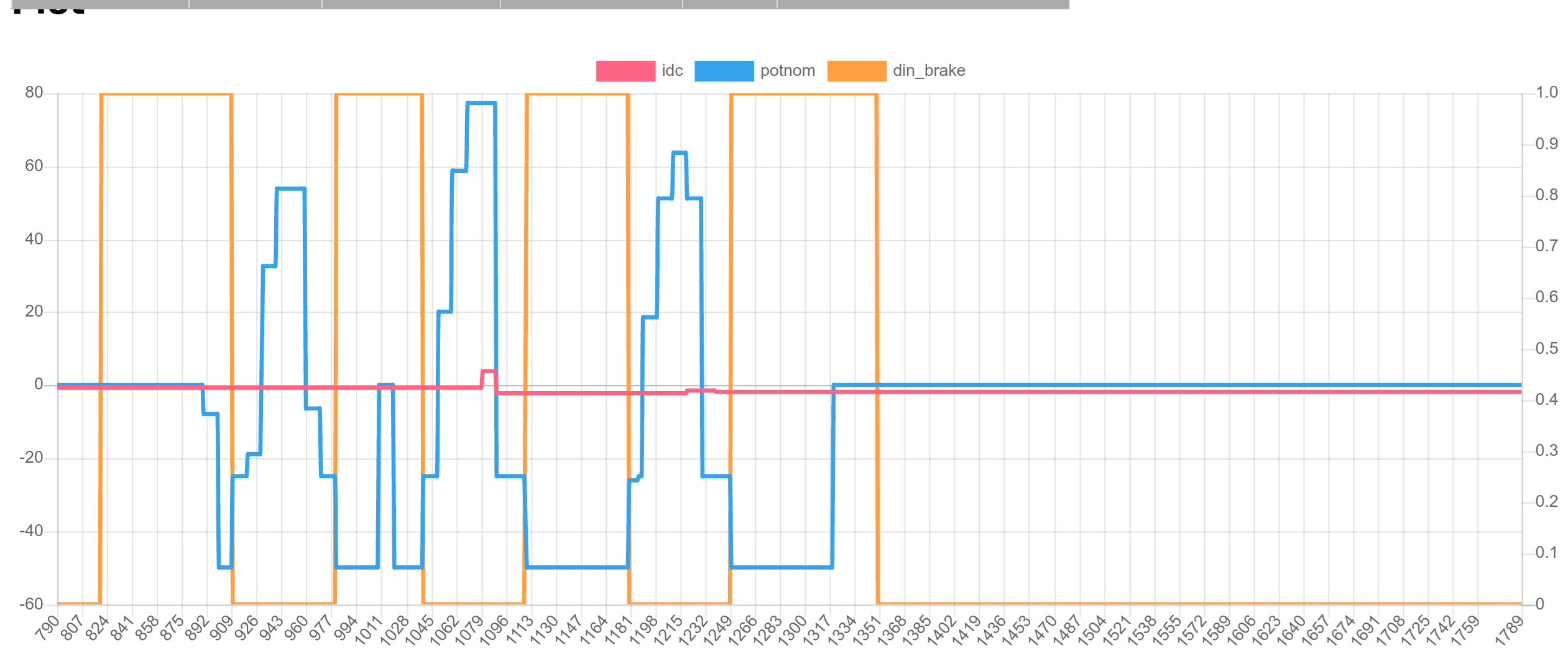

1) How can I create visibility of what is actually happening in a plot?
I tried plotting il1, il2, idc and expected negative values for idc at least but couldn't really spot it when braking from low speeds, is there a variable that will help? scaledBrkMax from throttle.cpp would be interesting I think, but it isn't a param. I could expose it as a param and plot I suppose.

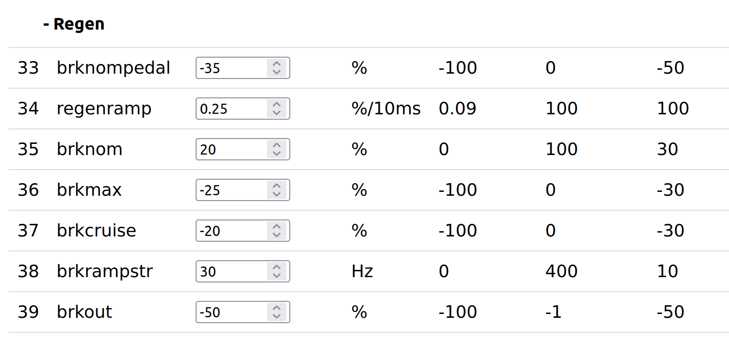

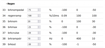

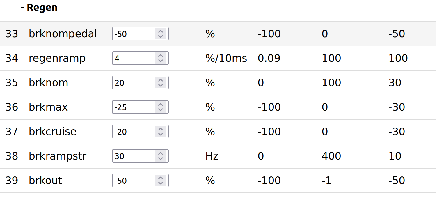

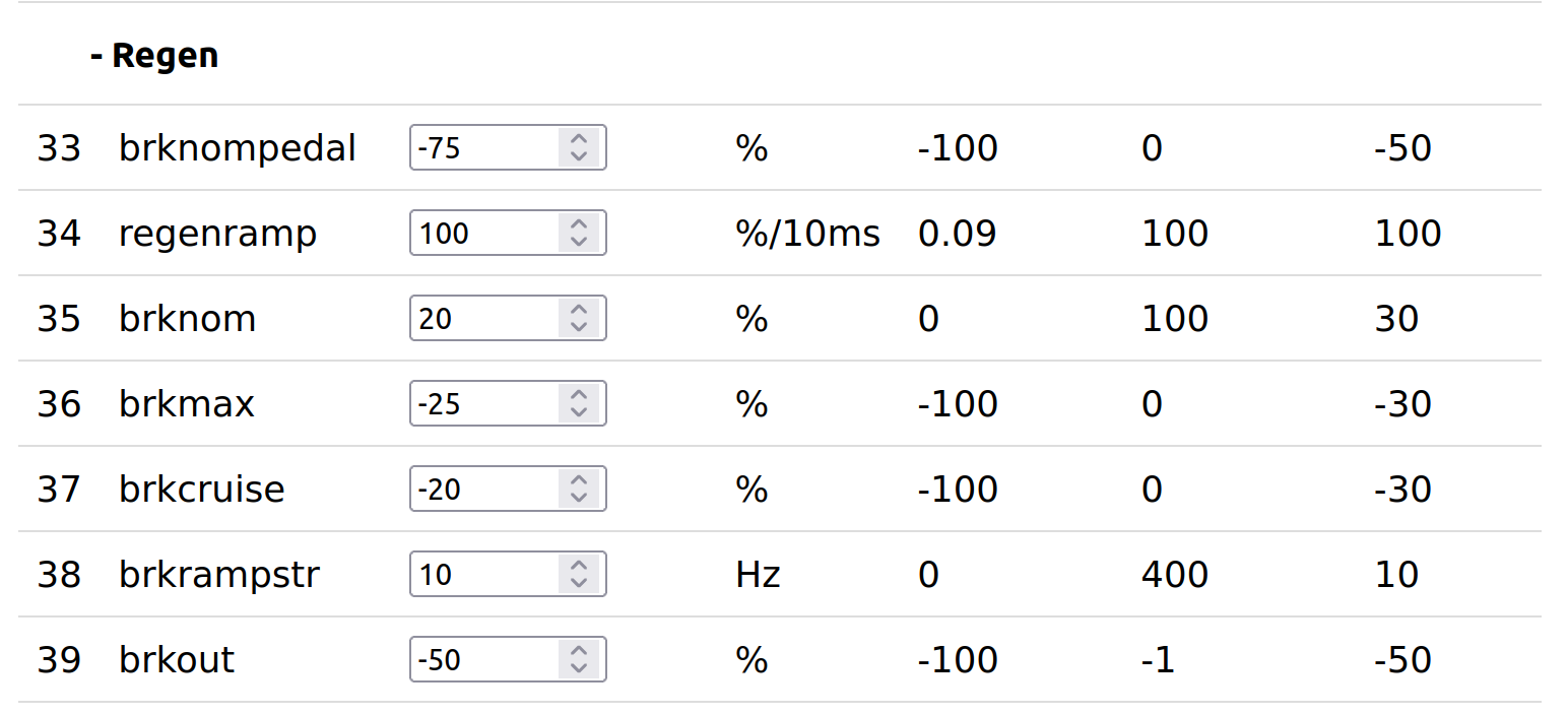

Below the two sets of params that I tried, but I struggled to feel a difference really.
Thanks for any hints!
calm settings
more aggressive settings

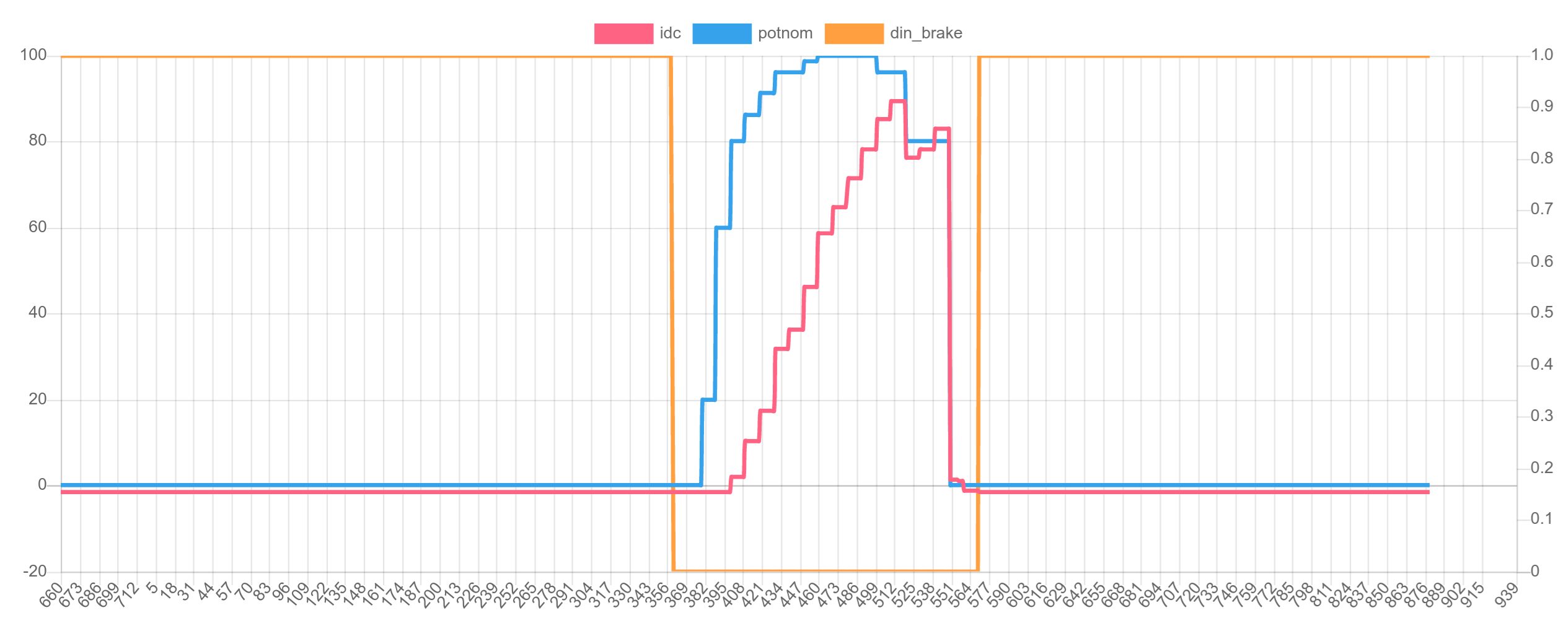

It only brakes at ~1kW.
I would have expected it to be more like 10kW with aggressive settings, right?
pot2 sits at 0. I set pot2min = pot2max = 0 for the trials just then, I could try -1 I suppose, haven't looked at the code yet if that would force it to 100%.
Noteworthy: I averaged the brake signal over 100ms in code to make sure there is no oscillation between 1 and 0, thats why din_brake comes up a bit later. Still I would have expected idc to dip a lot further afterwards. It just coasts till the friction brakes catch.
acceleration & brake test
most aggressive settings I tested

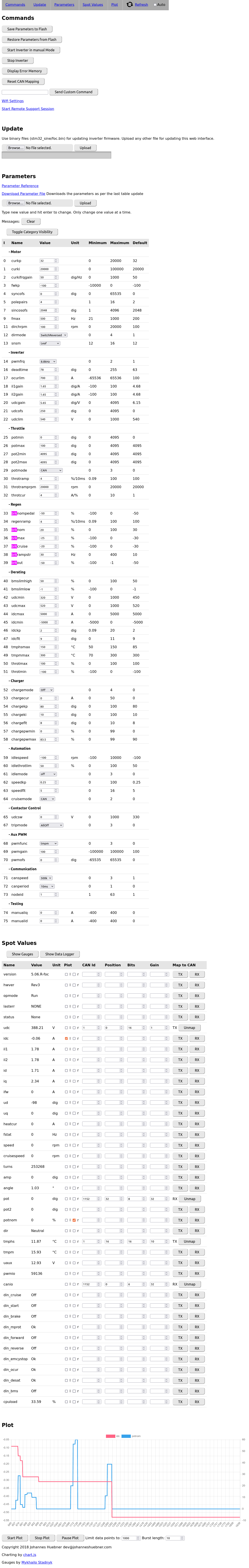

List of all options below. Sorry it is in a screenshot.

In some version there was indeed an issue with pot2. Try setting both to 0. Indeed potnom never seems to go below 0, so no regen

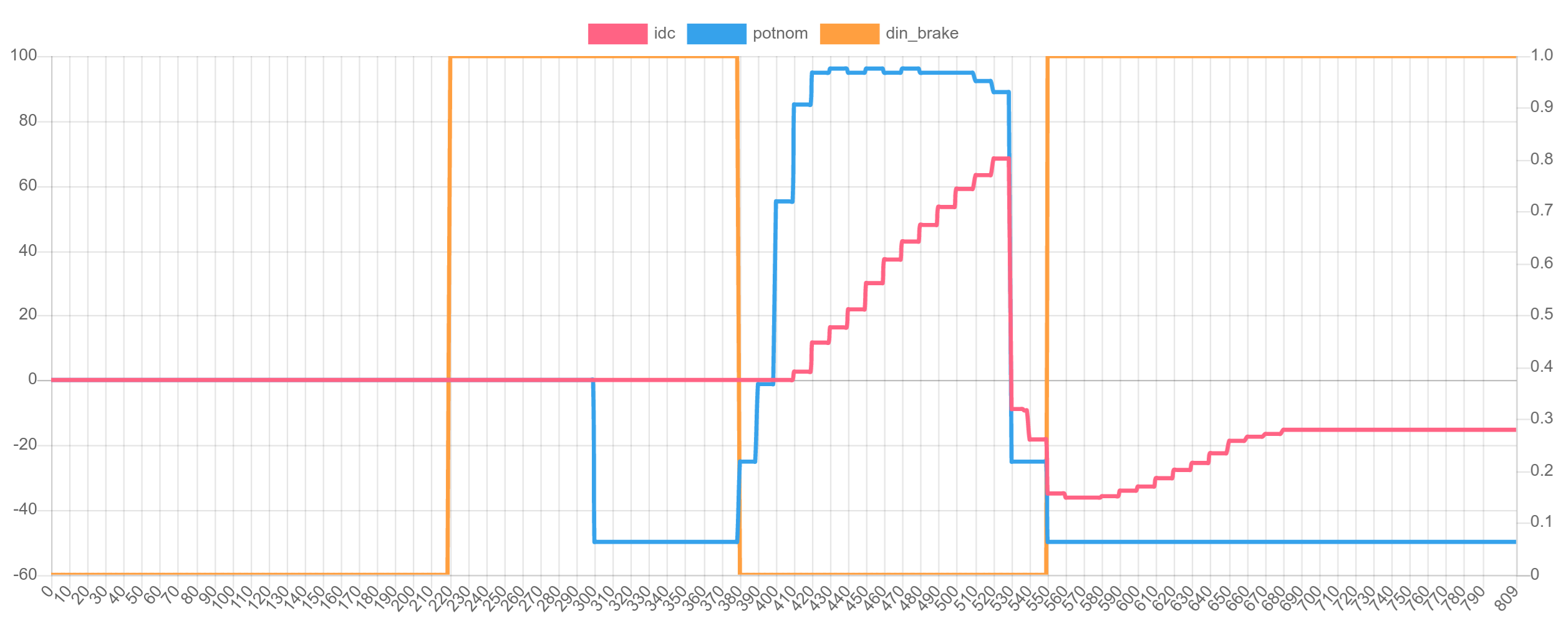

johu wrote: Tue Dec 21, 2021 4:17 pm In some version there was indeed an issue with pot2. Try setting both to 0. Indeed potnom never seems to go below 0, so no regen
I had both at 0 earlier. Let me update firmware and see if that alleviates the issue.
Edit:
Software update to 5.14-FOC makes potnom go negative!
Going to a car park now to try it.
Edit Edit:
There she is! 5.06r-FOC had the pot issue.
