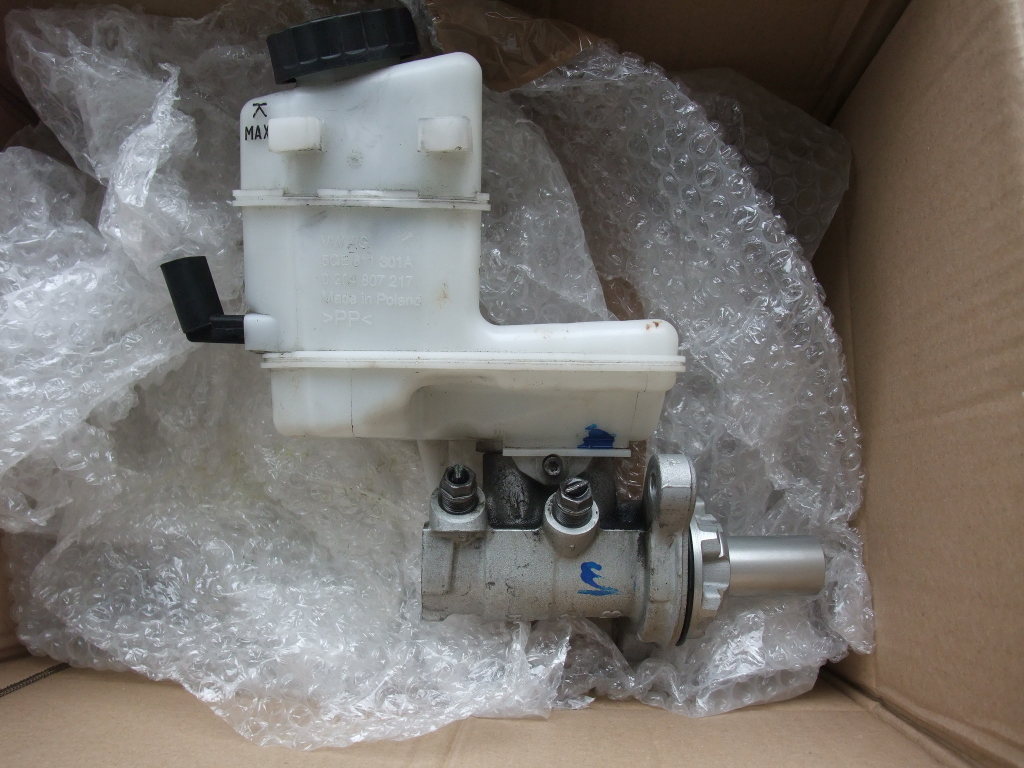

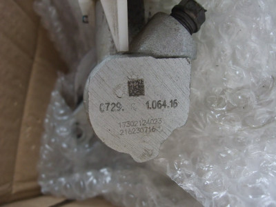

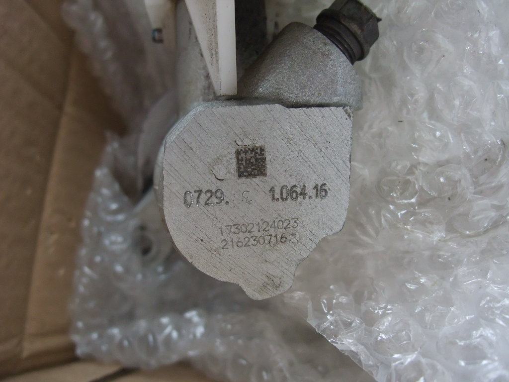

This just arrived :
Now I'm reasonably sure it's a Golf GTE master cylinder that should fit the iBooster. It was just described as a Golf part though (no mention of it being a GTE part). @seb43654 - any chance that you could confirm whether it's the same one that you are using?
Details of the cylinder part no. for reference :
Edit - Also wondering whether a Vauxhall Agila brake reservoir (pre 2006) might fit, may order one to see.
Edit2 - Also looks like the Roadster reservoir might fit it too, I should check that first!

Looks like the right part! mine came with same resevoir.
you could try out vauxhall one or just go for same setup as me with cr-v resevoir which is great fit.
smart reservoir certainly does not fit atall!

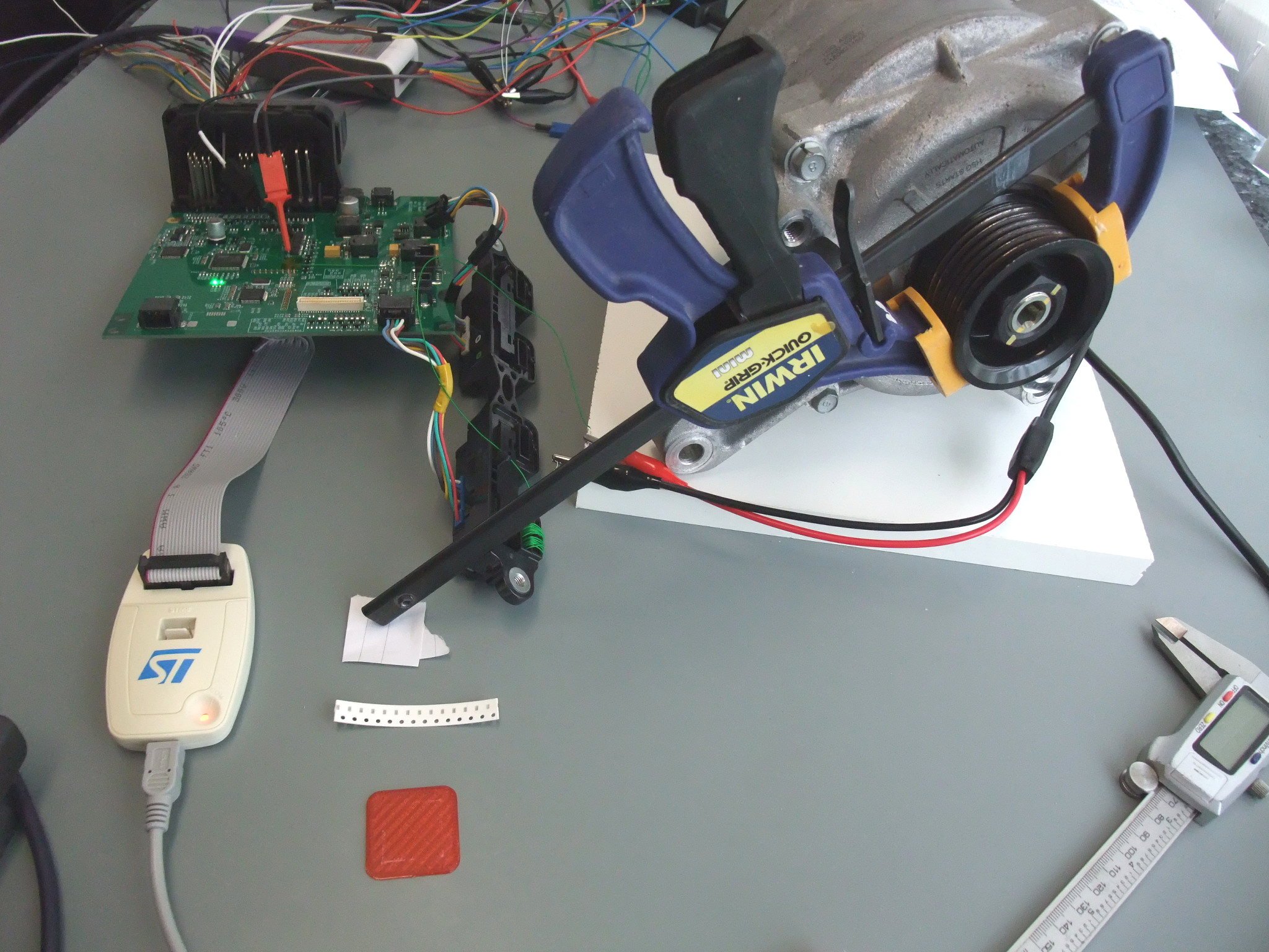

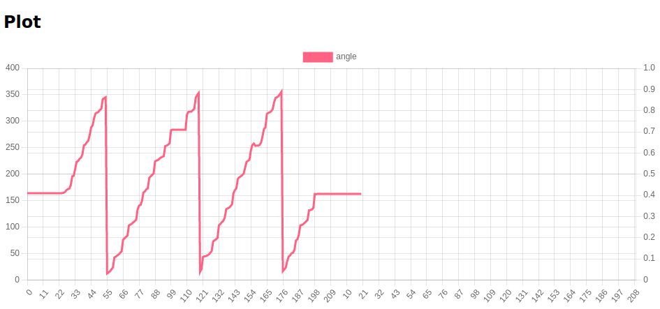

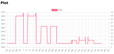

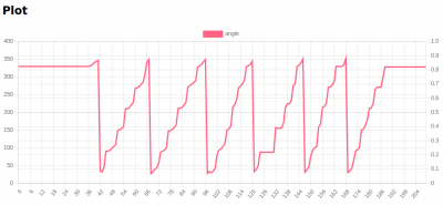

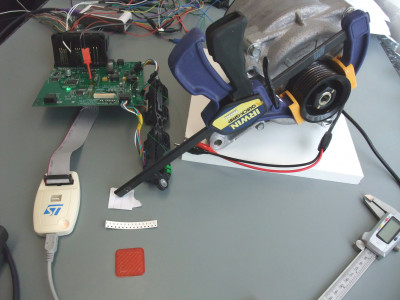

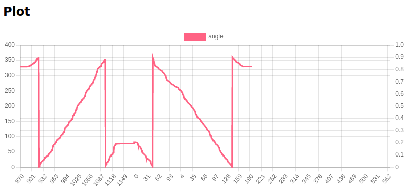

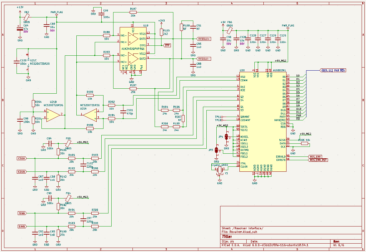

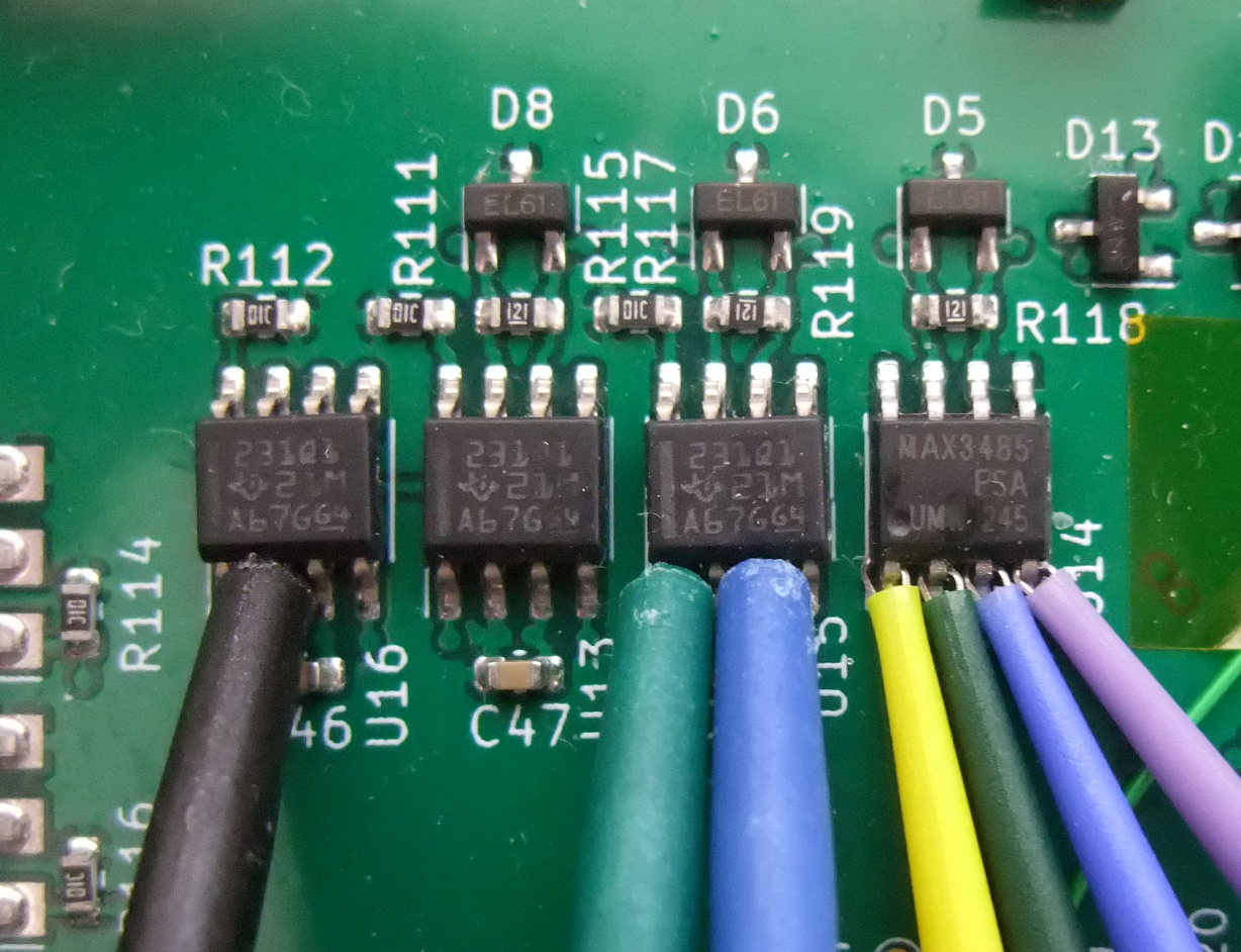

On to more interesting stuff I've actually done a bit on the logic board. The resolver interface is now tested and working :)
The interface is based on the AU6802 smartcoder interface IC that is used on the Toyota Logic board. I de-soldered them and have used one on my board. It's a big relief that it works as I was worried that I might ave removed a working resolver interface and replaced it with one that didn't work!
The advantages should be that it gives better resolution and lower noise and so far the results back this up. First slowly rotating the motor (using a clamp to give leverage and avoid cogging effects as much as possible):

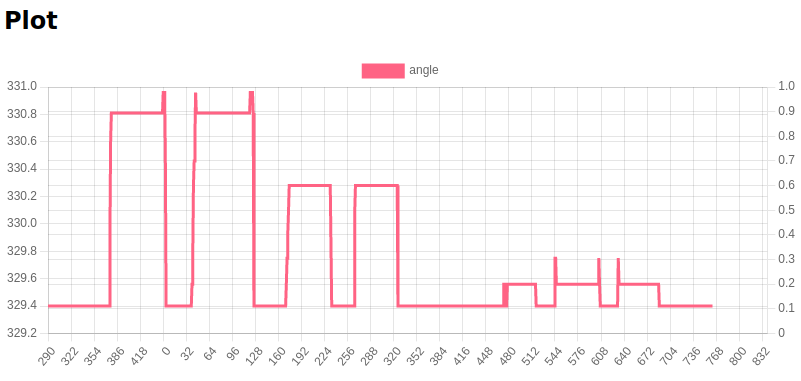

And small movements by packing under the end of the clamp with 0.2mm, 0.6mm and 1mm spacers:
Still need to check the pole count to see if the absolute values are right (anyone know how many poles the HSG resolver has?) but they look believable. Noise levels are below the measurable limits and the resolution looks to be down below 0.1degrees so pretty happy with that.
The drive level to the resolver is 4Vrms (11.2Vp-p) at 10kHz - does that seem reasonable or should it be a bit more?

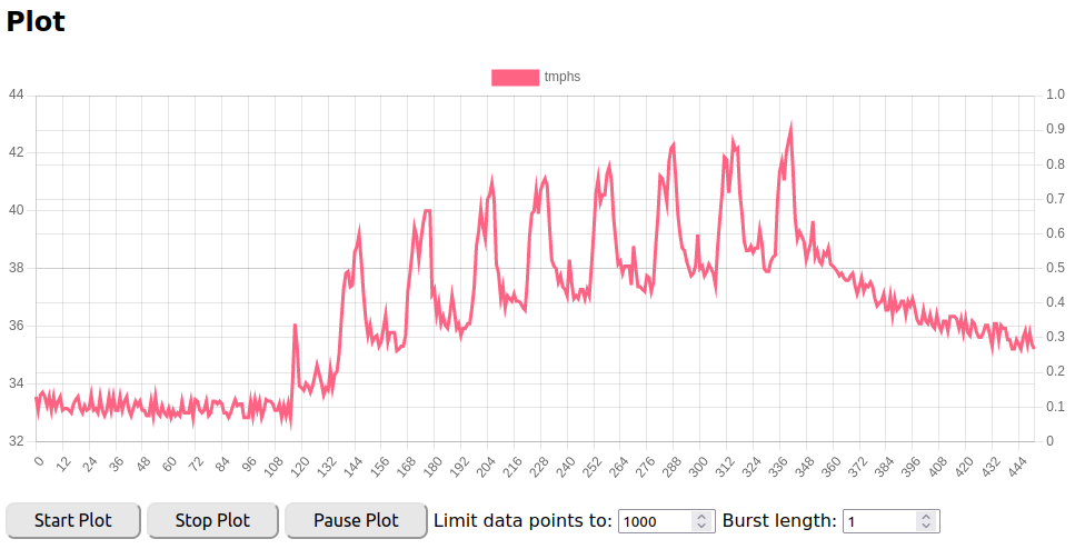

Hope to get the inverter bought in and try spinning the motor this afternoon. I've added code to do 4 semi automatic setup steps. The first just provides resolver output without PWM being active (used above). The second checks the phasing of the CTs against the PWM channels. The last two test spin the motor, either forwards or backwards,as if it's a stepper motor (just D current, no FOC control) while measuring the resolver output and the driven angle. When syncofs is right the driven angle and resolver angle should match.

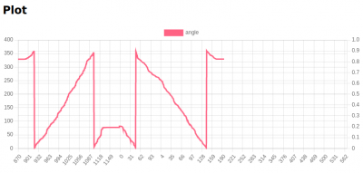

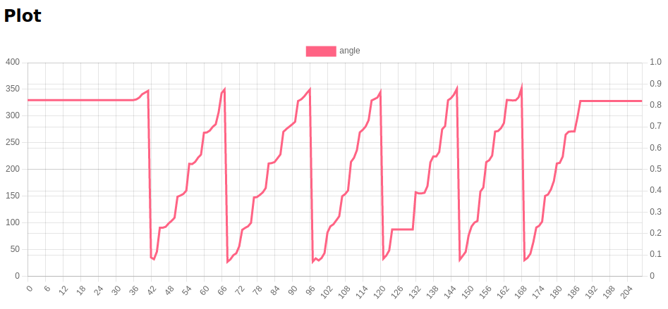

Edit - I'm being dim again, now the resolver is working it should be possible to count the poles however on doing 1 full revolution of the motor while monitoring the angle I get this:
Now this would make it 6 pole pairs wouldn't it? The only post I've found says it should be 3 (HSG Poles) so what am I missing?
Edit2 - Still being dim! Forgot that the motor pole pairs parameter affects the resolver measurement. It was set at 2, setting it to 1 to match the resolver and another turn of the motor now gives:
So 3 pole pairs - much better :)

That’s an impressively clean signal there! Resolution looks great this can only mean good things for your build! Sorry to hear about your health and energy level problems, I swear I go through periods of feeling very similar most days I’ve only got a morning of hard work in me, I just put it down to getting older! Lol
Pete9008
Posts: 1801
Has thanked: 102 times
Been thanked: 348 times
Re: Smart Roadster (with Prius Gen3 Inverter and Outlander Rear Motor)
Post by Pete9008 »
Yep, pretty happy with that although it remains to be seen whether it's still that clean once there are PWM currents flowing in the motor!
Your comment on energy levels is interesting, it exactly matches how I felt 10years ago before changing my diet (and inadvertently increasing B12 content) and more recently before starting the B12 supplements. Both times my first thought was I'm just getting older but then I'm only in my 50s now and have friends, relatives and colleagues who are 10, 20 even 30years older who have more energy. On reading up B12 and D3 deficiencies can both cause fatigue, and both seem surprisingly common. A supplement should do no harm at all and may just help so are well worth a try!
Didn't manage to try spinning the motor, partly ran out of energy but also decided that my bench power supply wasn't up to it. New 0-30V, 10A one on order which should also be useful for testing 12V automotive bits in the future.
Edit - In case anyone is interested this is the resolver interface I'm using. The schematic is for a parallel interface but the chip can also be used in SPI output mode which should be compatible with the standard F103 chip.
Edit2 - Aaargh - shouldn't have posted that schematic, it was tempting fate. The resolver is now tripping out on an error after a few hundred ms :(

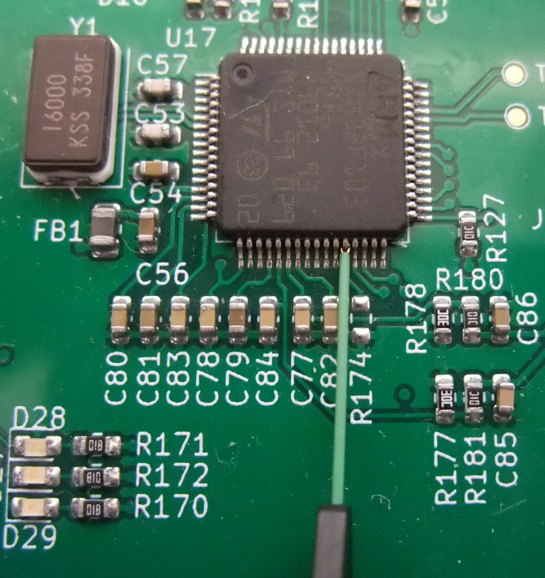

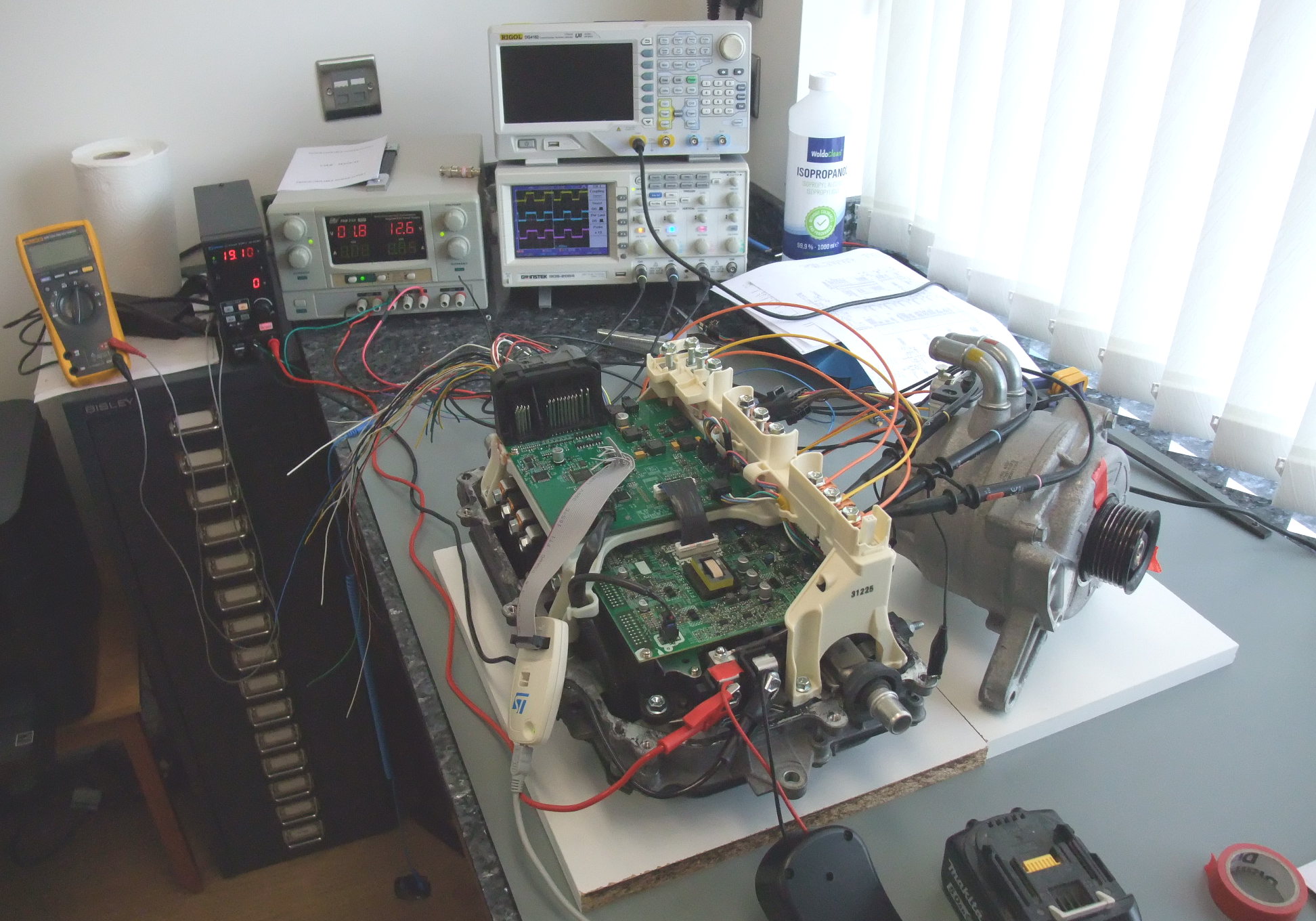

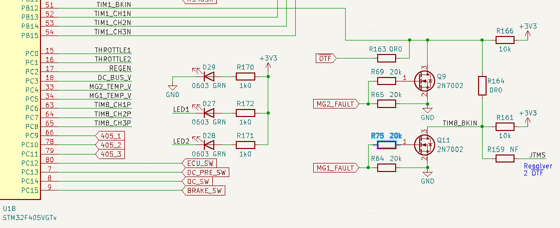

Right - it seems that plugging my logic board into the inverter stops the resolver working!
Seemed really odd because I didn't think there was any connection between the two. Turns out I forgot that the OTF (over temperature fault) line from the the op-amp used to drive the resolver is also a shutdown input. The inverter is driving the MG fault line active which is backfeeding the OTF line which turns off the op-amp so killing the resolver drive. The resolver IC sees the low level, flags its own error (low drive level) and shuts down.
So it's looking like my inverter may be dead :(
Is there anything other than an IGBT problem that can cause the MG fault lines to go active? Does it need HV connected, if so what's the minimum voltage? Or do I just have a faulty inverter?
Edit - starting to wonder whether I've misunderstood how the MG fault lines from the Prius inverter work. Does anyone know whether they are active high or active low?
Edit2 - balls - they're active low, I've got the board logic wrong :( although that might mean that the inverter still works.
Pete9008
Posts: 1801
Post by Pete9008 »
Ok - Not a big problem, this is the circuit:
I can just remove R163 to isolate the OTF line, lift R164 to isolate MG1 and MG2 faults and then change the BKIN pins to accept an active high signal instead of active low. It means I no longer have any access to the resolver drive over temperature flag (unless I mod wire it to a spare pin) but I can live with that.

OK, the logic board and inverter both now seem to be working and I have PWM output :)
The main problem, apart from the above, is that the HV supply terminals detailed in the wiki only work if the inverter capacitor pack is connected. Without it you need to connect power directly to the bus bars (seems incredibly obvious now I type it!).
The automated phase check seemed to work well too giving a very clear indication of the swaps needed. Unfortunately I now seem to have managed to break it while messing with other bits of the code.
I've even had the motor turning, well sort of and only in the test mode but it's very jerky. Need to go through things properly and have a look at the voltage and current waveforms tomorrow to see what's going on.

It's working :)
Turns out the code was fine, the problem was the cheap and nasty croc clip leads I'd temporarily used to connect the motor to the inverter which are now going in the bin. Replaced them with some proper crimped leads with spade terminals to connect to the HSG. Afraid I don't know how do videos but here's a picture which includes the scope showing phase waveforms.
The motor is spinning much better now, still slightly uneven due to the poles/saliency but not bad at all given it's running on pure D current. The phase detection, resolver setup and test spin steps all seem to work nicely with the new motor leads (I'll put a post up layer with details on the auto setup thread - Edit - done see viewtopic.php?p=56416#p56416).

On a vaguely related topic I've been getting fairly fed up with trying to connect up my logic analyser when debugging. Basically I've been using the fairly poor quality probes that came with it. Recently had to order a couple of chips so to get over the threshold for free delivery decided to splurge on some new probes and thought my findings may be of use to others.
First some micro probes. Decided to go for these Micro probe link. Here is a picture showing the difference, old probes on the left, new ones on the right:
The standard clips can only get every other pin on a 1.27mm pitch device while the new ones can get every pin. They also have two connector pins which means a single probe can drive the logic analyser and a scope at the same time.
Also got one of these Nano Probe link and here it is connecting to a pin on a 0.5mm pitch IC:
Well impressed with that! Always found it a right pain making a connection to fine pitch pins.
A little pricey but overall worth it.

Well after a little over a year of messing around with this stuff the motor has just spun properly - real FOC control this time too :D
It ran pretty much first time using the settings generated with the auto/assisted setup process detailed in the other thread and spins nice and smooth.
Couple of slight issues. First I've re-written the pot code to support three pots, dual redundant throttle inputs plus another for regen - it seems to work fine but potnom is being reported wrong in the web interface. Reverse also doesn't work - pretty sure I've missed a sign inversion somewhere when translating to floating point (it's only ever been simulated going forwards).
Given that this is a completely new logic board, a new resolver interface, new analogue input circuit, different processor, ported code (including floating point main control loop, pseudo MTPV, reworked resolver and current sampling timing and ISRs) and a new motor setup process I'm pretty happy with that!
Plan now is to fix the above bugs, work though the rest of the hardware (need to characterise the temperature sensors) and figure out how to set up regen and test that it works too. Would also like to take a log to feed through the calculator to find optimum values for Lq, Ld and flux linkage for the HSG - but I appear to have broken the web interface logging too!
Edit - might have to take some of that back. Every minute or so it hiccups, only for a few ms, heard as a slight knock and a slight drop in speed before it recovers. Looks like I may need to get the binary logging going again to catch it and see what's going on.
Edit2 - going to reserve judgement on the hiccups for now. Having dug a little deeper it's pushing quite a way into FW (it's only running on 20V, so could be running out of volts), working at very low currents so noise levels are relatively high and I haven't even tuned the control loop gains yet!

Little more progress.
It's now running in forward and reverse - had missed checking the sign of Is when calculating Iq and Id!
Hiccuping seems to have dissapeared. Not sure whether this is linked to the above, FW which is now disabled or down to a dodgy connection on the forward input (really should make all the connections properly now it's working, just twisted together at the moment).
Web page logging is now working and the graphs are working better too. I'd been reporting the wrong value for the version spot value which meant the web interface was using the get command rather than stream which was massively slowing things down!
Still got an intermittent comms problem which I think is down to the way the RS485 direction control is done (I think occasionally the end of DMA ISR is dropping the transmit enable just after a new transmission has started). Bit more debugging needed.
I also tried taking a log and feeding it through the calculator to work out motor parameters but without load it doesn't work too well for Ld and Lq. Indicated that flux linkage is around 75mWb though.
Ohh, and the old way of calculating syncofs gave exactly the same answer as found using the new test mode method.

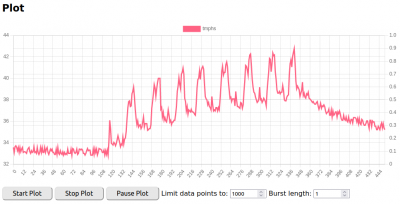

Thought the following was interesting. Now the temp sensor is working I was curious whether running the motor (without any coolant) would cause a temperature rise so I put the inverter into test spin mode at 15A and plotted the temperature and this is what I got:
You can clearly see where I started the motor at around 115 and where I stopped it at around 340. What I found really interesting though is that you can see the temperature changing as the load in the individual phases changes (the test spin is pretty slow). This suggests that the temperature is actually a die temperature not a heatsink temperature. Had a quick look at the board and the middle IGBT driver on the middle phase has an extra opto (all the others have 2 this one has 3) so I'm guessing that the reported temperature is actually the die temperature on the phase 2 IGBT die??
If this is the case then I'm happy to run things a little warmer!
bexander
Posts: 835
Location: Gothenburg, Sweden
Has thanked: 63 times
Been thanked: 89 times
Post by bexander »
My experience is that the temperature is difficult to monitor as it changes so much with load.
Maybe better to use the coolant temp sensor, but it might be on the slow side? Or maybe move the coolant sensor closer to the heatsink?
Pete9008
Posts: 1801
Post by Pete9008 »
If it was the die temp then that would make perfect sense.
The IGBT to heatsink thermal resistance and the low thermal mass will mean it will vary a lot with load. The upside is that it should be safe to allow it to go right up to the IGBT limit (125C?? - need to check) rather than the heatsink temp which is likely to be tens of degrees cooler (and as you say much slower to respond).
Edit - just checked and 150C seems to be a common max IGBT junction temperature.
Could really do with verifying the sensor calibration at higher temperatures. I'm not keen on putting the entire inverter in the oven so will need to look out for a dead inverter to do some tests on.
