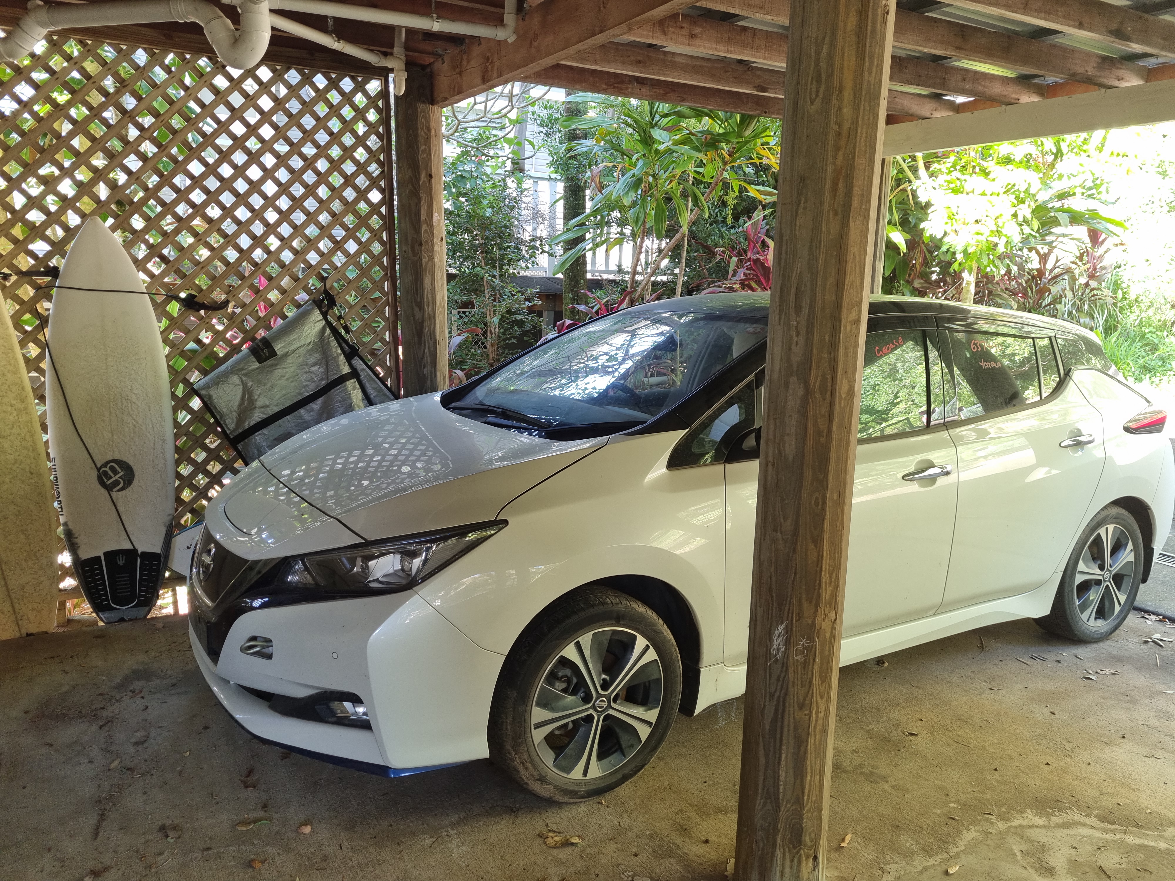

I've been sitting on an AE86 for the better part of 20 years. It was my daily driver for a while and then sat for years. It's now time to revive it and electrify it.
The plan is to use all the running gear from a Nissan Leaf, I have a 2019 (ZE1), and move it all over. I had hoped for a 62KWh variant but wrecked/second hand EVs are still hard to come by in Australia. Because the gearbox in it is 40yrs old and was never considered sturdy to start with, I'm swapping that out for a TL70 from a GT86 and intend to use the same mating as Zapatero used in his GT86.
I'd like to keep many of the ancillary features of the Nissan to modernise the AE86 but will hold some of that over until after it's running and registered. This is intended to be a restomod project so purists might not love it but I want a EV run around that looks good, goes well, and I don't have to wake up the family if I'm going out for a very early morning surf!
I expect to have the Leaf in parts in the next two weeks and then start fitting up the motor & gearbox, and the batteries to the AE86 and have an engineer lined up to sign off on those and other critical parts of the build. I am working to a June timeframe to have all the engineering signed off as the car's booked in a body shop to get cleaned up, have a new JDM body kit fitted and fresh paint.

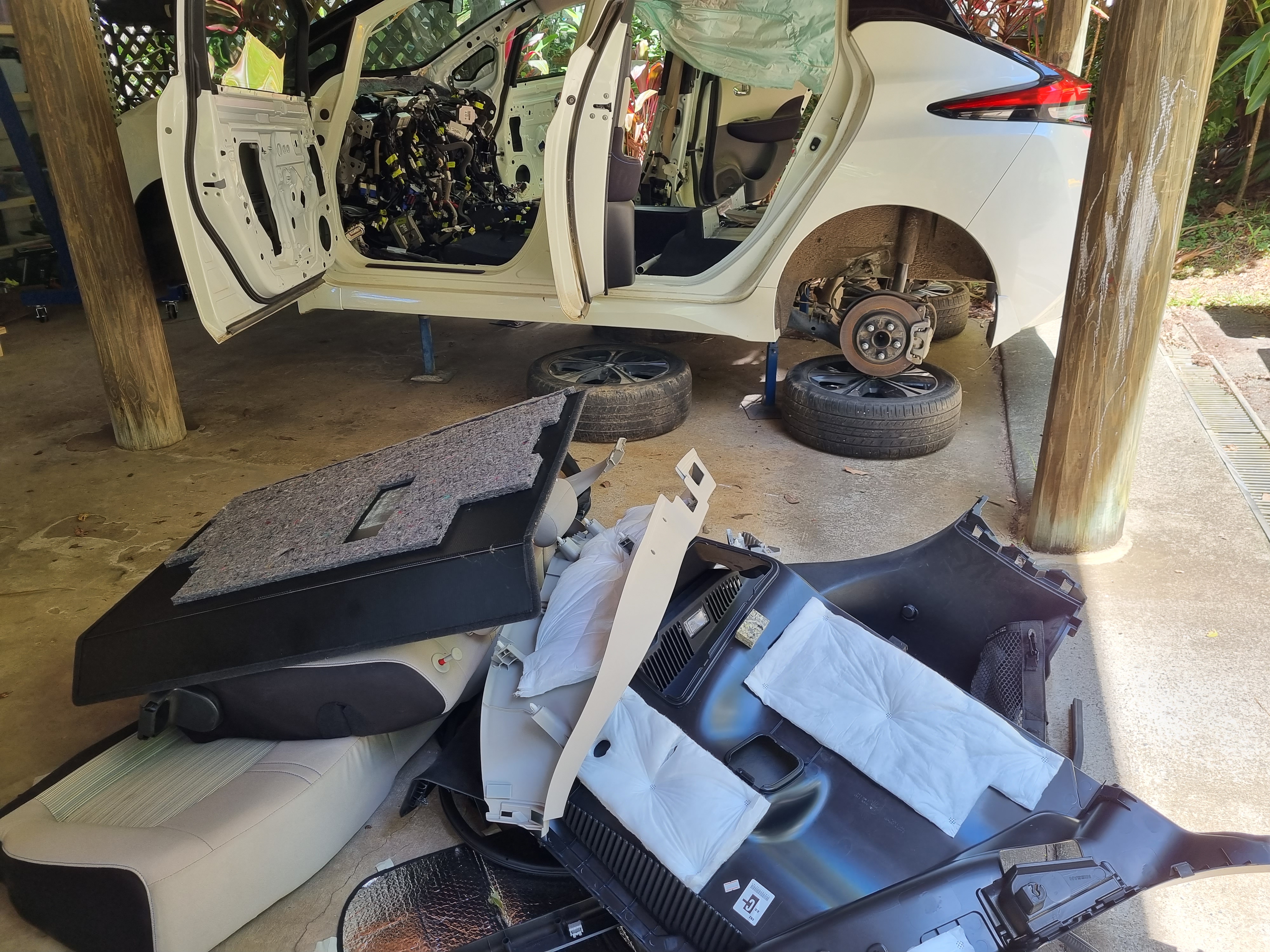

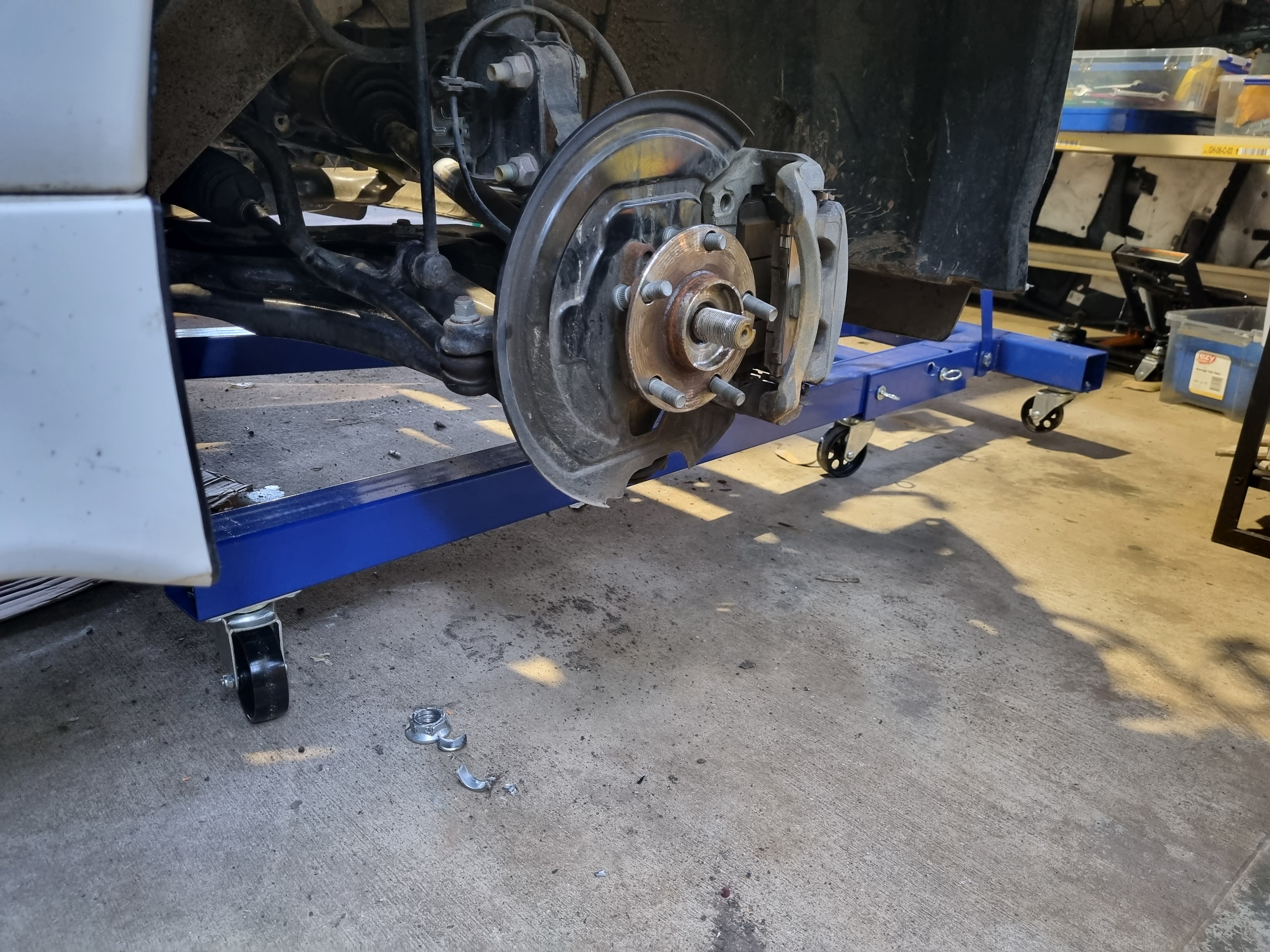

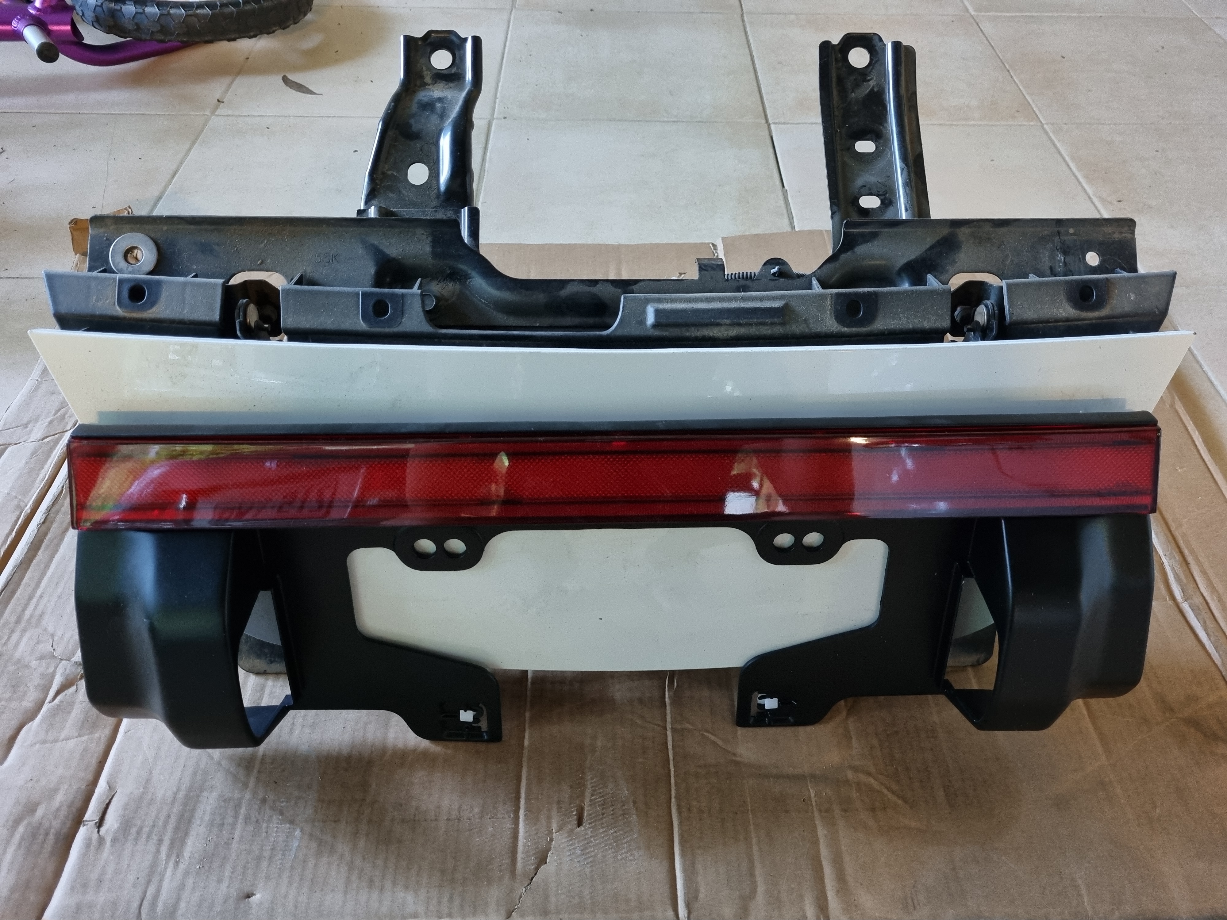

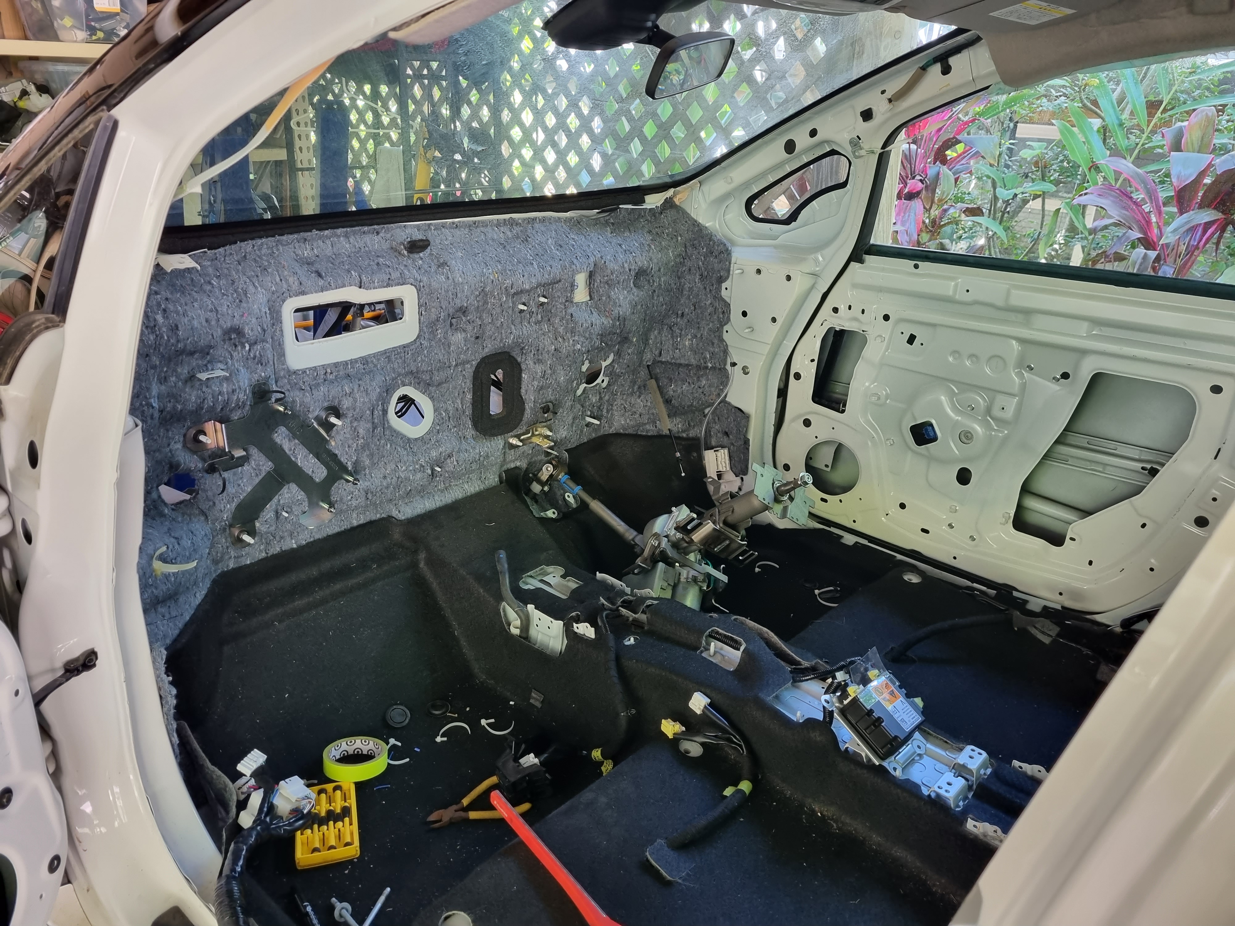

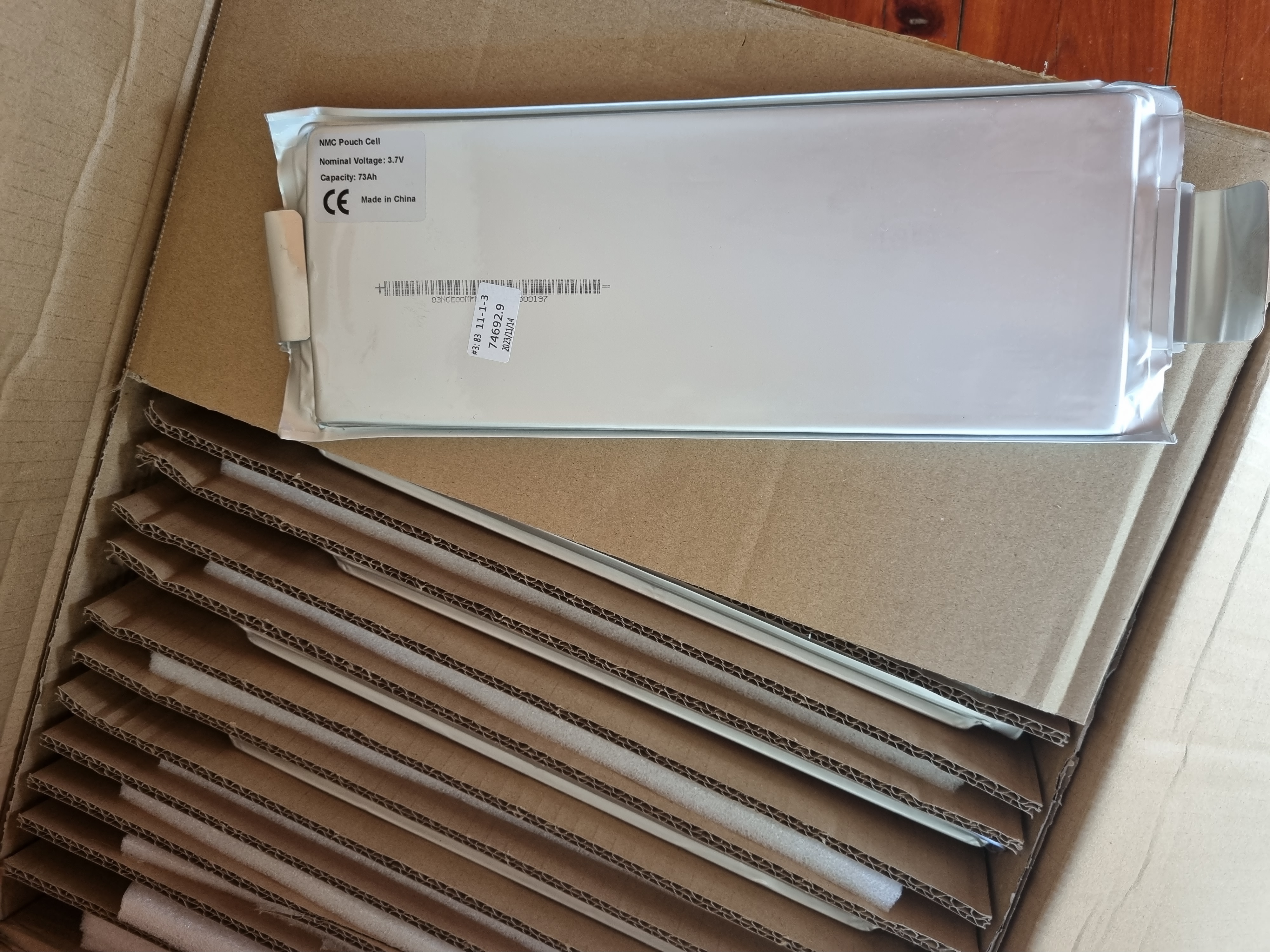

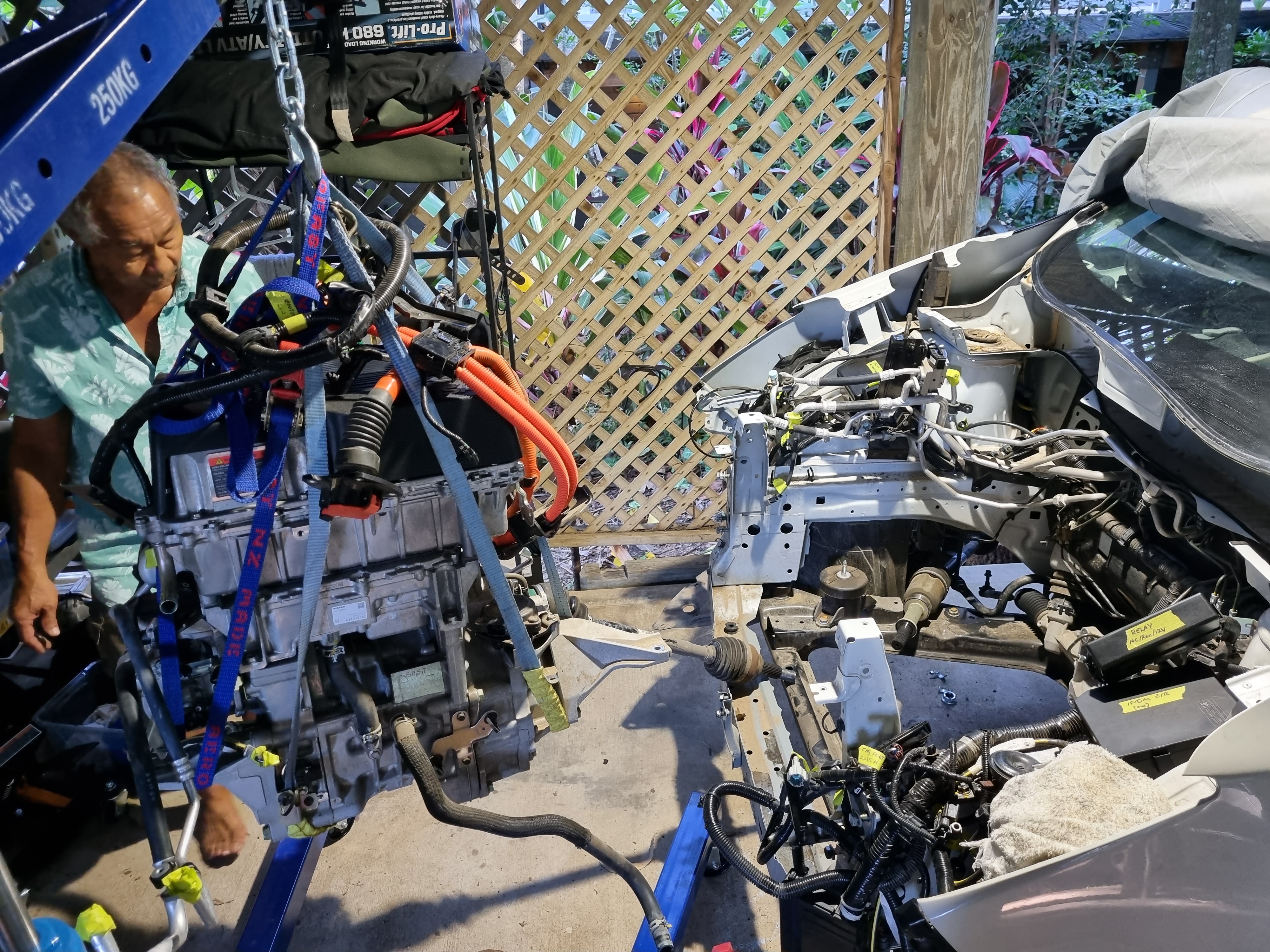

The Leaf (my little girl named it George) has been disassembled and I will be getting rid of the shell this week to make space for the AE86.
The engine removal was relatively straight forward after I'd managed to get the locked hub nut off the axle - that took a bit of persuasion with a grinder, big hammer and punch, and a pipe wrench. I also put my dad to work! Before it's carted away I'm going to take every last bracket off it so I don't have to re-make anything later.
I've managed to fill three tubs with wiring harnesses and will need to decide later whether I take out the extra wiring or not.

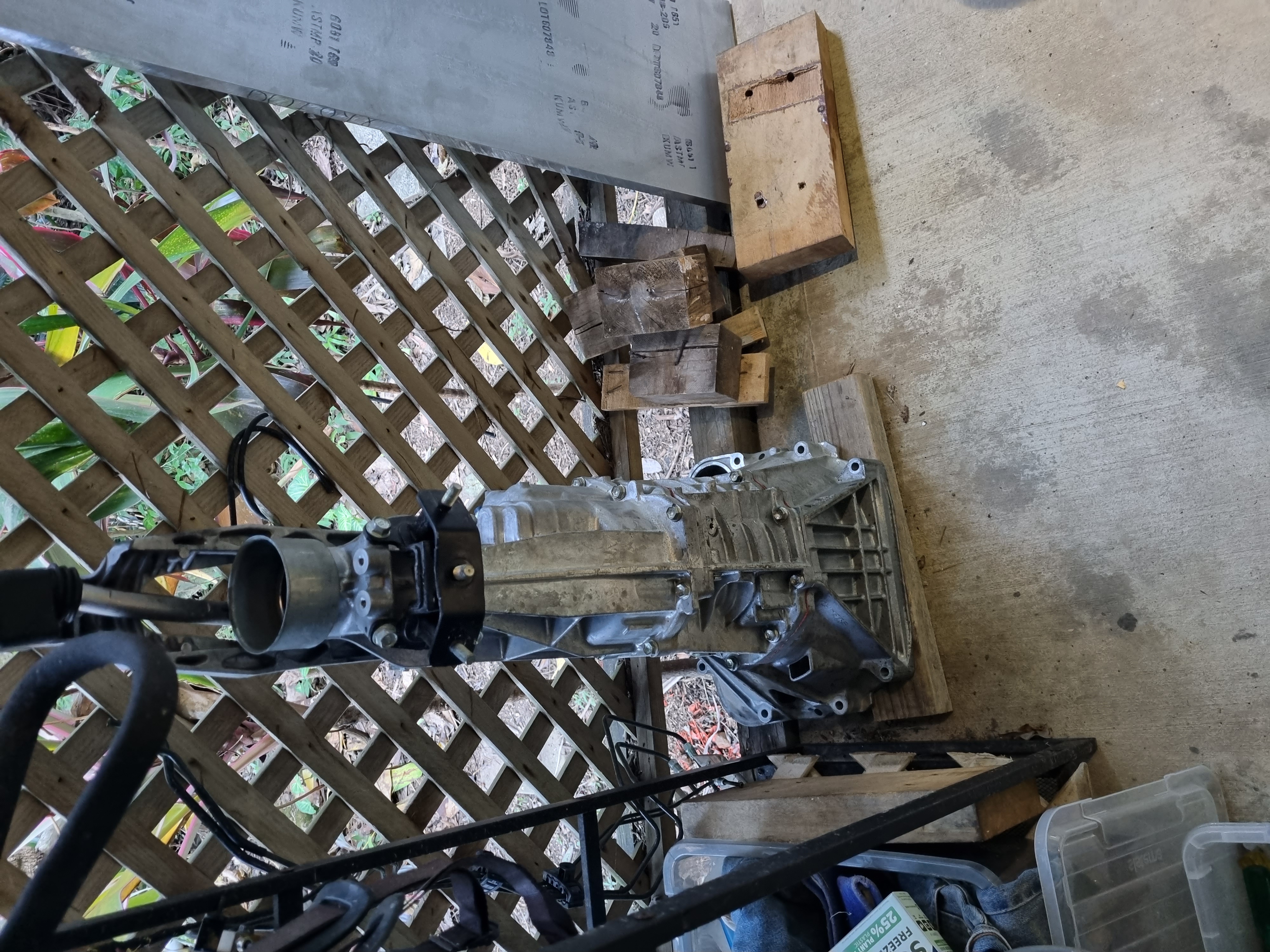

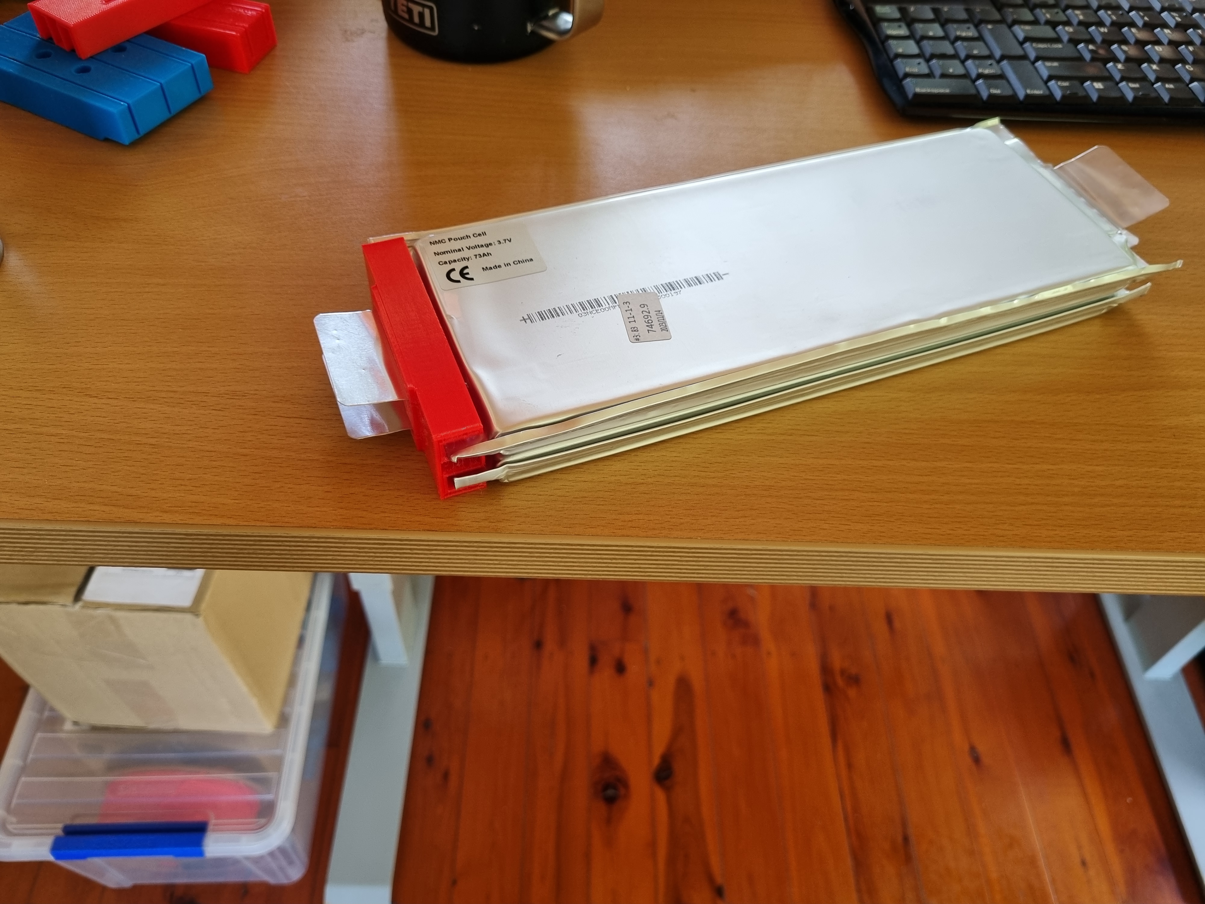

I also got hold of an almost new gearbox, 18,137kms according to the wrecker, last week. I will need to figure out a solution for relocating the shifter so that it lines up for the AE86.
The rough workplan for the fitment stage is:
1) Motor and gearbox mounting which will need engineering sign-off
2) Battery placement. I've got this sketched out on a scale drawing but need to mock it up to really understand the floorpan modifications required.
3) Firewall modification to layout component and wiring placement and ensure the right holes and mountings are in the engine bay and firewall.

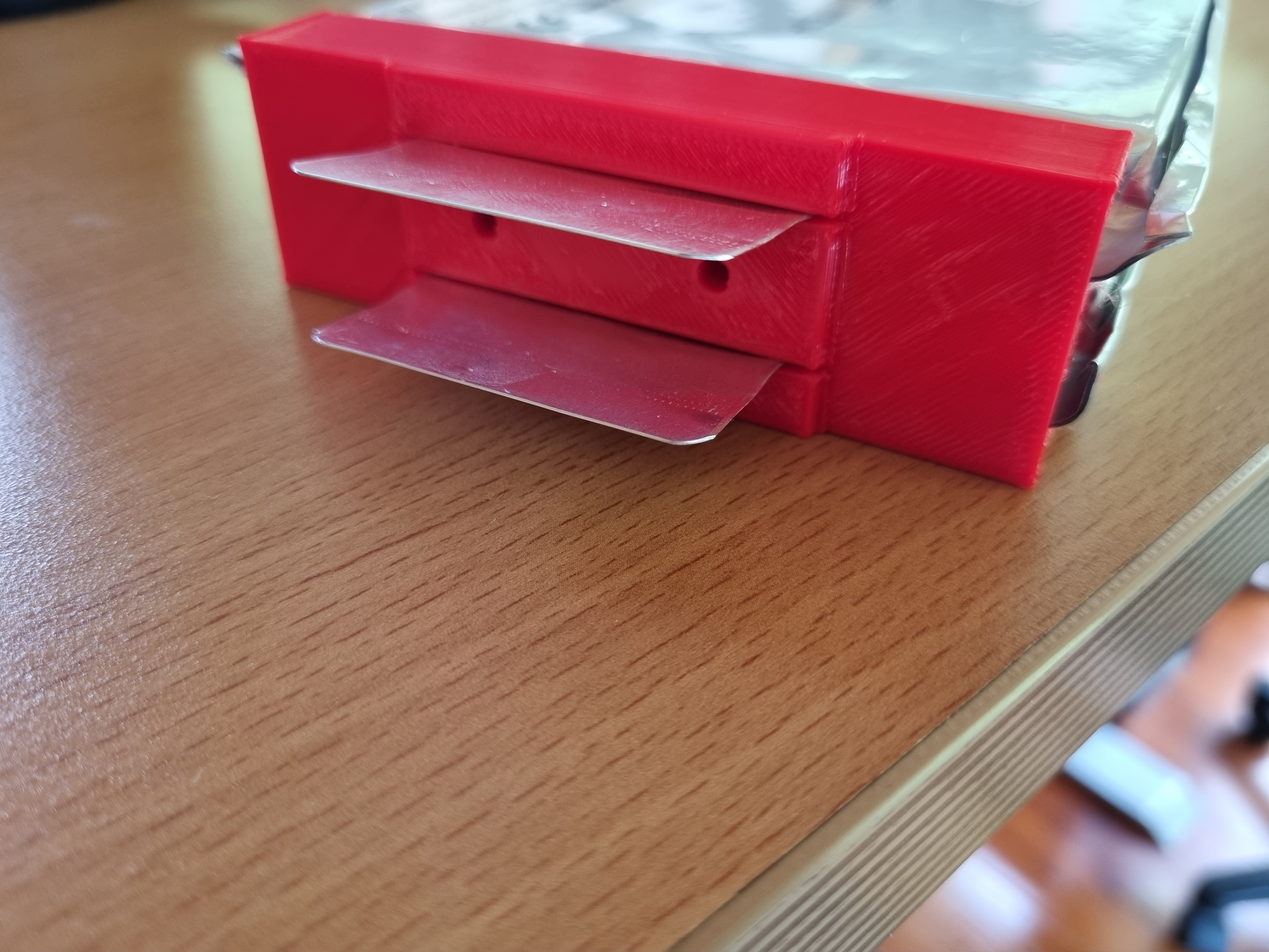

4) PDM position, HV cabling, charge ports (here's a peak at what I'm thinking)
It's a workday, so I'll leave it here.

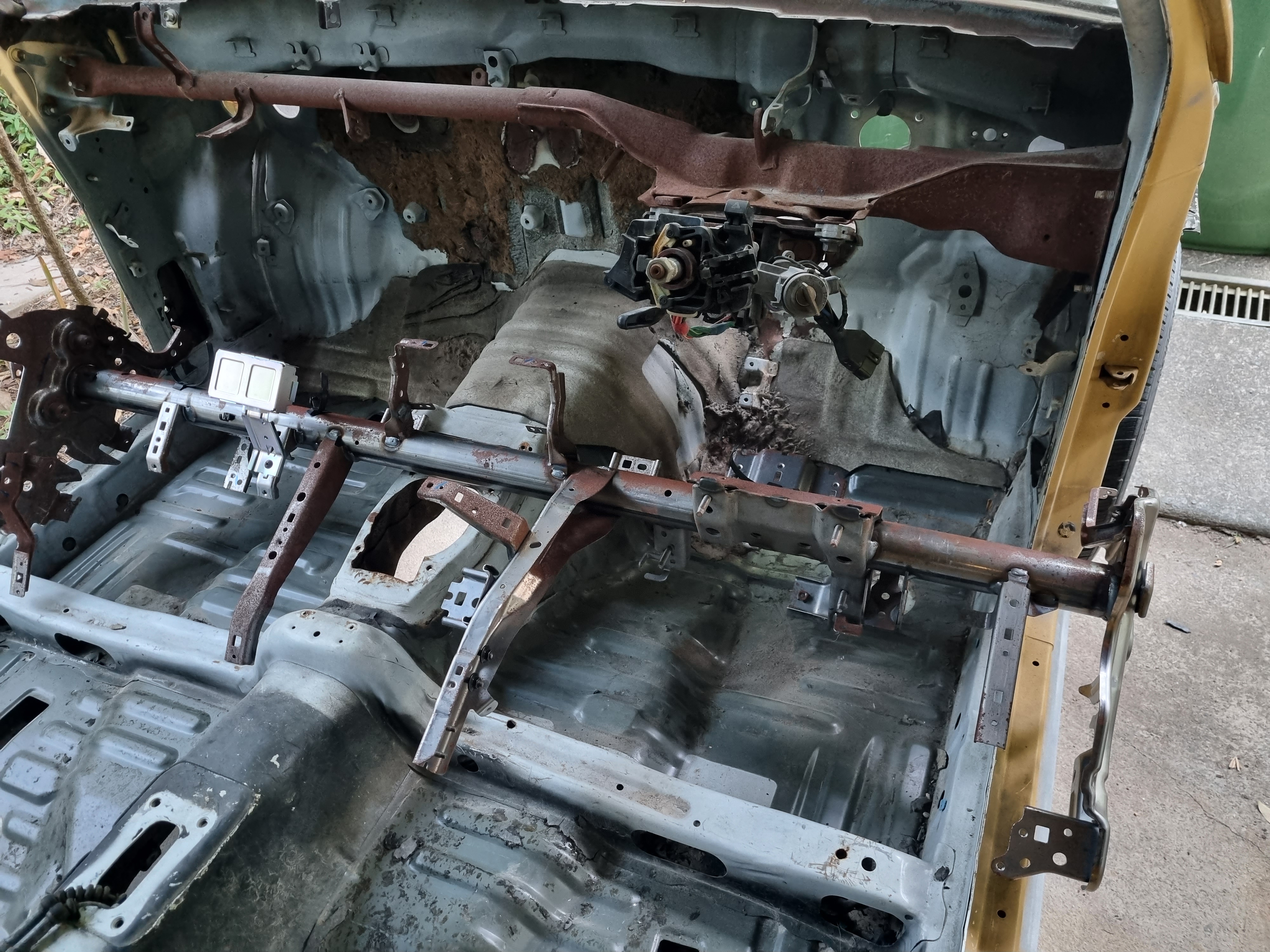

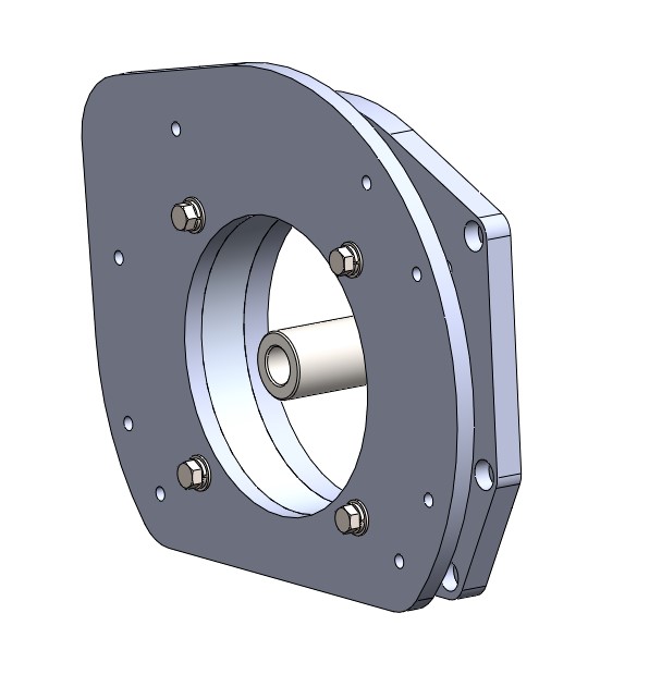

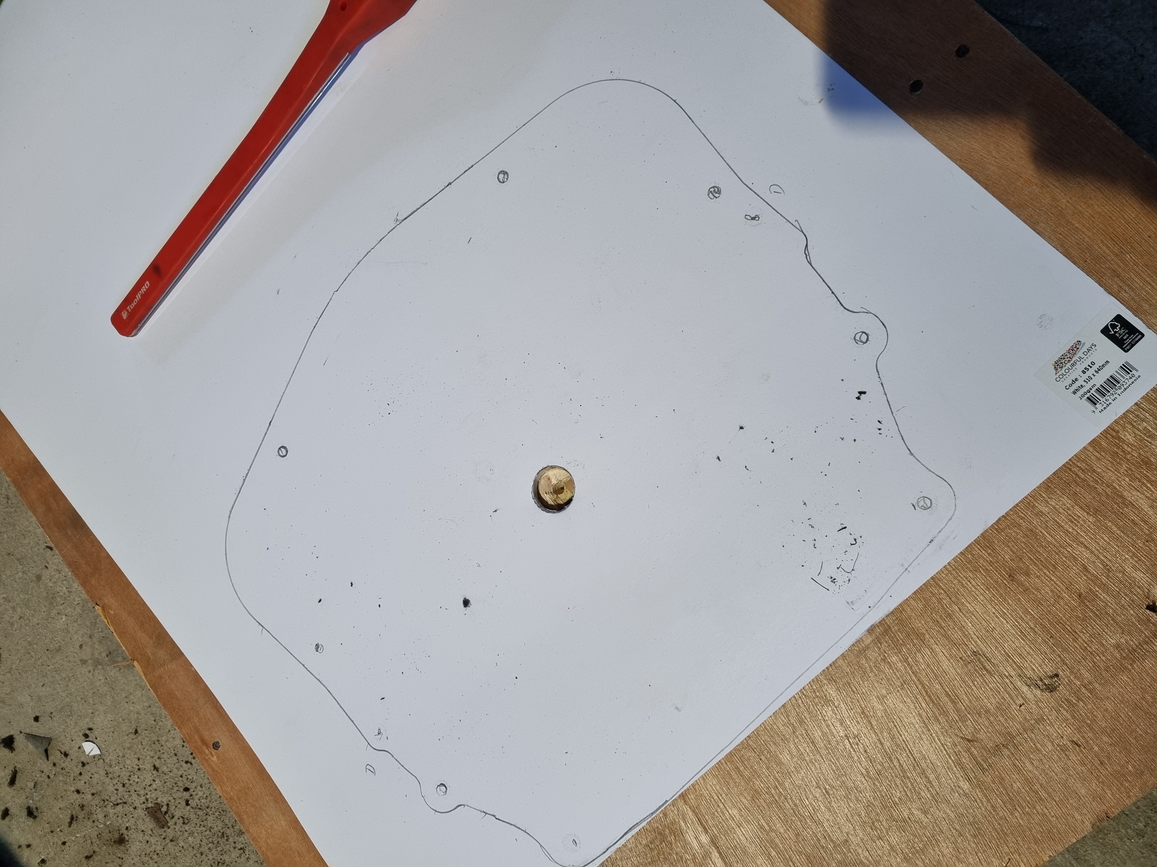

I have had a look at your adaptor plates (I actually have your shop page bookmarked). However, shipping a couple of plates of aluminium from Canada to Australia makes much less sense for me than getting them cut locally. In saying that, I appreciate the effort you've put in to design and manufacture!

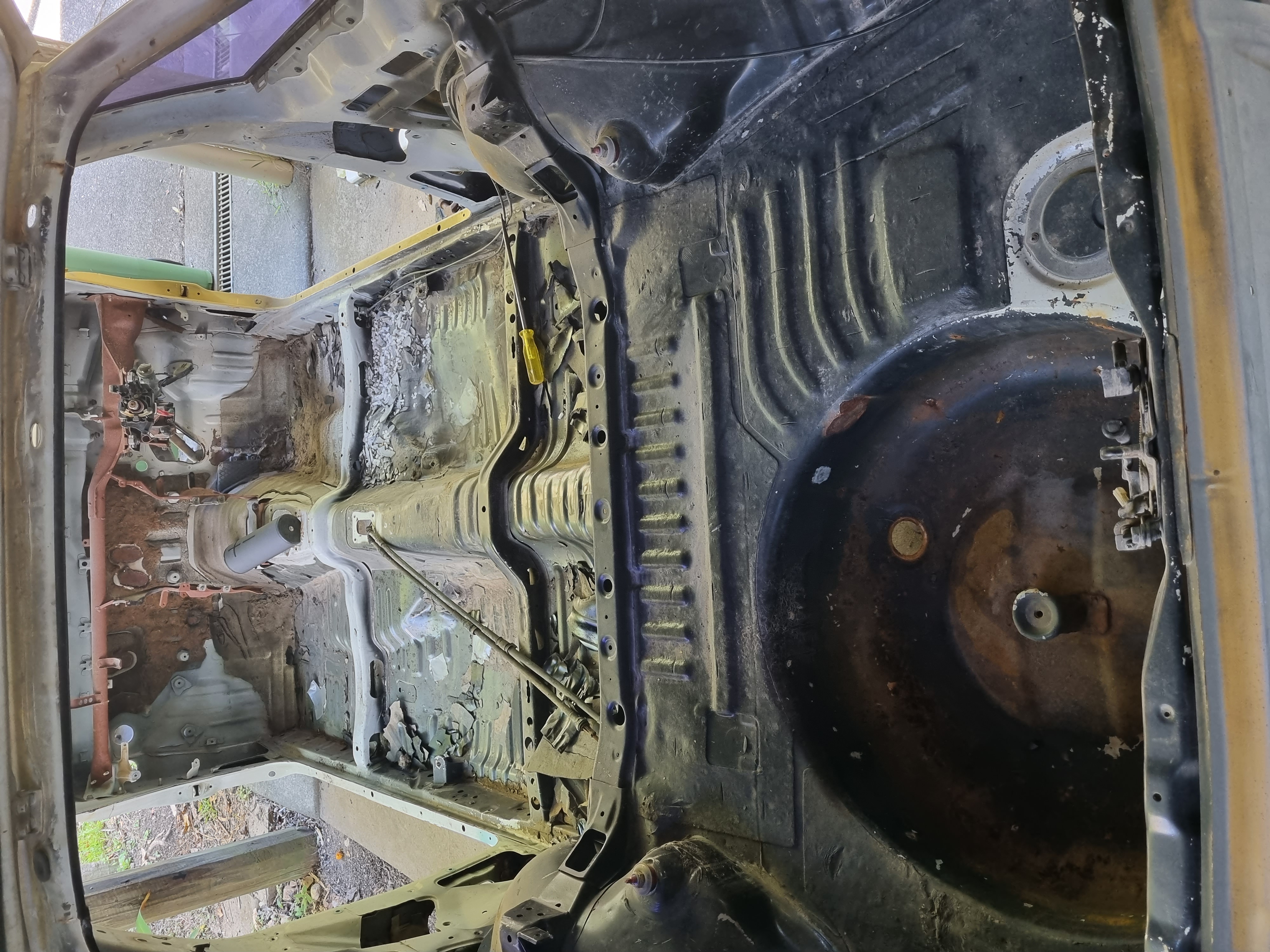

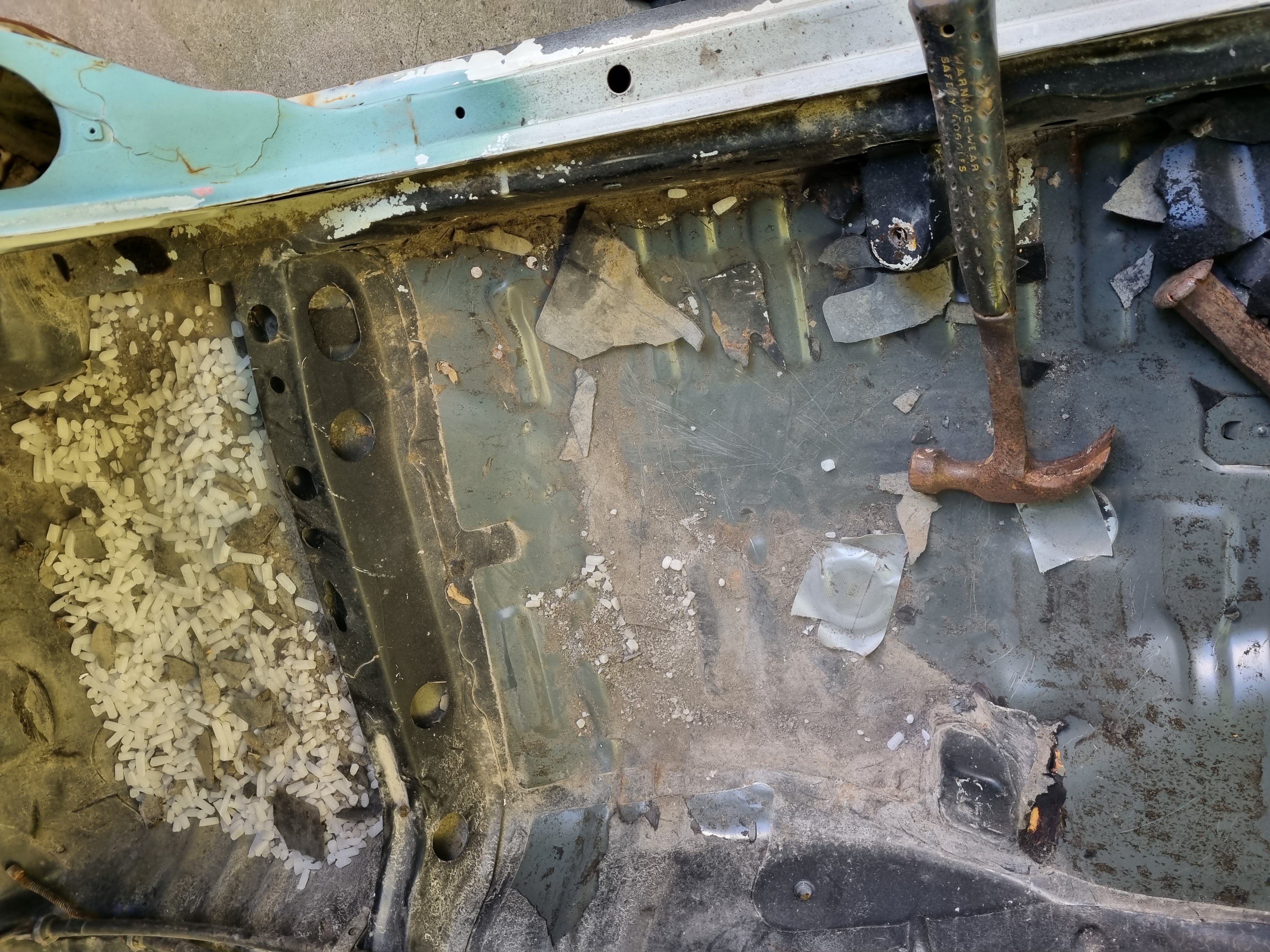

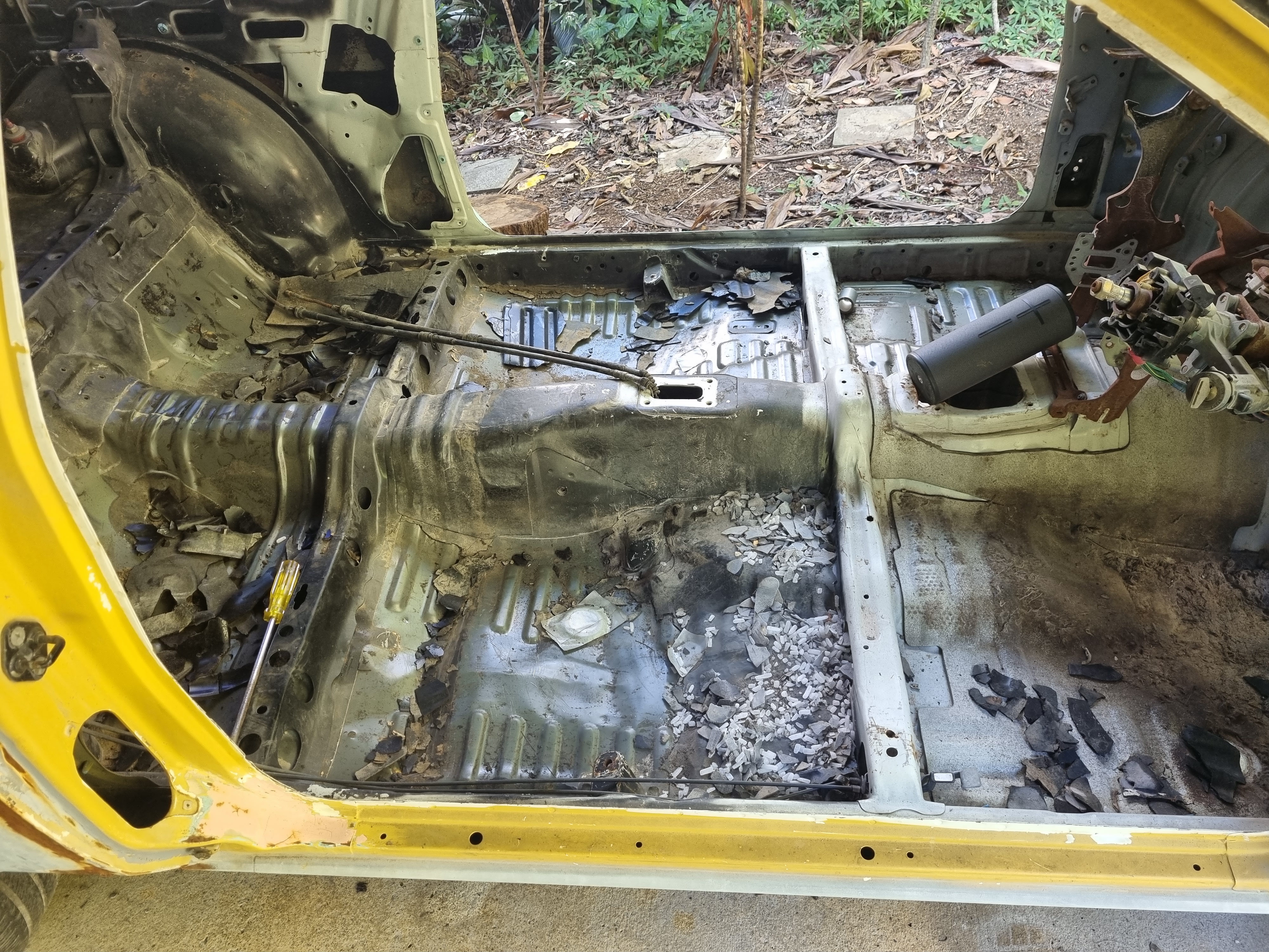

This is my offsider stripping the interior out of the rusty donor AE86.

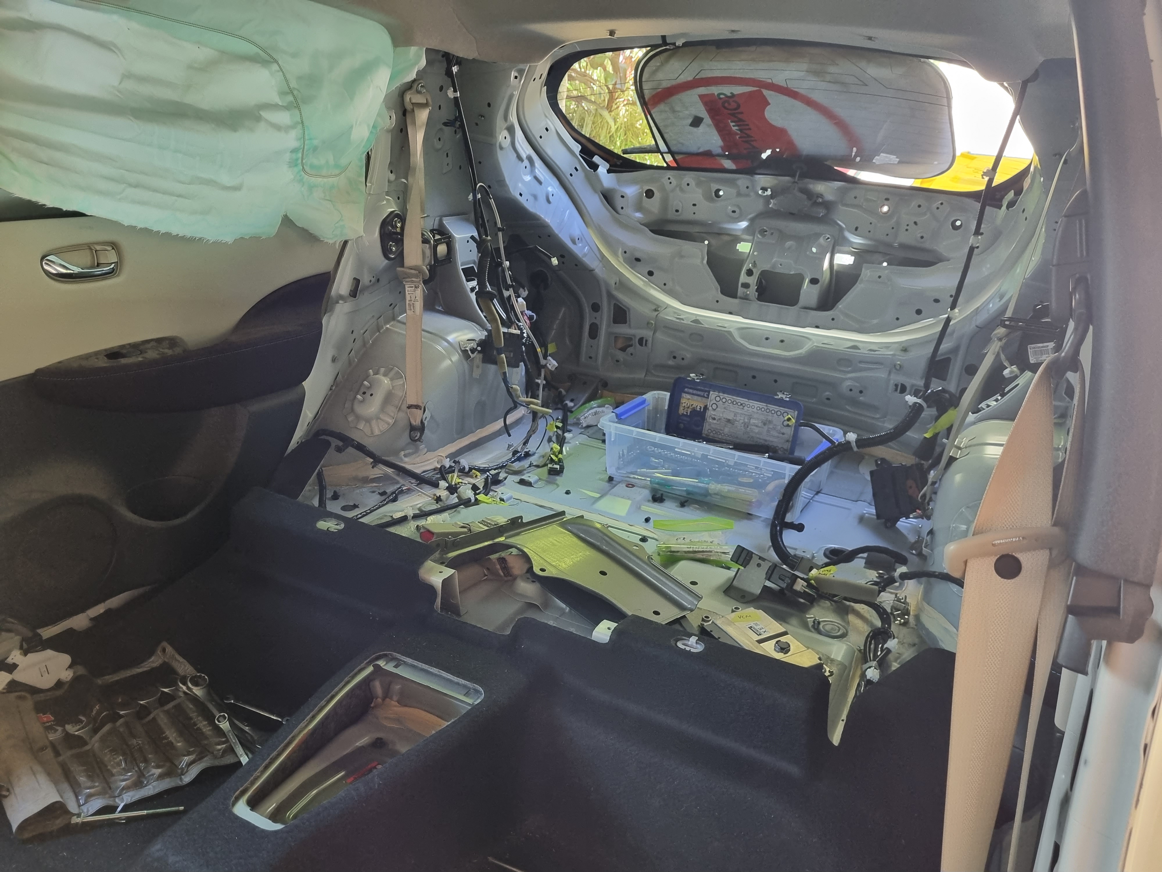

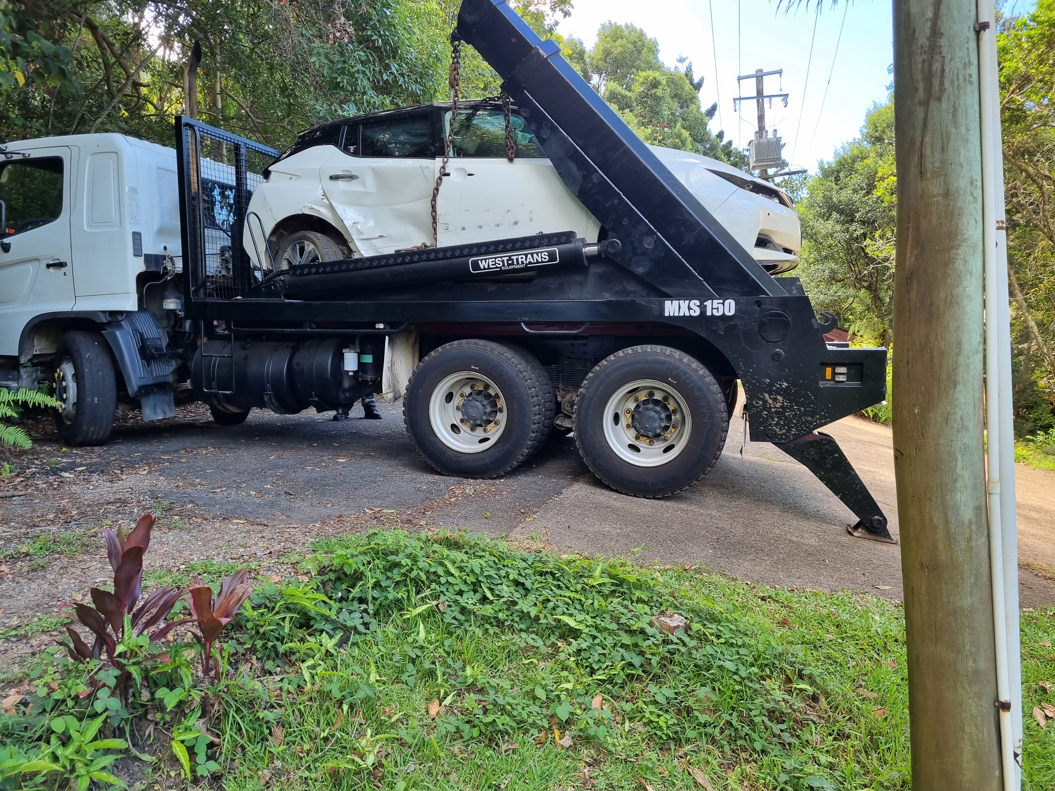

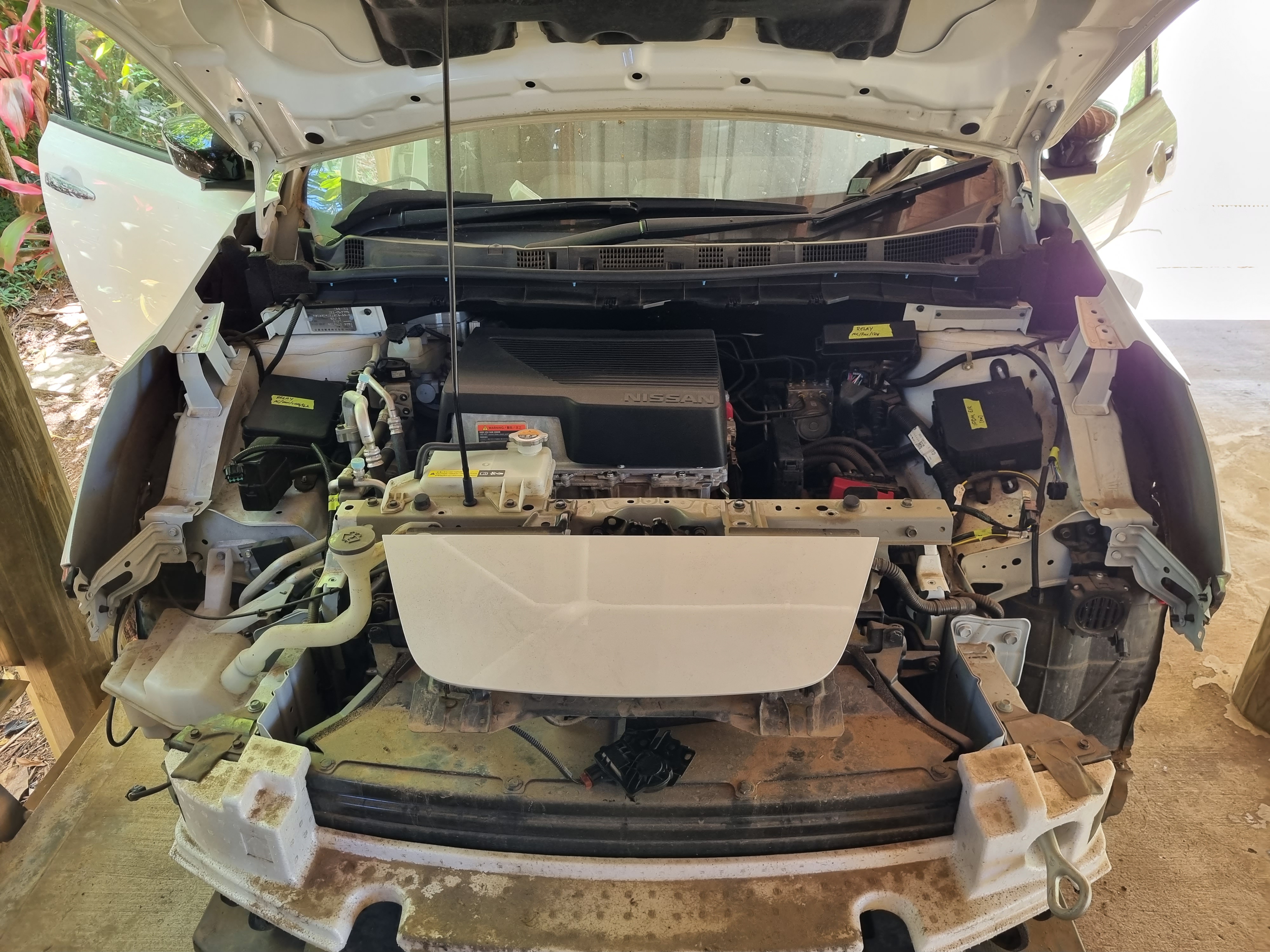

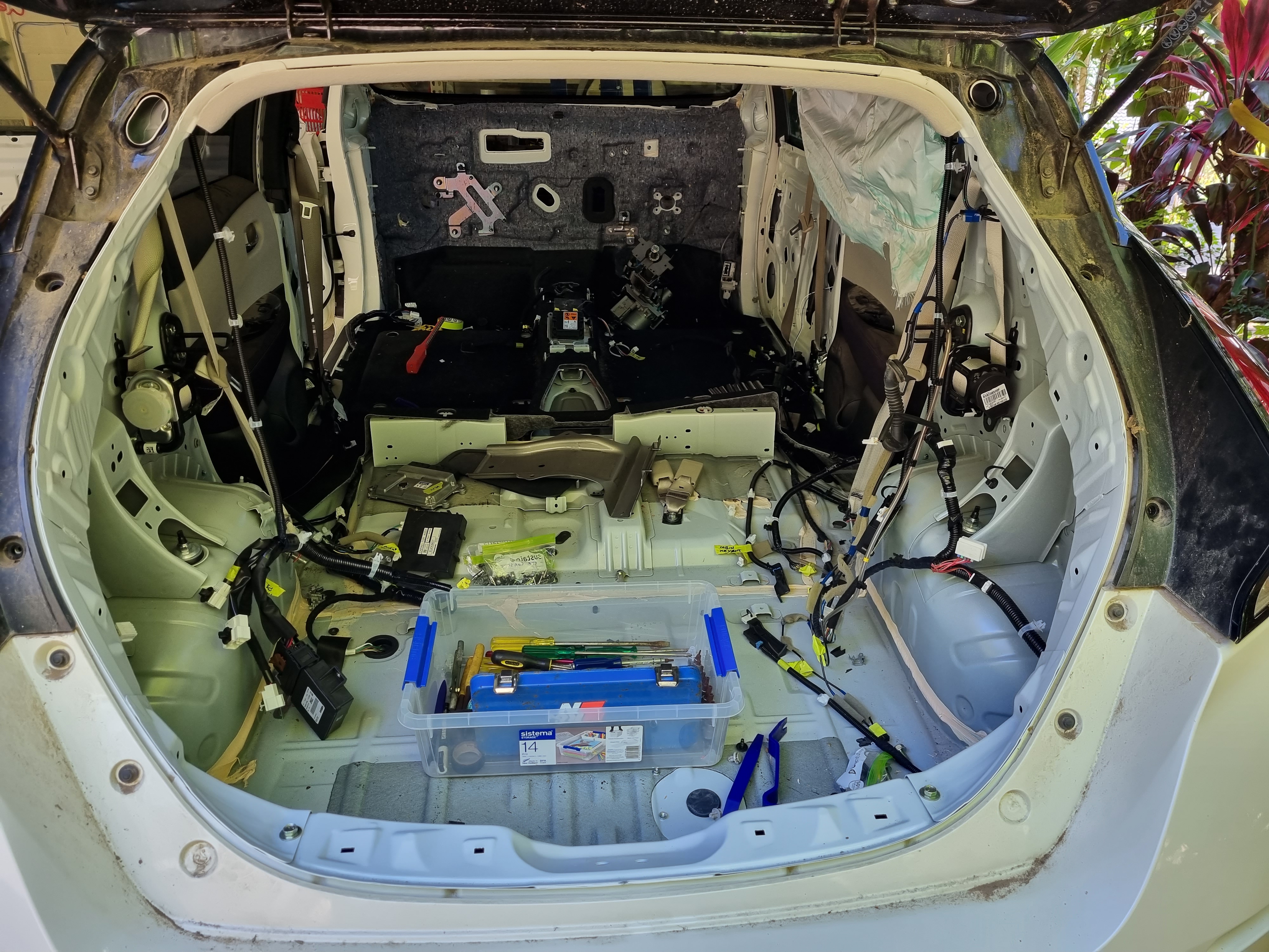

So, I got lucky!
I bought this leaf at a salvage auction and it was the only one salvage leaf I could find in Australia at the time. I took a bit of a gamble as the compliance plate listed the car as an 'e+', but the auction listing had it as a base model and the rear of the car had no additional badging. Anyway, long story short, it is an e+ so I'm feeling pretty happy with myself at the moment as that was what I was after.
The shell is getting picked up today now that I've taken almost everything out of it. That makes space for the AE86 which I'll organise to pick up next week from the warehouse it's currently sitting in. That means the real fun begins.
One question while I'm thinking of it. Is it possible to essentially eliminate the Leaf shifter in a straight transplant (ie, without using a Thunderstruck or Resolve solution)?
If be happy to move the function to a switch or switches.

I haven't given an actual update in a while now and a few things have happened.
1. The Leaf was taken away.
2. The AE86 was delivered and rolled into the carport (whoops, I forgot to take pics!)
I've since removed most of the sound deadening using dry ice but need a few more kilos to finish the job. I've taken off the doors, front quarter panels, bonnet and hatch. The gearbox is templated and I've got the aluminium plate for the job. The coupler has splines welded in and the test fit is positive. My 4 platform scales were also delivered (I need to test them to ensure they function and calibrate!).
Next few big steps on the work program are:
1. Cut and fit the motor to gearbox adaptor
2. Position it in the car and set up mounts
3. Set up new radiator mounts
4. Build a quick wooden scales jig (to keep them in place so I can roll the car on)
5. Open (finally) the battery box take the modules out and start distributing the weight around and assess whether I can make these modules work!
And finally, here are some photos I've taken along the way.

Re: [WIP] Project GTeV - Toyota AE86 meets Nissan Leaf
Post by GTeV »

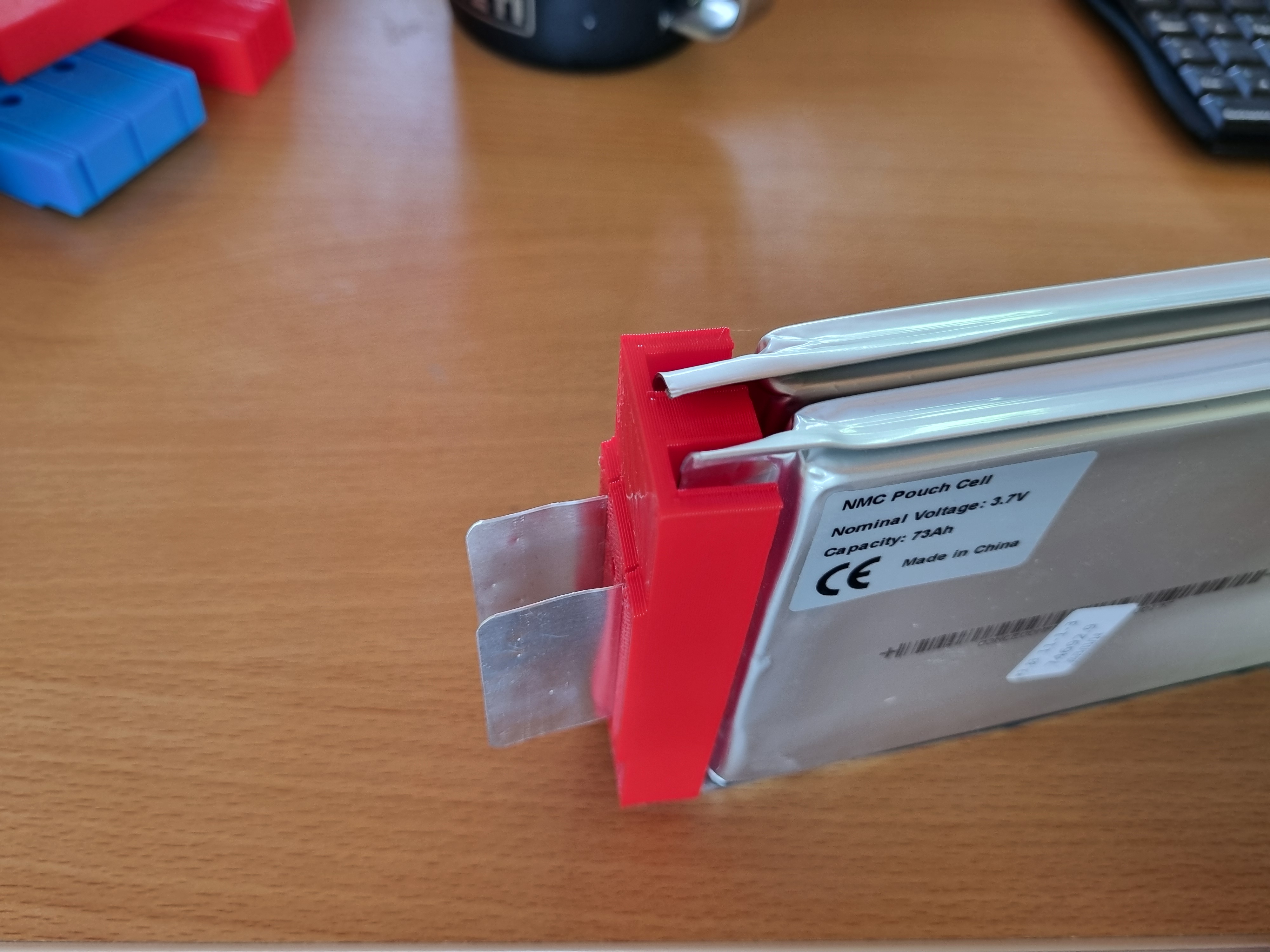

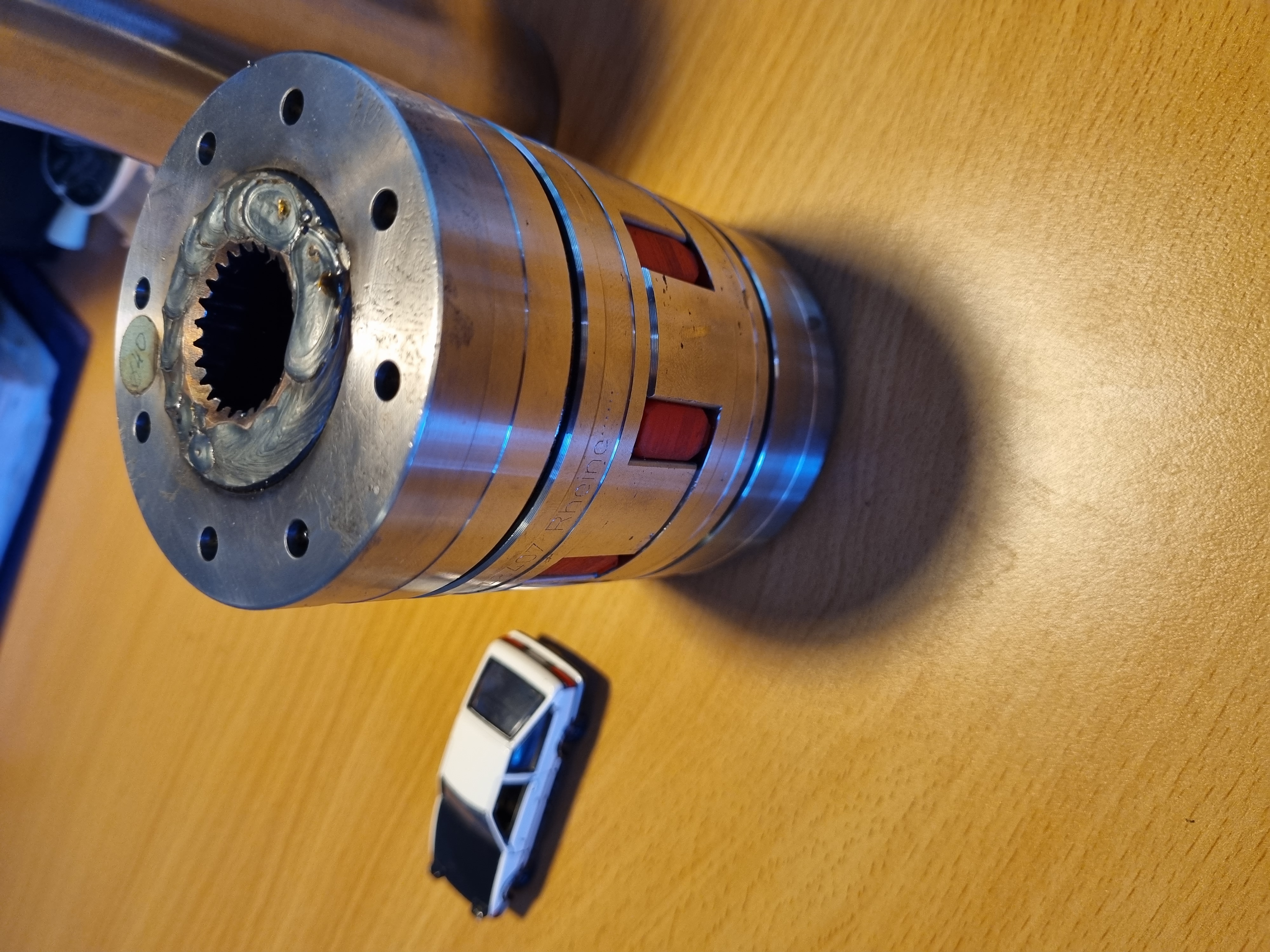

A little bit of catch up is overdue!
I've been slowly chipping away at this. The Motor to Gearbox adaptor plates are just about finished, just a bit of clean up, and locating to ensure alignment of the two shafts before welding it all up and having it machined flat.
My engineer provided some advice that forced a rethink of my battery plan. It means selling the Leaf pack and using something else. I considered prismatic cells, 18650 cells, and pouch cells. While the pouch cells were my least favourite option to begin with that's where I've ended up - Farasis 73Ah cells. The fit within my height constraint of 120mm for the under Passenger and under Driver positions with height for thermal management in the form of a thick water cooled baseplate for the boxes. I got a sample of 6 to see how they fit.
I then printed up a sample end plate to check fit. I intend to use these in a 2P 104S configuration which should give about 56kWh (146Ah at 385Vnominal).
It may not be entirely clear in the pictures but the tabs will fold over each other and be bolted together with the busbar. The bolts will also locate the cell taps and I've yet to accommodate thermistors.
The design leaves space for an aluminium transfer plate and two thermal pads between each cell. The transfer plate will have a face on the bottom side of the module that will sit flush on the water cooled battery box baseplate. I've taken some design cues from the LG Chem Super Cells that EV West are marketing (https://www.evwest.com/catalog/product_ ... cts_id=534) but will use side plates instead of top and bottom. I also intend to put connecting rods from one side to the other to minimise any swelling.
Anyway, a bit more playing around but these will fit in much more neatly without cutting frame rails - which is a major engineering/certification problem in Australia. I will then need to build the frame to hold the boxes and my engineer put emphasis on the frame meeting the regulations so a bit of design and fabrication to go there.
On other news, I picked up my JDM style body kit a couple of weeks ago and I'm very happy with the quality. Full j-blood kit with a CBY hatch with ducktail. Unfortunately I didn't take pictures while I had it all unboxed.
If anyone's got feedback I'm all ears. I didn't really want to build my own battery modules just because of the time, but here we are!
