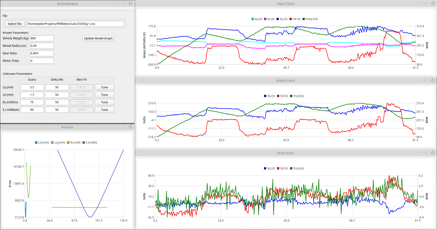

Re: Measuring Motor Parameters from Plots
Post by Pete9008 »
This is looking fairly promising :)
First how it looks when the program is started:
You can then open a csv file (which also displays the file data in the top right plot):
And then hitting the 'Update Model Graph' button gives:
This feeds the motor currents into the model and plots the predicted motor voltages and speed for each point. These are shown on the middle right window. It also compares the measured and model data and shows the point by point error in the lower right window.
Then clicking the Tune buttons in turn adds the error plots on the lower left window:
This runs the data through the model with varying values for the parameter ranging from Delta % below the nominal value to the same above while plotting the resulting error. The Lq, Ld and Flux Linkage plots clearly show and error minima which corresponds to the best fit between the measured and modelled data (this is also shown in the 'Best Fit' fields). The Rs plot is fairly useless as its effect is obviously below the noise floor - not sure whether to move it out of the tuning section. Similarly the vehicle data has very little effect at the moment (not really surprising as the way I ended up doing it doesn't allow time for vehicle inertia to have an impact) - not sure whether to remove it or leave it in case it is useful in the future.
Finally you can use the best fit values to update the actual fields and re-run the model to see what difference it makes to the modelled data and the errors:
There are still significant errors there, and I would like to see a better fit, but then there will be be other factors affecting things (road gradients, battery voltage changes, possibly even IGBT/motor temperatures). I think it's good enough to find the values for Ld, Lq and flux linkage.
It is worth noting that the above is with a guessed Udc (360V) which is probably wrong and is is probably why the best fit flux linkage is a bit low. Really need a csv file with udc in it to check whether this is the case. Also worth noting that there is some interaction between flux linkage, Ld and Lq so the tuning is a little iterative but it does seem pretty robust in reaching a consistent endpoint. The three logs do give slightly different answers (around 0.4mH min to max), not too sure why (changing battery voltage?) which may need a bit more looking at if inclusion of udc dousn't address it.
With the guessed udc bexander's values come out at Ld=1.7mH, Lq=5.5mH and flux linkage of 90mWb so pretty close to his measurements.
Still a bit of tidying up required but fairly happy with the results so far.

Thanks for the comments but this really came together much more easily than expected. Been wanting to have a go at it for a while but couldn't quite face it, however my brain seems to be starting to work properly again and bexander's data gave me the push to get on with it so here it is.
Hopefully get the code tidied up and pushed to github later this evening.
Bexander has kindly taken some more plots over here viewtopic.php?p=51123#p51123 which include udc and the program has now been modified to use it. Initial results are:
Log4 - Lq=5.4mH, Ld=1.65mH, λ=95.0mWb
Log5 - Lq=5.1mH, Ld=1.66mH, λ=96.4mWb
Log6 - Lq=5.2mH, Ld=1.66mH, λ=96.0mWb
Log7 - Lq=5.0mH, Ld=1.68mH, λ=97.0mWb
Log8 - missing udc
Log9 - Lq=5.75mH, Ld=1.77mH, λ=95.3mWb
Log10 - Rs = 145mR
This compares to measured values of Ld=2mH and Lq=6mH (wondering whether the reduction is due to core saturation in the motor due to the higher currents?).
Ought to explain log10. The Rs calculation didn't work on the previous plots, essentially its effect was tiny compared to everything else so didn't separate out. On log10 the car was held static on the brakes while the throttle was blipped. Because the motor is stationary most of the Vq and Vd terms disappear leaving just the resistive contribution and with that we get this (un-tuned, Rs=75mR):
And this when tuned (Rs=147mR):
That is a pretty good cancellation and minima curve indicating a Rs value of 147mR. Now bexander has measured this motor as being 75mR so why the poor agreement? Well the 147mR is based on what the firmware 'sees', which will include cables, IGBTs, diodes, deadtime, etc all averaged over varying currents (some of those are non linear). All it is really useful for is in trying to improve agreement between the real world and the simulator!
Just looking at why the values in log9 are different to the others. It's not enough to cause a real problem but would be nice to understand it so I'm going to modify the program so that the error is only calculated over a selected window. That should make it possible to see which part of the plot is responsible (guessing the fairly heavy regen but would like to be sure).
Edit - log9 included a drive up a gradient on the way from the flat test site, where all the other logs were done, back home so that it very likely to explain the discrepancy :)

The build files are now on github https://github.com/Pete9008/IPMMotorCalc
The code is a bit hacky but it will do for now. This is what it looks like:
Most of it is fairly obvious but a few things are worth mentioning:
  • You will need Qt to build the program.
  • The program works by reading in a logged data file which must contain the fields Timestamp, udc, id, iq, ud, uq and fstat (order doesn't matter and other fields can also be present)
  • When the 'Update Model Graph' button is pressed the program then uses a motor model and the known and guessed parameters to generate a set of modelled data. The measured and modelled data sets are then compared and an error calculated for each point.
  • The 'Tune' buttons can be used to scan each guessed parameter between (guess - Delta%) to (guess + Delta%). For each value the error between the measured and modelled data is calculated and an error term produced. All the error terms are then graphed. If there is a clear minima on the graph (as seen above) then the minima is at the optimum value for that parameter. This best fit value is also copied to the 'Best Fit' field.
  • The 'Copy' buttons allow the 'Best Fit' value to be copied to the 'Guess' field.
  • The 'AutoTune' button will run four passes of the tuning for the flux linkage, Lq and Ld terms and then copy the results to the 'Guess' fields.
  • The AutoTune does not try to find a value for Rs. Rs tuning must be done manually.
  • If you zoom in on the top right plot (draw rectangle with mouse or +, - and arrow keys) then only the region shown will be used when tuning. The quickest way to revert to the full data set is to reload the file (although un-zooming will also work). Different regions will give slightly different answers but there shouldn't be large differences (using too small a region will give unpredictable results).
  • Tuning of flux linkage, Lq and Ld should only be done on logs where the motor is mostly spinning. Regions where the car is stationary can affect the results (small periods being stationary are fine though).
  • Tuning of Rs should only be done on logs where the motor shaft is locked.
  • The values calculated include all parasitic components in the system. This affects Rs most and will include the resistance of cables, IGBTs, diodes, deadtime, etc. Rs can not be expected to match the reading taken on the motor with a meter but it is the value that should give the closest match in simulation.
  • The correlation between the measured data and the modelled data isn't as good as I would like but I can't see a way of improving it. I'm guessing it is down to non-ideal (real!) motor behaviour rather than ideal/simplified models. It seems to be good enough to allow a best fit to be found though.
  • All fields and window positions/sizes are persisted across program restarts. To delete the preferences data on Linux delete the ~/.config/OpenInverter/IPMMotorCalc.conf file. On windows the keys in the registry under OpenInverter/IPMMotorCalc must be deleted.
  • Any results generated using this program need to be treated with caution and put through a sanity check. If the results don't look right DON'T use them!
  • EDIT - try to minimise physical brake use while logging (regen is fine though). Similarly try to avoid hills.
Any problems let me know.
