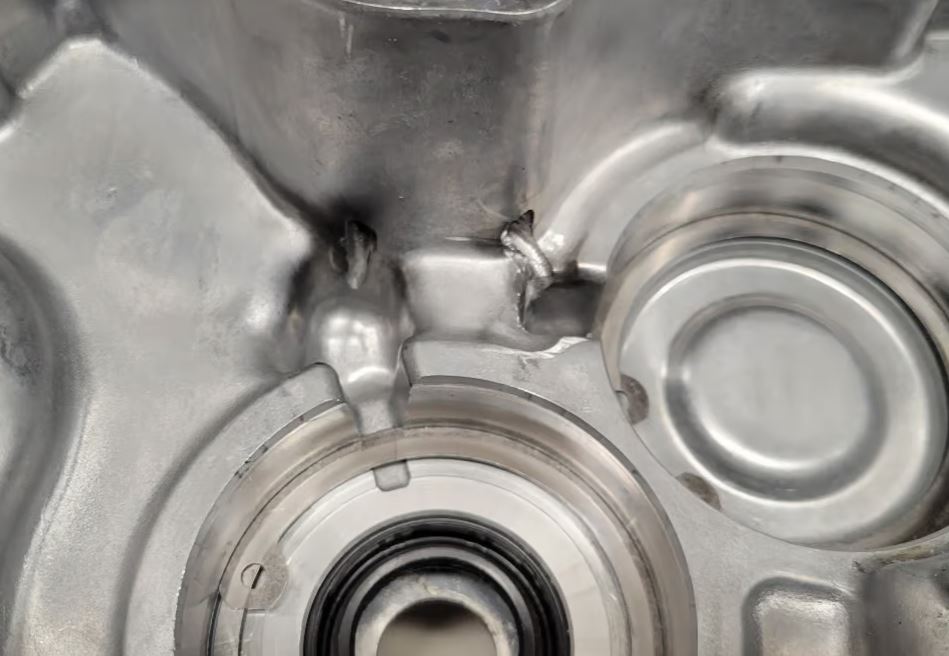

Oil pump on block: Example of holes in reservoir and grooves. The hope is that the flow from the pump and general chaos of oil flying around is enough to keep these bearings lubricated. I may switch to sealed bearings if I can find them, but for now they have proven pretty elusive. Thanks to another member here I have the part numbers for the two on the outer side of the gearbox, but that company doesn't list a bearing for the inside, so I'm not sure if the size was changed or not. It's very hard to find sealed bearings that can handle 10,000 RPM on the input shaft! Next steps for me are to figure out exactly how much of the Chevy Volt battery I want to use, and how to fit them in the car. Post about all that to follow below...

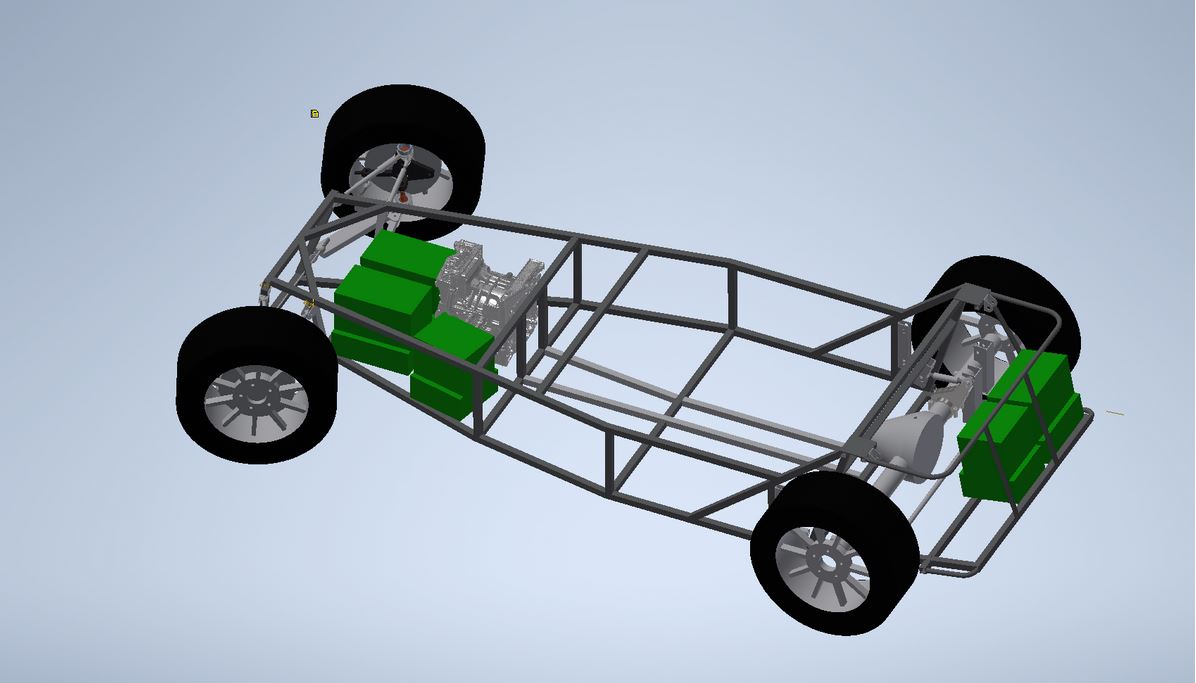

Okay, so for fitting the battery, I've been playing Battery Tetris for a while and have a few options. Some of them I like, others not so much. Given that I really don't need a lot of range, I would like to keep the weight of the battery to a minimum - but I also need enough voltage to reach a top speed of 130 KPH or so.
I'm currently off work on parental leave due to my wife and I having a baby late last year. While I'm off, I don't have access to Autodesk Inventor so I have been using Onshape instead. If anyone is looking for another option for free 3d CAD, it might be worth a look. I like that I can open and work on things with my tablet or my PC. The only catch is that anything you make is publicly available for anyone else to copy into their own workspace.

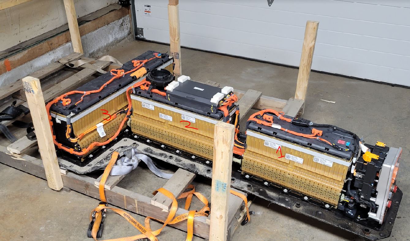

All that said, here's what I am looking at. The yellow outline is roughly the space I have to work with. And for reference here is the pack with the corresponding cell groups numbered: I have a steering rack right at the front that might be touching module 3 as it's shown here - it'd definitely be close either way. I also have the steering shaft running down the left side of module 1 but shouldn't be an issue as it runs higher than the battery in that area. The way I am showing module 2 will reduce passenger legroom by a bit, but I don't often have passengers, so if that's what I have to do, I might be okay with that. If it looks like I can do away with one group of cells (going down to 84s from 96s) that would make life a bit easier. Have to run more calcs.

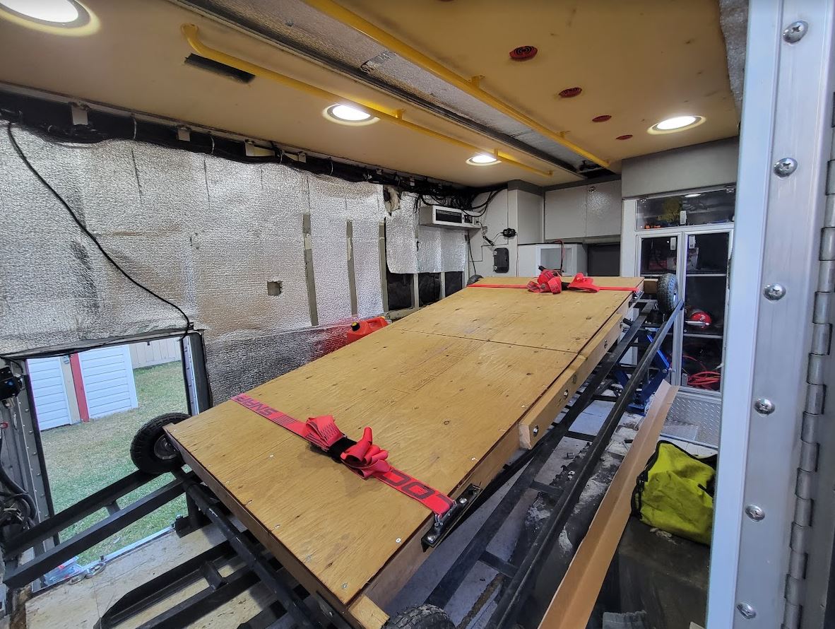

I stripped the interior and made a set of articulating ramps so I can winch the car in and then lower it down. Amazingly, the net weight of the ambulance plus car and ramps almost exactly matched the weight of the ambulance before I started gutting the interior. I also built a little sled that can ride on the ramps to make hauling things around easier. I've used this thing to move a lot of furniture for friends and family...

Can you fit one or two modules behind the rear axle?Zieg wrote: ↑Sun Feb 12, 2023 5:40 pm Okay, so for fitting the battery, I've been playing Battery Tetris for a while and have a few options. Some of them I like, others not so much. Given that I really don't need a lot of range, I would like to keep the weight of the battery to a minimum - but I also need enough voltage to reach a top speed of 130 KPH or so.

Hmm, that's a good idea. I think I can get away with ditching one 12s group. The orange one seen here is that module 3 with one 12s group removed (so just 2x 16s). I do need to allow for some space around the ends for the water cooling connections, and around the long sides for the holddown clamps. Then I plan to form some sheet metal into a protective box over the whole thing.bexander wrote: ↑Mon Feb 13, 2023 4:52 am

Both look like they fit better than the Volt cells
140kW might be possible with the BMW. If you assume a 360V pack voltage and 20V of sag then you need 140,000/340 = 412A which is around 12C. Feels a bit high but for brief periods maybe?? Even half a 70 sec run is still well outside the normal pulse discharge time though and if you are using regen that will also heat the cells (although regen does increase the chance of locking the rear wheels so not sure I would on track). The only way to tell is to try it while carefully monitoring everything. I'm planning to limit at 100kW but then that's all my motor can do.
If you find evidence of the BMW packs being used at higher currents please post it as it would be great to find out what the limit is.

What batteries was Damien using when he pulled 224hp in his BMW E39?
I had a vary quick Google and found this https://www.encycarpedia.com/bmw/19-330e-saloon
According to the website above the motor is 83kW max but you can be sure BMW will have a massive margin in that so the batteries will easily cope with much more/

Battery details are in a video somewhere, possibly the dyno video? Seem to remember it's an oldish Leaf pack in parallel with something newer (phev pack?).
I agree that there will be spare but how much? Plus the 83kW is short duration peak, so probably for just long enough to get to 60 (well under 10sec) which is different to working them hard for a minute. Would love a definitive answer on this!
Also interesting that they quote 11.15kW net out of a 12kW pack, that's not leaving much reserve at each end.

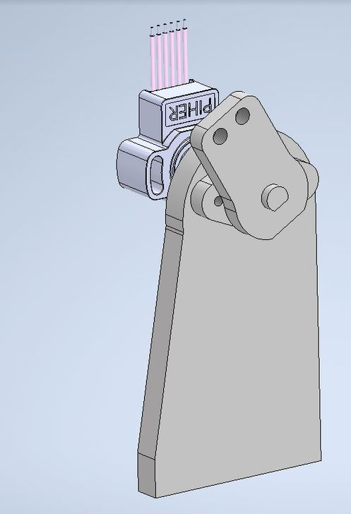

And coming soon: My Accelerator Pedal Position Sensor mount. Really annoying that Tilton has a bracket for mounting a hall sensor to their pedal boxes, but Wilwood does not. So I somewhat ripped off the design and am making my own. 3d printed a couple prototypes to refine the concept and enlisted the help of a friend with a basement CNC machine to bang out the basic shapes. He wasn't sure he could get a nice round hole for the bearings though, so I'll bore those out on my manual mill once I get my hands on 'em.
I also haven't really seen much info on the Pacifica water cooling plates being used in conversions, but I would be planning to do just that. If I do go that route, it would be nice to be able to provide more pictures and measurements of the cold plates for others to benefit from.

That looks like something Superfast Matt's besties "Send Cut Send" could do very accurately.

Yeah, you're right. I originally asked my friend because of the machined fit I need for the bearings, before he told me he wasn't sure how well that would turn out on his machine.
I will probably be using them for other stuff though, including my battery enclosure. My combat robotics club was actually sponsored by them last year and they made a bunch of parts for our arena.
