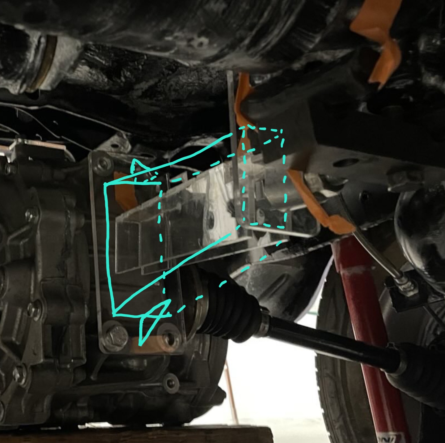

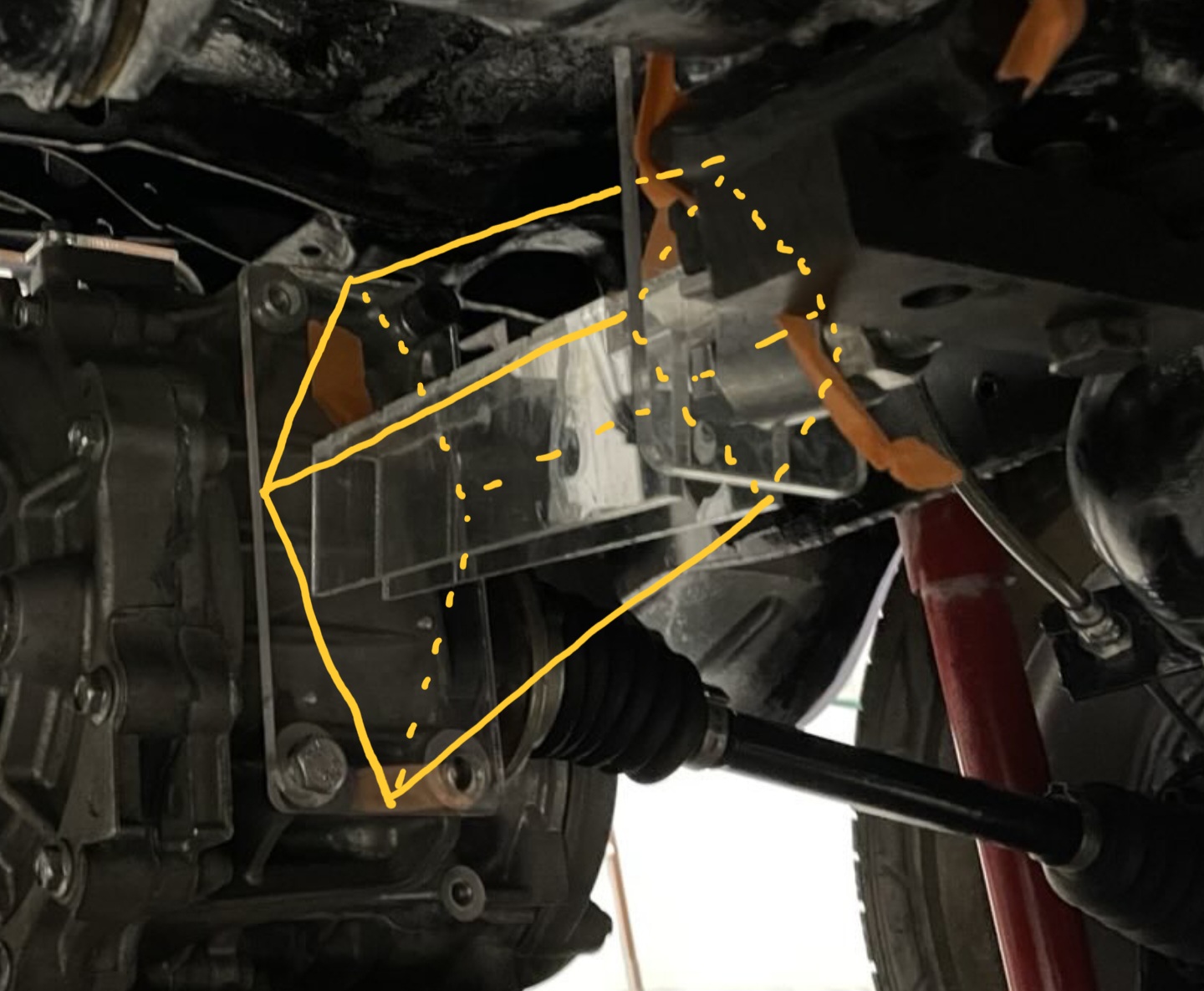

Also since the electric motor - unlike the petrol engine - doesn't suck, I bought a Tesla M3 brake booster to replace the vacuum powered one. This for me was a much cheaper solution as I was going to redo the booster and the master cylinder anyway, so pricewise adding a external vacuum pump on top of those wouldn't have made any sense.
It does have a bolt pattern very similar to the VW one. Just a few mm's narrower on horizontal so I'm getting away with just widening the mounting bolt holes a bit in that direction.

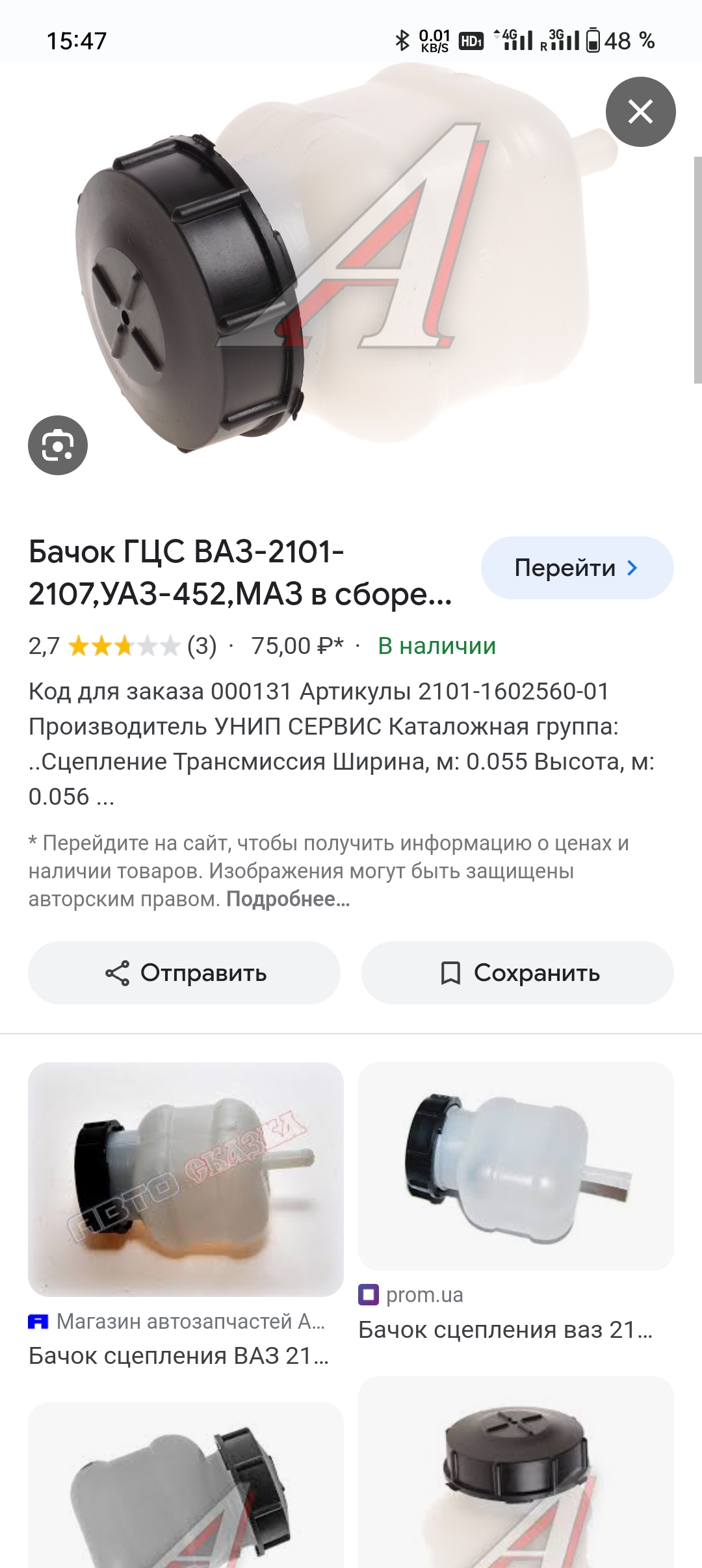

The more annoying issue is that since it sits in an angle on the M3's firewall, the reservoir is tilted also.
I've considered making a custom reservoir out of aluminium but then I found out that same master cylinder is also used in hybrid 18->21 Honda Accord, 19-> Honda Acura, etc. and those cars have a much better looking reservoir system which resembles how VW did theirs on this vehicle (dual reservoir, with the main one inside the cabin so you don't have to crawl under the vehicle to check the fluid level).
Sadly, however, those vehicles were only sold in the US market and never in the EU as far as I can find, so I doubt I'd be able to scavenge this reservoir system from local junk yards.
EV Create sells this reservoir setup for 80-ish Eur (VAT inc.)+shipping which is a viable option, just an expensive one. I am considering buying this from them but it's a steep price for a plastic box and some hose. https://www.evcreate.com/shop/brakes-wh ... -ibooster/
Anyone in the US fancying tracking down this reservoir system from Honda brake booster let me know.

look for an option from very old fiat or look for lada stores (vaz from Russia) . they have external brake tanks small for the hose and cost 1€Cera wrote: ↑Tue Oct 24, 2023 10:40 am
evil neodymium

Yeah that's one option for sure.
Still would need something on top of the master cylinder though, and that's the trickier part than the remote reservoir. For the remote reservoir I'd like to use the VW original, since it has the original mounting screw holes in right places and does feature a hose outlet in the bottom.
I mean I now know how to lathe so making some aluminium plugs and drilling and tapping threads on those for the remote reservoir is an option I'm considering. That way it'd not matter what the remote reservoir is, as long as it'd have a connection for a hose.
But for safety I'd like to have some small reservoir directly connected to the master cylinder, then run the hose to that. That way if the hose is damaged and the fluid runs out from the main reservoir, there's at least some still sitting on top of the master cylinder.
