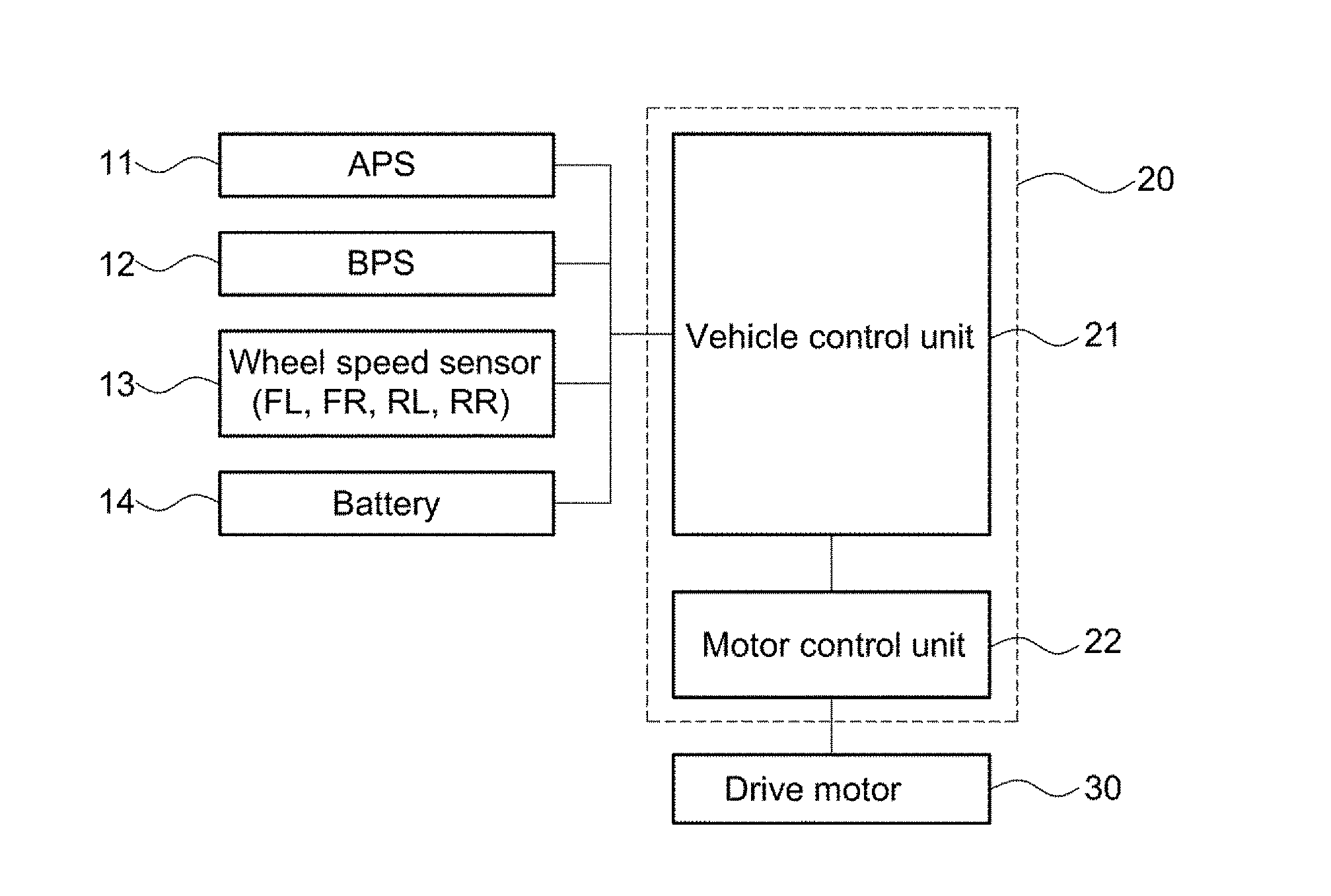

  • VCU & MCU (Vehicle Control Unit, Motor Control Unit). In Kona these are on the same PCB in the "EPCU" unit but they appear to be two different logical controllers with their own CAN connection, CAN IDs, and power inputs. (translation of writeup by Kutato72, Ioniq also looks the same). EDIT: replaced PDF link with translated article link.

Plan B for the EPCU is to use only the MCU functionality and send Torque Request messages from a custom VCU, Zombieverter style. That might be the best way if the Kona VCU turns out to be temperamental or unsuited to being repurposed. But given it's co-located with the MCU, it seems like the natural approach is to try and use it directly (and it also might be the only way, depending on how they are connected internally).

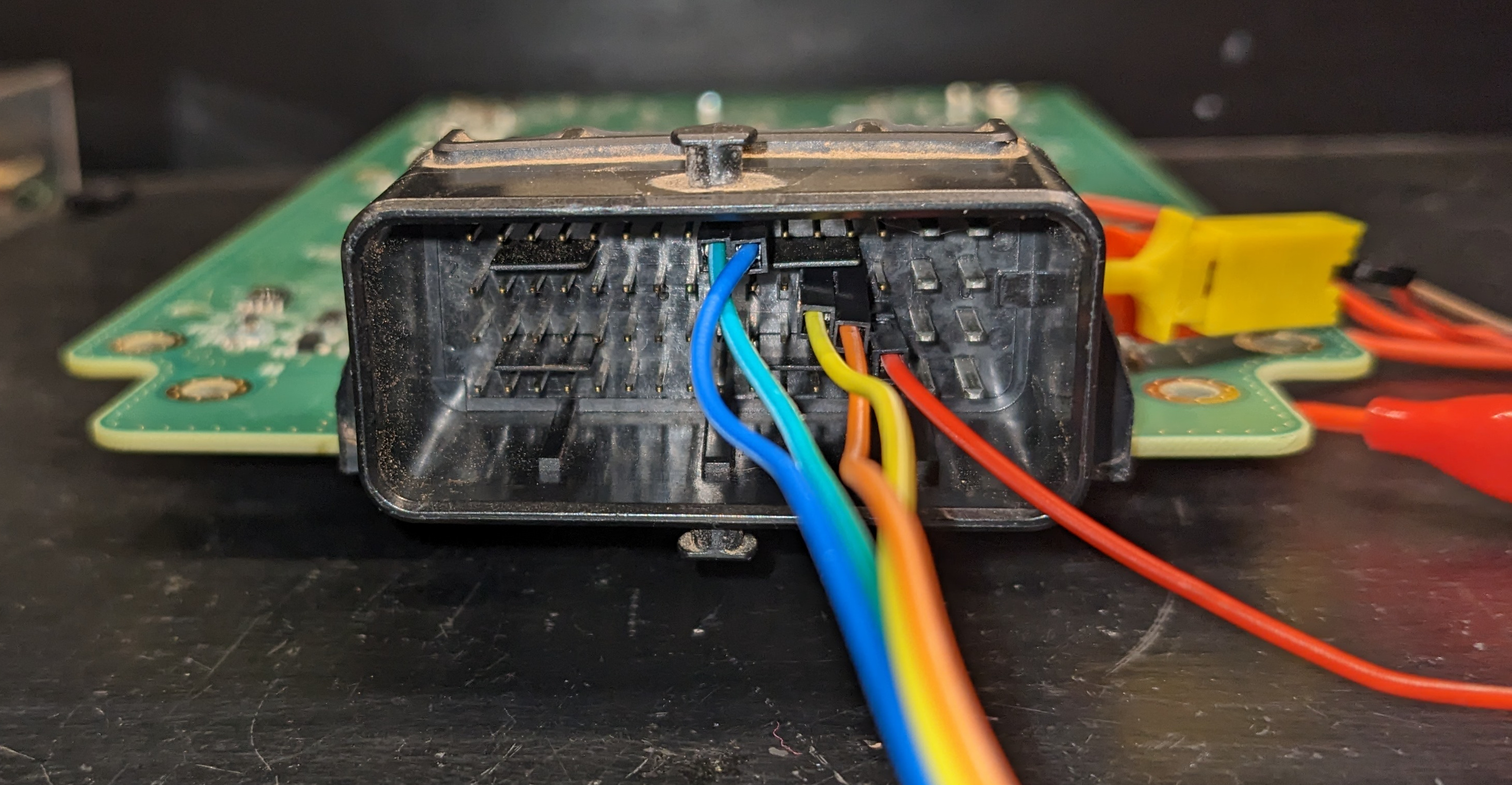

After several months delay when I broke a fine-pitched connector (friends don't let friends forward-probe their connectors, folks!) and bricked the car, I converted my car's "Hyundai Data Link Premium" Telemetry T-cable (I think an Australia-only implementation!) into a handy T-cable that breaks out PCAN, CCAN, BCAN and MCAN over CAT5 twisted pairs:
Building the T-cable
Canalyst-II and RJ45 breakout adapter
This connects to the "G" socket on the back of the IGMP CAN gateway/fuse module under the steering wheel, which seems like the most convenient place to get at all of the buses.

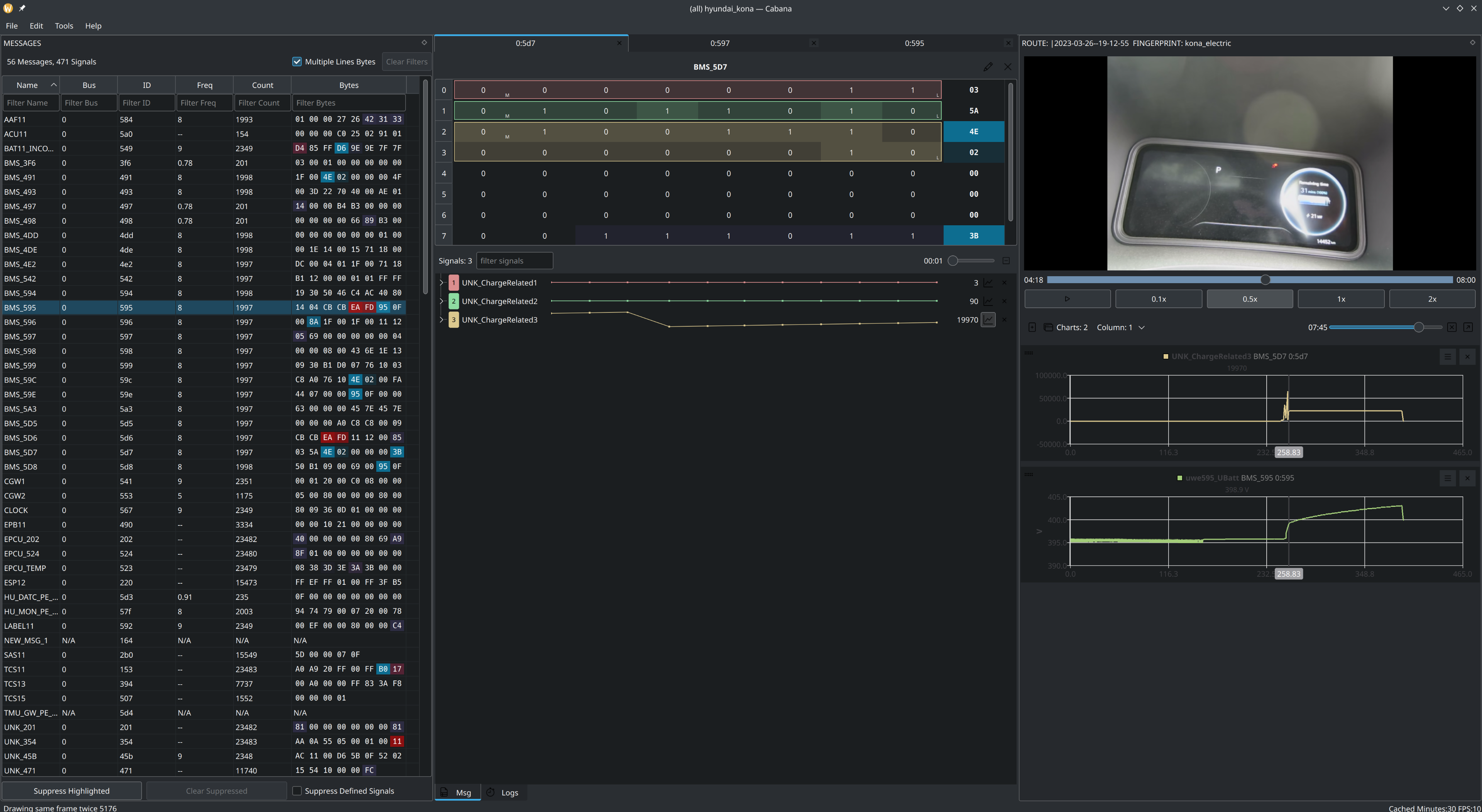

Once I solved the connector problem, this has been great. Logs from both cars are posted at https://github.com/projectgus/hyundai-kona-ev-can-logs along with some very early analysis of CAN IDs.

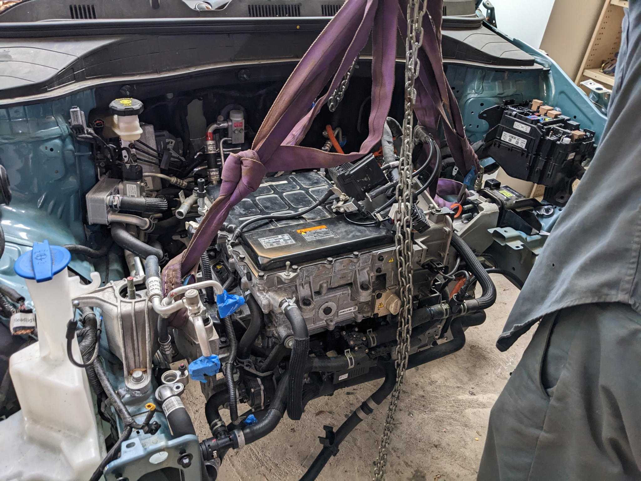

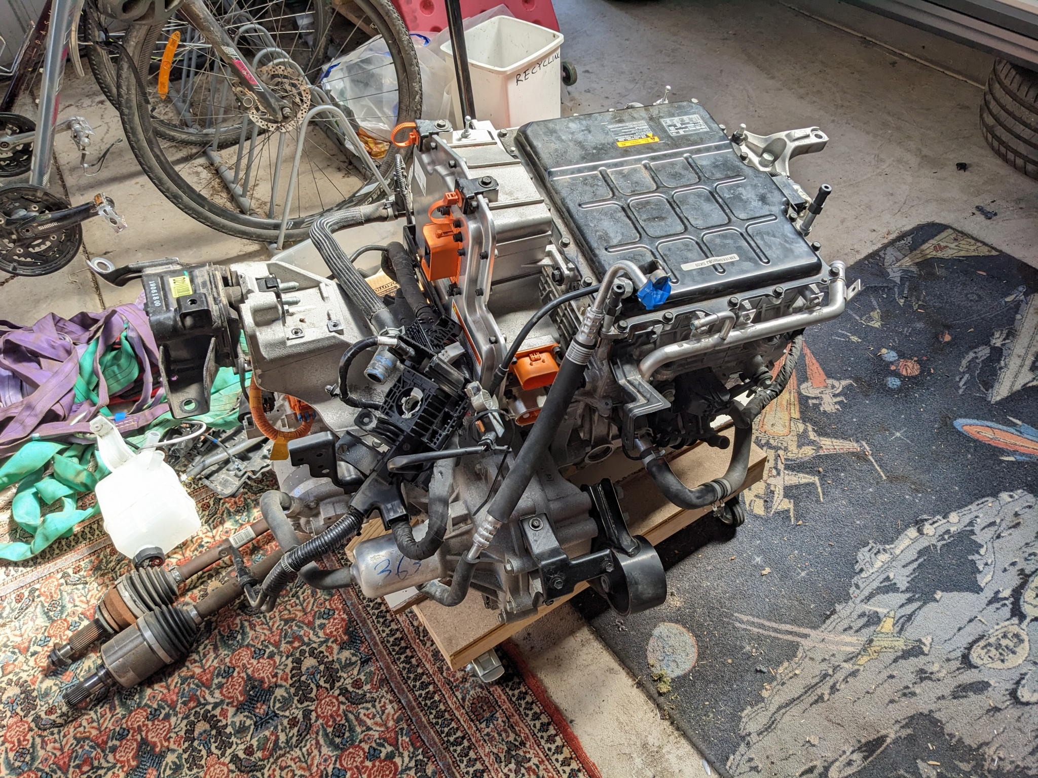

Got together and made a bit of progress today.
Kona with front taken off
EPCU stack being slinged out
Empty Kona engine bay
Motor stack sitting on dolly
Still need to get the HV battery and some interior modules out before looking to bench testing...
The EPCU stack connects to the car via these two plugs in the engine bay fusebox only, which is expected but still good news to confirm it.

Have also started the long process of puzzling out the CAN logs. I'm still getting my head around SavvyCAN and how it expects you to do things.

I have been playing around this weekend, mixing my tests with your wealth of PCAN logs. These have been extremely useful!
Below are my findings so far - I will keep updating the google sheet when I can (sadly, the working week starts...)
https://docs.google.com/spreadsheets/d/ ... sp=sharing
I am parsing your csv with
grep "<ID>" * | awk -F"," '{print $6,$7,$8,$9,$10,$11,$12,$13}' |sort | uniq

I've been working on a tool to convert local CSV logs & matching videos into a format that can be used with comma.ai's Cabana. I really like this tool for reversing CAN logs (it's a lot less flexible than SavvyCAN, as it's designed for just this one goal/workflow, but as a result it's very streamlined for that one workflow.)
Screenshot of comma.ai's Qt Cabana tool playing back a DC fast charging log and video
The converter tool is still a bit rough, needs manual "massaging" to get a usable result. Once it's usable as-is then I will post it online. (There is also a WIP repo based on the old version of Cabana, but that one is pretty limited. Comma.ai has deprecated that "web Cabana" and moved to a new "Qt Cabana" that runs on the desktop and already supports locally stored files.)
We also made some progress assembling a "bench Kona" to try and turn the motor, although it doesn't do anything exciting yet.
Photo of bench Kona bits

Another small win, a friend who has another wrecked Kona lent me some parts including this EPCU control board (thanks Sam!) Powered on the bench with few other connections, one of the 3 CAN buses produces messages. Have guessed these are all coming from the VCU. Guessing the second PCAN bus connection on the board is probably an independent link to the second MCU microcontroller, which didn't become active during this bench test.
EPCU board on bench
EPCU board on bench
EPCU connector
EPCU connector
The third CAN pair on the connector is marked "CCP-CAN (Unused)". It seems to be unpowered, at least in this configuration.
There's a bit more about the connections in use in the CAN log repo, here: https://github.com/projectgus/hyundai-k ... rd-onlycsv

Here's some of my (guessed) CAN signals from the first runaway event:
Graphs from Cabana
Graphs from Cabana
(Graph shows: A short accelerator pedal press and release, the VCU torque request starts climbing linearly, and then eventually it goes into some other state that coincides with relatively big battery transient currents.)
I think what is happening is that the Kona VCU is looking for confirmation of vehicle speed. My laptop was feeding spoofed constant zero wheel speed data, so it thought the car was stationary. So, it progressively ramps up the motor torque request values (i.e. as if the car was parked on a hill or something, it's just trying to get the wheels to start turning.)
Weirdly, the second runaway event happened after switching to Neutral (with the VCU confirming it also thought it was in Neutral). Although again "Neutral" might really mean it's trying to hold the vehicle still, and the wheel speed data said it was already still, so...
Some official Hyundai material seems to support this theory of vehicle speed as the only speed-related feedback to the control loop, such as this Hyundai patent about motor control which includes this figure:
Patent figure
Patent figure
