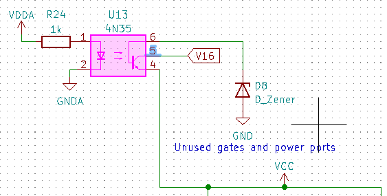

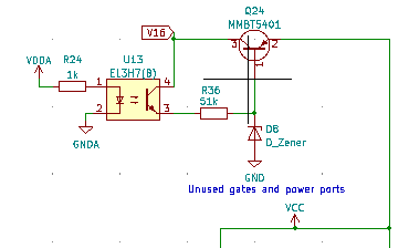

And here's my latest iteration of the mux power supply:
EDIT: even more tightassed:
When the ADC power supply turns on it activates the photo coupler which enables the linear regulator. At an assumed 1 mA current draw Q24 needs to dissipate 62 mV when running off 67V (16x4.2)EDIT: even more tightassed:

I like the last one, very few componentes but don't you need to bias the Zener diode by placing a resistor between V16 and Zener cathode?

According to the simulation, no. I think the little PV cell inside switches on the transistor which pulls the emitter to V16 and thereby the base to E+0.7V. When base hits 5.6V the Zener starts counteracting the PV cell.
Also biasing the Zener would also bias the opto, turning it always on.

I tested using the opto as voltage regulator and failed. The current generated by the PV cell in the opto is smaller than the Zener leakage current. So will need an external transistor after all.
Also I found there's no need to power the opto coupler from the DC/DC auf the ADC. It can just be turned on by the LV side, maybe even with a pin from the uC. This also puts it in a more convenient location on the PCB.

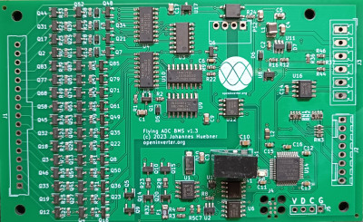

New BMS boards arrived
Worked almost out of the box, just needed to stick a 1uF cap across the output of the new LDO. It doesn't like the cap being behind the opto coupler.
These boards will get a proper shakedown in the clipper taxi.

We did the first HV power up of the battery supplied mux yesterday and it did not go so well. While we successfully completed the test with one board running with all 3 boards first showed no voltages measured on 2 of 3. We then found the 5V supply of the mux had collapsed and on a second try we popped something.
Turns out all logic chips were fried, root cause to be determined. I think the LDO must have not regulated cleanly from 65V down to 5V. So we will revert that design change and populate the DC/DC converters.

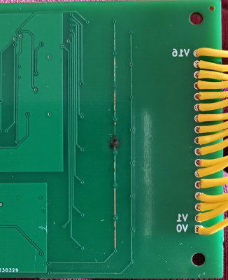

I found it's always the OUTN trace that burns, never UOUTP. Will add a picture later.

UPDATE: picture It's always that trace that burns plus the low side mosfets are often killed but never the trace to them (the horizontal part of the burned track). Could either point to something meaningful or just means the weaker 2N7002 burn before the trace does.

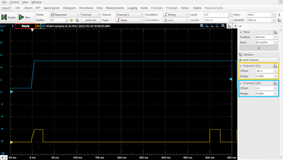

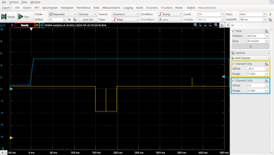

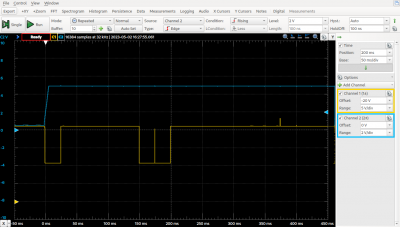

Alright, some new findings
I have scoped the mux 5V supply (blue) which is switched on by the processor about 1s after power up. The other trace is the gate of Q18/Q26 (channel 6). We'd expect first the power-up and 150ms later turn on of channel 7, like so: After doing many power cycles I got a picture like this: I repeated it on channel 8 and found the same glitch at the same time.
I don't see the other channels but somehow I suspect they glitch as well.
And likewise on channel 0 I suspect they all glitch at the same time or at least there is a possibility they will. In any case the early turn-on is not supposed to happen. Will keep digging.

Strange. So it means, that the 1-out-of-8 decoder randomly has (hopefully only) one output active after startup. This looks ugly, but still is no reason to burn anything, because it is just ONE, no current flow possible in the OUTN rail itself. I did not analyze the complete logic part, maybe the idea of "self-secure" is not fully realized, an a certain, random init pattern leads to activation of two pathes on OUTN.

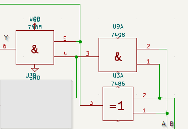

Another thing: As I understand the logic, the Y is always false, because it would be only true if (A XOR B) AND (A AND B), but either they are different to fulfill the XOR or they are both true, to fulfill the AND. Maybe I missed something or use an outdated version (it is from the beginning of the thread).

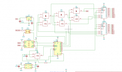

Sorry, here is a more recent version (PS2 is not populated in case you wonder)
EDIT: G16 is a special case where the "even" decoder is disabled and the fet is switched by the AND gate instead
Meanwhile I found random output bits of the HC595 start out as one. Unfortunately there is no reset signal for them, only for the internal shift register. Like you say, that in itself doesn't present a problem, as the first control word that is sent after power-up disables all channels.EDIT: G16 is a special case where the "even" decoder is disabled and the fet is switched by the AND gate instead

And early forum release because it may assist fault finding

Just thinking, our power cycles were always rather short. What if the last control word gets preserved in the shift register and the power up reset (gone in above circuit) fails to clear it because too much charge is left in the cap. Then we would have the glitchy register behaviour once at startup where random bits are shifted through and latched. Still doesn't cause turn-on of two FETs logically but with the slow switching time could cause overlapping.
Maybe the decoder-disable bits should be held high with some circuit that doesn't fail to do so on a short power cycle.

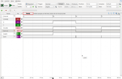

The SPI clock runs at 93 kHz so agreed at that rate a shifted "1" wouldn't cause a reset. On the other hand the traces are short and the isolator has a push/pull output.
A control word looks like this: 0x80Cx (x: channel number) shifted MSB first. I'd think when the 0x80 is shifted through fine, the blanking time is guaranteed.

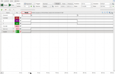

Attached the logic analyzer, here's the issue:
Switching from channel 6 (that happens to be in there) straight to channel 0 without blanking time.
UPDATE:
It seems indeed to be a function of the cycling time. So if you power down and 2s later power up again it seems the output latches of the SR are still in the state where they were turned off. If you wait like 10s the start up is normal. One solution would be to delay mux power-up by 10s in software. Bit of a workaround, a hardware delay might be nicer
UPDATE:

Alright, this might fix it:
When booting up the mux supply is off. Next the mux supply is turned on with the possibility of random data being in there. 25ms later (the power supply is stable by then) we shift 0x0080 through the register. The first 8 zeros clear whatever is in there, the 0x80 latches 0 to all output. 25ms later we actually start sampling.Support R/D and forum on Patreon: https://patreon.com/openinverter - Subscribe on odysee: https://odysee.com/@openinverter:9

Maybe some less consumption can be achieved with sleep modes. It's woken up by SPI clock (if possible), receives the data, sets pins and back to sleep.
I thought about above glitching a bit more. It is just an issue if after power-up a channel is selected without inserting a turn-off command.
But then we also tested with modules that have permanent 5V supply via DC/DC converter. They receive many mux-off commands during bootup. These blew up just as well. So I'm afraid the above isn't the solution either. Even more so as it wouldn't explain why one module works but stacking 2+ modules clearly triggers the blowup.
Could it be some capacitive current over the isolator or DC/DC converter?
