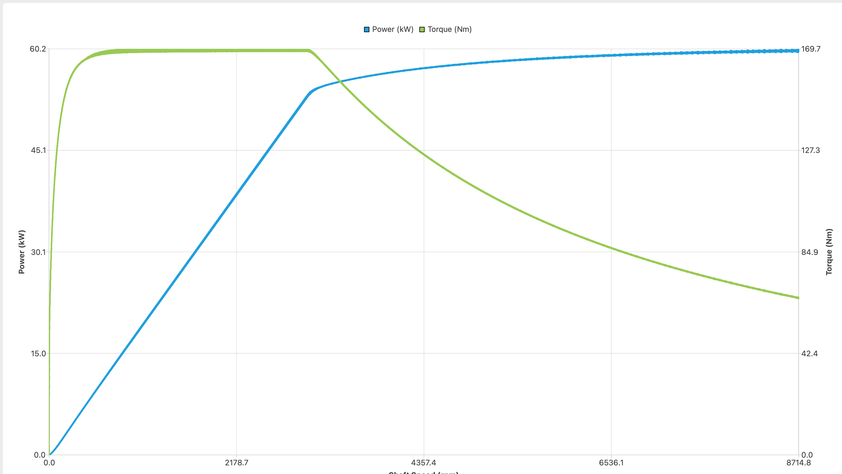

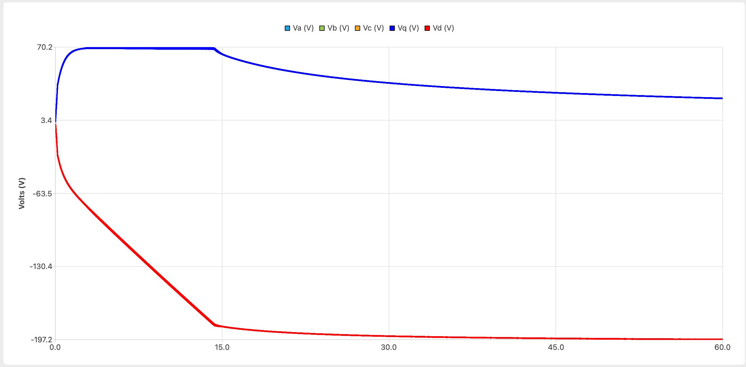

Not looking bad at all, think your motor resistance is probably on the high side though, I'd drop it to around 0.1 and see what difference it makes. It should lift the power a bit.
Noticed your plot is saturated on Ud not Uq which made me wonder what the MTPV stuff might do for it so tried your settings (except for the resistance, dropped that to 0.1 which may explain some of the gains) and got this: Not sure whether to believe that or not (it's without over-modulation too!).
Still needs a bit of work, you can see it doesn't transition between MTPA and MTPV nicely and it's prone to oscillation but there is definately potential there.

The above is without over-modulation, just MTPV. With both it should add a bit more. Was hoping to have something to test by the weekend but it's not looking too likely at the moment
