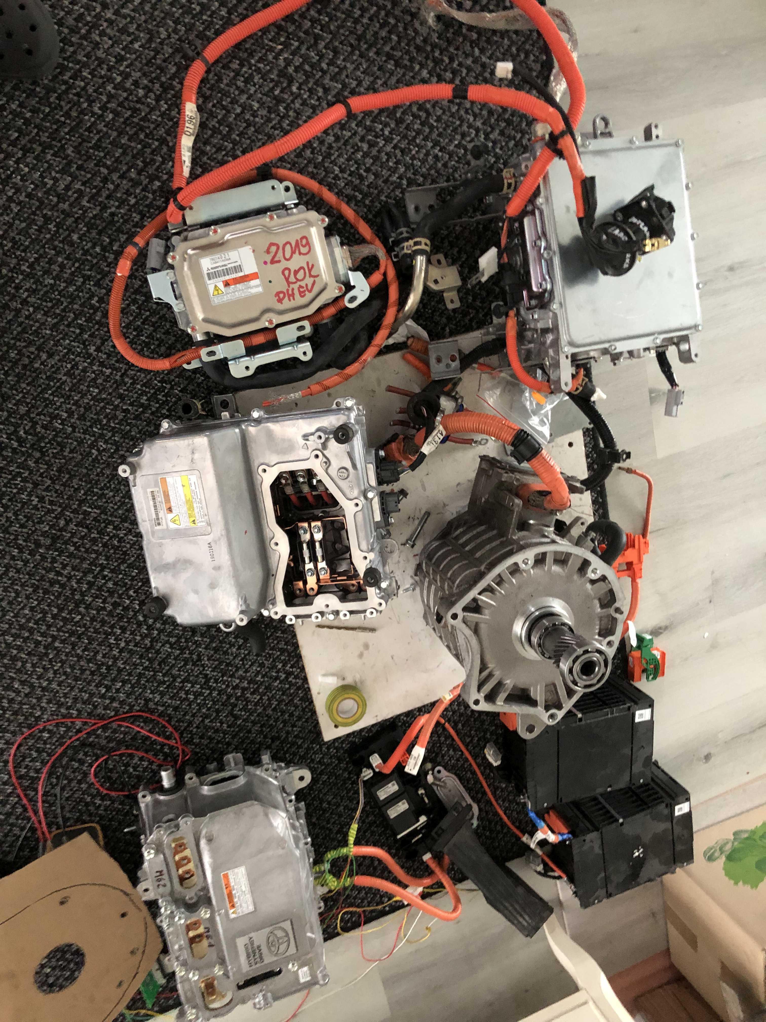

Hello everyone. I'm starting soon with my first project based on peugeot 306. I got it for free from my friend, that's why such an idea for a base. I want to use an inverter from Toyota Yaris with Small board V1d. As a drive I want to use rear drive from Outlander. The battery will come from the i-miev. The vacuum and power steering pump comes from Opel. I'm going to connect the electric motor to the original gearbox. Earlier, I wanted to use the drive from Toyota Yais, but this Peugeot model has a speed measurement not from abs but from a mechanical sensor in the gearbox. My version of the Peugeot also has air conditioning, so at a later stage I want to use the air conditioning compressor from the Outlander. The project is to be a science of conversion and is to serve as a daily car charged from my off-grid installation that powers my house.
I want to divide the battery so as to load the car evenly and place some of the cells in the place where the fuel tank was and the rest under the hood to match the weight of the old internal combustion engine.
The photos show the items I have already collected.

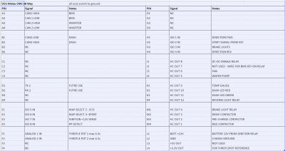

- Posts: 220
- Location: N. Wiltshire. UK
- Has thanked: 17 times
- Been thanked: 107 times
Re: Peugeot 306 '98 conversion
The design files including cpl are available from Damien's patreon site, at €10 /month membership level.
https://www.patreon.com/evbmw/membership
- Posts: 3267
- Has thanked: 80 times
- Been thanked: 235 times
Well not only....youngpoland wrote: ↑Sun Feb 05, 2023 10:12 pm ...... For this you need a zombieverter and here is the problem with ordering the assembled board in jlcpcb because I did not find a single configuration file on githab. I miss the CPL file if any of you would have such a file I would be grateful.
viewtopic.php?t=2167

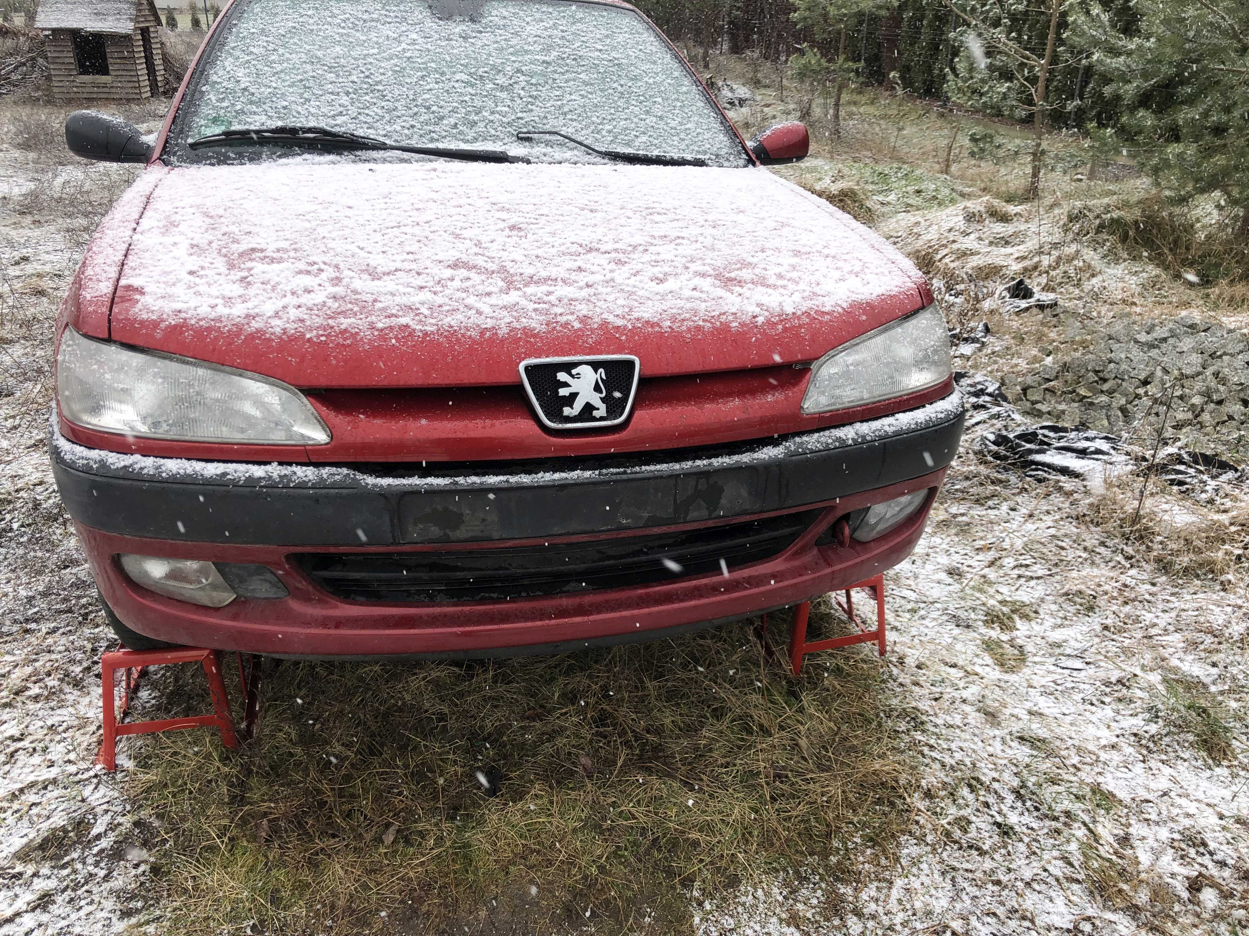

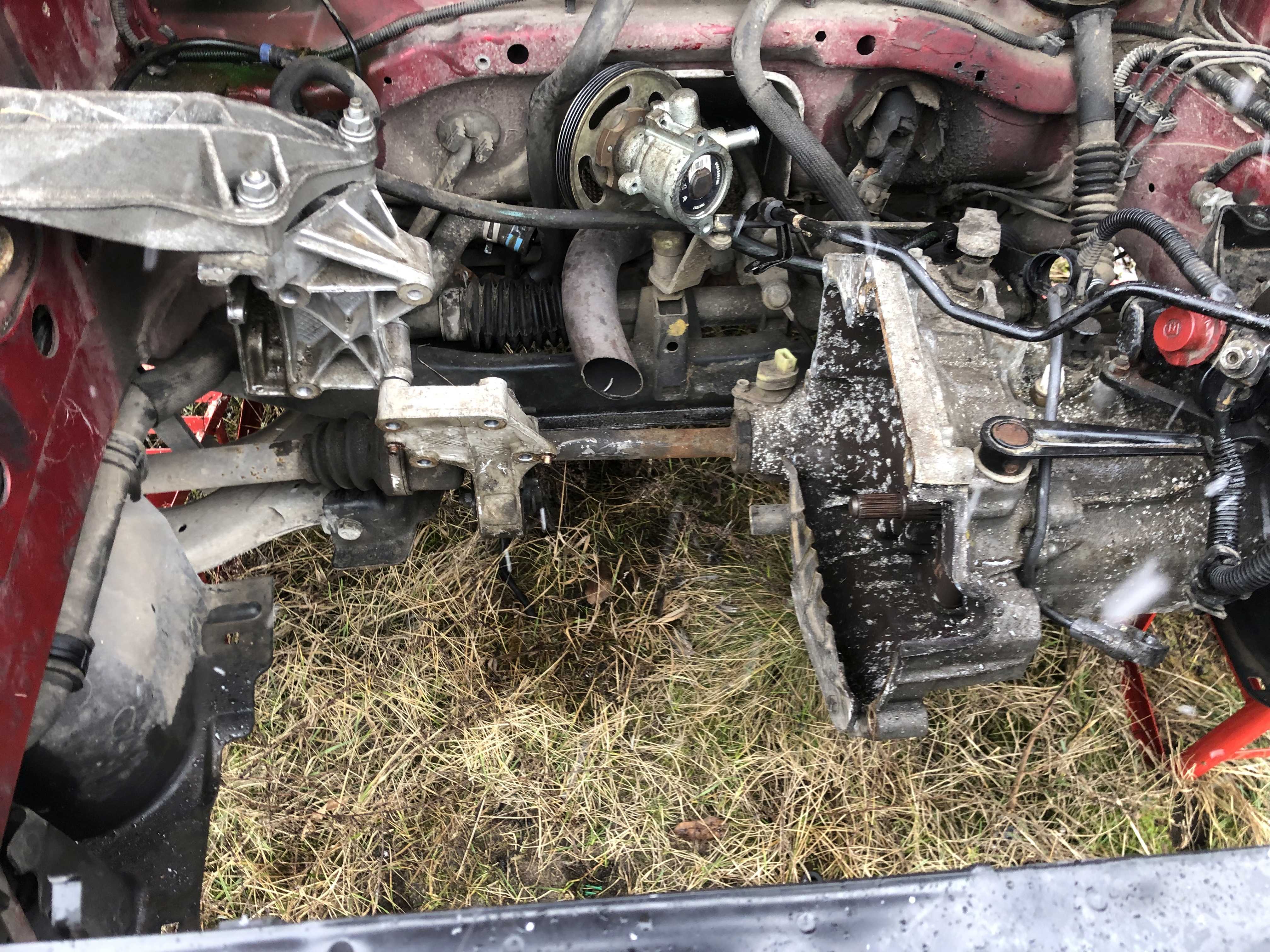

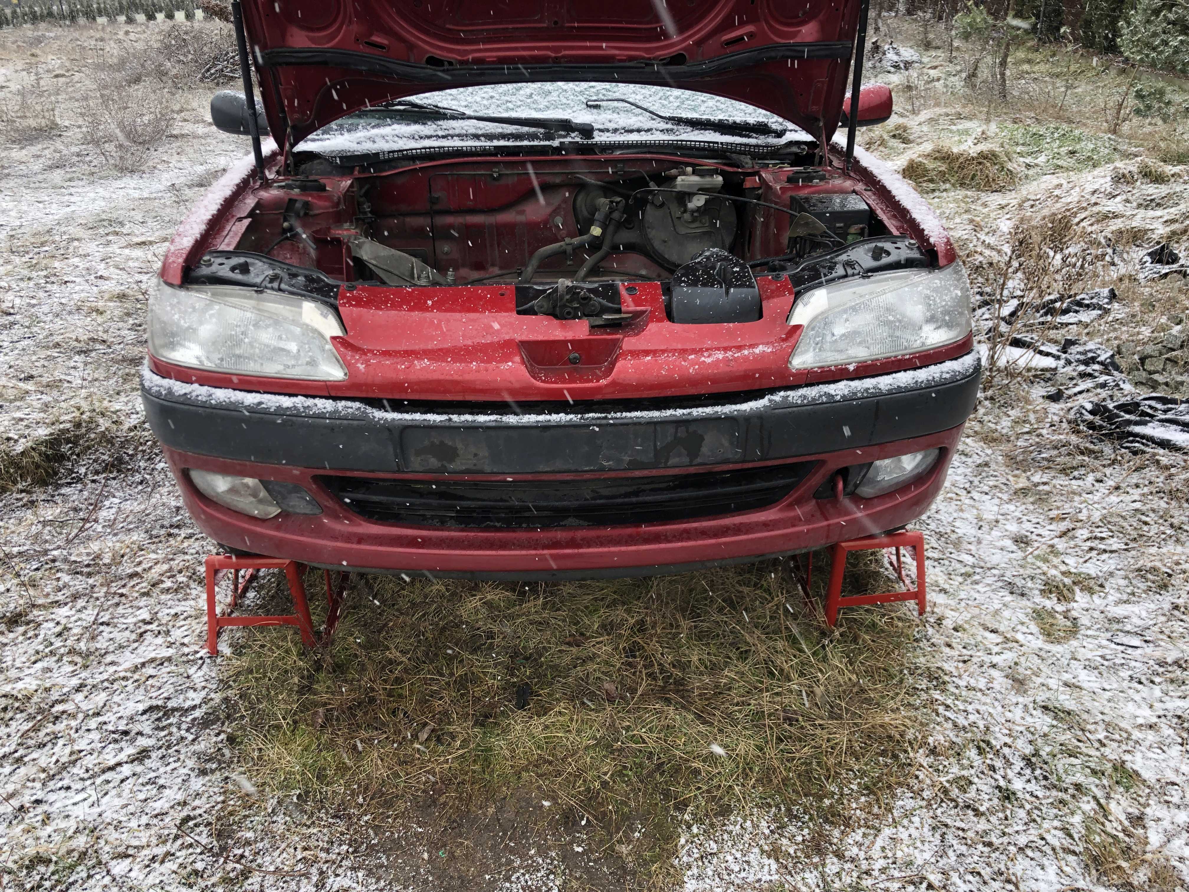

Work is progressing slowly, waiting for the outlander's engine, I'm disassembling the internal combustion engine. Due to the cold and snow, there is not much going on

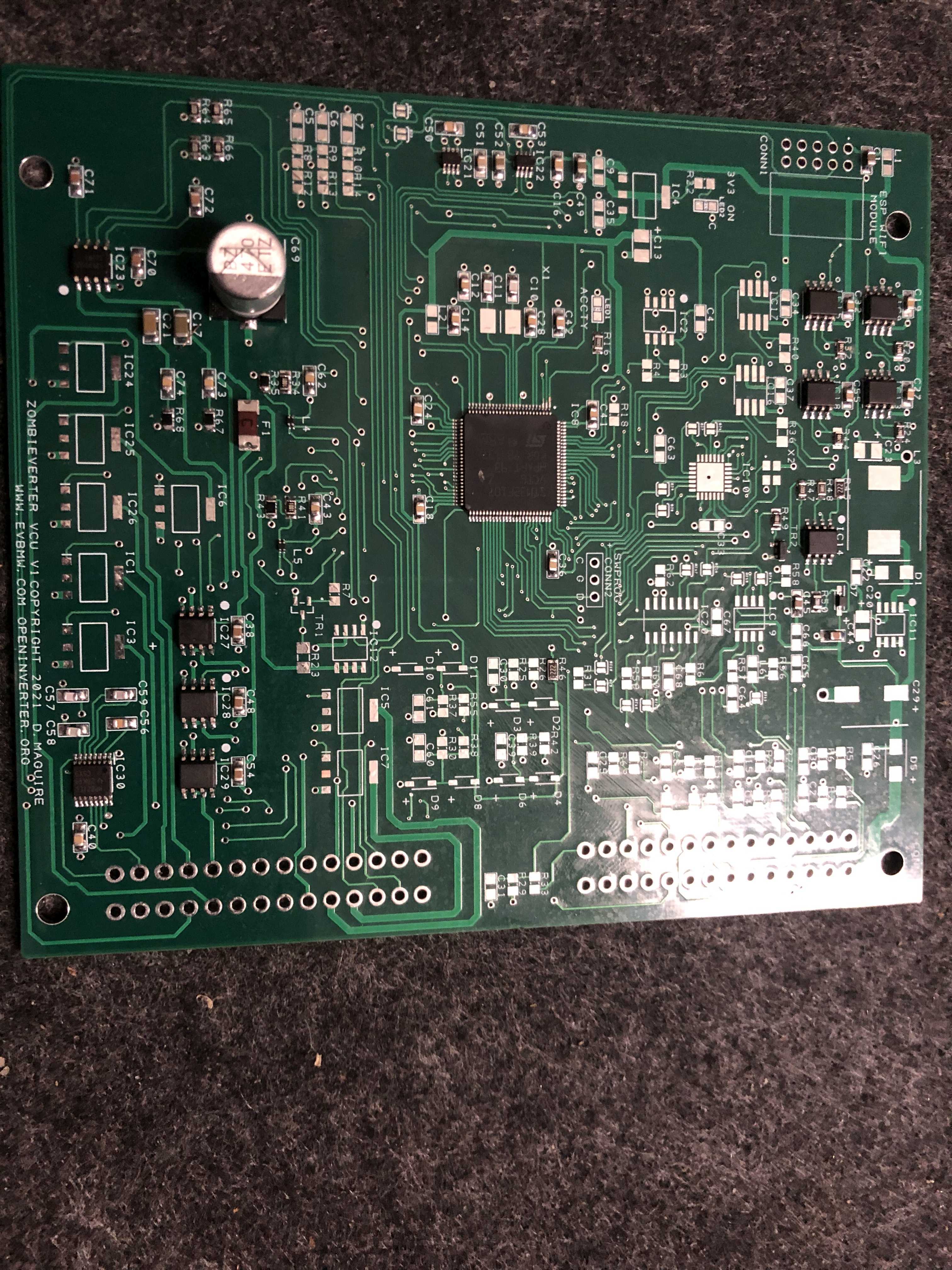

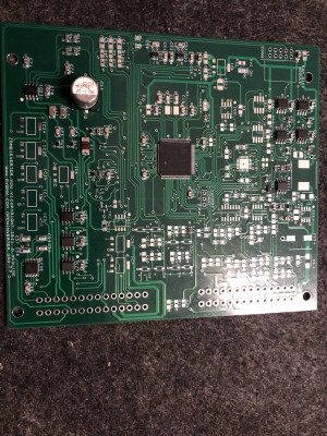

Finally, the assembled boards have arrived from jlcpcb. I am starting to assemble the connectors removed from the yaris inverter board.

the board is already alive after programming
I did everything step by step like this friend on YT- youngpoland

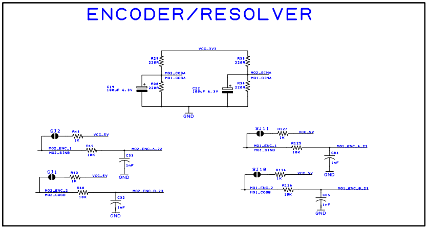

I have a question for people with more experience than me. Below I have compiled the connector from the dual_v1d board and the resolver from the outlander rear drive unit, is this connection correct?
- bexander
- Posts: 835
- Has thanked: 63 times
- Been thanked: 89 times
No, S3 and S4 does not go to ground. Should be connected to MG2_ENC_1 and MG2_ENC_2, one to each. That is the resolver inputs.youngpoland wrote: ↑Wed Feb 08, 2023 5:06 am I have a question for people with more experience than me. Below I have compiled the connector from the dual_v1d board and the resolver from the outlander rear drive unit, is this connection correct?

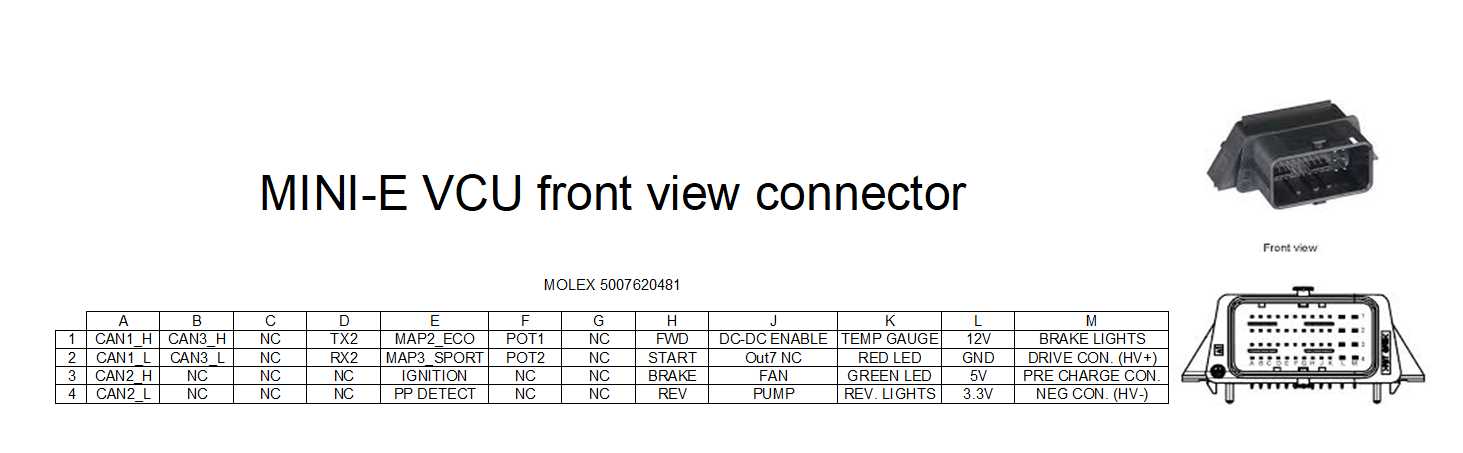

Does anyone on the forum have a reworked version of the Mini-E-VCU for the arduino compiler for teensy 4.1. Can you send me this version?

More items have arrived. motor and inverter to it. Now I'm wondering whether to use the toyota yaris board or, on the contrary, leave it for another project and make the control using the software and driver from https://github.com/aot93/Mini-E-VCU. Are there any step by step videos on how to do this?
Does this driver only support bms from outlander and is it necessary for this driver to work. Can other bms from nissan leaf or i-miev be used.

Just rename main.cpp to main.ino or Mini-E-VCU.ino, and it should compile with Arduino IDE.youngpoland wrote: ↑Thu Feb 09, 2023 3:37 pm Does anyone on the forum have a reworked version of the Mini-E-VCU for the arduino compiler for teensy 4.1. Can you send me this version?

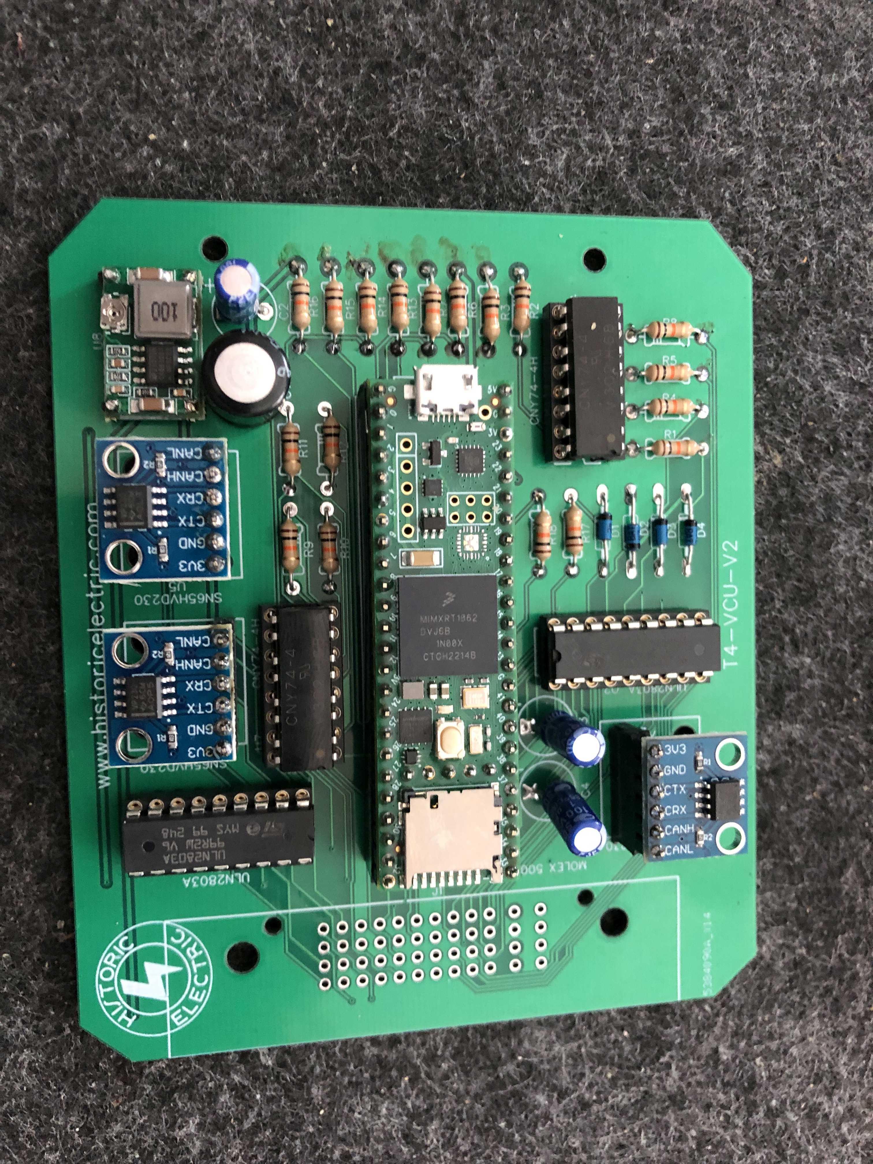

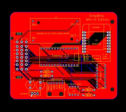

Today I managed to buy probably the last piece of teensy 3.2 for little money. And now I have a question.
I want to use https://oshwlab.com/aot93/mini-e-t4-vcu_copy to control the inverter from outlander
and as bms https://oshwlab.com/aot93/simpbmsminimal
the question here is if I program it with the soft https://github.com/Tom-evnut/ImievBMSV2 will it all work together. Because I have original batteries from i-miev and I want to use them.
Short answer is no.
The code base needs to be modified to work with these boards.

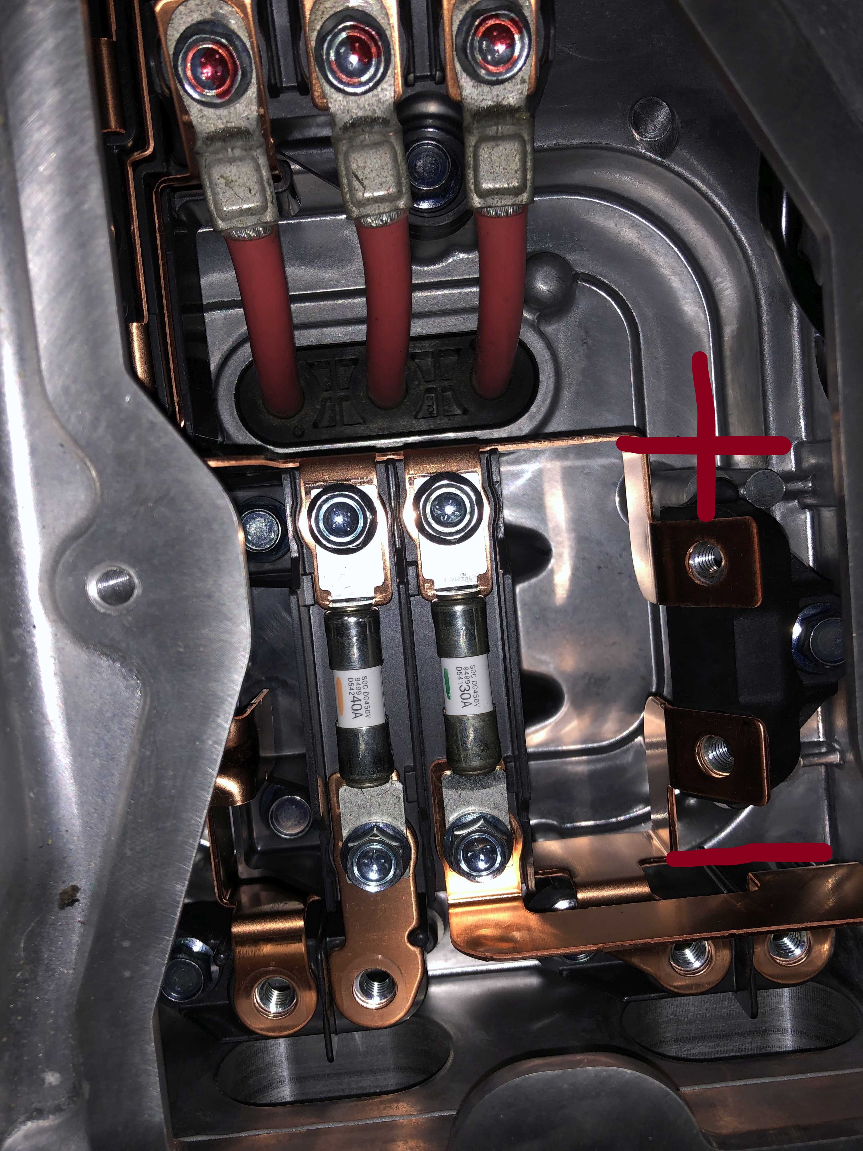

I have a question, do I think correctly that this is how the poles of the battery wires should be connected? This is the rear inverter from the outlander
In outlander inverter +HV is on the side of the fuses. Simple, just follow the fused rail to your positive terminal.youngpoland wrote: ↑Mon Feb 20, 2023 7:12 am I have a question, do I think correctly that this is how the poles of the battery wires should be connected? This is the rear inverter from the outlander

when the weather is not conducive to work on the car, I solder a zombieverter
