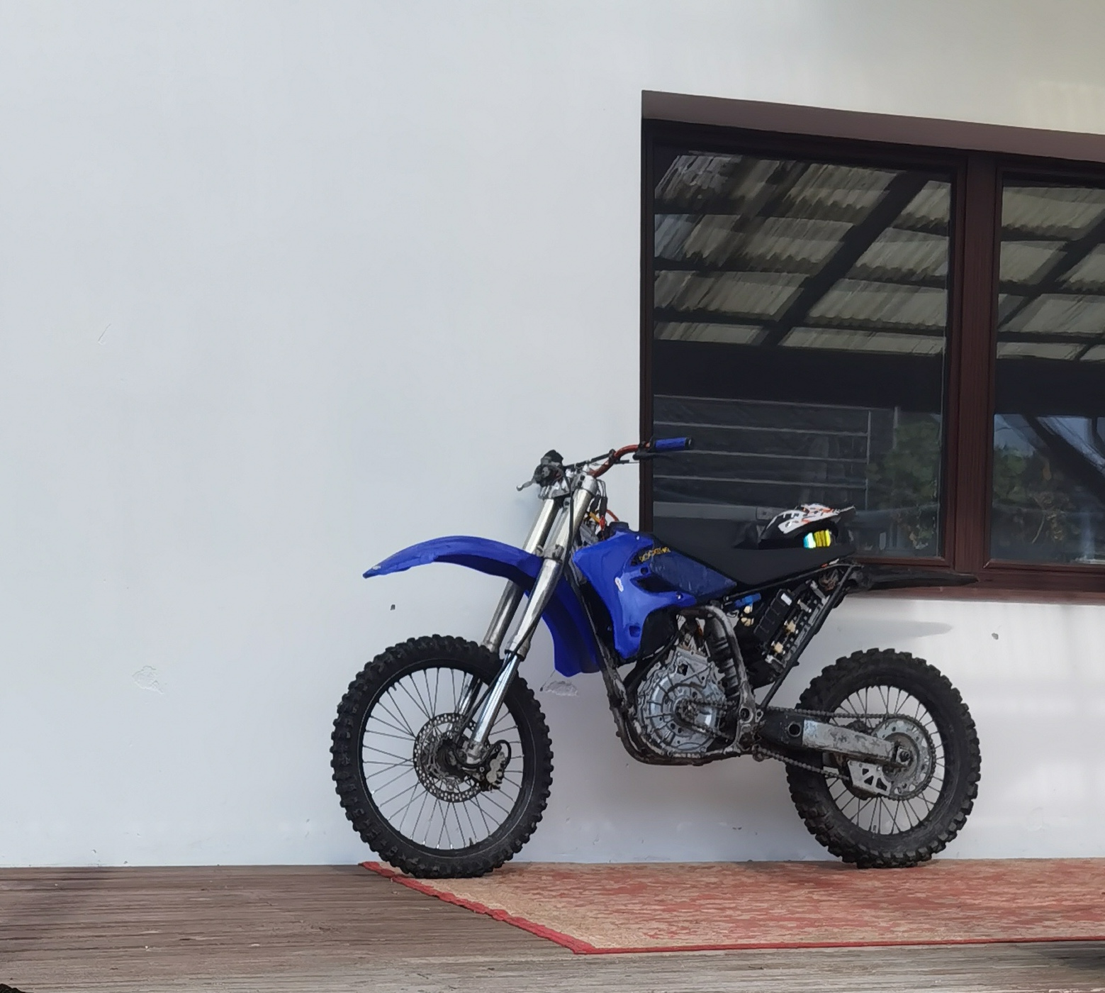

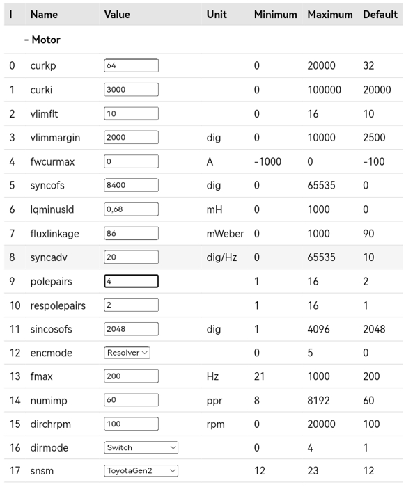

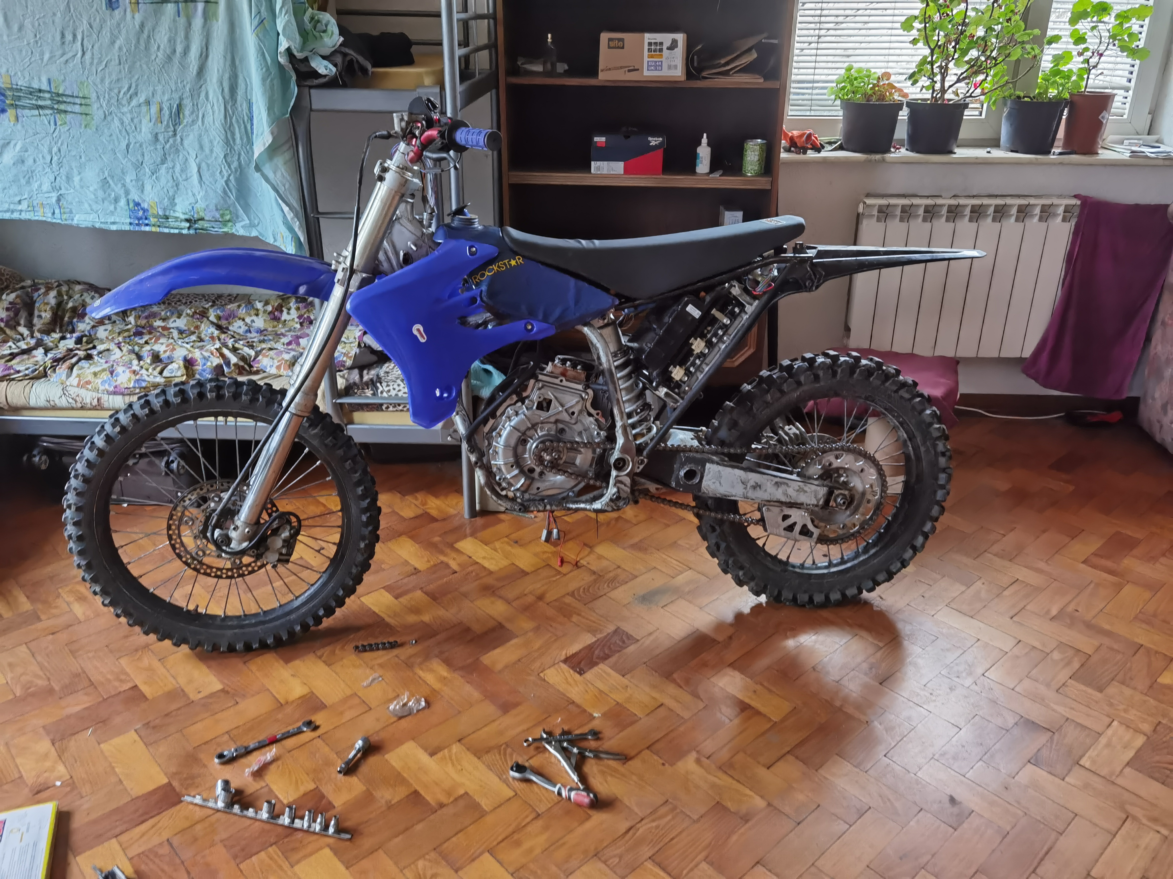

Hi all.
I've been working on an electric motorcycle for several months now.At the moment, the transmission and the motorcycle have been tested. Battery 24S12P (86v). Mg2. inverter Prius gen 2. (fstat=khm/h)More info later, need help now. Tested for 44v, 72v, and 86v, the torque is excellent, but the maximum currents are not more than 78A.
lqminusld and fluxlinkage Can influence it? Or direction of current is wrong?

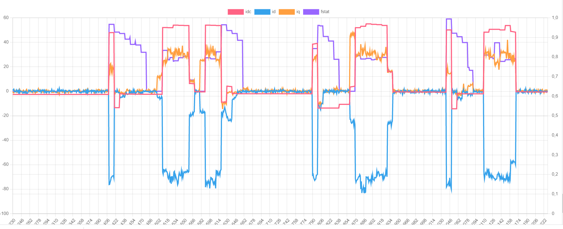

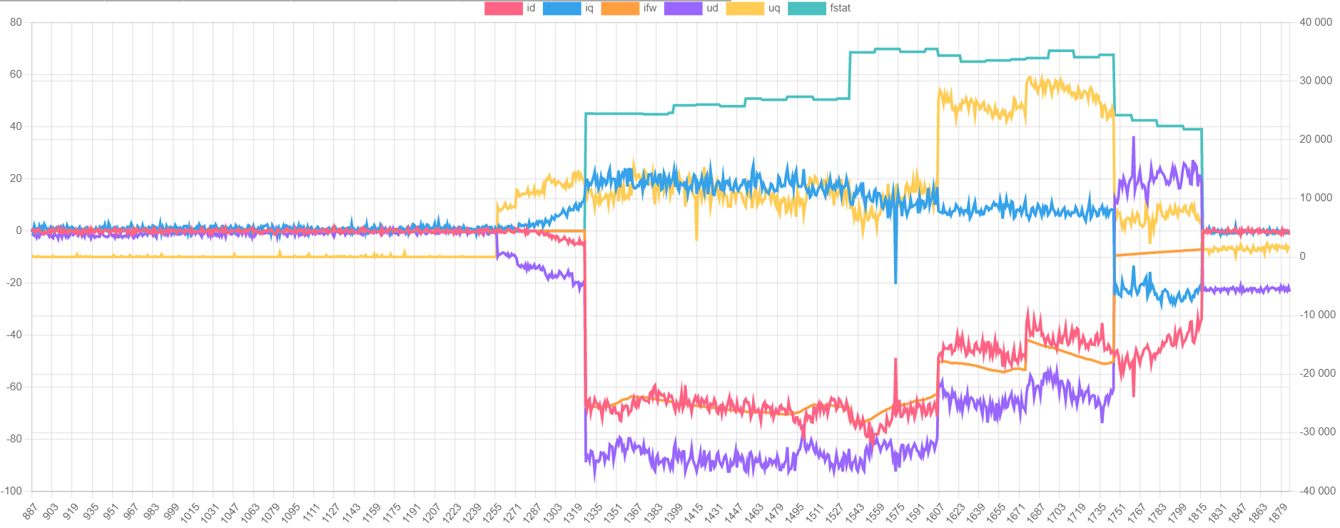

Today I tested different combinations. Parameters from the forum, measurements and pdf for Toyota Prius. More than 80A has never been. I use LG chem 18650 batteries. Therefore, I can’t determine if the current is limited due to the battery or inverter parameters.
"Evaluation of 2004 Toyota Prius Hybrid Electric Drive System":
Motor voltage constant 1.338 Vrms/Hz
Prius based on static measurements: 5 mH and 1.92 mH,
>>lqminusld 3,09mH
>>fluxlinkage 74mWeber
But in the end I got this data, IDC is calculated in terms of phase currents, so this is inaccurate. The measurement was carried out through a current meter:

Strange that the magnitude of id is larger than iq? (I think? Maybe not)
If your battery is limiting things, udc will drop as you increase current demand (resistive losses in the pack and wiring).
It may be that the (relatively) low udc combined with a relatively high inductance motor just doesn't allow sufficient current to flow? Do you still have the boost converter from the prius inverter? Another heavy lump to carry around, but could boost your udc to 300V or more.
Alternatively, you could maybe improve performance by fitting a smaller front sprocket (more torque) and relying on field weakening at higher speeds?

If your values for lqminusld and flux linkage are right for your motor then I think you need to change fwcurmax to something like -40A.

mjc506 wrote: Thu Feb 02, 2023 4:36 pm Strange that the magnitude of id is larger than iq? (I think? Maybe not)
Since this is a motorcycle, I am limited by the maximum weight. The first battery was 44v) but 5.4 kWh. Boost converter did not want to put it so it's 3.23kg. But I will definitely try.
Pete9008 wrote: Thu Feb 02, 2023 4:42 pm If your values for lqminusld and flux linkage are right for your motor then I think you need to change fwcurmax to something like -40A.
I tried without FW,because the speed suits me, vnom = 87.12v-> 65hz-> 65kmh. At 0, - 40 and - 95, butthe current consumption has not changed

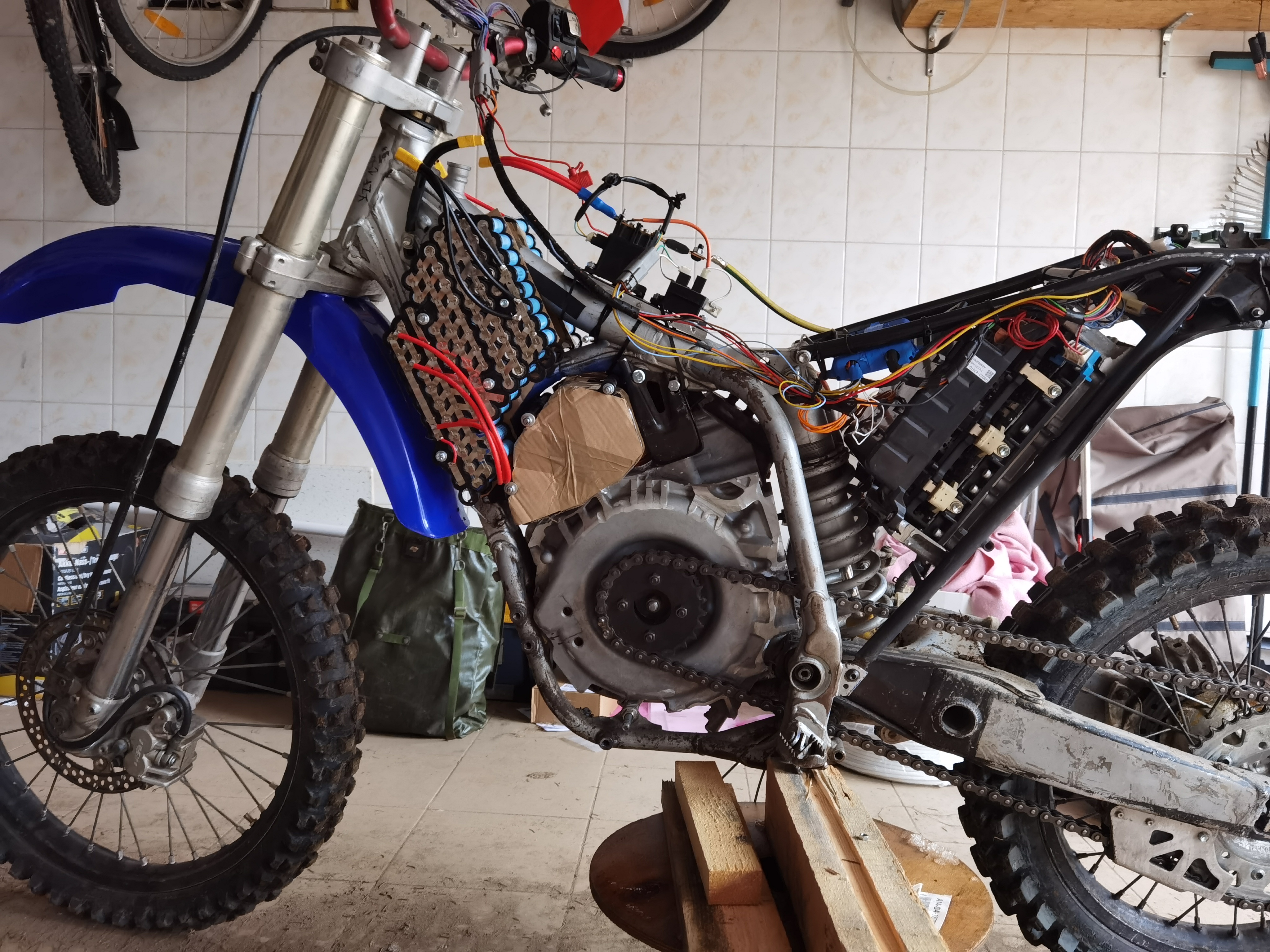

Mg2 is too heavy and has a very high inductance. I redid it on mg1 and am very pleased with the result. Now I'm setting it up, because after 35 km / h (74 Hz or 1100 rpm) the power drops

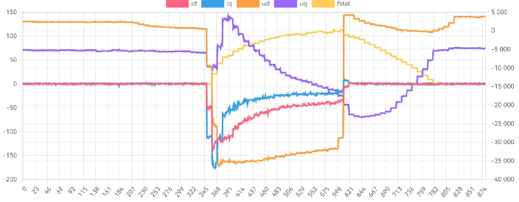

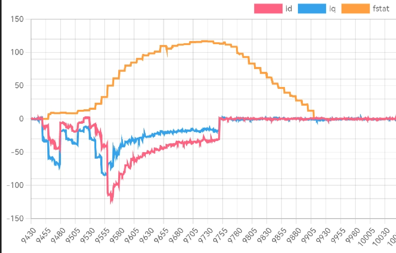

Full throtle.This is the best performance I have achieved after trying to tune the engine. But it is not possible to achieve 12 kW stably
Can I equalize the current consumption? Maybe resolver or reverse?
EDIT1: regen not working
EDIT2: could it be te engine saturations?
