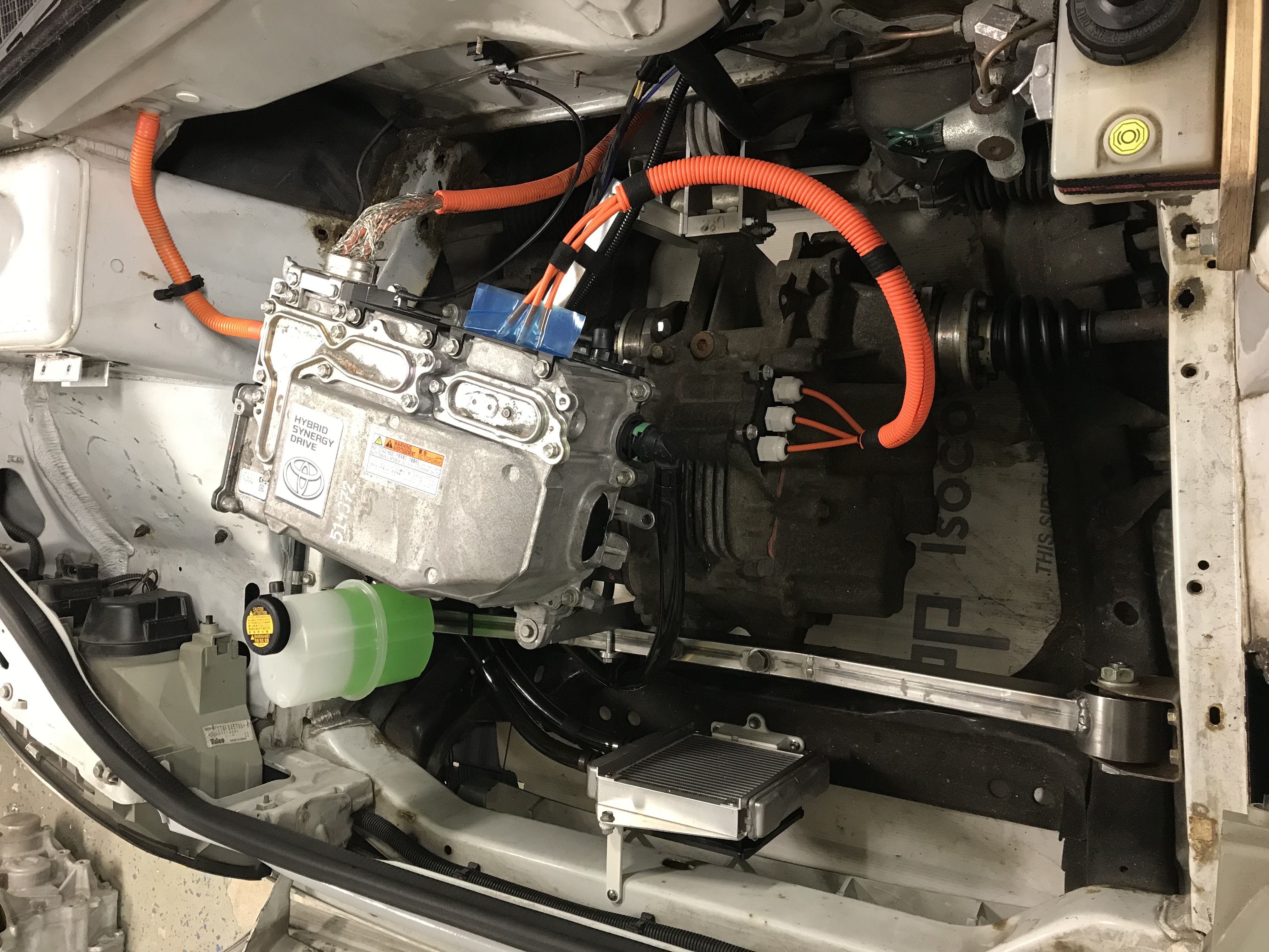

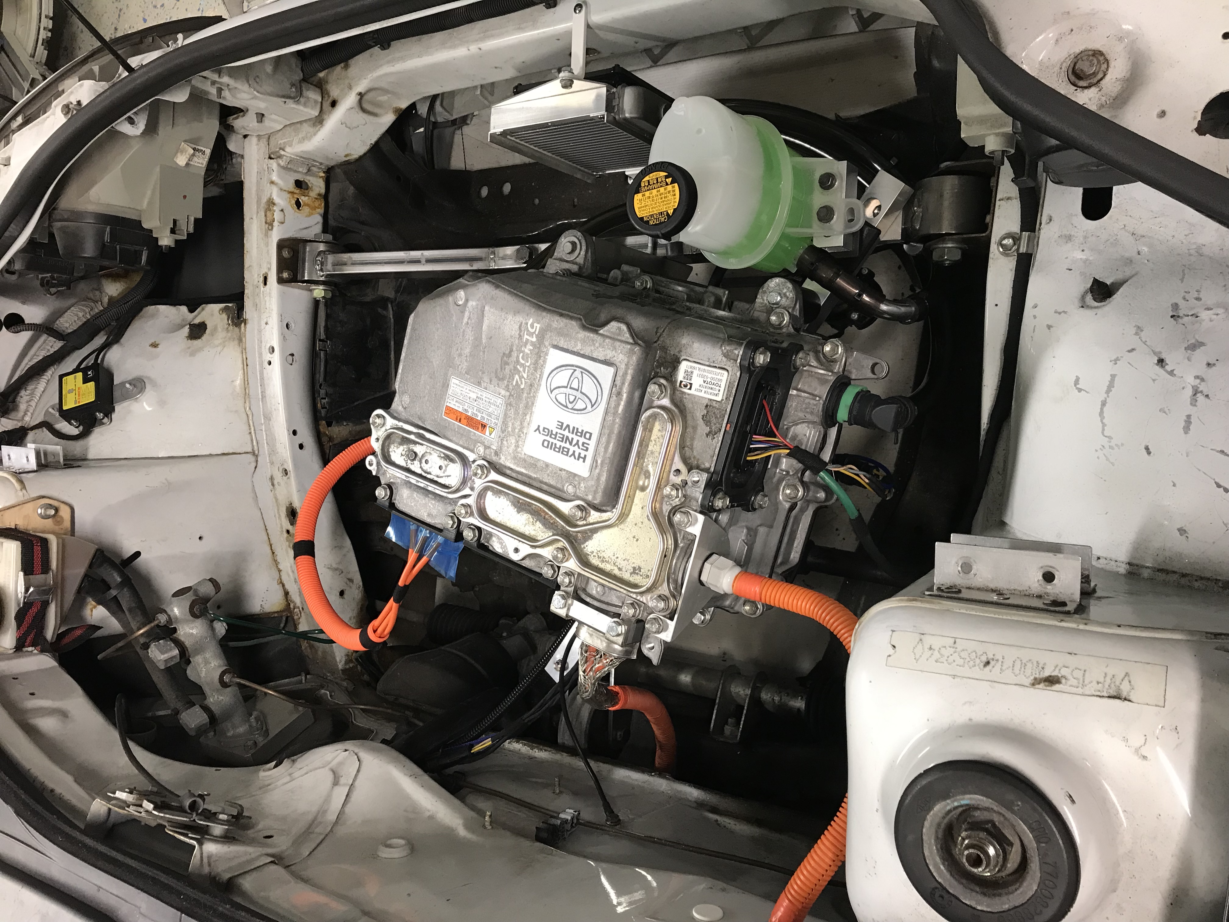

Finaly got a more permanent inverter installation done. Still need to sort out the motor cable as it didn't fit as I planed, hence the blue tape. Best option is to source a original MG2 cable for the Yaris inverter and adopt it on the motor side.
Mounted a water cooler on the inverter coolant as well. Test and calcualtion showed that the temp rise would be to large. With the Leaf setup I never needed a radiatior as there where so much mass in the motor to absorb the heat.
When the mtpv SW is ready, I'm ready to test!

Looking good, must be about the emptiest engine bay I've seen (and the smallest radiator) - little surprised at the size of your coolant header tank though, there must be almost a kg of spare liquid in there!
How much power do you think you are having to dissipate in the cooling loop?

Well I did a test drive without the radiator and with 840g of coolant (50/50 water glycol, with specific heat of 3,3kJ/Kkg) I calculated a power loss of approx 60W based on a temp rise of 20degC and a duration of 15min.
With the radiator the total amount of coolant is closer to 1200g. Before I added the radiator I considered just adding in a larger header tankt to provide a buffer but if I want to drive longer distances it might be a bad idea. There is a 120mm fan in front of the radiator as well which in turn should help circulate some air over the motor as well (air cooled only). Always feels good to get double use out of thing...
Did a drive today and the inverter temp never got above 10degC with ambient temp close to 0degC so seem to make a difference.
The radiator is a heater core from a daewoo matiz. A 140mm fan pretty much covers the whole heater core. Weights less then 800g incl the fan.

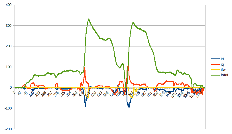

Alright, the over-modulation do indeed increase power with approx 10%.
I got, from battery, 45A @ 387V @ 70km/h compared without over-modulation 40A for the same case.
That SW stays in the car! Would be a good idea as Johu already suggested to make modmax a parameter in the future.
The log from my very short test drive, if anyone is interested.

Nice Same finding on Audi.
I wonder where the upper limit for this is and whether it's diminishing return (or eventuell an int overflow). In the extreme case you'd end up with 6-step modulation but which modmax would this correspond to?
edit: thought I'd plot your data

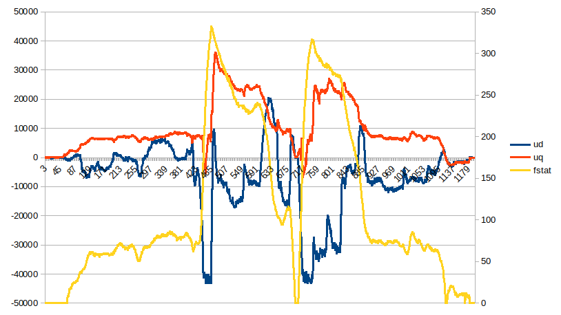

Did a longer test drive and the oscilations at high speed and low current demand is with over-modulation barely noticable so a good improvment here as well!
A quick serch on the topic of over modulation lead me to this article,
https://microchipdeveloper.com/motor:overmodulation
Seem like 1.15 and above no longer increase Uq, but I'm not shure I understand if 1.0 is what is run in the original code or not?

Good find, particularly interesting that over-modulation can start to link Uq into Ud at high levels.bexander wrote: ↑Sat Jan 28, 2023 9:41 am A quick serch on the topic of over modulation lead me to this article,
Wondering whether the best way to do over-modulation is to have two parameters, modmax and modmaxfrq? The later is the frequency by which the modmax value should be fully used. Below that frequency it gradually increases from the standard SVM value. It means that we don't get the waveform distortion at low frequencies but still get the benefits where it's needed (see SciroccoEV's post viewtopic.php?p=48646#p48646 for another reference)

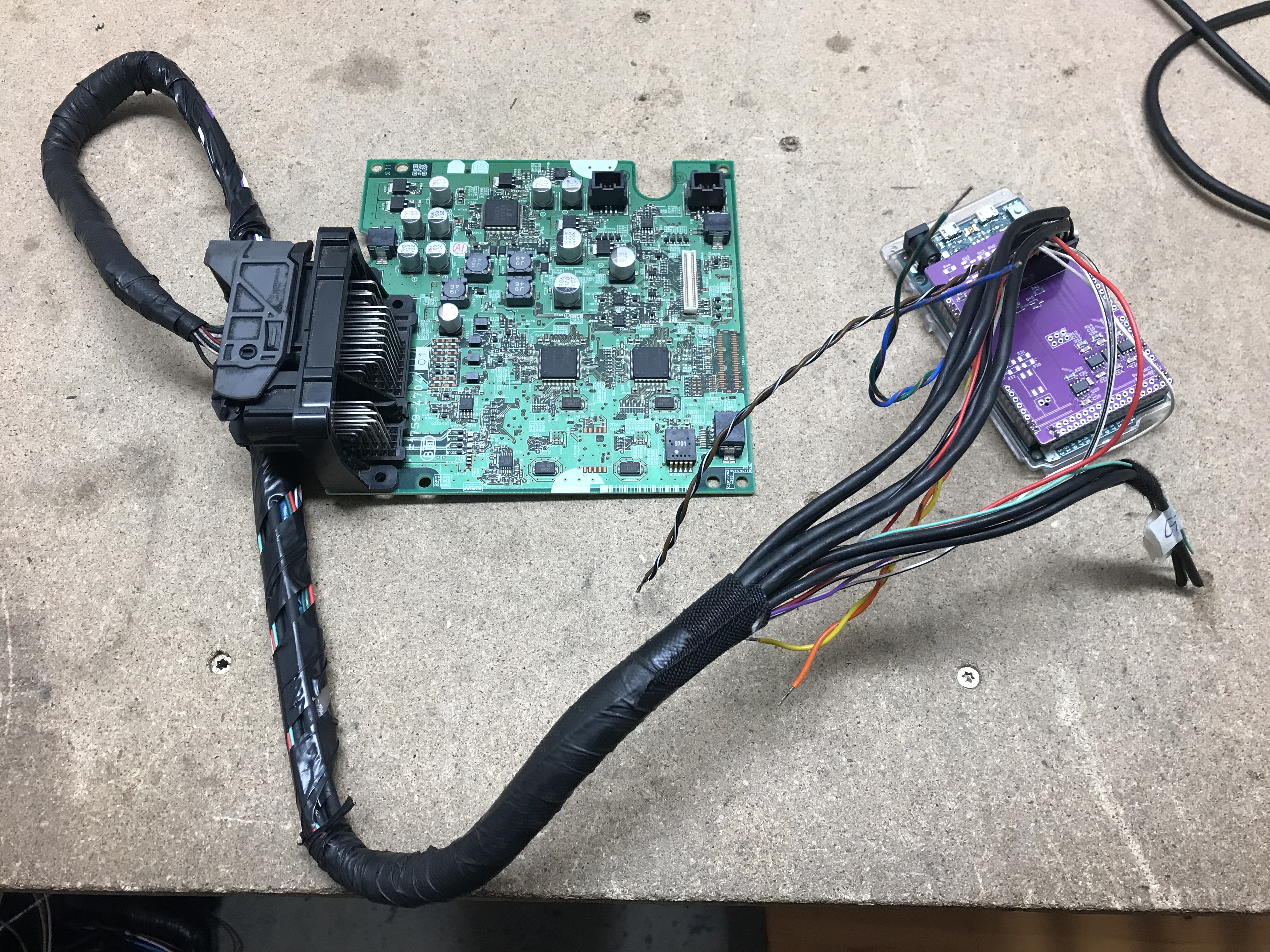

What would also be interesting is trying to drive the motor with an OEM Toyota control board. There's a high chance that it will be compatible with the MGR, and that it will be smooth at high rpm. However, conclusive tests haven't been made with this combo. I've only seen some questionable test bench videos.
I want to do it on my test vehicle, but annoyingly I'm having to spend my time on other things and can't get to it in another half a year probably.
Would love to see this tested on the Clio - just swap an OEM control board into the inverter and get a ZombieVerter or a GS450H VCU to command it.
(Or get another inverter... if you need one sponsored, please ask - it's not out of the question for me at least to cover some of the cost. And you could ask Damien for a "reserach"-priced VCU, as everyone wants to know if the inverter will work in this way.)

My thinking was that I need a RX450h with the extra MGR output and then need to hack that inverter etc.
Quickly looked in to it and at least Johannes uses similar parameters for the MG2 in the Audi project, specially the missmatching resolver/motor pole pairs.
I will investigate this further. I do still have the OEM control board for the inverter.

I was a bit concerned about resolver position with a random motor/inverter setup and also my inverter is heavily modified on the inside to only supply voltage to motor side and using that same voltage to supply the DC/DC but after watching this video posted by Damien I'm thinking that this might actually work! Very Exciting!!
Video will start at the interesting bits.
Also, I have a Arduino Due and the V1 of GS450h inverter controller uses that same ARM processor so I could probably get away with a simple home made shield on top and some adoptions of the code, at least for testing.

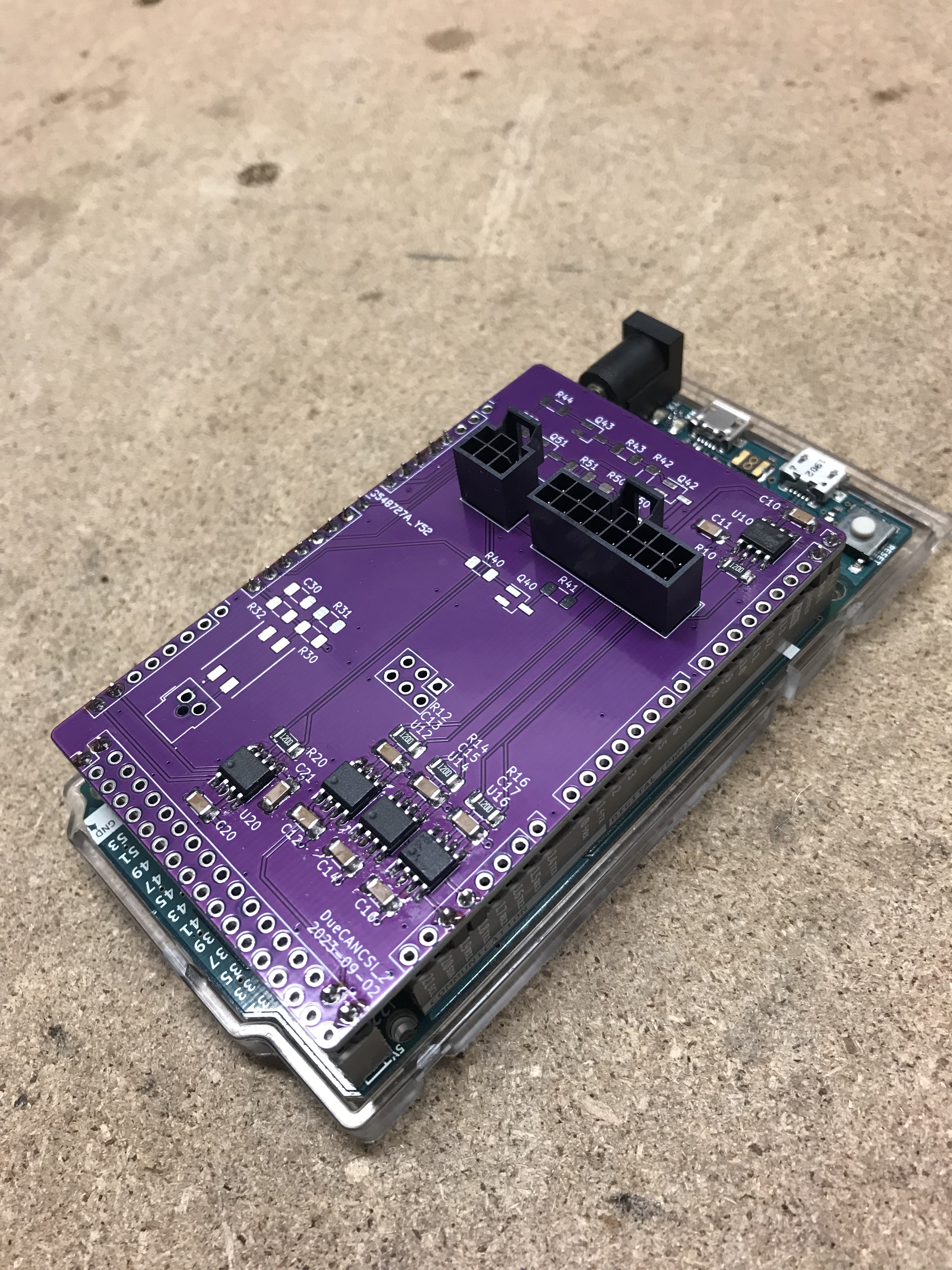

I've created a shield for my DUE to be able to test communicating with a Toyota logic board using Clocked Serial Interface Protocol.
First step is to establish communication with the logic board and then step by step find out if I can control the MGR with this setup.
Sourced suitable connectors and cables as well. I do have the resolver part of the Toyota connector as well.
I have created a rough SW based on the Lexus GS450H VCU SW and ZombiVerter VCU SW. First step is to establish communication with the logic board and then step by step find out if I can control the MGR with this setup.
