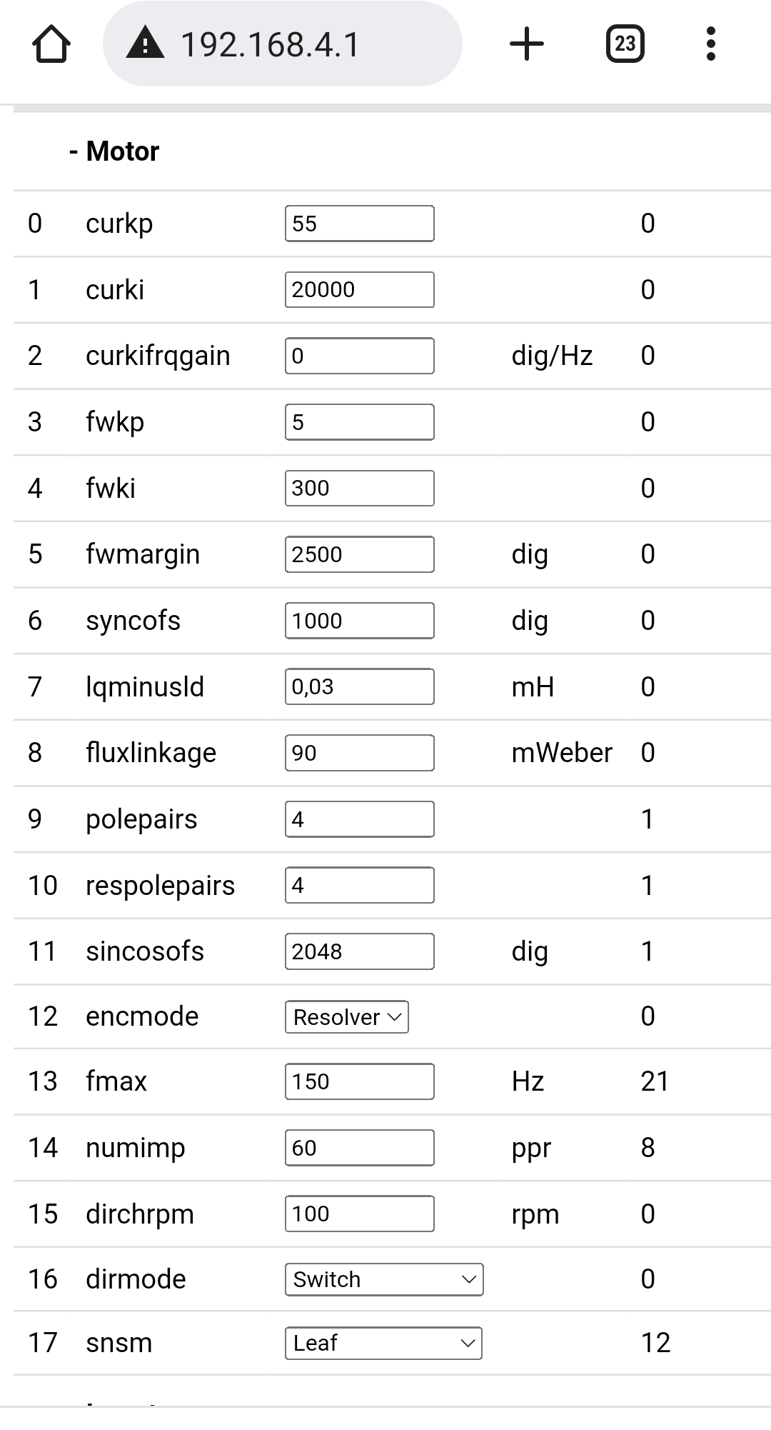

Hi, folks.
I`m try 5.20 firmware.. well, what can I say - the unexpected recuperation seems to have really gone... but the behavior of the inverter itself has become completely unpredictable, it seems that the inverter has been torn off the throttle and it lives its life 1. When pressed throttle, it accelerates very sluggishly from the spot, but when passing 30 km/h, it suddenly accelerates, even if the throttle is not completely pressed... Setting lqminusld=1 make better with start from spot, but acceleration worse than my current firmware v.5.06.
2. When driving at a speed of 60-80km/h with full release of the throttle, it continues to far to the full even when you press the brake, it continues to turn with a large flow rate, that is, to stop, you need to suppress the motor by brakes!!! :oops:
3. There are some new settings in the firmware, but configuring them did not improve the behavior...
4. The motor is still blocked when the neutral is turned on during movement, last time on the previous firmware (5.12) this broke of the hinge...
my_params _gen3_outlander_MGR.json
(1.33 KiB) Downloaded 87 times
Posts: 5789
Has thanked: 157 times
Been thanked: 1023 times
Re: Inverter Firmware 5.20.R
sounds not too good but not too surprising either:
1. MGR apparently needs large lqminusld, maybe 5. Try it
2. Please check curkifrqgain=0 and please post the parameters with new firmware (the ones you attached are your older ones). Also make sure syncofs is well tuned
4. damn, forgot to keep this. Ok, no neutral for now.

johu wrote: Mon Sep 12, 2022 1:42 pm sounds not too good but not too surprising either:
1. I`ve try it, is not help :(
2. Try curkifrqgain=0 - not help
UPD: May be isn`t clear from video, but after 80kmh I release the throttle, but motor continue to drive and when I press brake it still provide power (see ampermeter on dashboard) I need continue to press brake for stop a car. :twisted:
OVERCURRENT was because I set "idcmin": -100 for save my transmission.
About: "Also make sure syncofs is well tuned" - with 5.06 firmware works perfect. If only we don`t need tune it for each fw version?
my_params_gen3_outlander_MGR_v5.20.json
(1.45 KiB) Downloaded 74 times
