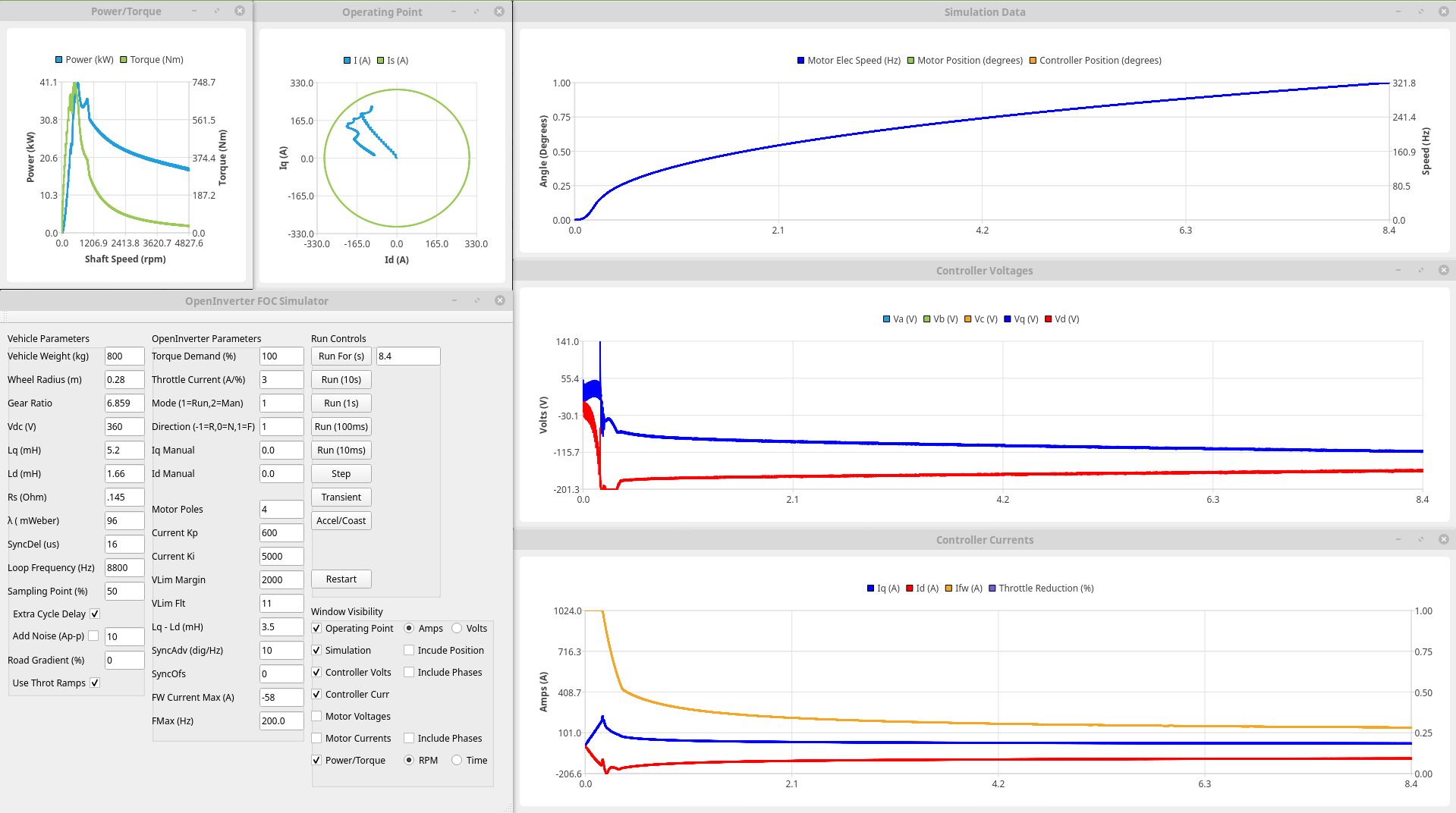

Little more progress, think I know how to do it all. Decided to graph the algorithms in a spreadsheet first just to make sure what they were doing made sense before trying to port them into the OI firmware. To plots: It looks sensible, above 40Hz (which is roughly where MTPA runs out of steam and fw starts to come in in the above plots) it starts following the MTPV curve and moving current from Iq to Id. This reduces Vd and holds the total motor voltage stable at 200V (this is the value used in spreadsheet for udc/2). Once the speed gets to around 140Hz this is no longer enough and this is where the operating point would need to start moving from the MTPV point towards the critical current point (throttle reduction).
So it all looks like it should work, just need to get the equations into the firmware now...

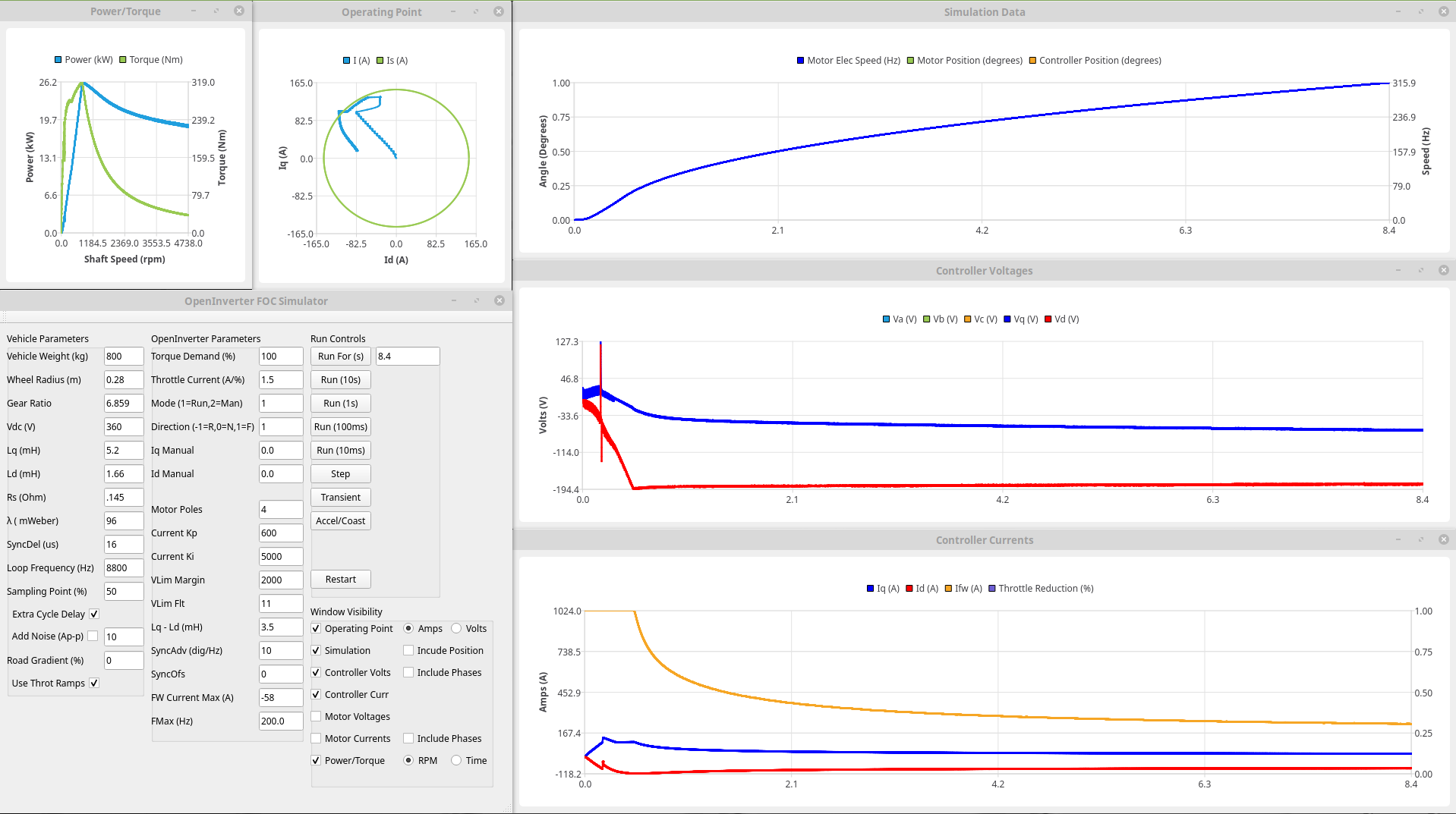

Some progress but not making quite as much sense as I would like and it doesn't want to transition cleanly into MTPV. I think the problem is mostly that I don't fully understand the mathworks equations that I'm using. Also need check how frq is generated as I'm wondering whether it lags slightly and this is causing the problem.
First the original FW results: Now MTPV with the same settings: So that's around 1.6seconds less time to the same speed as before (8.4sec vs 10sec), 33kW peak, 22kW at 2400rpm and 18kW at 4800rpm (compared to 29kW, 19kW and 14.5kW for the FW code)
Dropping throttle current from 2A to 1.5A gives: 33kW peak, 21kW at 2400rpm and still 18.5kW at 4800rpm so a much less peaky and more usable power curve and not significantly slower.

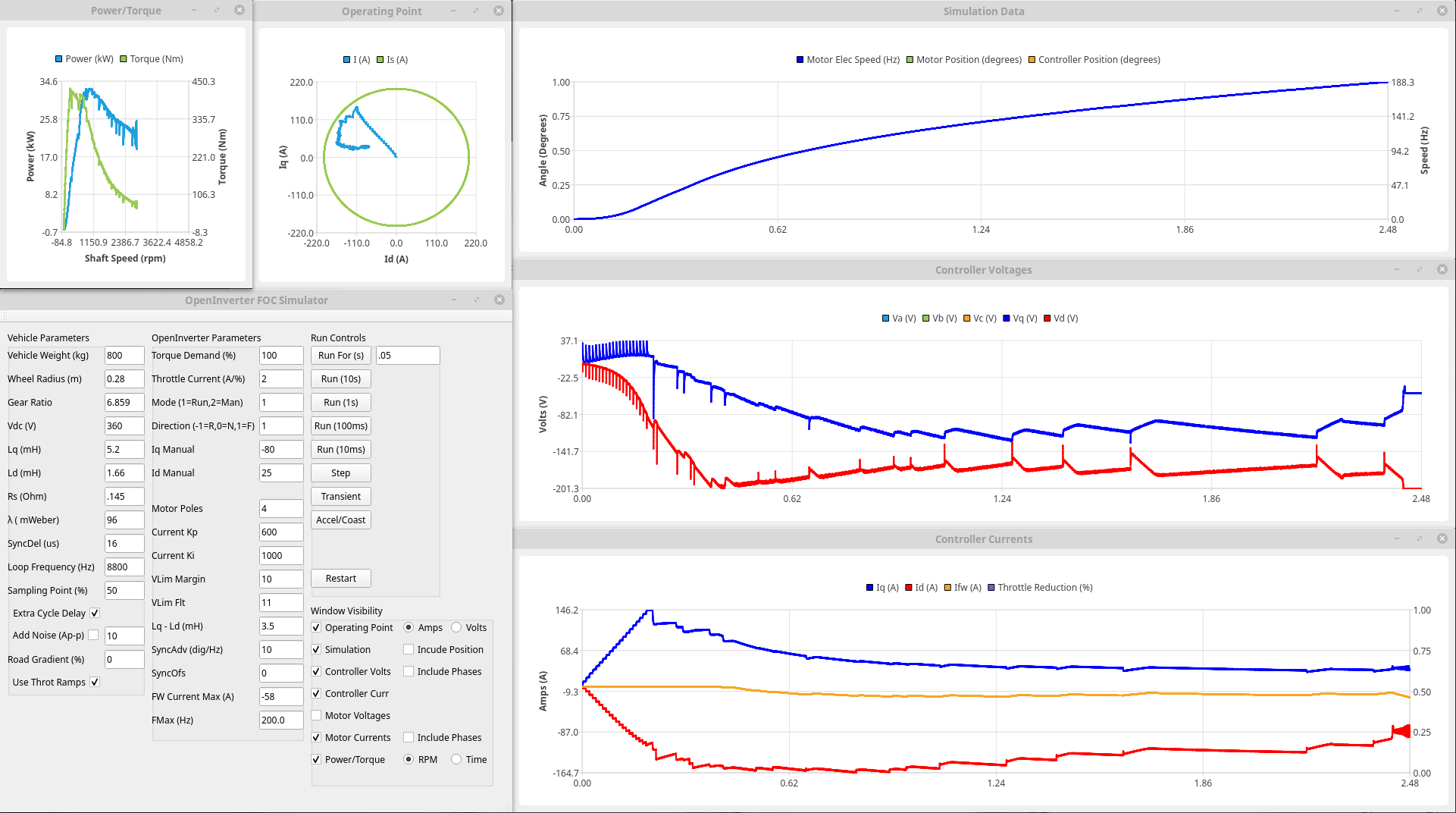

Had another look at this and it doesn't handle regen very well, essentially it doesn't allow enough Iq to do any significant regen when past base freq
Need to go back and review the MTPV equations to see what I'm doing wrong.
