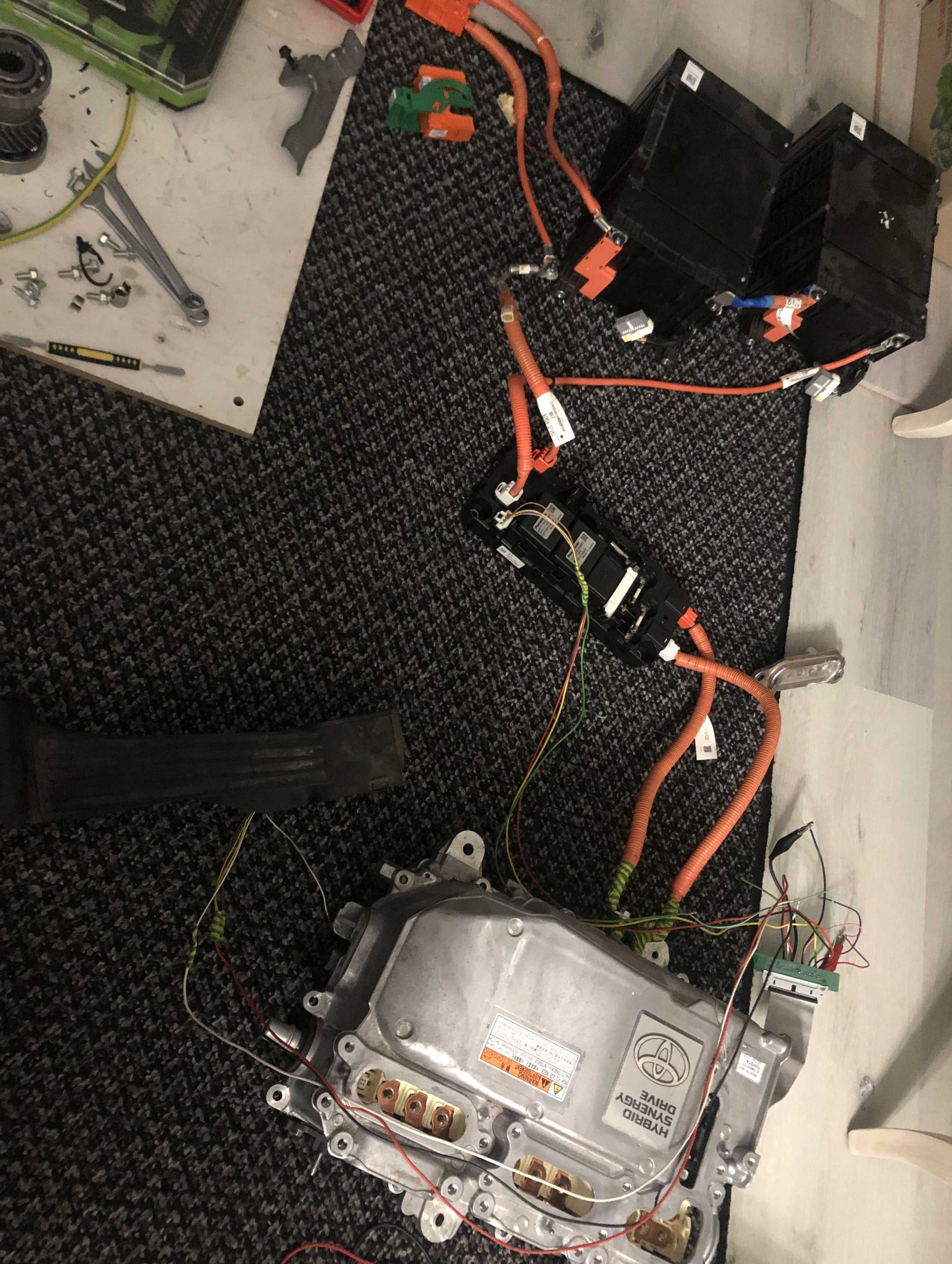

Hi
Help me please with problem
Din_start always “On” but stm32 pin 58 (MG2 start) has 0V
How to fix it? I can’t save parameters because board always run and can’t stoped

I use a diy board assembled according to the Auris / Yaris V2B4 inverter circuits. Firmware version 5.24R-foc. The "stop the inverter" button in the web interface does not stop the inverter. I tried to download the software through the web interface, but it gave an error. I also checked with an oscilloscope the presence of a PWM on the outputs, it is only on 2 pins (pwm1_n and pwm2_n) in testing mode.
Re: Auris/Yaris inverter
I didn’t say correctly, on pins pwm3_p and pwm2_p there is a PWM, on others there is nothing

I designed the board myself. Soldering is in order and there are no short circuits. I checked pin 58 (start) and it turned out that it was not working. It seems that the matter is in the stm32 itself. In the web interface, the board is defined as Prius

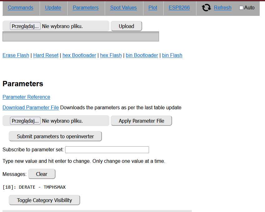

When I run it, I get the error [18] DERATE-TMPHSMAX. The small_dual_v1d board has the latest soft stm32_sin loaded, only the gas pedal from BMW is connected.

You get a heat sink temperature derate. What heat sink temperature sensor have you selected? I run "snshs": 1 i.e. "semikron". Seem to work well for the toyota inverters.
And what does your heat sink temperature read? "tmphs" under "Spot Values".

thank you very much for the hint. change "snshs": 1 i.e. "semicron" helped. I am very grateful for your help
