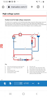

I have Passat GTE cells at home and they have liquid cooling and persumably heating too. It would be foollish not to have both with that cooling plate.
Passat GTE is using the same kind of PTC heater as Golf EV.
