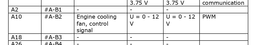

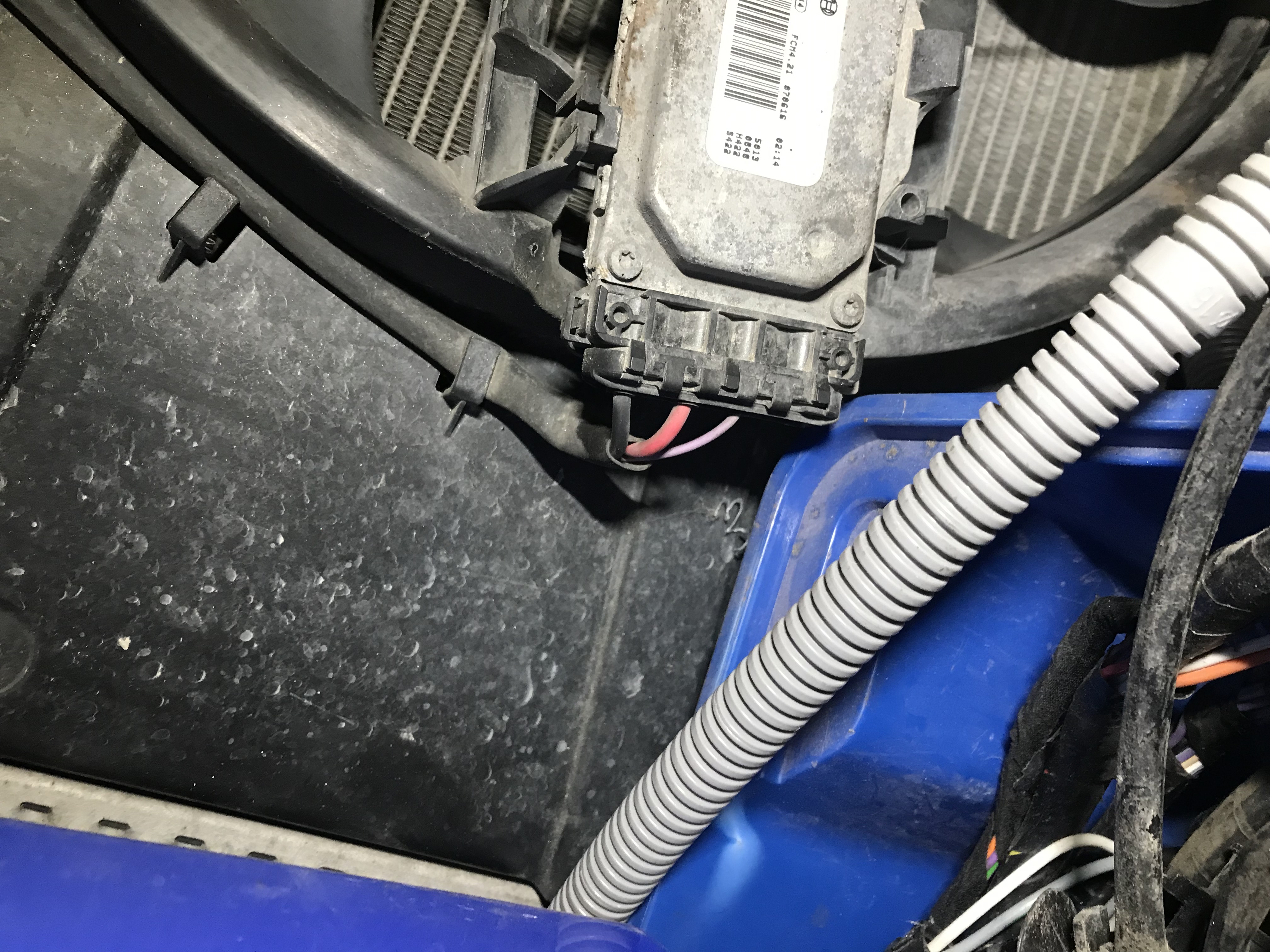

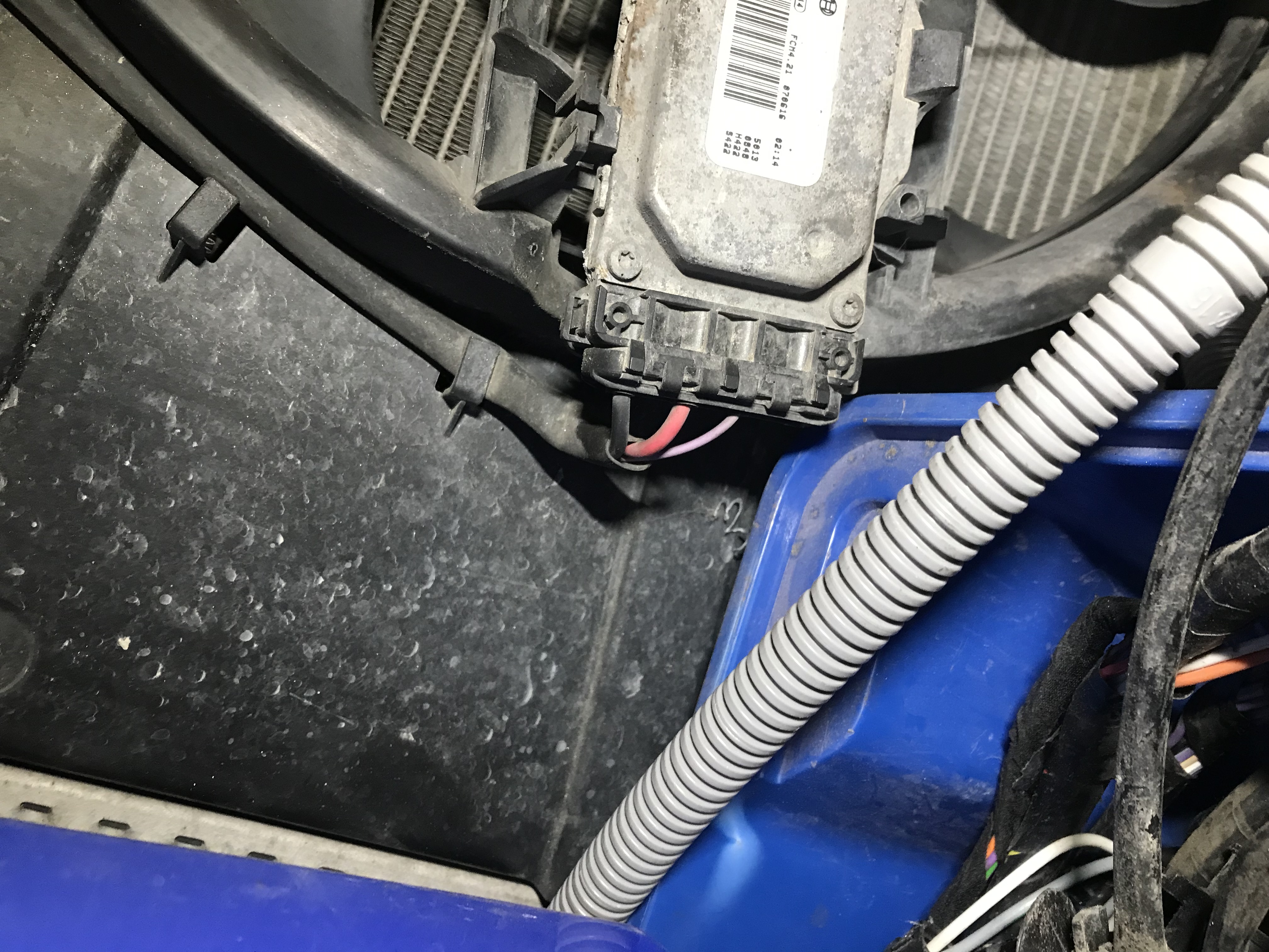

Had another look at the connector and I think it is OK to reuse. Also decided to leave all the connectors off during the initial build as they are difficult to remove without damage, difficult to replace and I don't know if the board actually works yet! Once the board is tested Ill hand solder them on. The soldering wont be quite as neat as reflowing them with the rest of the board but it seems a safer approach.
The PWM frequency on the F4 looks like it will be either 5.1kHz or 10.2kHz due to the increased core clock frequency. I would like to run it at 10.2kHz but not sure the Prius inverter will cope, any thoughts on this?
Also planning to change the way desat detection works. Given the Prius inverter seems so good at protecting itself I'm inclined not to immediately disable PWM (not a great idea if above base frequency) if the MG fault line goes inactive. Instead I'll limit the torque request and light the ECU error light. Again, any thoughts?

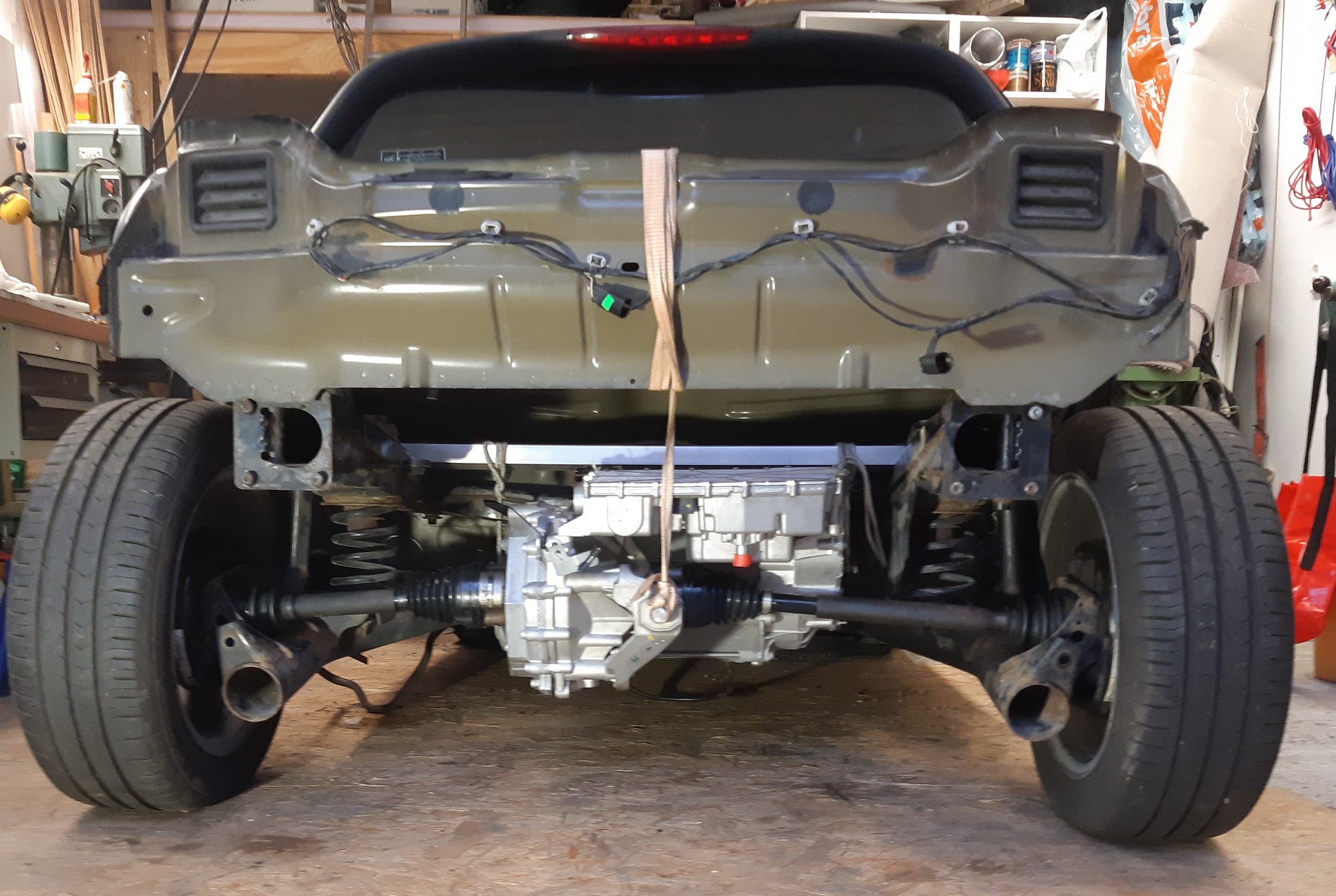

Cool to see that there are several people who are interested in converting a Smart Roadster to electric operation. Have had a hold up in my building for 1 1/2 years.
My build consists of Smart Roadster 2003 and motor with inverter from a VW ID.3 have assembled it in place. The next step is to communicate with the inverter, where the plan is to use the power transistors from ID.3's inverter and openinverter.org Brain Board Rev 3. What remains is the adapter board for the IGBT transistors.
An early picture of the engine installation:

Looking good Are you going to do a build thread, I'd be interested in seeing more details?ChristerE wrote: ↑Thu Dec 29, 2022 7:44 pm Cool to see that there are several people who are interested in converting a Smart Roadster to electric operation. Have had a hold up in my building for 1 1/2 years.
The motor looks like it fits well, the motor being forward of the driveshaft means that it clears the watts linkage and keeps the weight towards the middle of the car which is good. What are you plans for batteries and where are you going to put them? Has anyone reverse engineered the ID3 IGBT driver interface?

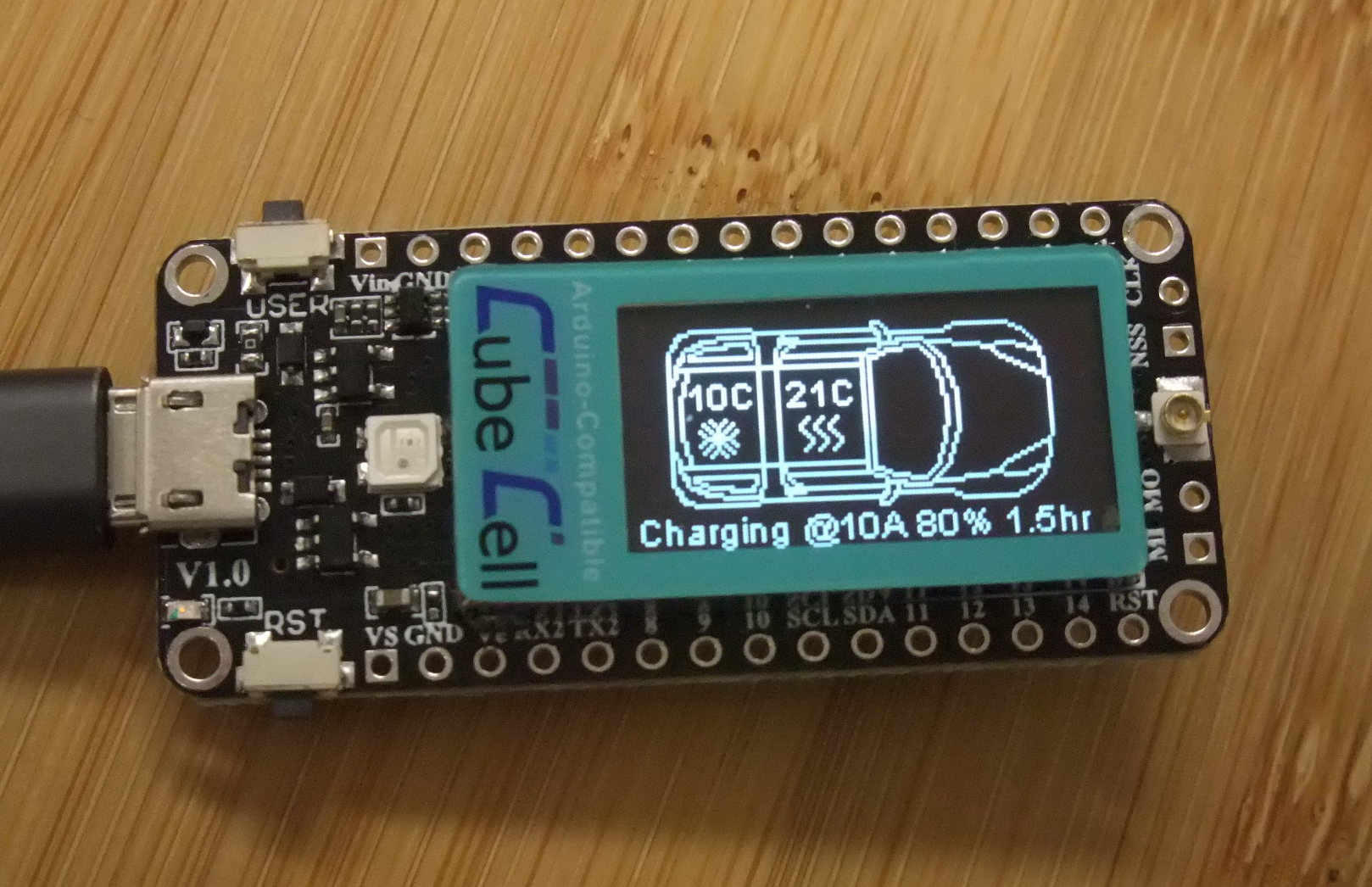

A little more progress on mine. All the bits are sorted out ready to hopefully assemble the board tomorrow. Have revised the terminal class in the firmware so that it will cope with the unidirectional RS485 comms (removed echo characters and added transceiver receive/transmit switching). Also ordered a USB/TTL to RS485 module so that I can talk to it from either the PC or ESP32.
Also the Heltec board that I'm hoping to make a keyfob remote out of turned up today. Only had a quick play with it but fairly impressed so far (not used the RF side just messing about with the display); the Arduino support and examples seem to be really good. This is where I'm up to with it (ignore the heat/cool icons and temperatures - I know they don't make sense!): Can't decide whether to keep the Roadster graphic or just use it as a text display. The graphic is nice to have but it does take up a lot of display real estate making the text a bit on the small side.
I also have the LoRa transceiver for the car end and a spare Nucleo-64 (STM32F103) to hook it up to for testing so hopefully have the RF side working soon too.

The other thing I thought it could be used for, as well as the ability to pre heat or cool, is to be able to boost the batteries to 100%. My understanding is that charging to 100% is only harmful if the battery is then left in that state, if it is immediately discharged then the harm is minimal. Is that correct? If so then the ability to normally only charge to 80-90% to protect the cells but have the ability to boost half an hour or so before leaving could be quite handy on a car with a smaller battery pack?
The only other idea I'm toying with is whether to try and build the PCB from the standard car key fob into the back of the LoRa one so that a single fob can be used to both unlock the car and remotely access it?

- Based on a STM32L496 processor (91uA/MHz when running, 2xCAN, 3xADC, 2xDAC, 6xUART, etc).
- CAN1 - To interface to Smart's existing bus (only active when ignition on).
- CAN2 - To interface to battery pack, inverter boost/DC:DC processor and charger interface (always active).
- RS485 - To interface to external ESP32 module for web interface and data logging.
- LIN bus 1 - 9600baud, I-Pace A/C expansion valve,
- LIN bus 2 - 9600baud, I-Pace A/C ball valve and I-Pace expansion valve,
- LIN bus 3 - 19200baud, VAG water heater, AC compressor and AC pressure sensor.
- LIN bus 4 - spare channel.
- 4 x PWM outputs - to suit Prius/Auris variable speed aux water pump speed control (inverter/motor loop, battery loop, cabin heat loop and spare).
- 4 x PWM inputs - to suit Prius/Auris variable speed aux water pump status output.
- 2 x 3-way water valve control outputs (interface TBD, battery loop mixing and spare).
- LoRa transceiver - for remote keyfob.
- Charger Pilot and Proximity connections interface.
- Interface for external HV DC voltage measurement circuit (MAX22530 based)
- 8 x 10k NTC temperature sensor inputs (A/C compressor outlet temp, expansion valve outlet temp, cabin evaporator temp, battery water temp, external temp, cabin temp + spare)
- 1 x switch mode out to drive cabin heater fan motor
- 2 x PWM out to drive cabin heater blower control module and radiator fan control module.
- ? x analogue inputs - +12V battery voltage, cabin temp setpoint, cabin fan speed setpoint +TBD
- ? x 3A? low side output drivers - TBD
- ? x 3A? high side output drivers - TBD
- ? x digital inputs - TBD
Again this is very much phase 2 and is highly unlikely to be in the initial car. I've started on the schematic but it is another trickle it along in the background project. The list above is just to try to get it clear in my mind and if I've missed anything hopefully someone will point it out
Edit - changed fan control method above.

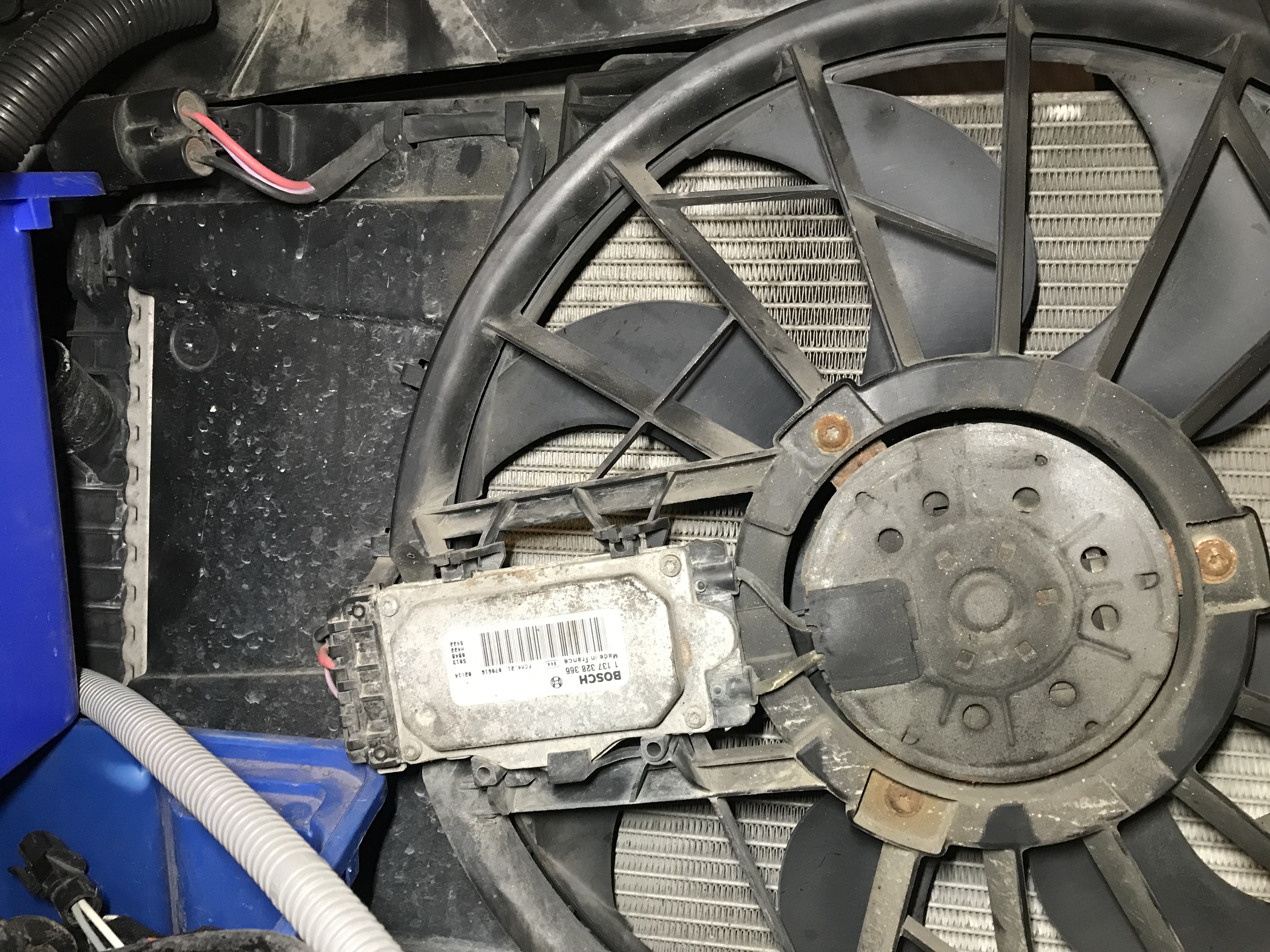

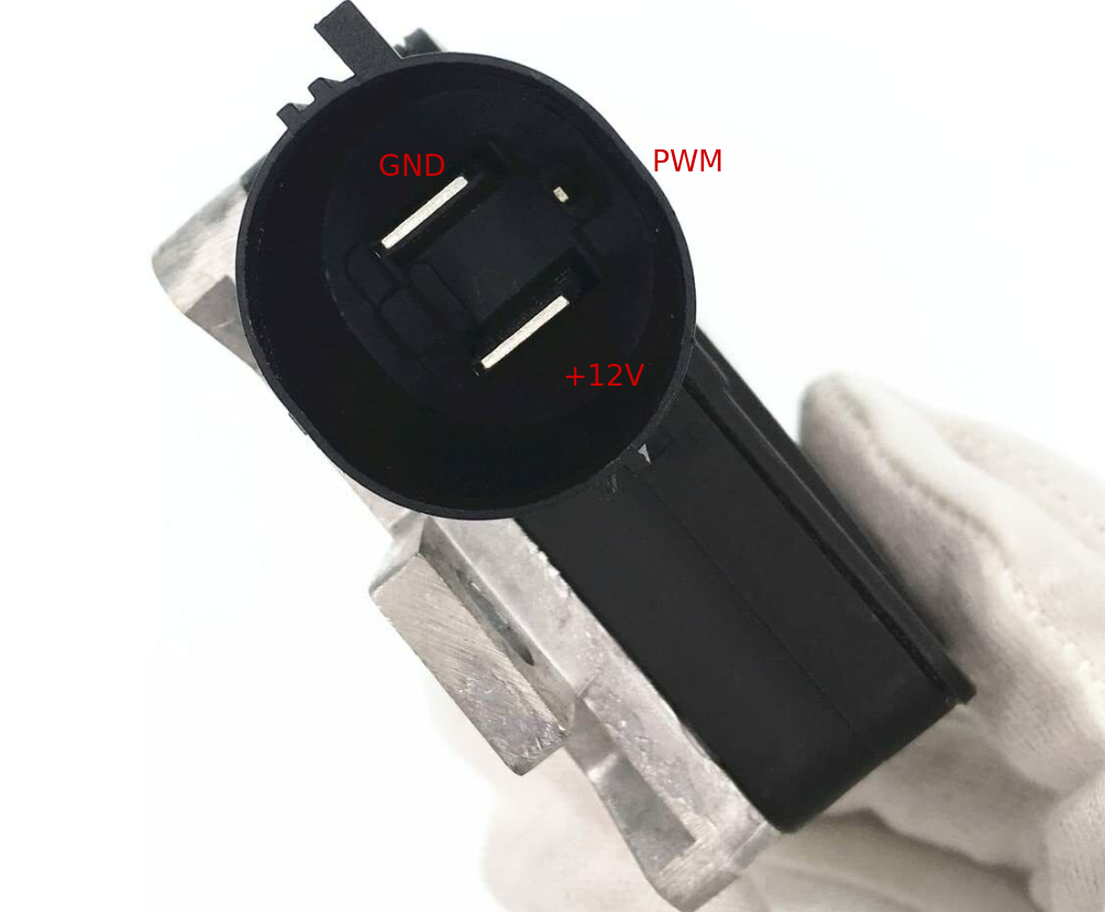

Just had a thought re the above, for cabin heater fan control I was planning to build a brushed DC motor controller into the VCU, the trouble it that means routing the high current fan wiring too the VCU and having the heat generating and potentially electrically noisy PWM stuff inside the enclosure and close to the LoRa module, neither of which are ideal.
It occurred to me that I could use a standard off the shelf radiator fan control module, something like this, https://www.ebay.co.uk/itm/255606958284. I think it just has a PWM control input that controls the fan speed and if so it would be ideal and a lot easier to do.
Has anyone used something like this and if so did it work and can you confirm how they are driven?
Now I know everyone is asking why bother with this at all? Well firstly I would like to eventually be able to preheat/cool the cabin which needs electronic rather than manually switched control. Secondly I'd like to convert to climate control rather than manual control an thirdly the Roadster has a notoriously bad heater fan control switch which has a habit of melting both itself and the attached wiring, and mine already has, so it needs replacing anyway!

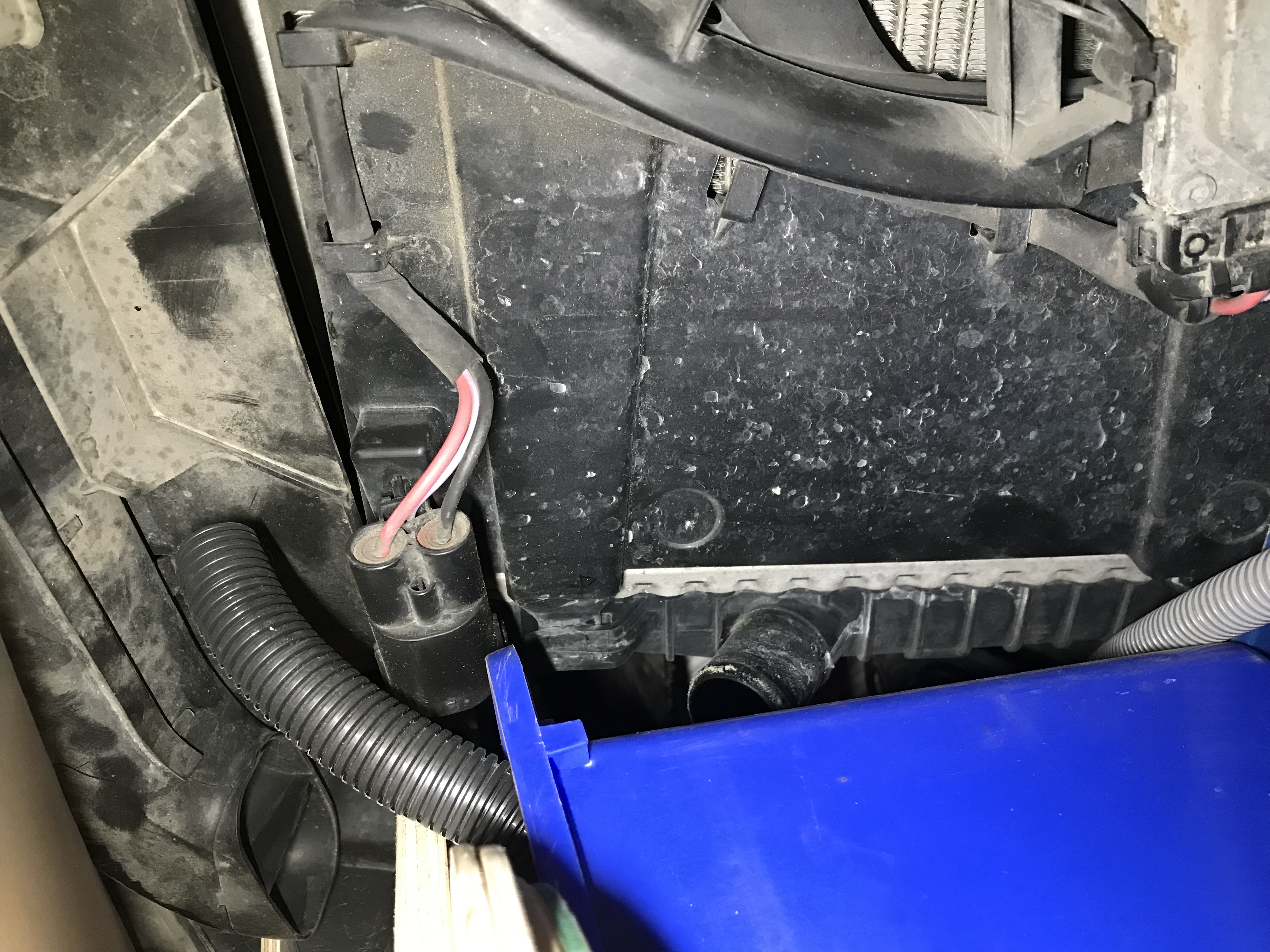

Very interesting idea. In the C30 (my other project car) I think uses exactly the controller you linked to. (C30, S40, V50 and C70 uses the same platform, Volvo P1).
In the wiring diagram for my car it looks like this: And then reading the pinout explanation for the 2.0D ECM pin A:B2: It shure looks like the ECM is just sending a 12V PWM signal to the fan controller. The fan controller is mounted very close to the fan motor in the car.
I do not have the C30 in the garage at the moment but I still have all parts needed to hook it up and maybe possible to measure the PWM frequency even if I don't have the IC motor and all the other signals to the ECM. Let me know if I should look into this when the car is back in the garage?

Thank you, exactly what I was hoping to hear.
Don't worry about trying to measure it, without everything connected up, and possibly the engine running, I doubt it will do anything but thanks for the offer.
What would be very useful is which wire colours go to which connector pins?
I'll get a used one on order and give it a try.

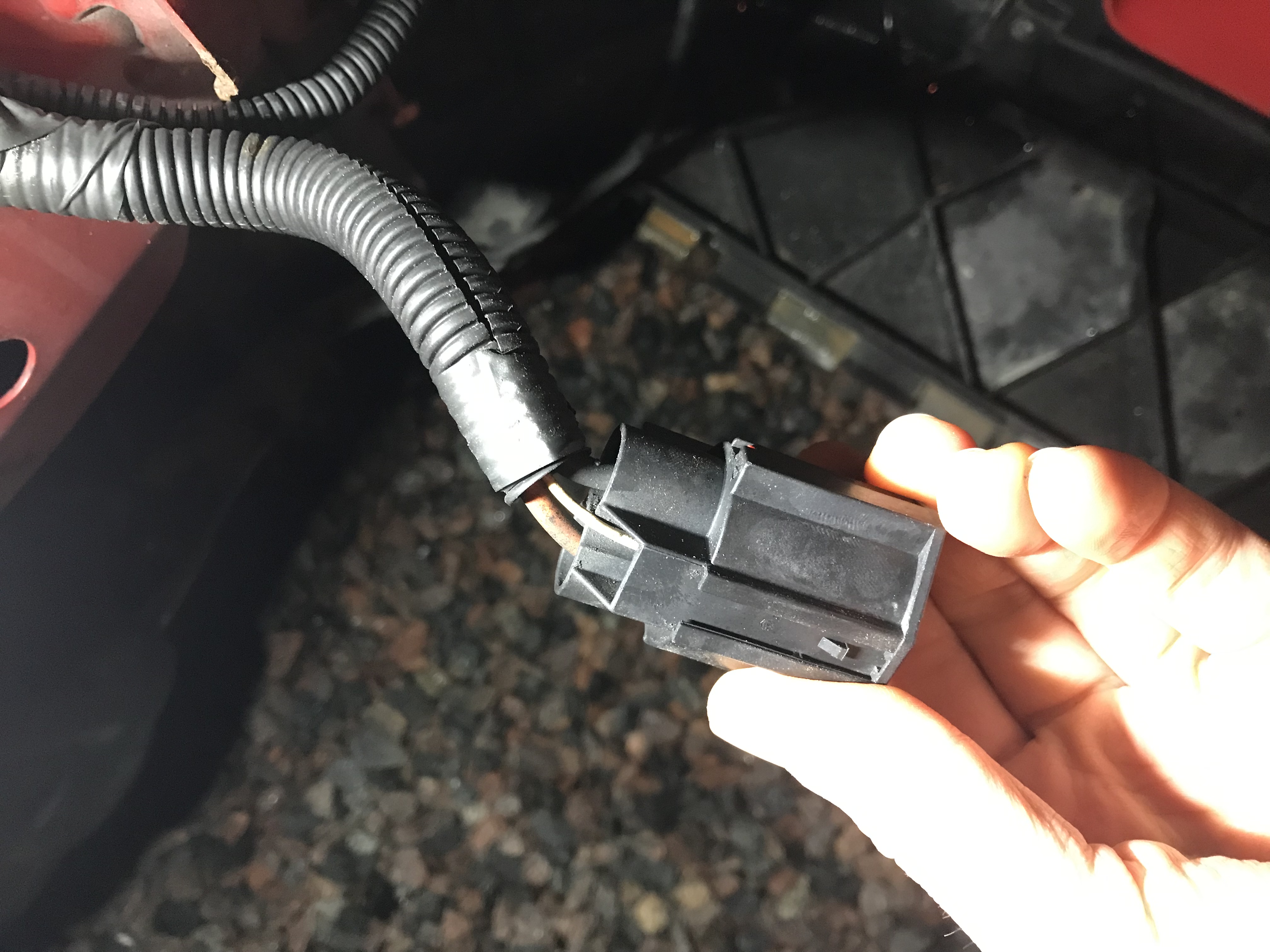

I was thinking that the ECM might send out an PWM signal even if not commanding any fan, but I guess you are right that it will not if the engine is not running.
My module looks very different but the connector looks like it might fit the module you linked to from ebay. So my best guess is
