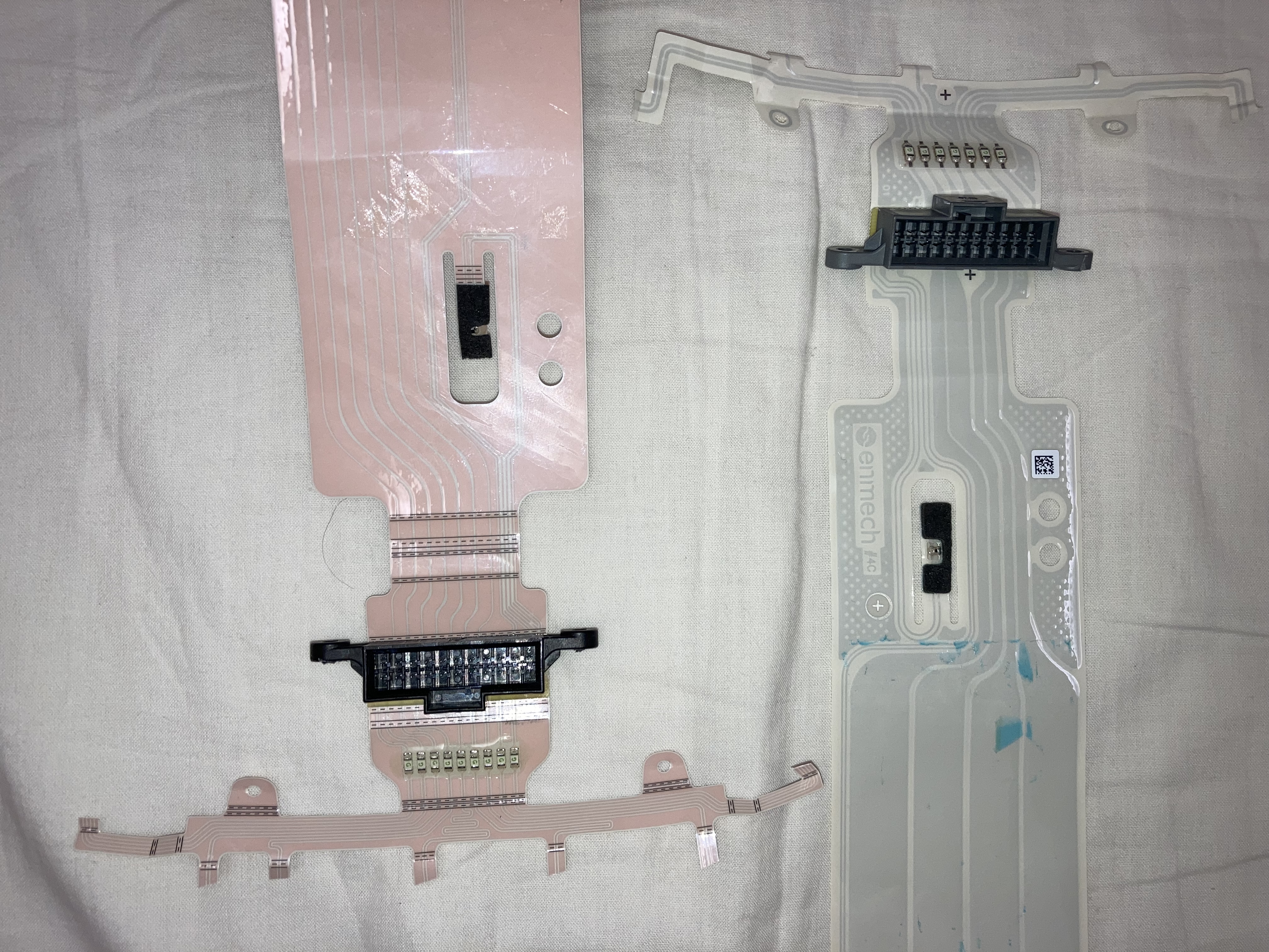

Fuses. 1206 size SMD fuses in the LG Chem version.

Kutato, great picture. This helps a lot!
I guess the grey flex cable is from an 8S module and the pink one from a 12S module? So there are 4, respectively 6 fuses somewhere else? Also good to see one of the NTCs. Is the other placed similar, just on top of the cells?
Best regards, Jochen

There are also fuses at the other end. He just couldn't fit a single photo.

"The Orion BMS balances at a maximum rate of about 200mA". So the MEB modules can't be used with Orion BMS?Carel Hassink wrote: ↑Tue Mar 29, 2022 9:31 pm Jochen, what a bummer, sad,
but think you blew the smd resistor in the line of the flex cable, leading to cell 12, disabling it effectively.
100mA is about max what it will take...
Lars, a partner has designed a cell-tab board using oem cell-tab cable, out goes MOLEX with pin-numbering sticker for easy connecting,

I've used e-tron modules,3s4p 240ah, in a couple of builds and those use the same type on flex cable.
The flex cable has a high resistance compared to normal cables which can be a problem for the BMS because of faulty cell voltage readings. I’ve seen this on BMS based on the LTC68XX stack monitor. I ended up modifying all modules and replacing the flex cable with 22 awg cable.
Can Orion compensate for wire resistance?

I have actually cut off the ends of these batteries using a 1mm thick disc cutter blade, there are fuses both ends from memory the 3.6v, 11.8 etc fuses are at the opposite end to the terminals. Just follow the weld and cut to about 2mm and you are ok. One of the wider sides of the battery has an area that is not welded this is the bit where the printed circuit runs so be careful in that area.Scutterbob wrote: ↑Sun Dec 18, 2022 4:27 pm Often like incandescent bulbs, slow blow fuses are temp and current dependent. They as "slow blow" don't respond to a minor spike. But I don't know if these "fuses" are fast or slow. I found this thread a few weeks ago, have the sealed box aluminum cased battery and while I can sense all cells, I can't get a conventional 8 cell test device to see any cells. I'm already expected I'll have to rig up a way to cut the lid which is not going to feel safe. I am guessing I'll rig up an angle grinder with cut-off wheel on my radial arm saw locked in linear and tilted 90 degrees, or something. I have both 8 and 12 cell batteries. I tried to make order of battery manager from Netherlands but paypal shut me down.. I mapped out both batteries to what others have posted and interfaces agree, I've ordered from VW parts sellers the connection light gage cables and attempted to make my own breakout boards.. and still failing ... I have mixed uses.. lawnmower and excessive PV absorber to power EV when available.
Any and all tips apprenticed
My reason for opening one was for one of the bms sensor wire fuses popping. I have found that if you have the sensor wires connected to a bms unit and the batteries that any slight short to earth when connecting the hv cables to the batteries will pop a fuse.
Hope that helps
