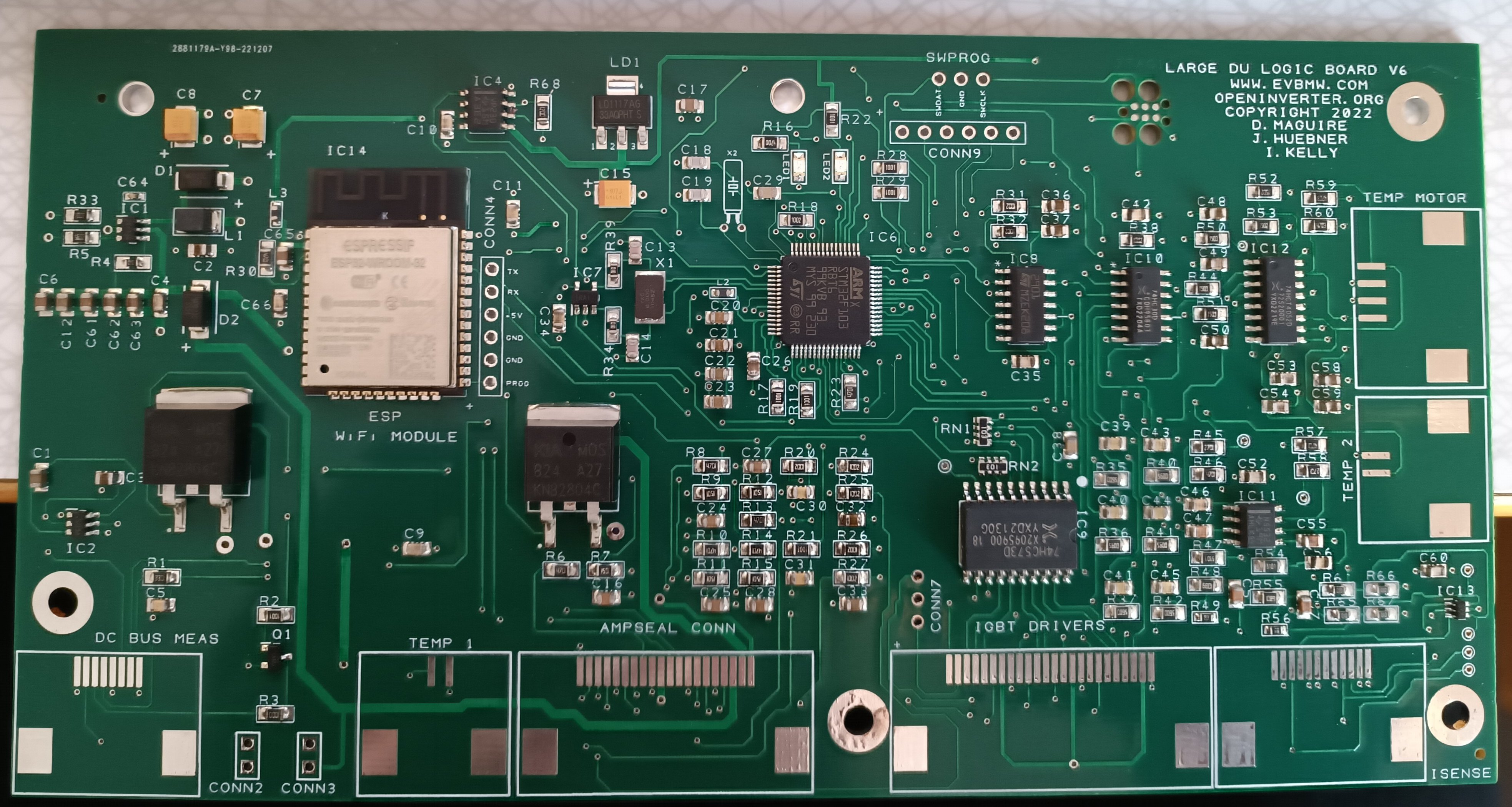

Both are done. The LDU was a bit tight but I managed to squeeze it in. Not sure how well these work mounted like this, but I cleared the planes under the antenna which should help. Also added 10k resistor arrays on PWM and clock output driver. Not sure if they are needed on the clk. What file name/version should I used for the update files? I can produce gerber and other output files, and pdf/png for schematic and layout if needed for checking. DesignSpark is fairly horrible so you made a good decision not to use it.

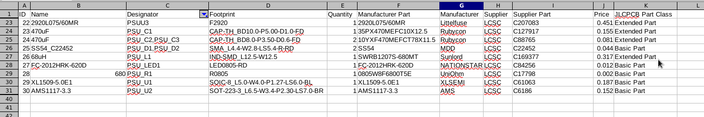

Johannes can you confirm the part number for ESP module ( ESP32-WROOM-32E-N4, C701341 has the highest stock level ). I am updating the BOMs, which is a manual process, and while checking the data sheet for the ESP32 I noticed that the footprint I am using is not quite correct.
Been thanked: 1918 times
Re: Put ESP32 on Tesla LDU and SDU board
I use this one: C82899. Only two requirements were PCB antenna and solderable in economy process (not standard process)

Ok I will put that in the BOM but as it is not recommended for new designs they may run out of stock.

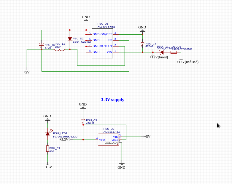

i would make sure that you have a large cap on the 3.3v rail (as well as ones very close to the chip) as the power spike when the wi-fi is enabled, caused me a great del of pain on some of my projects as its caused reboot loops! in had to bodge on some big caps rather than the smd ones.
i typically just go over kill now and put 470uF (through hole or smd) caps on the 12v,5v&3.3v lines, the esp32 dev board reference design is good for inspiration as well. personally i would just put a esp32 dev board footprint on there as you can buy them for sometimes less than you can source the parts for from jlc, also the genuine expressive ones aren't that expensive in the grand scheme4 of things.
for ref my typical psu arrangement i have been using with the esp32 (dev boards)

Files attached. I hope they are OK, I can change anything if necessary. The placement and rotation data files are not very good but no worse than the previous versions.

An enormous truck pulled up here this morning and delivered
Update: programmed fine and works :)

This is absolutely beautiful. Thank you mr royhen99!
Bonus points for putting a +5v supply for ESP32 programming with a USB UART cable!
