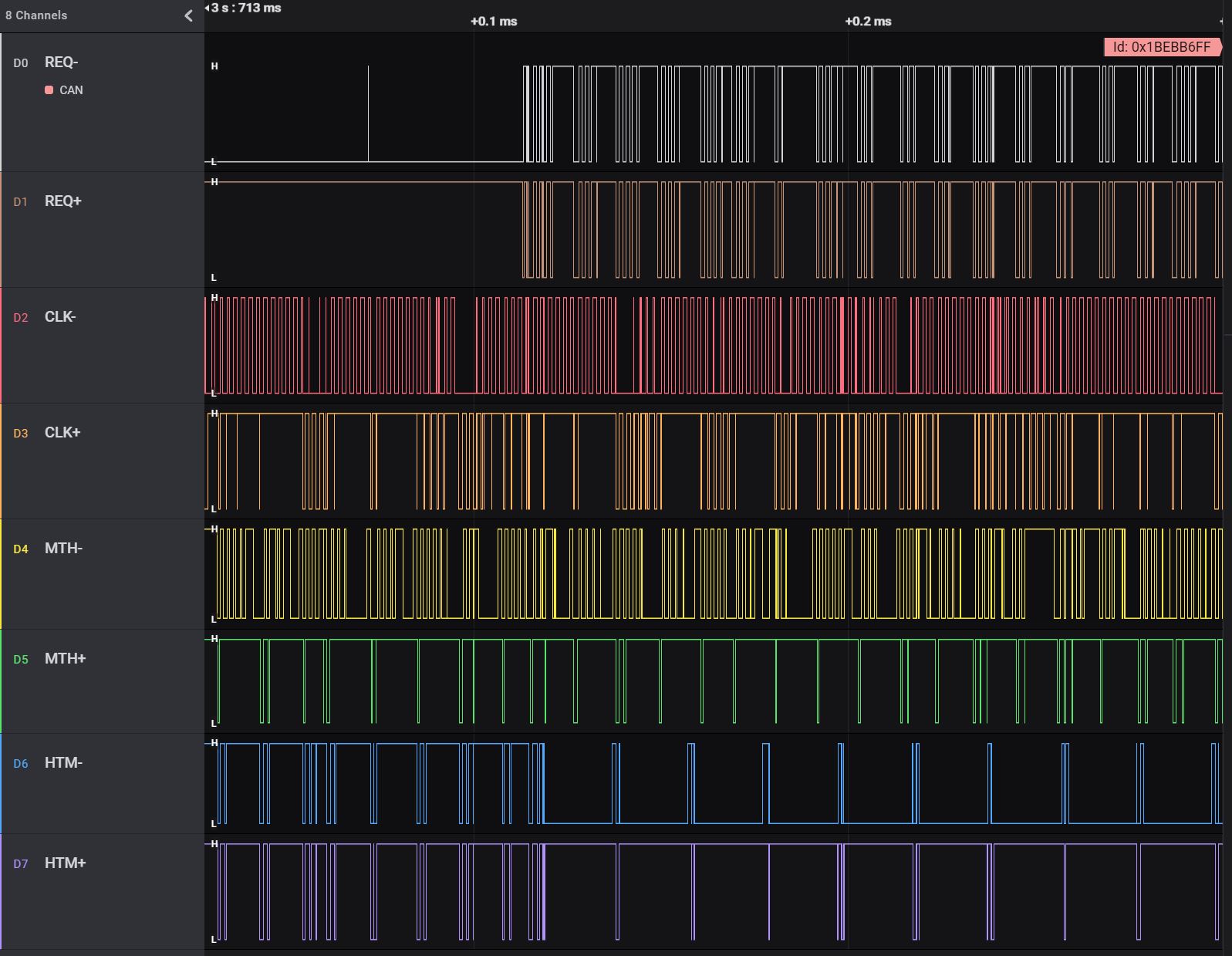

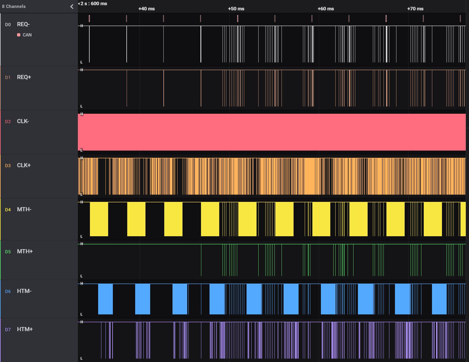

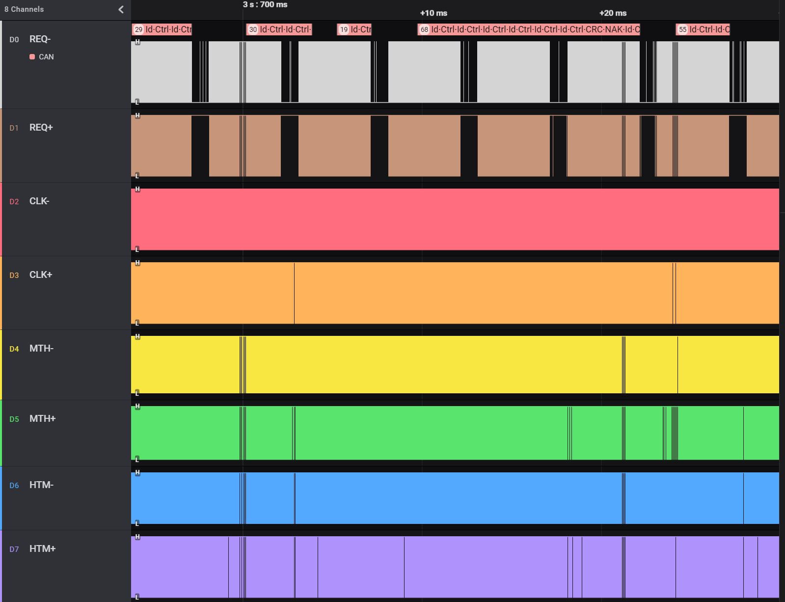

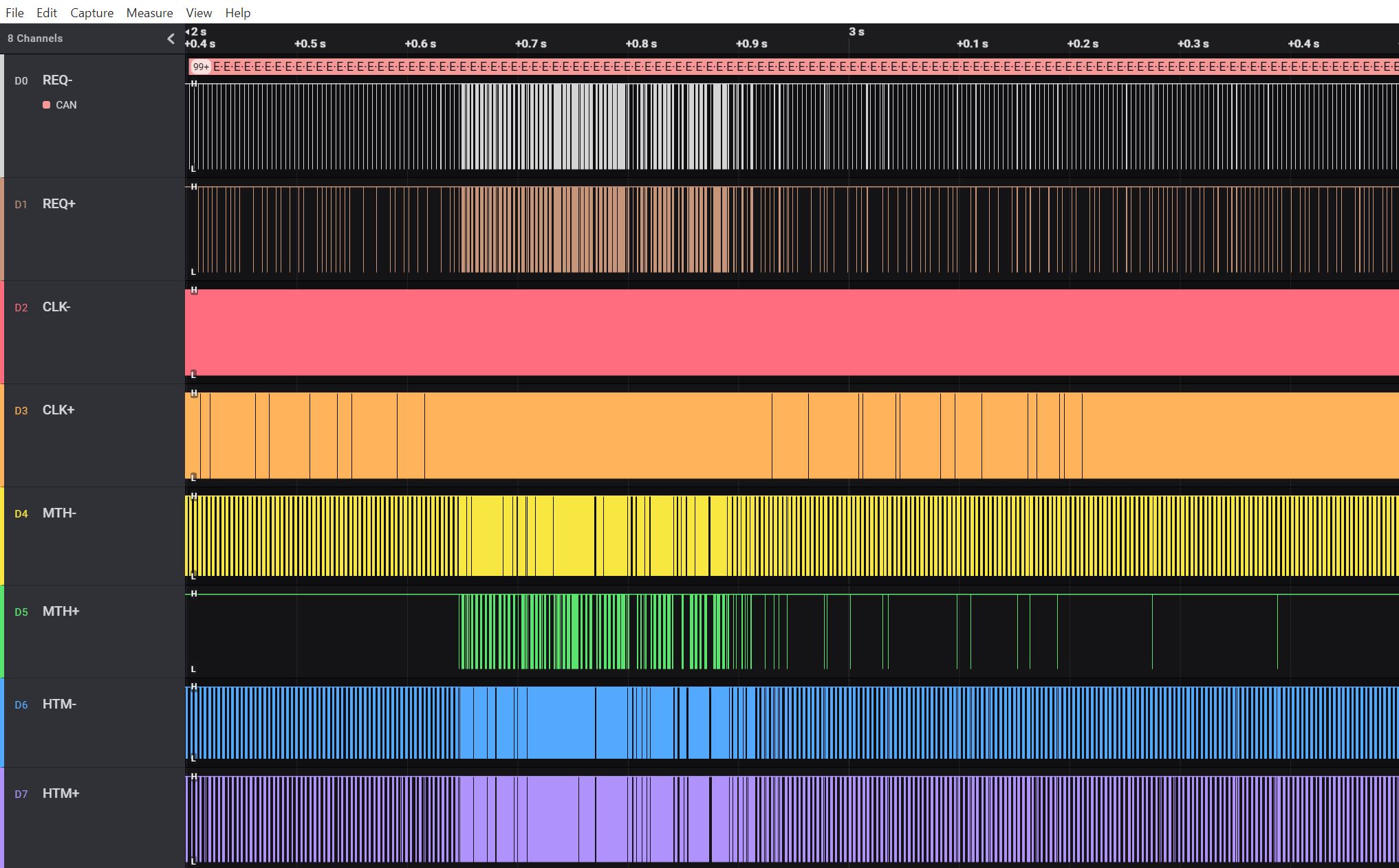

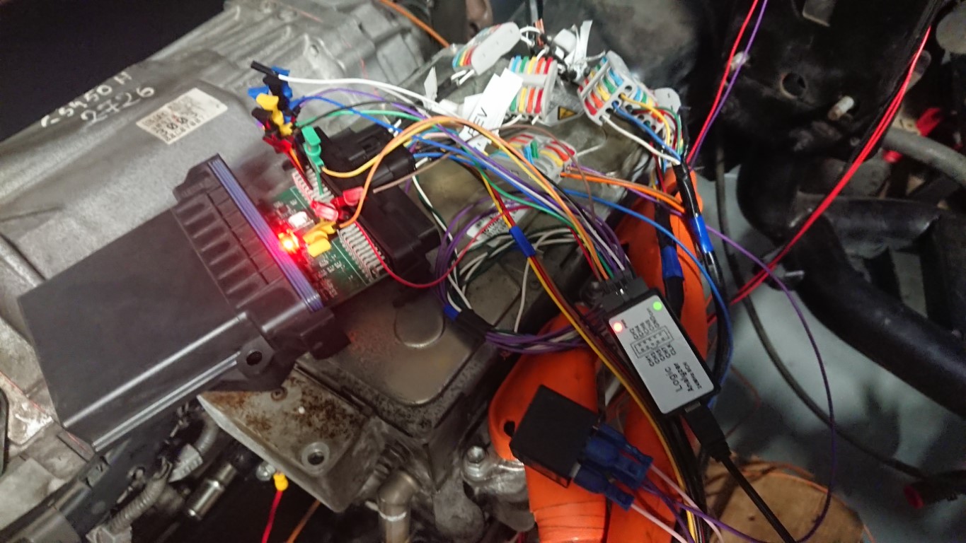

Wanted to share another update on my Zombie/GS450H investigations!
Well it spins! Thanks to Damien and those contributing to this thread :) First time getting the GS450H inverter and drive running
There's a little caveat and a question I might need some help with
So I got hold of a third GS450H inverter. Connected it up and get the exact same result as the first two, InvStat stays Off, Invudc not reading HV, and no spin. So I wired back in the GS450H VCU to check if this new inverter could be run on that board like the other inverters and yes, all runs 100% forward and backward. I've been capturing the comms signals with a cheap saleae logic analyser, so hooked it up to the GS450H VCU comms pins. Look to get decent signals (although I wouldn't know what correct signals looked like!) and when blipping the throttle and spinning the motor, MTH signals pulsed away, so my conclusion was that the inverter can actually communicate as needed to run the system
Seeing Damien's posts about the latest 1.06 firmware, I reconnected the zombie and updated the firmware. Quick test but no change in result. I wanted to grab a saleae log for comparison to my previous logs, plugged the saleae into the laptop (running off its own battery power) and followed the same Ignition On and Start signal sequence. HV contactors did their thing, HV to inverter (4 x 12V batteries, 49V) and 13.5V to inverter, and there it was! First time hearing the inverter whine with the Zombie.
This was accompanied by the Windows 10 USB disconnect and reconnect sound, so the laptop was dropping and reconnecting to the saleae analyser??? Strange. I plugged the analyser out and the inverter whine stopped immediately. Analyser was connected to the 8 comms lines and the zombie ground.
So I repeated this to see if I could get the gearbox to spin. Connected the analyser to the laptop again, ign on, start applied, system into run mode and inverter whine. Applied the forward signal and pressed the throttle pedal and away it span, class. Spent a few minutes spinning at different speeds, and checked the web interface to see Invstat was ON and Invudc was reading correctly. When I unplugged the analyser USB cable, inverter shut down again.
Unfortunately I'm not sure what this means, the analyser must be doing something to help the 12V ground plane maybe, or doing something to correct the resistance or separation of the comms signals. Would anyone have an idea what this means to maybe point me in the right direction? Thank you

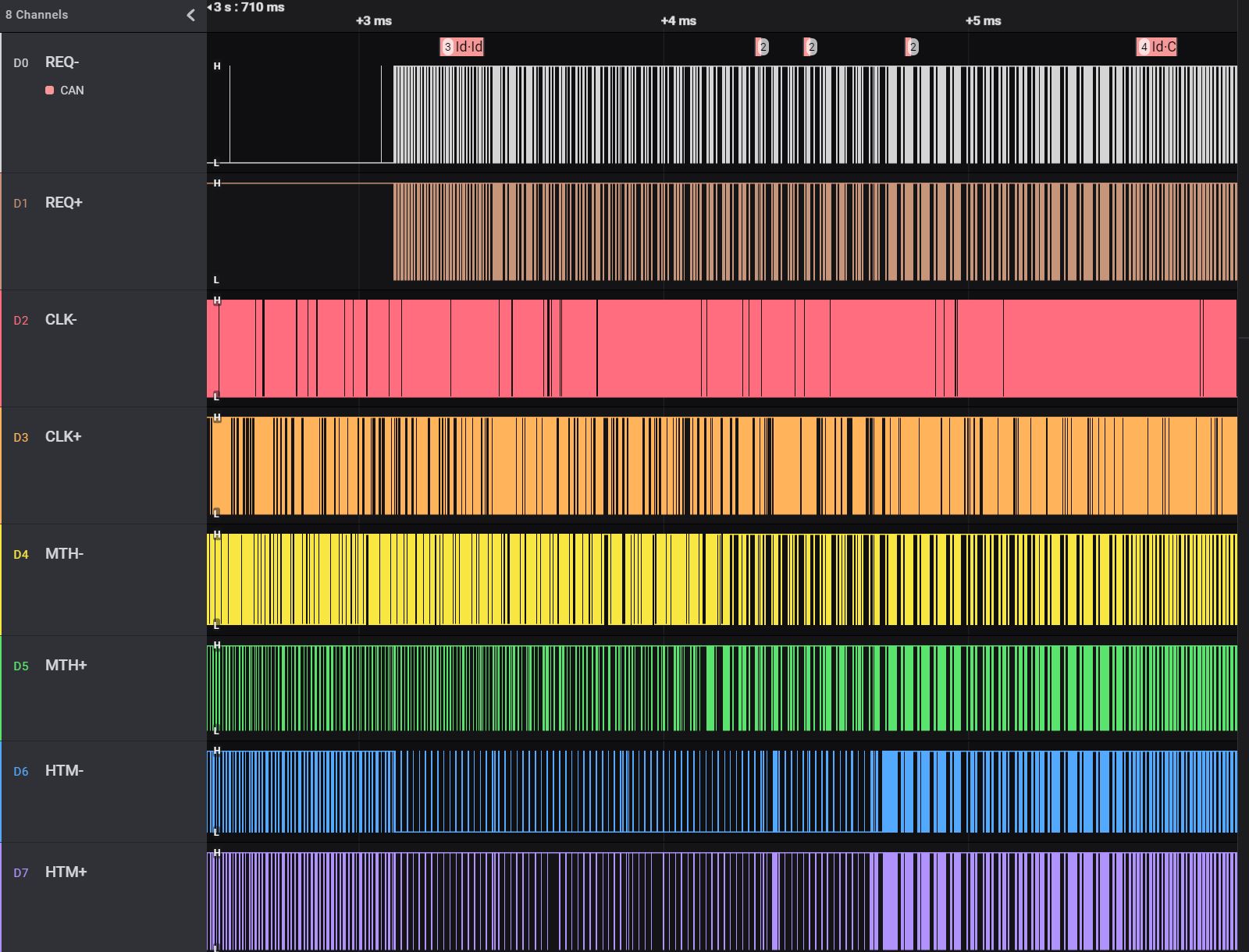

Do you happen to have access to an oscilloscope? Those kind of problems sound like noise or level problems.
When you connected your PC, you earthed your system which might help with noise.
Can you post a more zoomed in picture of the logic analyzer program? Or maybe export the captured signals?
MTH+ certainly looks suspicious, it shouldn't be stuck high so much 🤔
Posts: 5791
Has thanked: 157 times
Been thanked: 1024 times
Re: ZombieVerter VCU Support
Not that I can really fill the gap, I noticed a subtle difference in termination. Zombie has plain 120 Ohms across H/L where as the 450h dedicated had 2x60 Ohms and a cap two ground.
Whatever it is, your signal integrity suffers at some point. Had that happen many times - connect scope, all good. Disconnect - no longer working.
An crasbe just wrote what I was going, to - perfect :)

Just a stupid idea but... did you measure the value of R20, R24, R32?
Not that R20 is a 12 Ohm resistor and adds too much load to the signal lines. But juuuuust enough for it to work sometimes.

Thank you Crasbe and Johu for your replies.

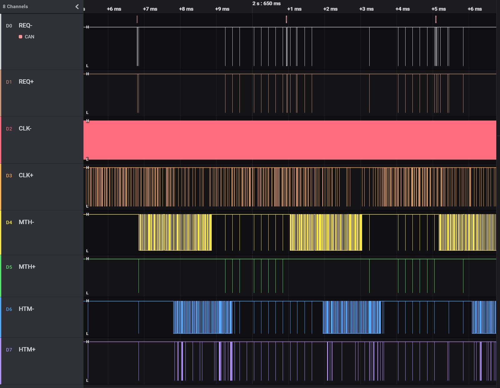

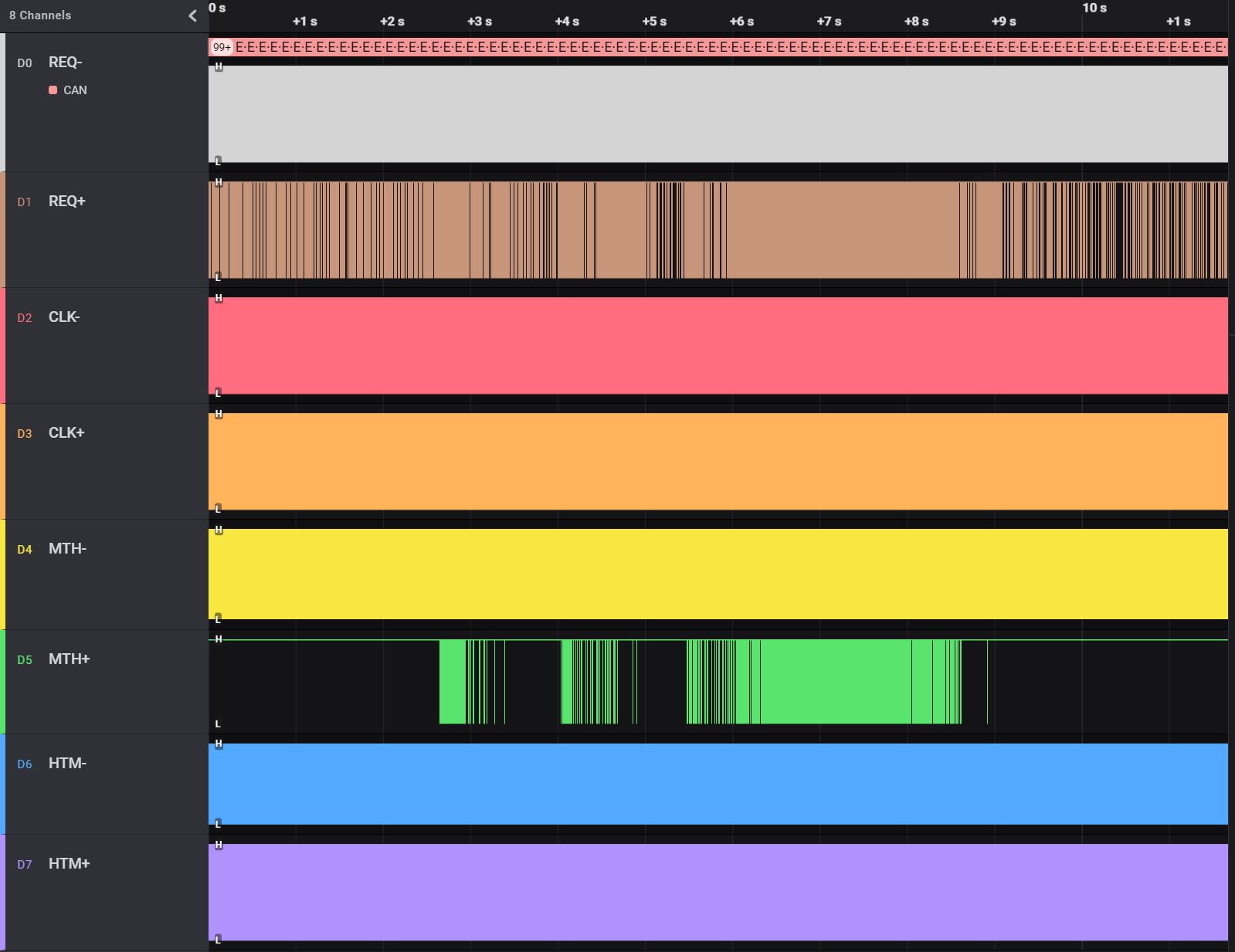

I don't have a better scope unfortunately. I grabbed a few screenshots zooming in on the capture because the file type doesn't seem to be supported here (note this is from the working older GS450H VCU). Damien did find that the older VCU firmware didn't care as much about the return data on MTH but the Zombie does. First image shows three separate presses of the throttle, holding it on longer the third time.
I didn't know what to check so I didn't check those resistors but can try them tomorrow hopefully, thank you Crasbe. I was going to check if just disconnecting the Saleae's ground wire caused the inverter to shut down or if it was one or more of the signal wires.
The screenshots below are from a previous capture with the 1.01 firmware on the Zombie. Some of the previous captures pointed to a lot of commonality between channels and looked like signal bleeding between channels, and the clock signal had breaks. Interestingly I'm not sure I can get a saleae capture with the 1.06 firmware, as it won't stay connected on the USB like before!

You can attach the file if you compress it in a .zip archive.
The signals really look like there's noise present. Do you have the cables of the differential pairs of MTH+ and MTH+, CLK+ and CLK-, HTM+ and HTM- twisted? or are they just "dangling"?
Twisting them might actually significantly improve the signal quality. Maybe adding shielding or using Cat5 S/FTP ethernet cable could work as well. 🤔
