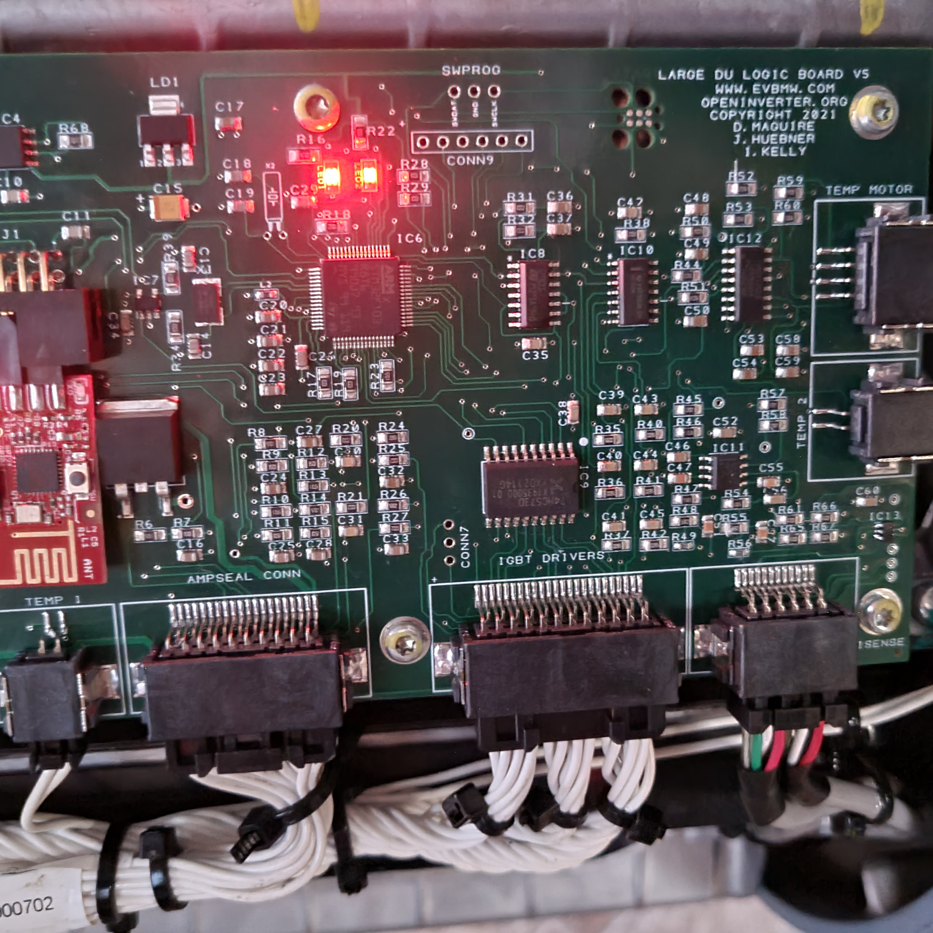

the voltage on C6 measures 11.76 the strange thing is that the battery has 12.7V and why does it drop. buy the card directly at open inverter Shop. I will send you the photo of it, it is a V4B, and I have also noticed that all the points of the ampseal connector output 5V, I only have 3.4

A bit of drop is normal, but should be more like 0.5V. Something is loading down the 5V rail.bmwx5projet wrote: ↑Thu Nov 10, 2022 1:50 am the voltage on C6 measures 11.76 the strange thing is that the battery has 12.7V and why does it drop. buy the card directly at open inverter Shop. I will send you the photo of it, it is a V4B, and I have also noticed that all the points of the ampseal connector output 5V, I only have 3.4
I will also check if something is wrong with the 5V reg
EDIT: checked on a board here, it produces 5.3V
- Can you check again with all BUT the ampseal connector disconnected?
- Does anything heat up?

Greetings, I was looking at the description of the LD1 voltage regulator and it is AMS1117-3.3 and it is a regulator whose output is 3.3v. No matter what its input is, from 4.5 to 15V, 3.3V come out, which means that the correct voltages are coming out. , which is not 5 but 3.3V. Is this analysis correct?johu wrote: ↑Thu Nov 10, 2022 7:21 am A bit of drop is normal, but should be more like 0.5V. Something is loading down the 5V rail.

Yes, but before that is a 5V regulator that supplies some parts of the circuit and also the throttle pedal. So 5V goes into LD1, 3.3V comes out. I had you measure across the INPUT and that was 3.4V, too low.

Hello, I started doing some follow-up tests and this is what I saw, 12v arrives at lC1 but 4.1 comes out for L1 and 3.4V comes out of L1. what I can deduce is that IC1 is the one that must take out the 5 V to L1 which is an inductor. what do you think?

It's hard to help if you don't follow instructions
- what is the current draw?
- does anything heat up?
- do you obtain 5V out of the inductor L1 with all connectors unplugged and only 12v supplied to the board?
- Posts: 30
- Joined: Tue Aug 09, 2022 12:54 pm
I'm sorry, I hadn't understood the instructions, but yes, I already removed the connectors, just leave the ampseal connector and 5.35V comes out through L1 and 5.35V arrives at LD1 and comes out of LD1 3.3 is correct

I dared to reconnect the connectors one by one and measure the voltage and the drop that occurs when isense is connected. If left unconnected the voltages remain constant.

Ok, so it is diagnosed, something is dodgy with the current sensors then. You can leave them disconnected for some gentle spinning tests as the current values are not needed by the motor control loop.
Then you should find out why they draw so much current and which one of the two draws so much current. Maybe you need a replacement?
