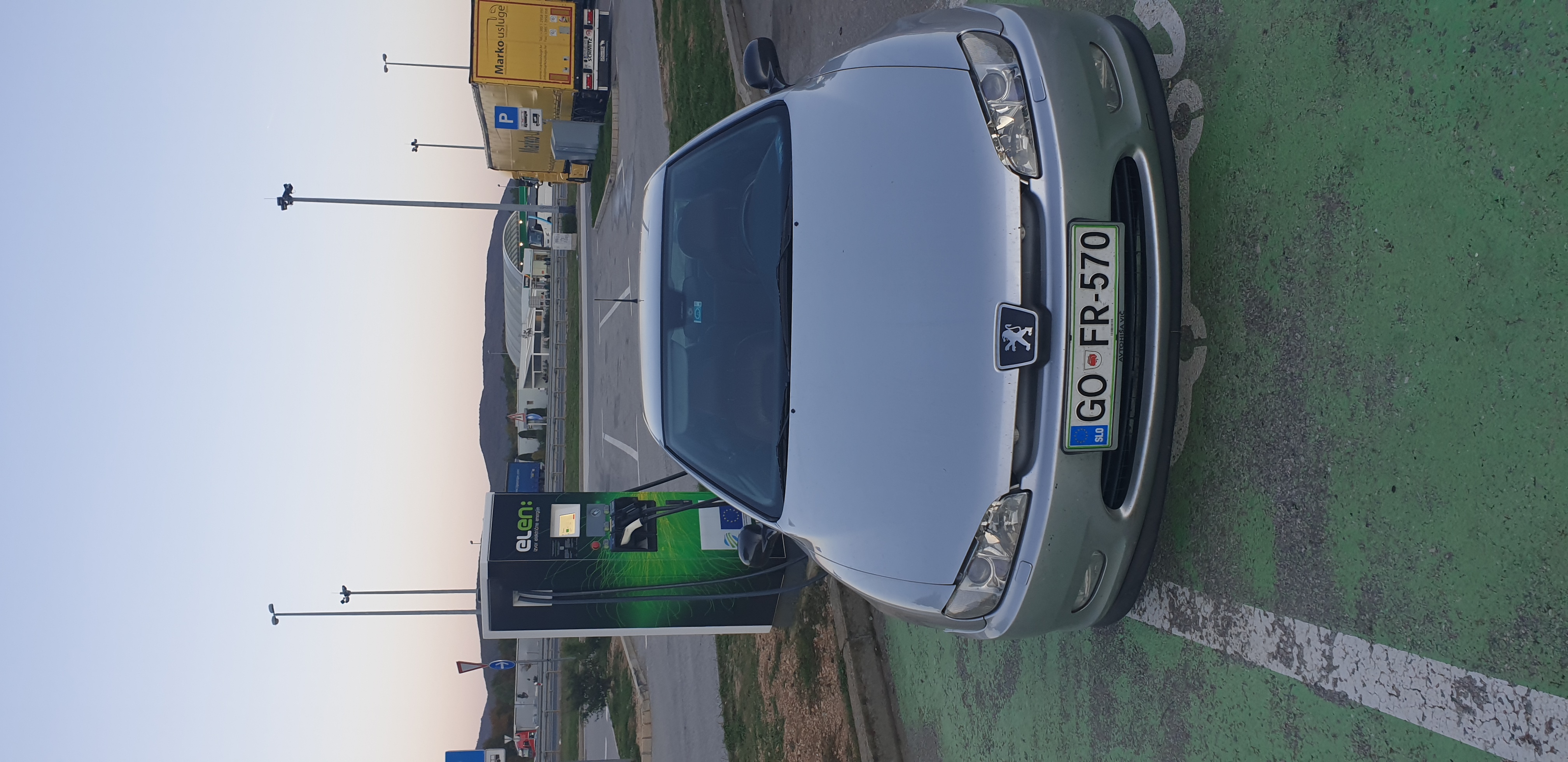

Nope that doesnt work. Today a lot of evse on my way to Split just stopped charging when reached 390V battery voltage. I havent observed any throttling of the amps.

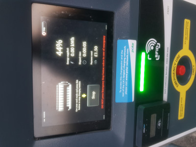

Currently awaiting recovery tried multiple chargers and now too empty to continue, getting recovery home instead of desired destination so I'm not stuck again
Charging starts then immediately stops with no apparent reason.

Dang! I was good with Chademo stations all the way to Split.
The same happens to me at Delta chargers. I suspect bad CAN bus termination. I am thinking of taking VCU board 60R resistor out and extending chademo twisted pair. Then i qould fit one 60R resistor into the end connector. Maybe i could then more easily connect to this line for listening...
But this would mean i have to take apart everything... maybe now that i have to refit my battery i can also do this job.

I'm not sure what the problem could be, it was communicating properly from what I can tell with the log file, the current request ramps up then it just stops at 4 amps.

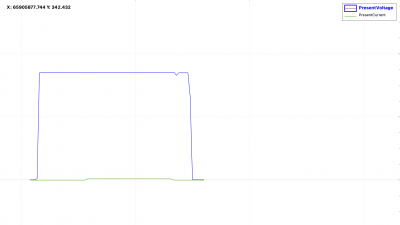

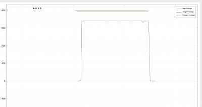

Still an issue today so grabbed a log
Looks like the voltage seen goes up to ~340v but doesn't drop back below 20v before staring the charge.
