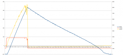

According to that chart, my 0-60 was 8.0 seconds. Certainly should be able to improve on that once I have these voltage and slip parameters set correctly and I'm a bit more confident in all the mechanical bits! Raising boost will have already helped I'm sure.

The next time I test I will add i1rms to the chart, and swap idc for the measurement from my ISA shunt. This should provide much more detailed data about what's happening. I'll also experiment with increasing fslipmin from 1 to 2. I have a *lot* of trials to do before I fully understand the optimal configuration!

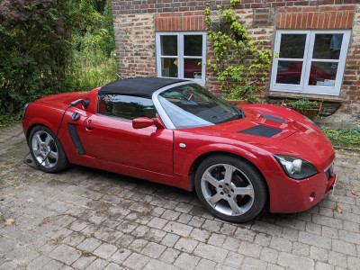

I made some videos to show the finished car!
I've also informed the DVLA of the conversion, fingers crossed I get the documentation updated without any issues.

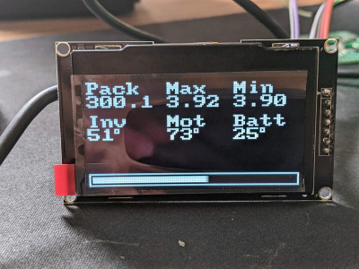

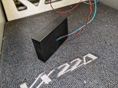

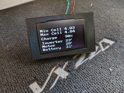

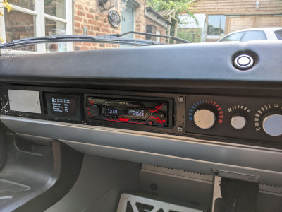

The display is now finished and installed. With that done, and the SDU tuning complete, I think I can declare the car complete

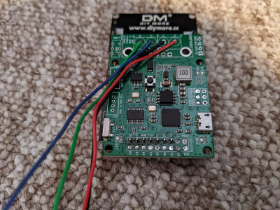

Hi man, great project, I watched your videos a few weeks ago.
How do you feed data into the OLED display? Do you have another MCU and send it data via CAN or do you display data on it via I2C? Or something else?
I am having trouble with EMF and my I2C display dropping out when depressing the throttle and inverter working hard. Now investigating what the best course of action is, shortening the cables helped a lot, but didn't fully eliminate the problem - and I don't want my display in the engine bay
Currently waiting for a pair of PCA9615 that Johannes suggested, but wondering what your setup is.

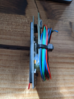

Re: VX220 with Tesla SDU

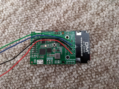

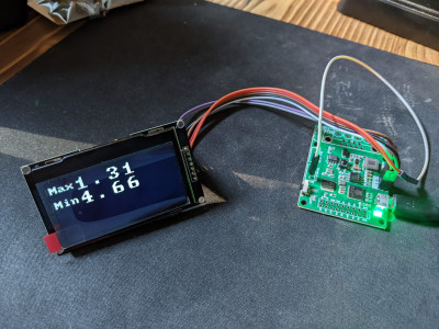

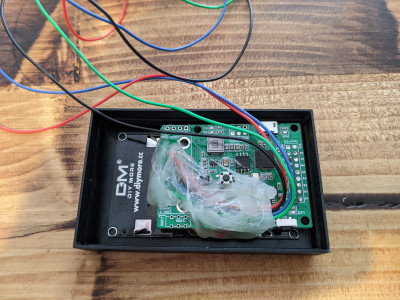

I am using this display: https://www.diymore.cc/collections/led- ... lue-yellow
And this board: https://docs.longan-labs.cc/1030018/
I was able to sandwich them together very neatly to create a fully integrated programmable CAN display. RP2040 source code here: https://github.com/catphish/vx220-oled/ ... /display.c
