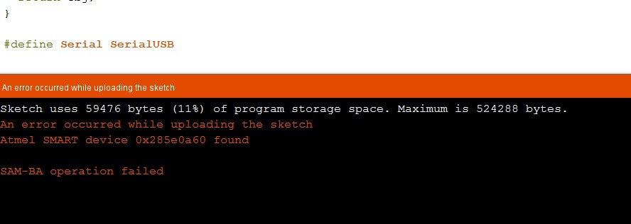

See on the photo, IDE sees the chip but it cant upload...
Posts: 3266
Has thanked: 80 times
Been thanked: 234 times
I managed to upload .bin file via bossa utility, but i cant get any serial data as i power the VCU.
It is still recognised as Bossa programming port.
Did i mess the bootloader?

EDIT: I get this when i try to upload sketch
Send auto-baud
An error occurred while uploading the sketch
Set binary mode
readWord(addr=0)=0x20001000
readWord(addr=0xe000ed00)=0x412fc230
readWord(addr=0x400e0740)=0
readWord(addr=0x400e0940)=0x285e0a60
version()=v1.1 Dec 15 2010 19:25:04
chipId=0x285e0a60
Connected at 115200 baud
SAM-BA operation failed
Atmel SMART device 0x285e0a60 found
write(addr=0x20001000,size=0x34)

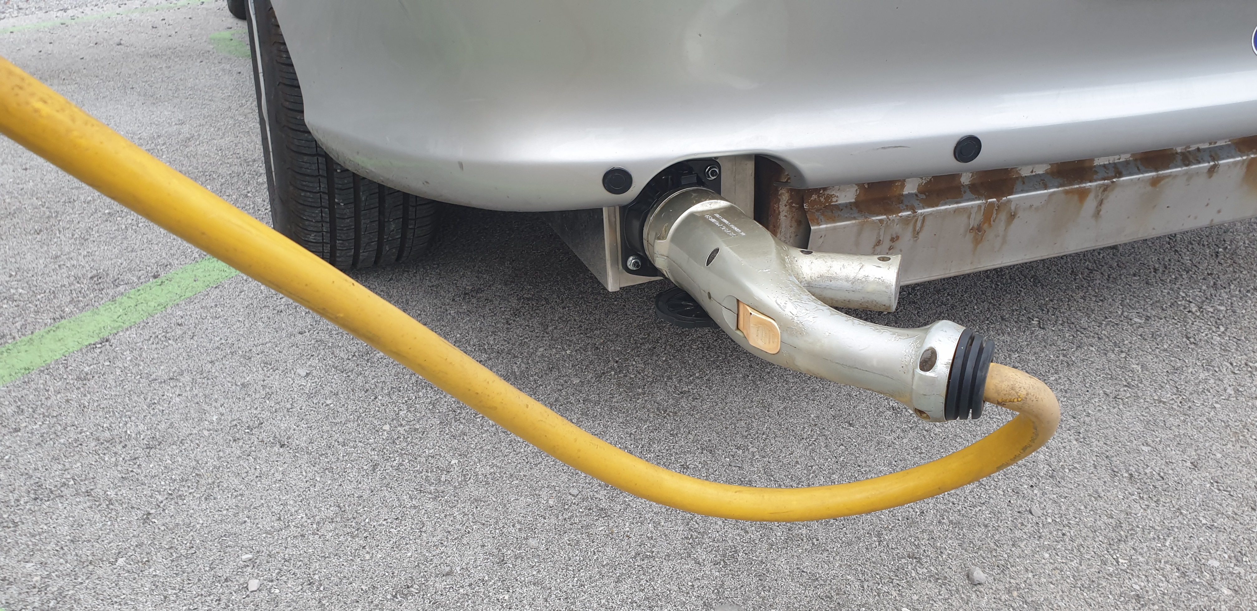

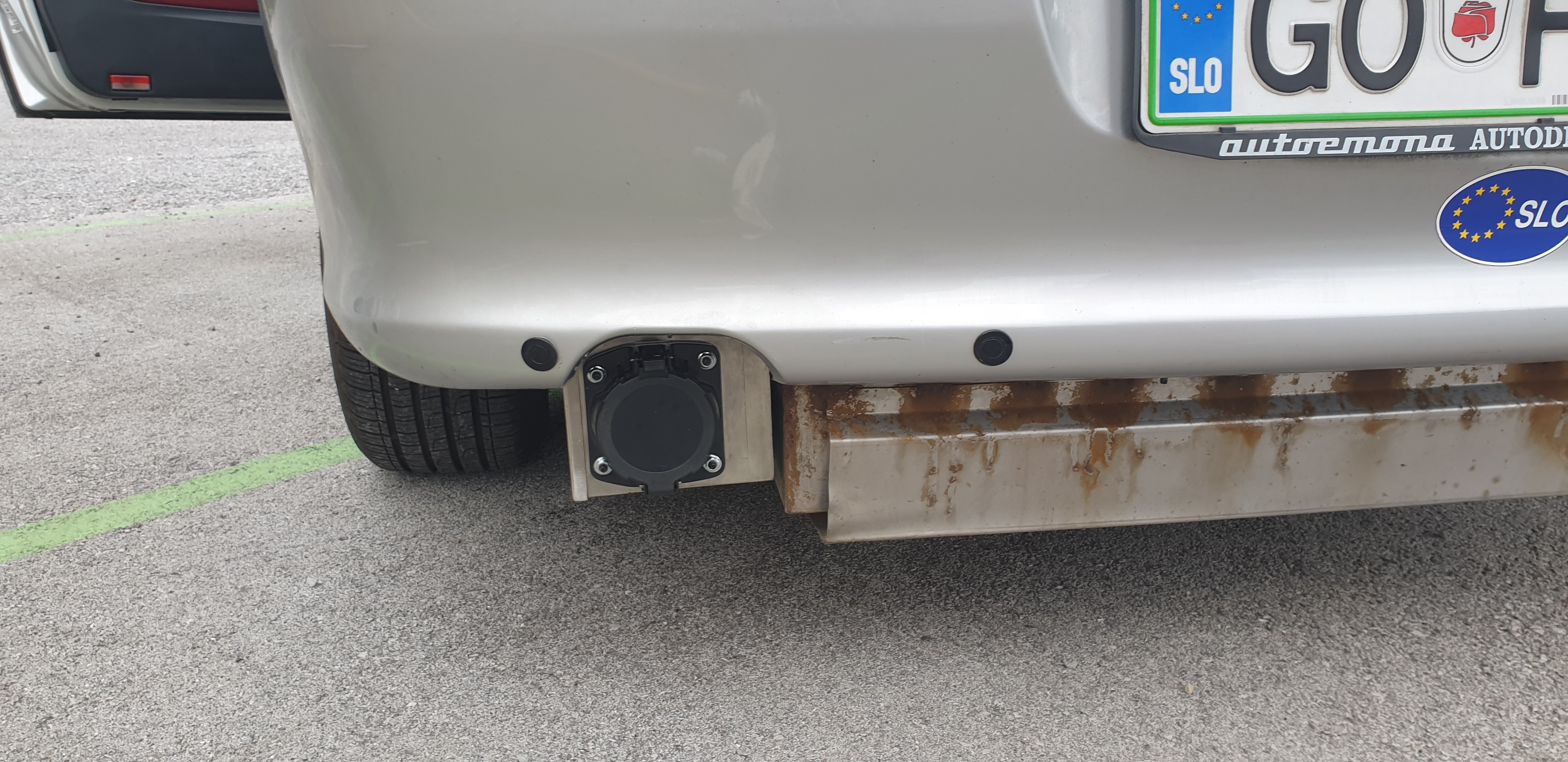

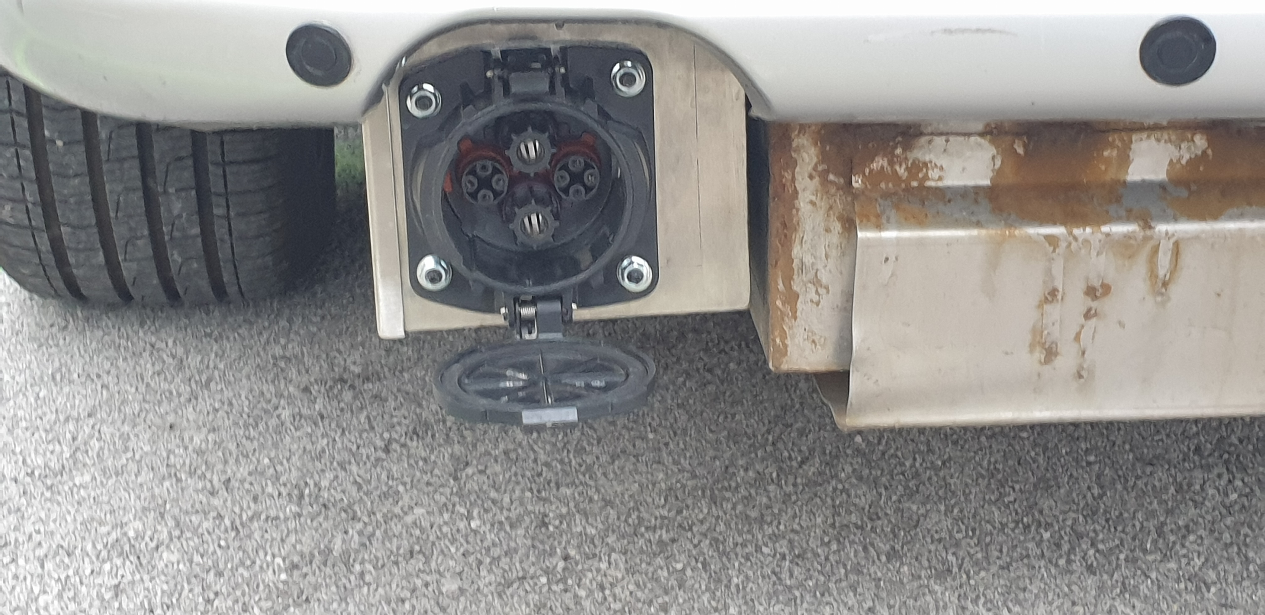

Finally the fruits of my labour...
I mounted the box to the place of exhaust. Self sustained no power from the car required. Apart from solid GND. I intend to test this a bit. In the end i will probably add CAN line to BMS for protection.
I intend to simply use a heartbeat telegram similar to Outlanders 0x285 to keep chademo operating. If that would be missing VCU would stop.
Edit: that rust does not belong there 😁. I guess there is no inox welding wire. I have to sort it out before winter.

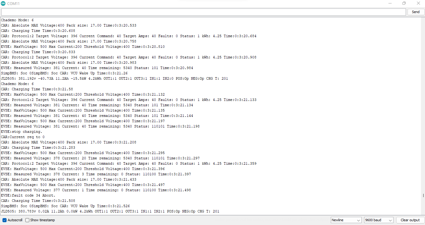

Hey Guys, I've set up a due with bigpies shield in the wiki. Testing on a nearby charger it stops charging after almost exactly 2mins every time I test it. Its a Tritium PK350 "ultra rapid charger". Has anyone else had a similar issue? I'm Planning on testing on the next closest station tomorrow, unfortunately its 40km away :roll: .
Attached is a screenshot of when it stopped.
Posts: 1596
Has thanked: 75 times
Been thanked: 306 times
Which version did you use? V1 had a few mistakes that needed correction:D
If V1, R4 needs to be a solder bridge, R7 needs removing. IN2 needs a 1k pull up to 3.3v adding too. I've also changed IN2 to use pin 5 vs pin 6 as I've blown pin 6 on my due.

Using V2 :) The charger stops at exactly 2mins everytime, I'm thinking a compatibility issue. I'll get a CAN log over the next few days.
One thing I found on the V2 board is the 3v3 wasn't connected to the can transceivers, The traces are there but a through hole is missing to join them. Great job on the board though, it's a neat little solution.
Posts: 1596
Doh, I'll update that, I've not actually got round to ordering v2 boards yet :D. A can log would be good and also if you do DBG=3 before starting it'll spew out more info too.

        if (carStatus.targetCurrent < settings.maxChargeAmperage) carStatus.targetCurrent++;
The change then propagates to sendCANStatus() where askingAmps is decreased if greater than targetCurrent. askingAmps is the real request going to the EVSE.
VMAX is a protection setting, so if voltage hits that level the charge will shut down. Use V=(desired setting) to configure your desired charge voltage.
It's been some time since I played with this code. Last time I had Chademo working I ran into issues with overheating EVSEs (it was 100F out) ramping current down and the software didn't like it, I made changes to fix that but haven't gotten those into the published version.
CCSknowitall
Posts: 105
Joined: Fri Jun 04, 2021 1:47 pm
Been thanked: 28 times
Post by CCSknowitall »
Isaac96 wrote: Wed Sep 28, 2022 10:22 pm Last time I had Chademo working I ran into issues with overheating EVSEs (it was 100F out) ramping current down and the software didn't like it, I made changes to fix that but haven't gotten those into the published version.
Highly recommend implementing this as a number of CHAdeMO stations will adjust their max amps due to temp or available power modules. Most notably the Tritium Veefil 50kW units.
Posts: 3266
Isaac96 wrote: Wed Sep 28, 2022 10:22 pm VMAX is a protection setting, so if voltage hits that level the charge will shut down. Use V=(desired setting) to configure your desired charge voltage.
HM... so it would be desirable that settings.maxChargeVoltage would be set lower than settings.targetChargeVoltage?
I guess i attributed a lot more importance to settings.maxChargeVoltage when it just seems to be a limit when tapering occurs.
Can you confirm this logic for me?
So if i set settings.maxChargeVoltage = 390V and settings.targetChargeVoltage = 392V askingAmps would be reduced down to minChargeAmperage by holding maxChargeVoltage steady. Then charging process would stop. Thus i could charge up to 390V and current would taper down to 10A if i would set minChargeAmperage so?
If it works like this then i just need to correct my settings :). Maybe i will set a comment in wiki too.
tnx
Isaac96
Posts: 656
Post by Isaac96 »
arber333 wrote: Thu Sep 29, 2022 6:57 am HM... so it would be desirable that settings.maxChargeVoltage would be set lower than settings.targetChargeVoltage?
tnx
Other way around. settings.targetChargeVoltage is the CV limit, settings.maxChargeVoltage is the 'safety valve'.
Posts: 3266
Isaac96 wrote: Thu Sep 29, 2022 2:10 pm Other way around. settings.targetChargeVoltage is the CV limit, settings.maxChargeVoltage is the 'safety valve'.
Hm... no i tries that already and it just stoped charging. No tapering of current... this is why i wanted to setup tapering.
Do you think i should setup greater difference? As in 390V for charge and 394V for max?
